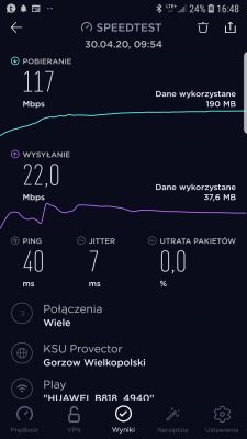

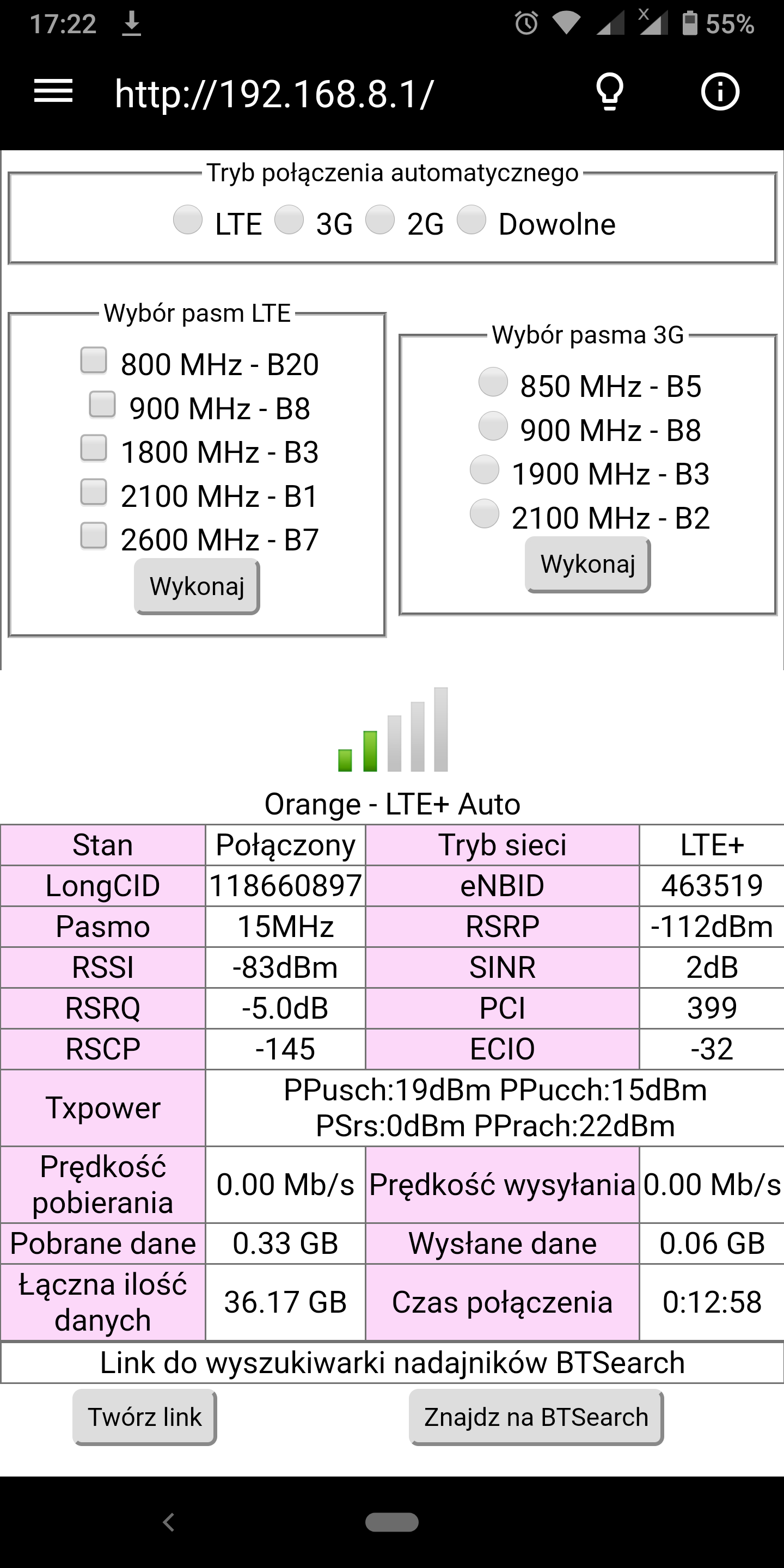

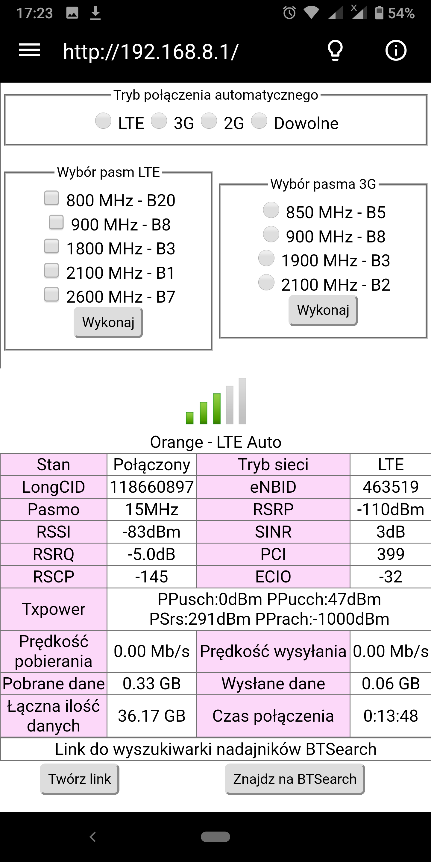

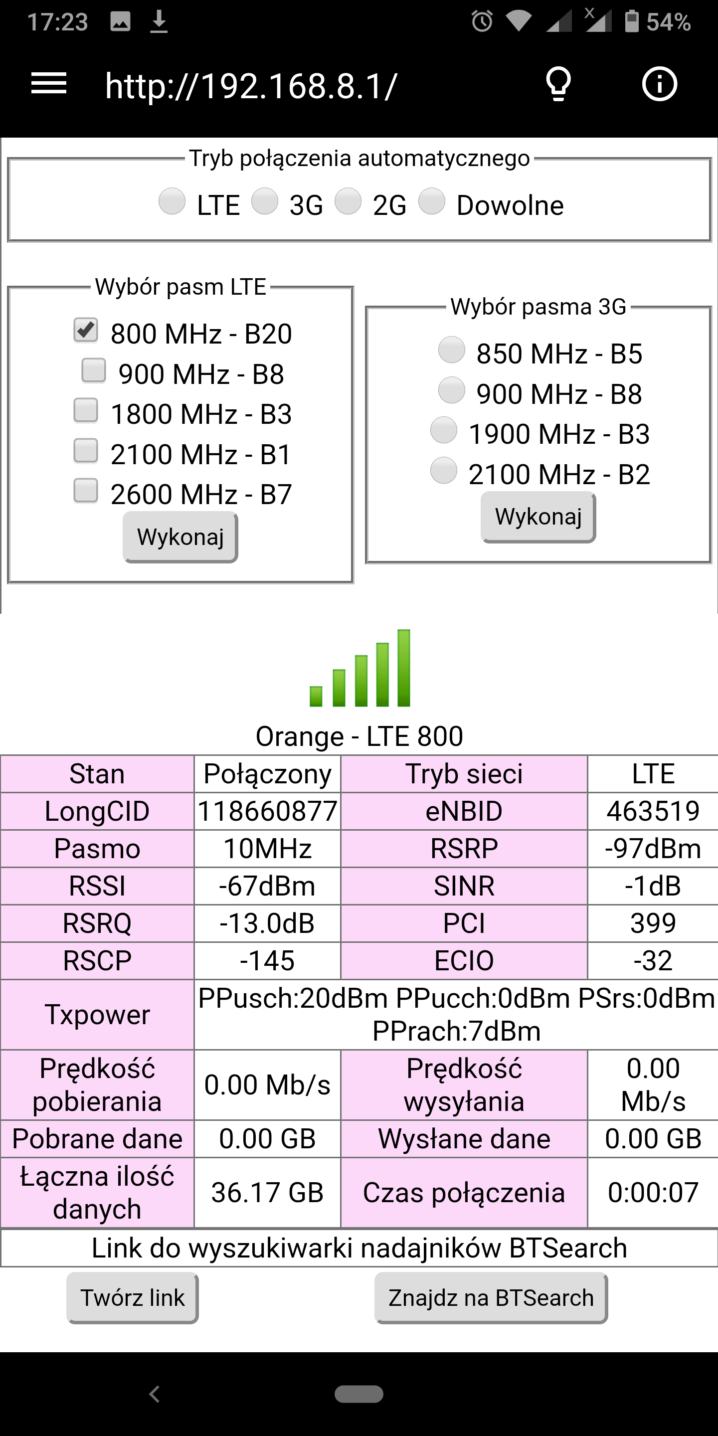

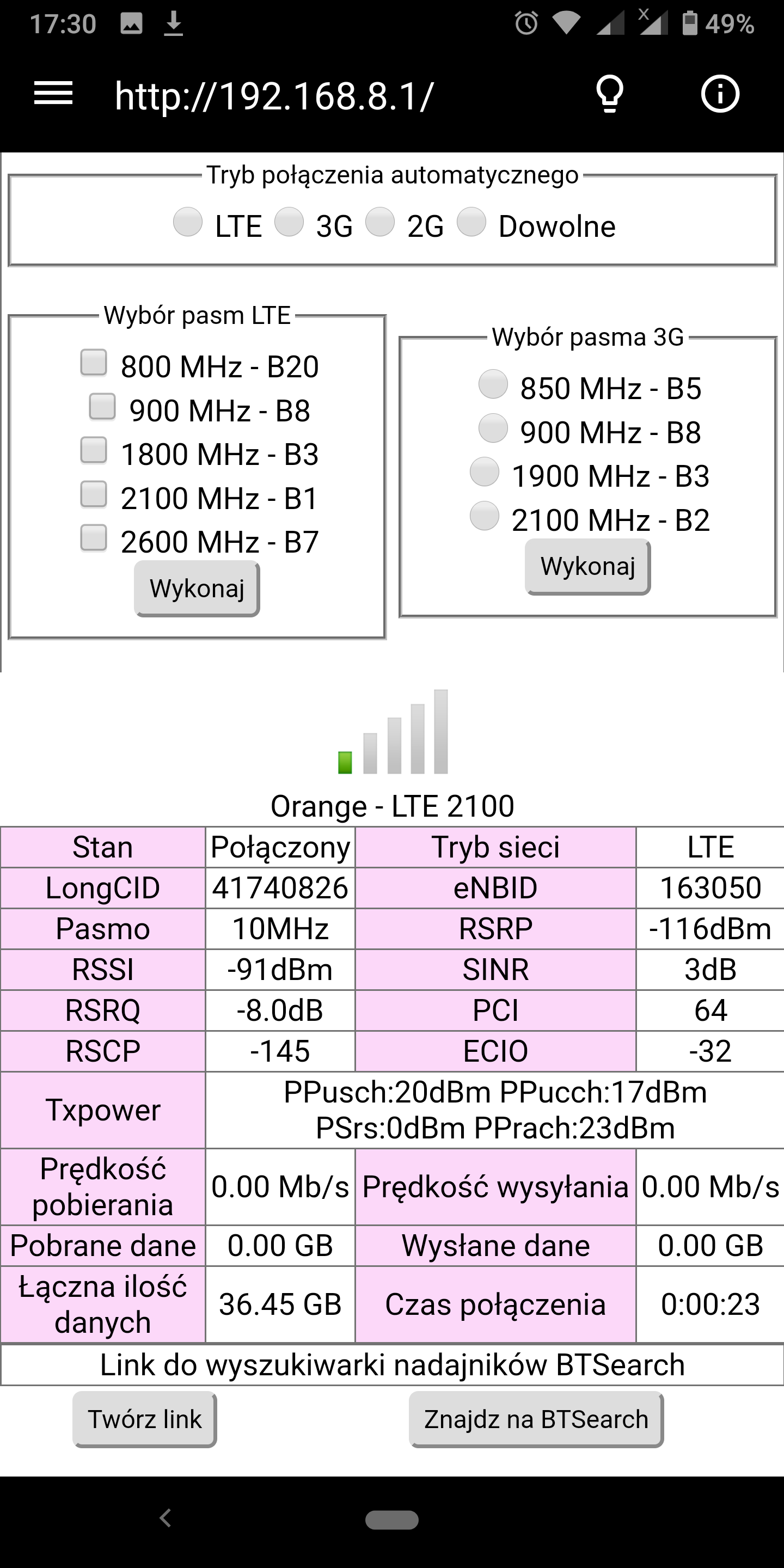

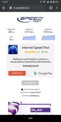

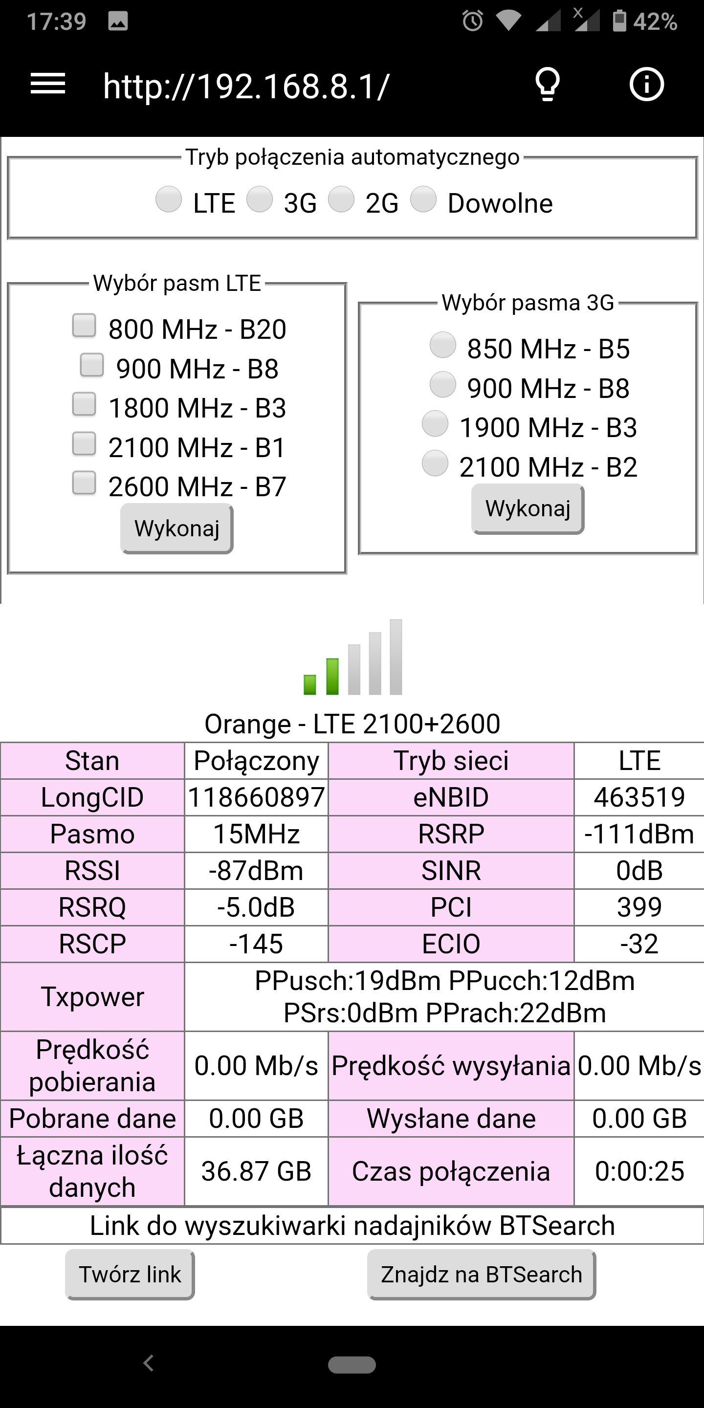

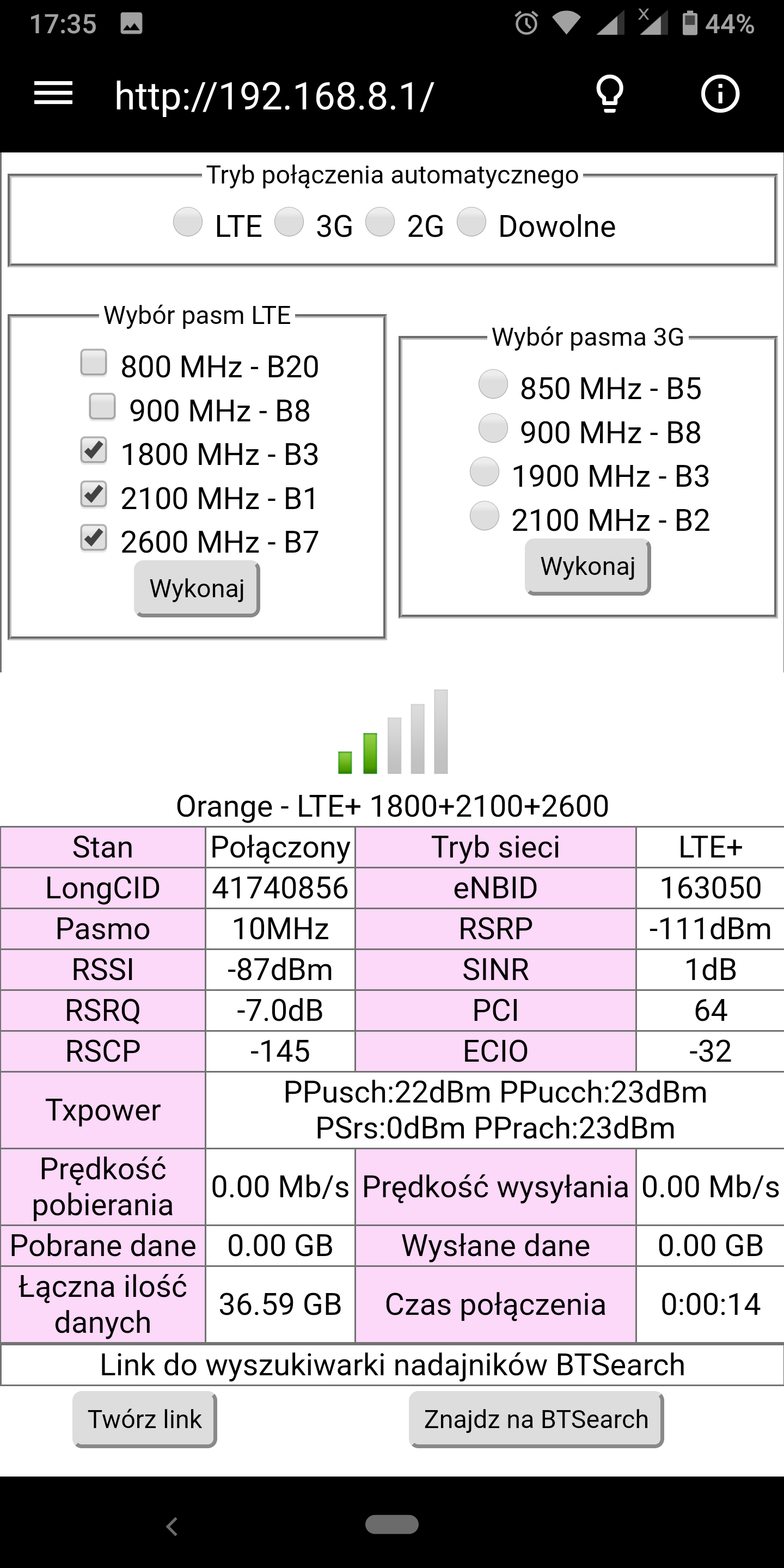

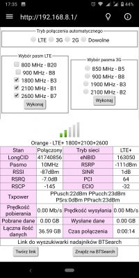

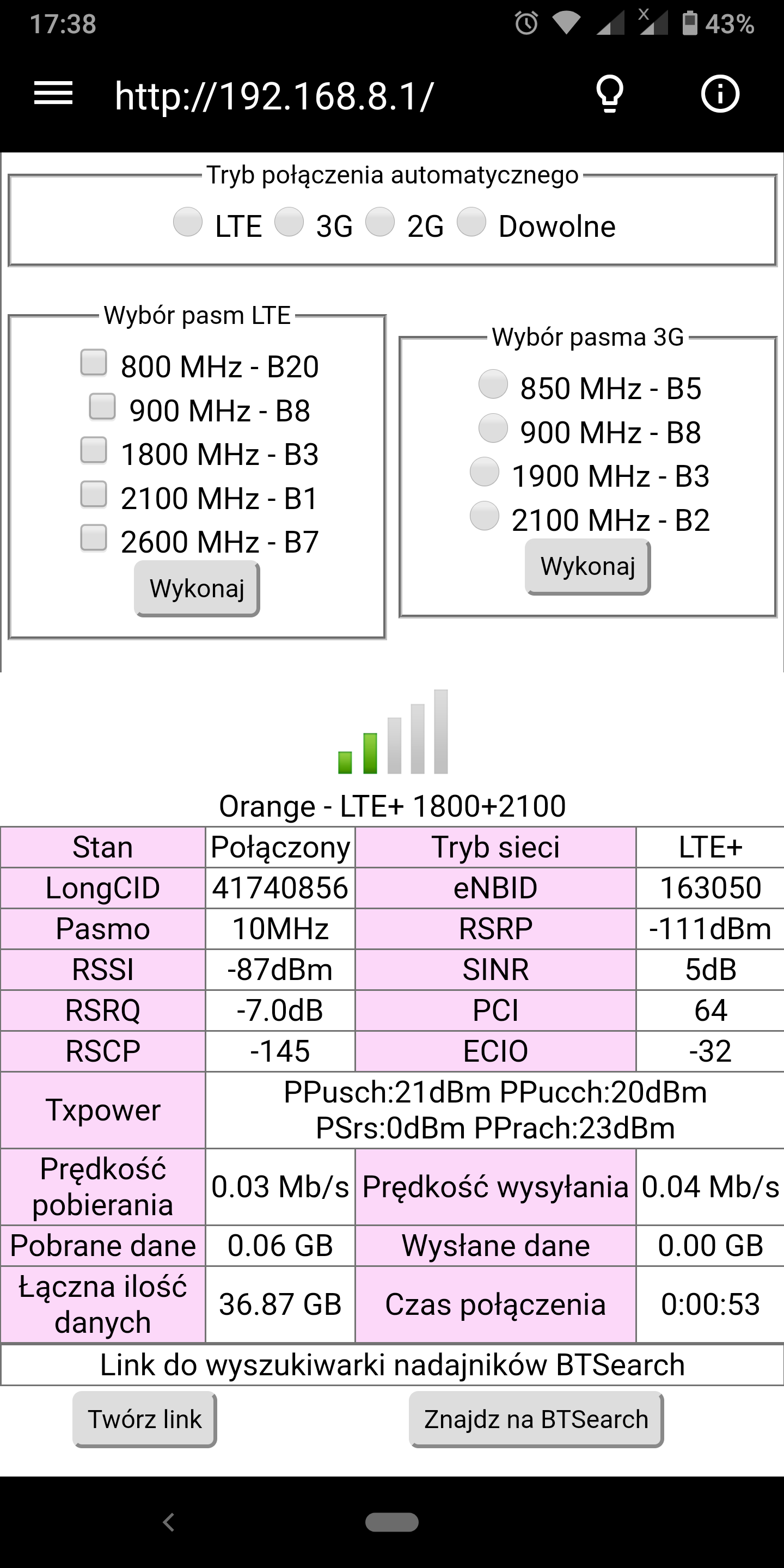

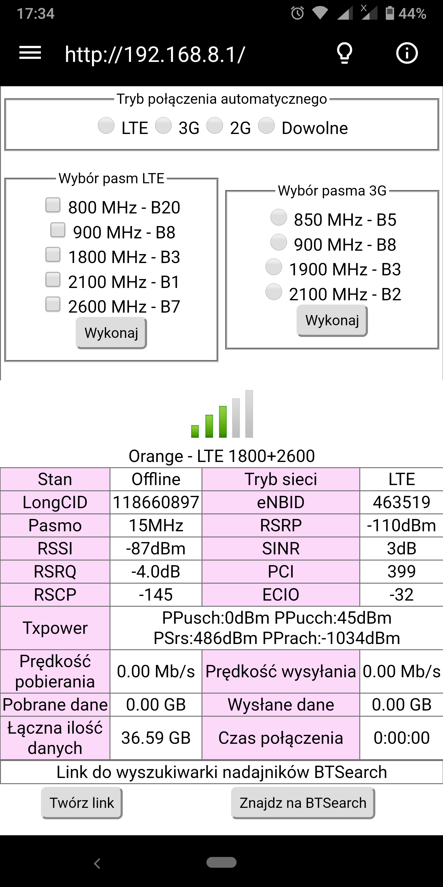

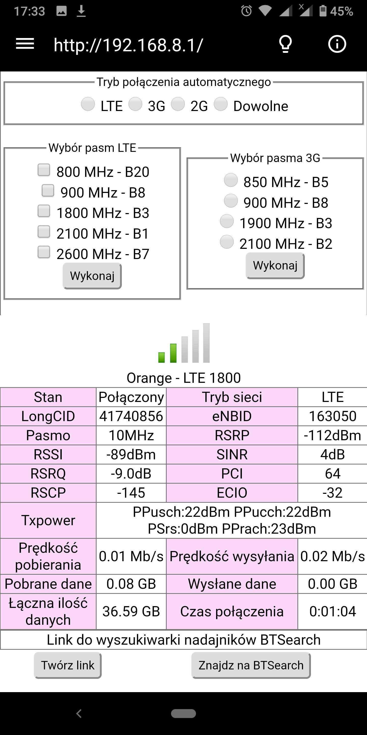

    Hello everyone!
    Unfortunately, I have a similar problem with the B818 with the Orange sim card.
    The nearest BTS is in Budzisław Kościelny / Górny and I have about 3.2 km to it.
    The best upload was on LTE800, while the best overall result was for 2100 + 2600 aggregation.
    Please take a look at the screenshots below and recommend a really good antenna :)
    For me, the router has to land outside in the box, so I will be happy to use any information about what boxes you recommend and their heating or ventilation.
    Best wishes!
    Best External LTE Antenna Options for Huawei B818 Router: Recommendations & Buying Guide Best External LTE Antenna Options for Huawei B818 Router: Recommendations & Buying Guide Best External LTE Antenna Options for Huawei B818 Router: Recommendations & Buying Guide Best External LTE Antenna Options for Huawei B818 Router: Recommendations & Buying Guide Best External LTE Antenna Options for Huawei B818 Router: Recommendations & Buying Guide Best External LTE Antenna Options for Huawei B818 Router: Recommendations & Buying Guide Best External LTE Antenna Options for Huawei B818 Router: Recommendations & Buying Guide Best External LTE Antenna Options for Huawei B818 Router: Recommendations & Buying Guide Best External LTE Antenna Options for Huawei B818 Router: Recommendations & Buying Guide Best External LTE Antenna Options for Huawei B818 Router: Recommendations & Buying Guide image10 Best External LTE Antenna Options for Huawei B818 Router: Recommendations & Buying Guide Best External LTE Antenna Options for Huawei B818 Router: Recommendations & Buying Guide

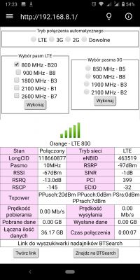

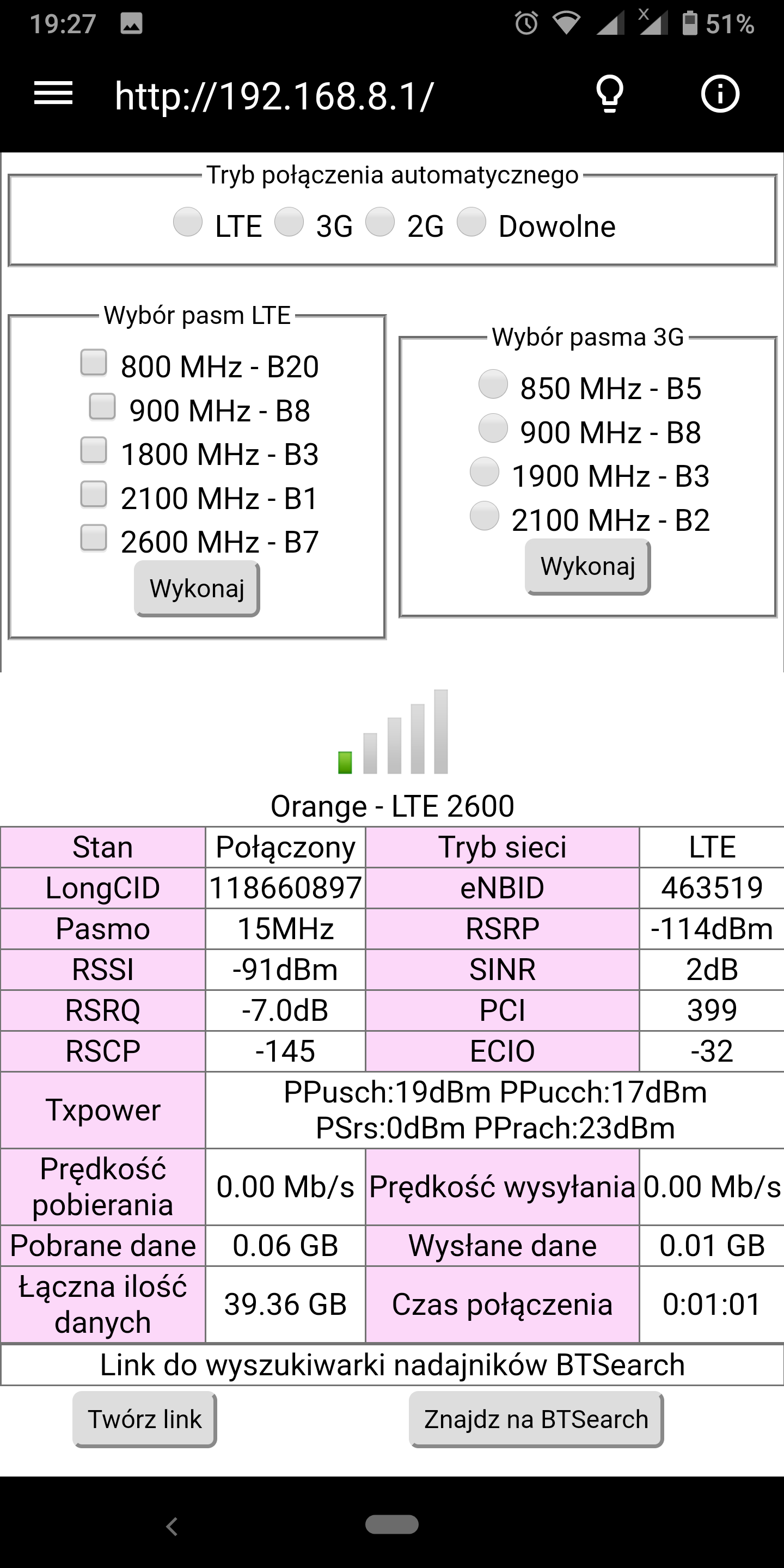

    Yes, out and of course I can repeat them.
    From what I remember, the results were rather oscillating within the same limits DL: 20-30 mb / s Up: 2-5. There was a very high ping on one of the frequencies (probably LTE2600, 1.5 seconds).
    And out of curiosity, the LTE800 is why we give up?
    After all, it had the most green lines ? ?
  • #73 18696527
    Range1
    Posts: 310
    Help: 80
    Rate: 22
    Because this is the range band to which they log in most often and due to the fact that it is the narrowest only 5 MHz of capacity, it clogs up the fastest. That is why we focus on capacitive bands, because you can have normal Internet on them.

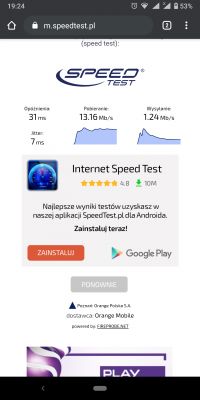

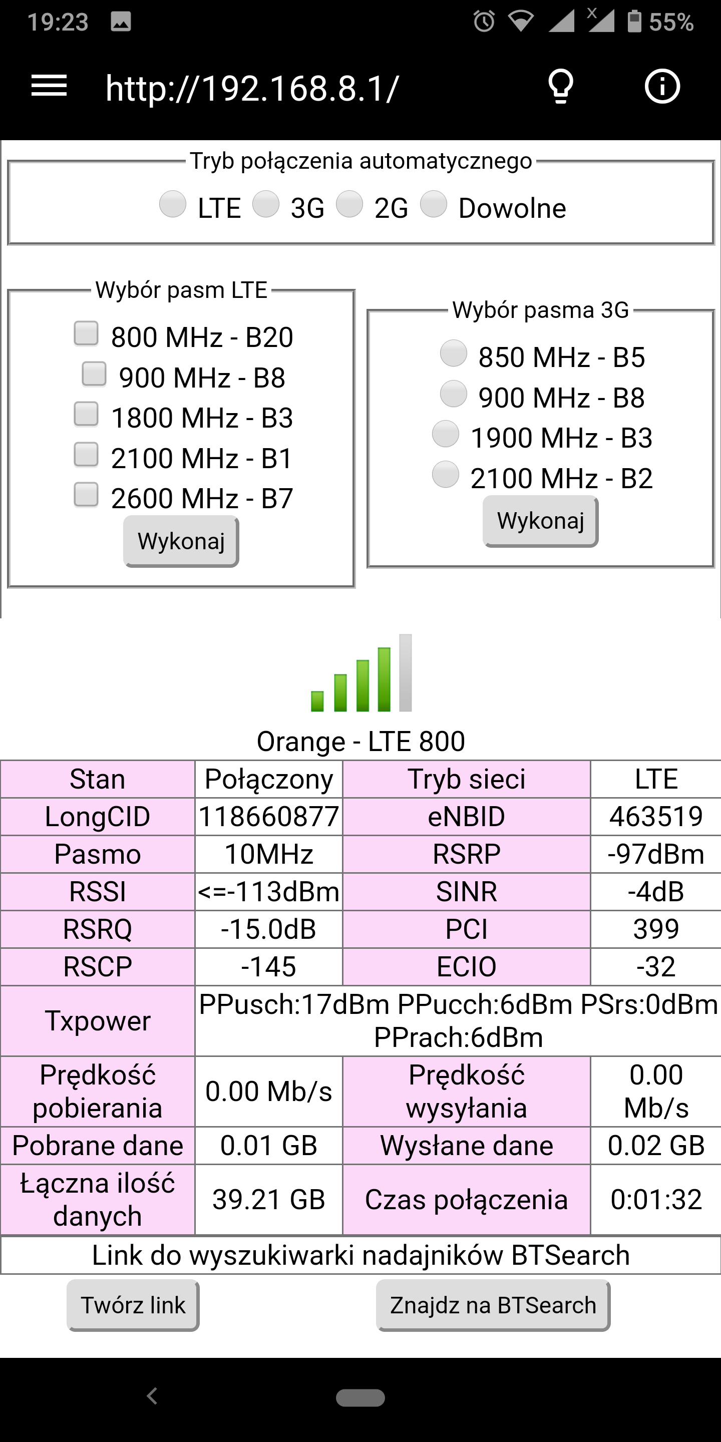

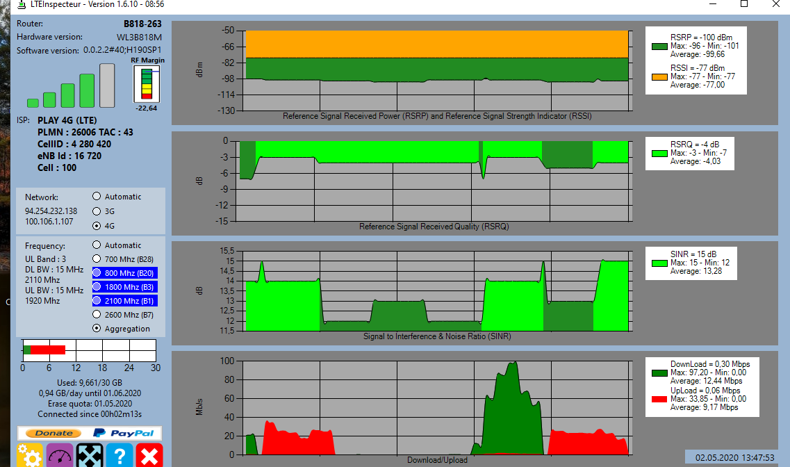

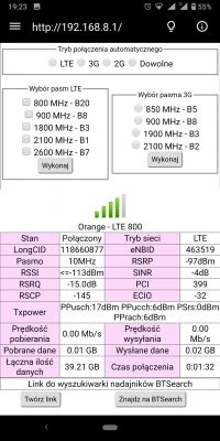

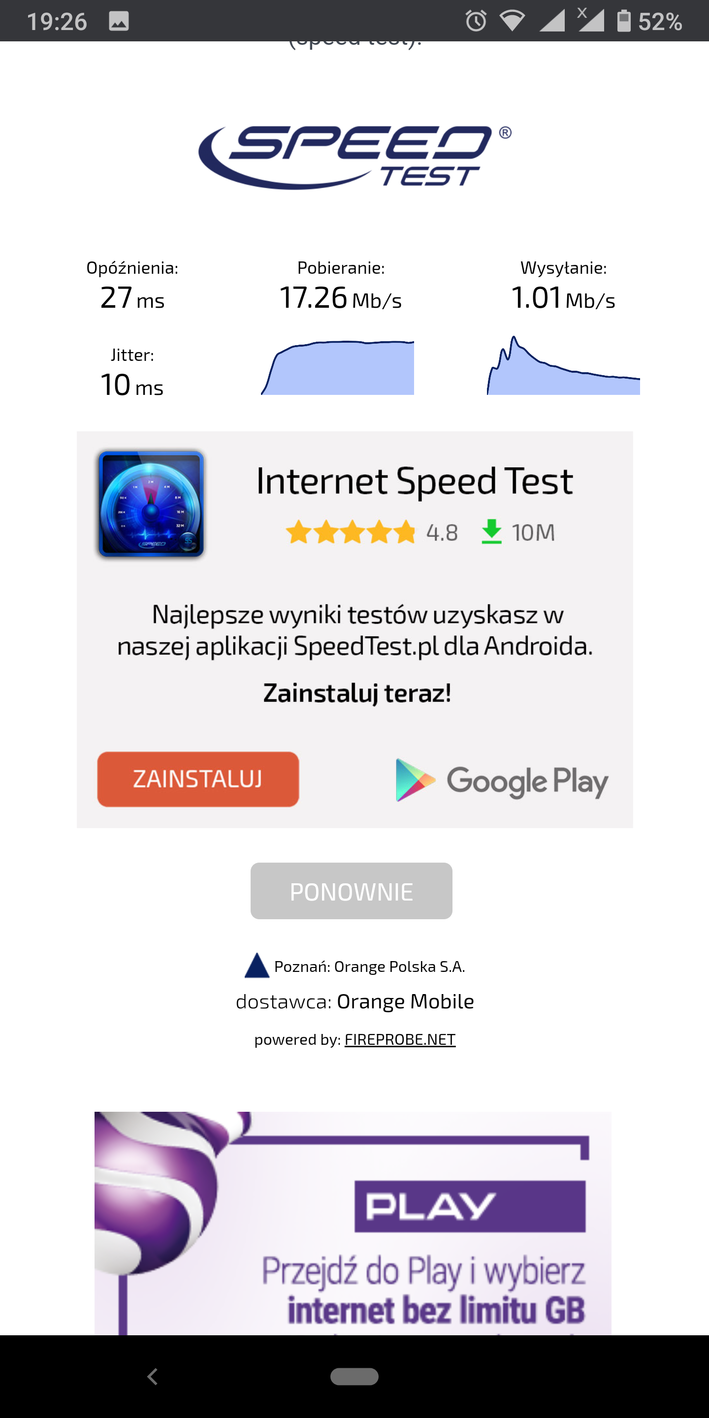

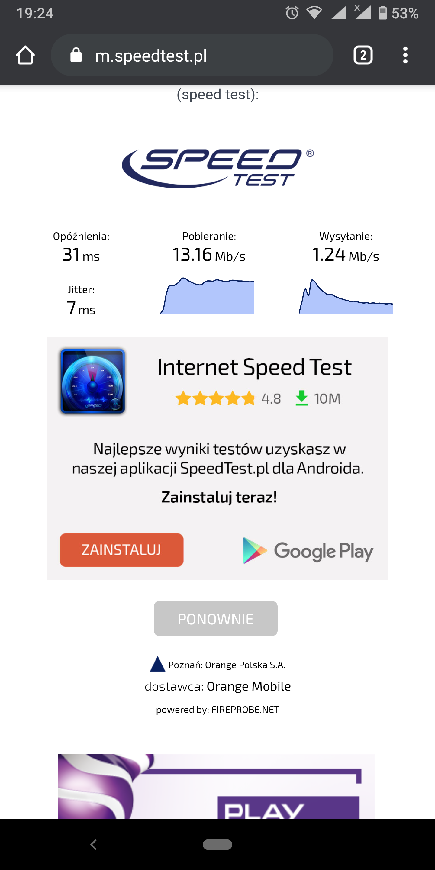

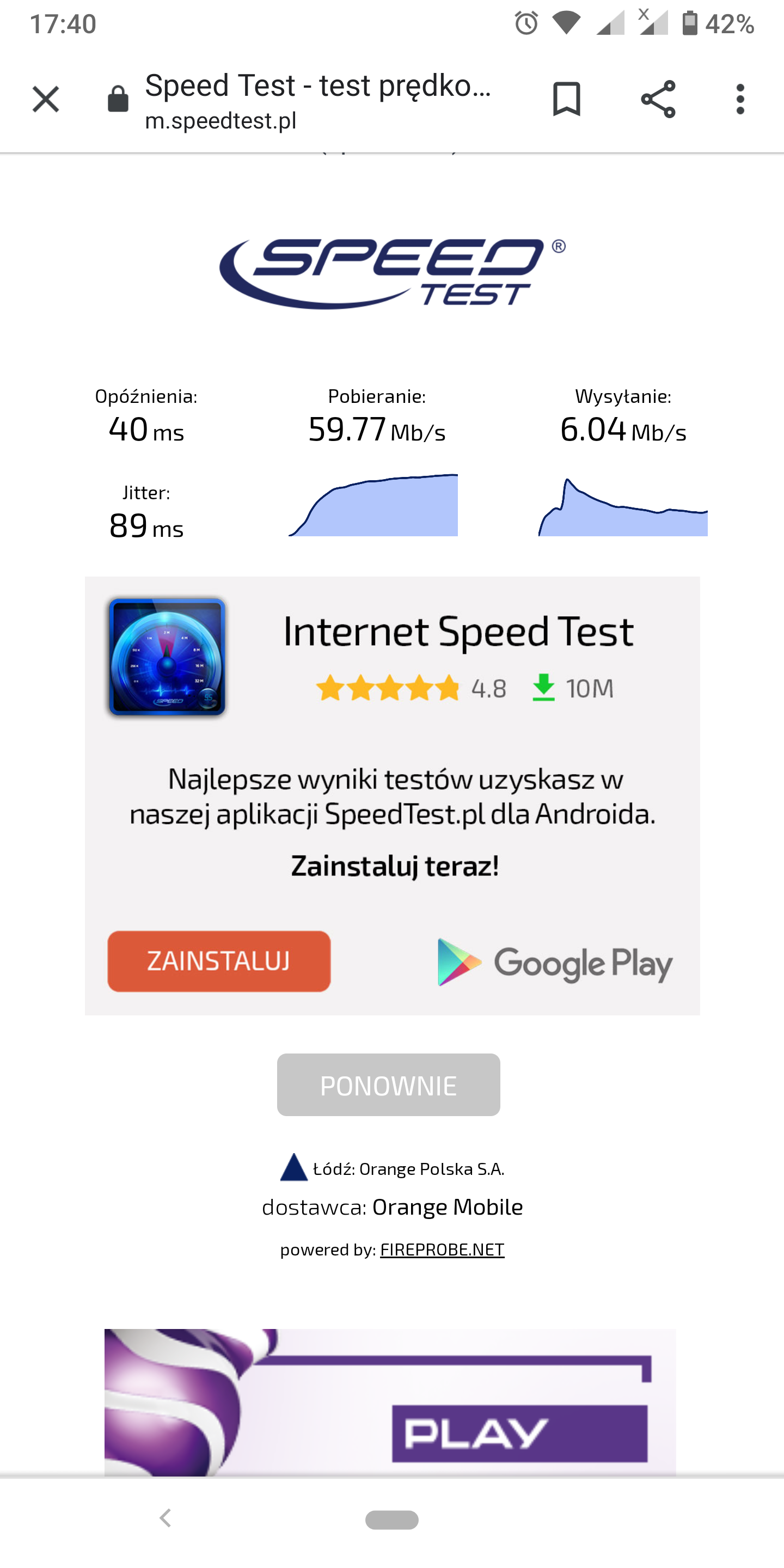

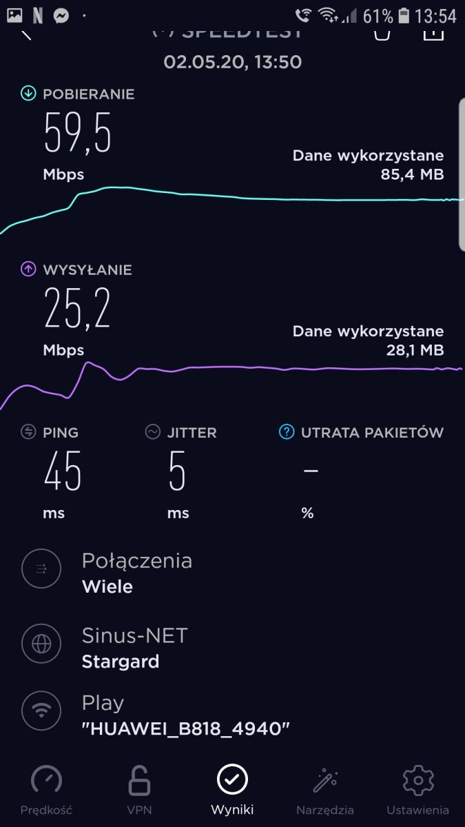

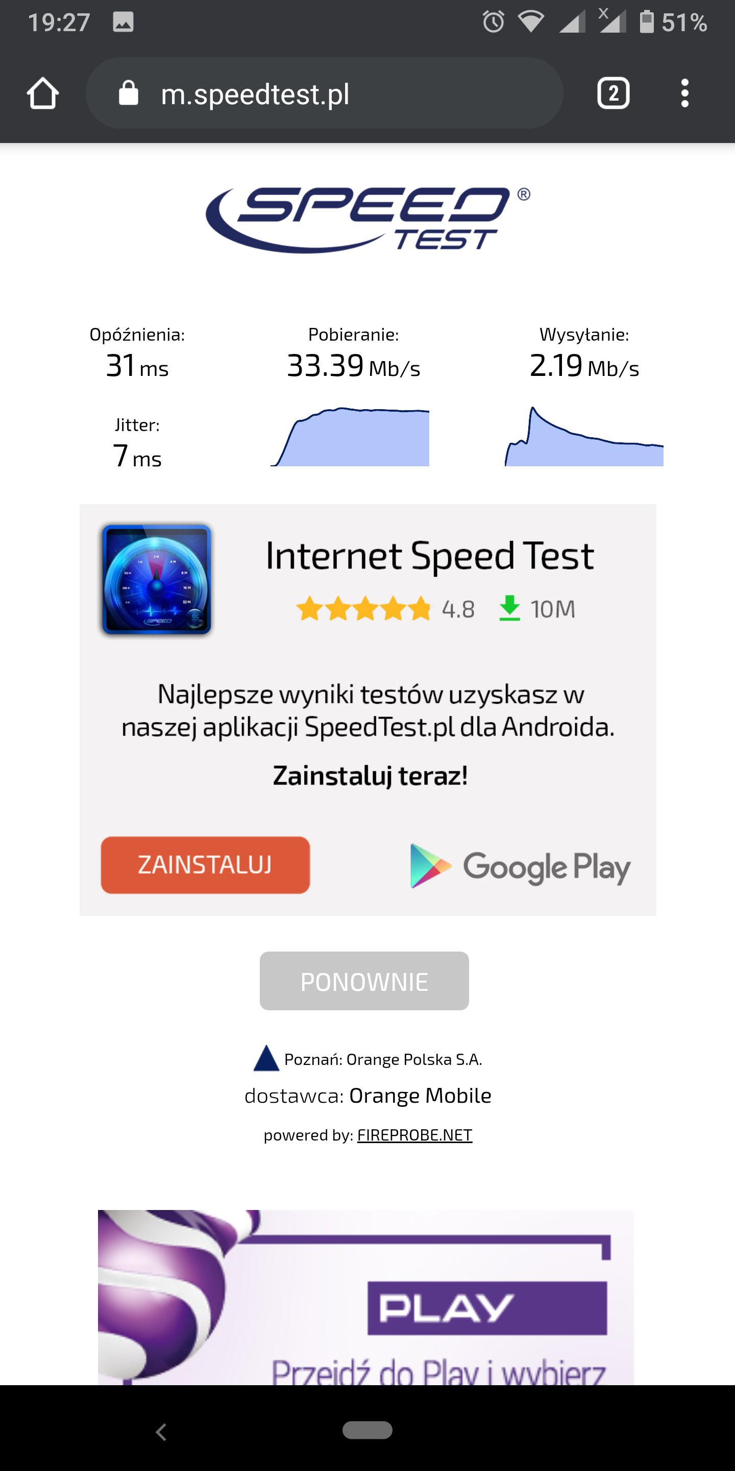

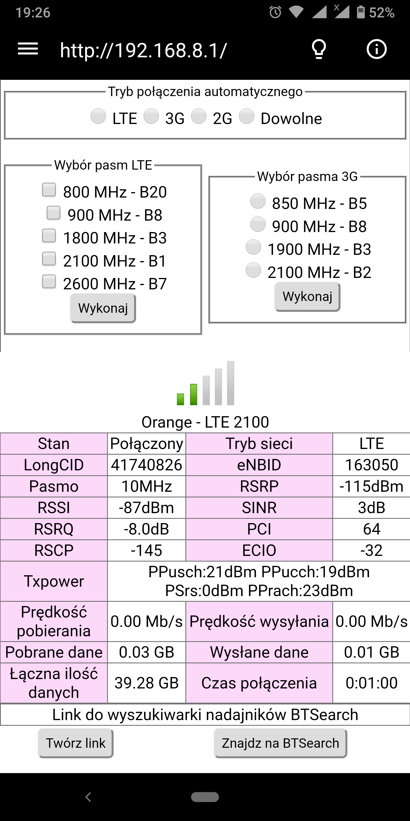

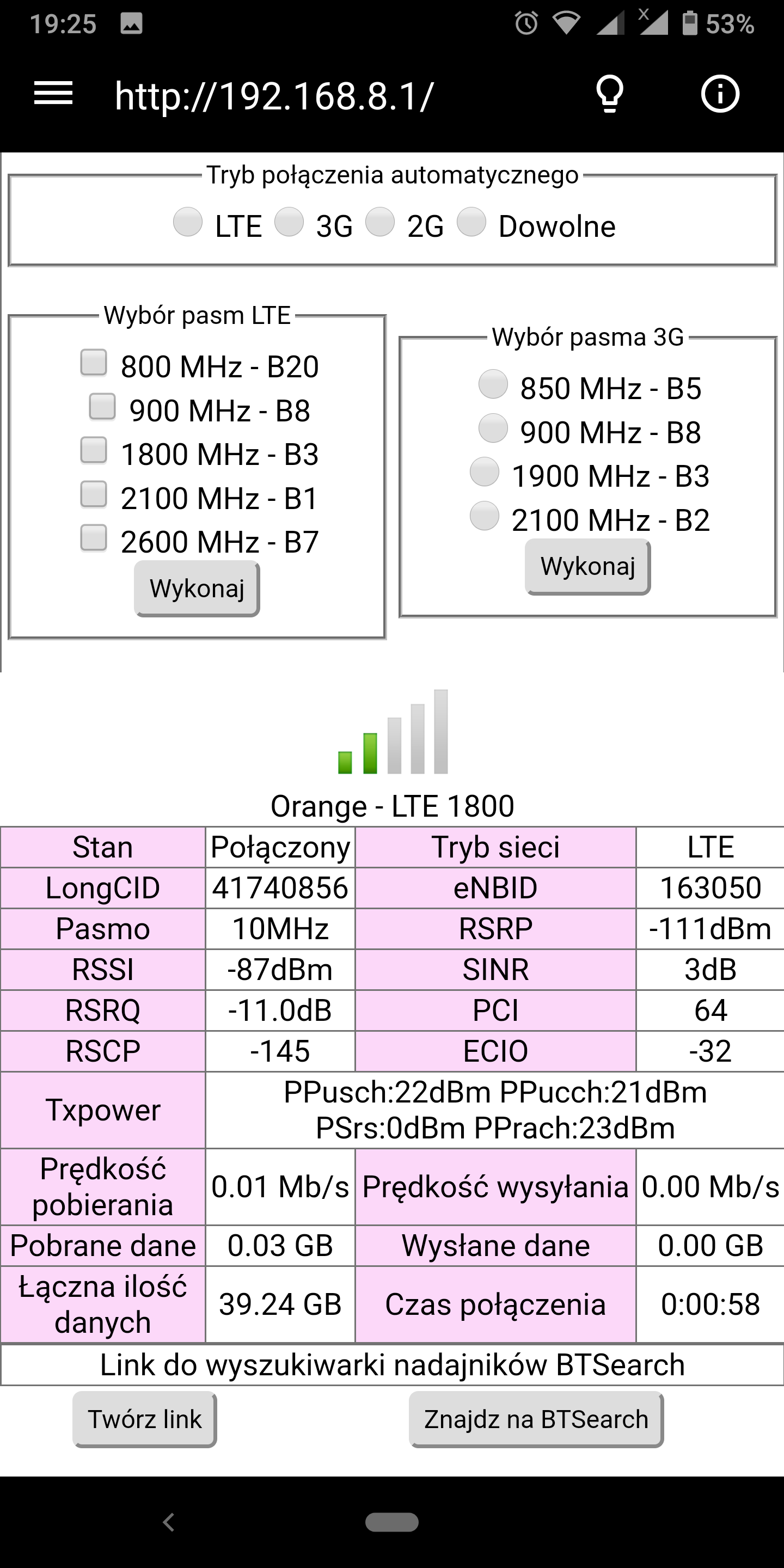

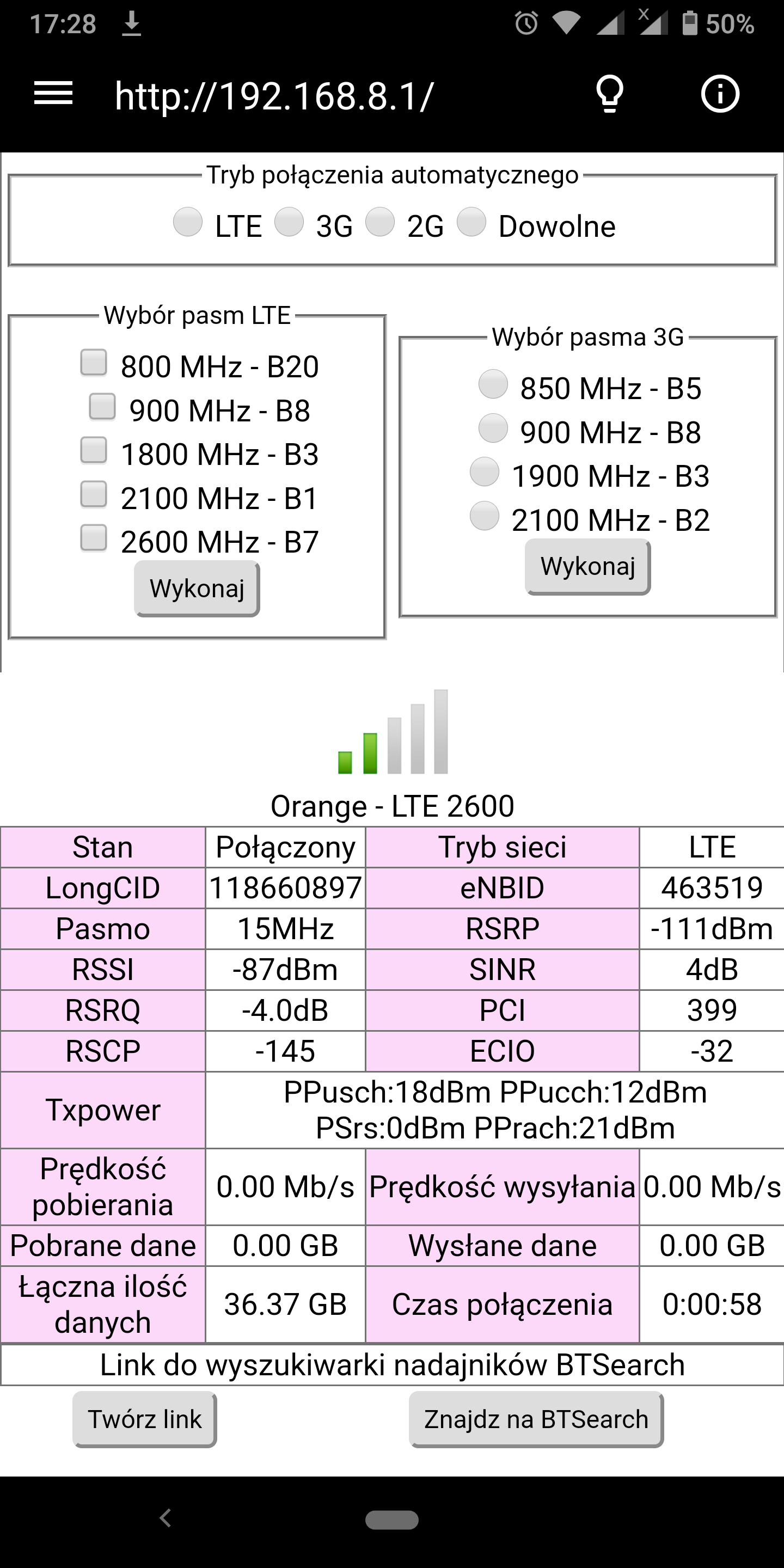

    bebini
    Posts: 14

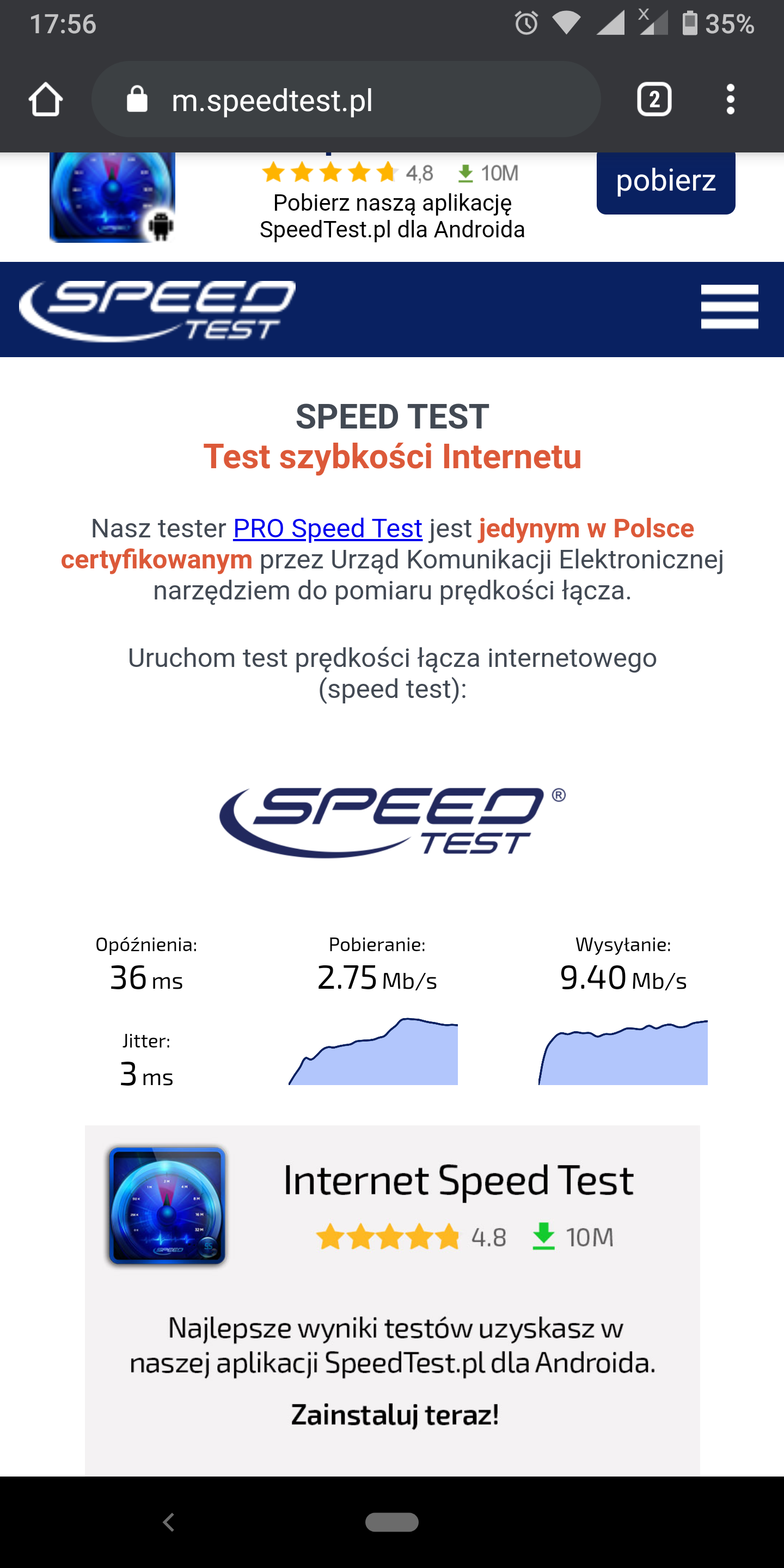

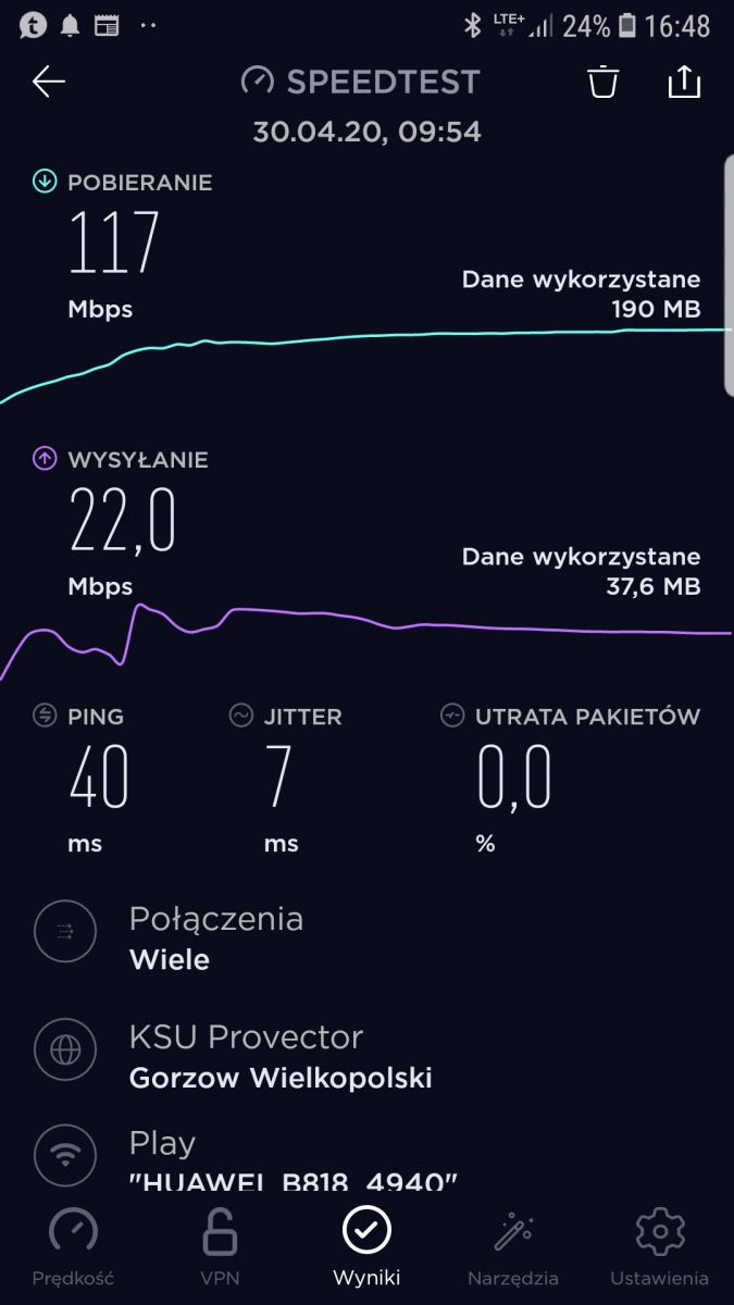

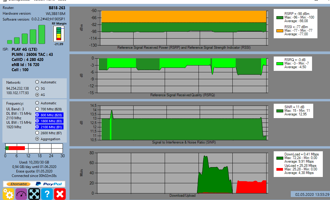

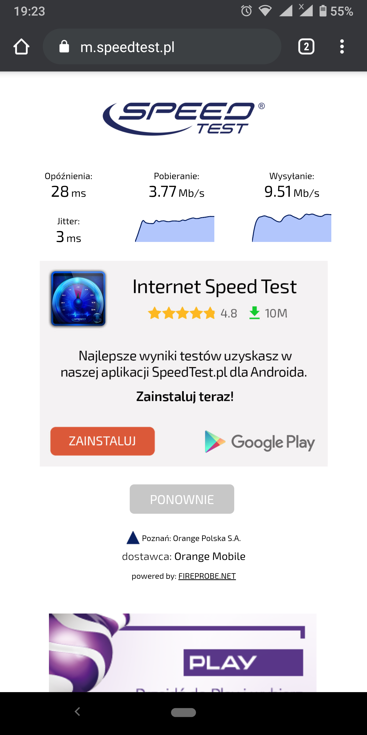

    I re-tested and organized the results a little better this time.
    I would ask for a glance in case these measurements change anything.

    According to my assumptions, the 800 band is overloaded, speedtest confirms it. Other bands OK
    You are buying the antenna from post link # 71 Cable 5-7 meters H155.
