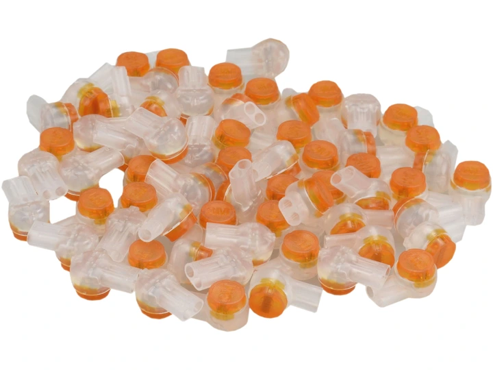

    You can try. 6x0.5 has thinner conductors than twisted pair and you need to check that there will be good contact.
    For permanent connections you can use scotch-locks.
    Added after 57 [seconds]: .
    How to extend Bitner 6x0.5 alarm cable - patch panel or otherwise? .
    Or electrical cubes with screws, but in a version with a sheet between the screw and the cable. You have to look for these, as they are rare.
