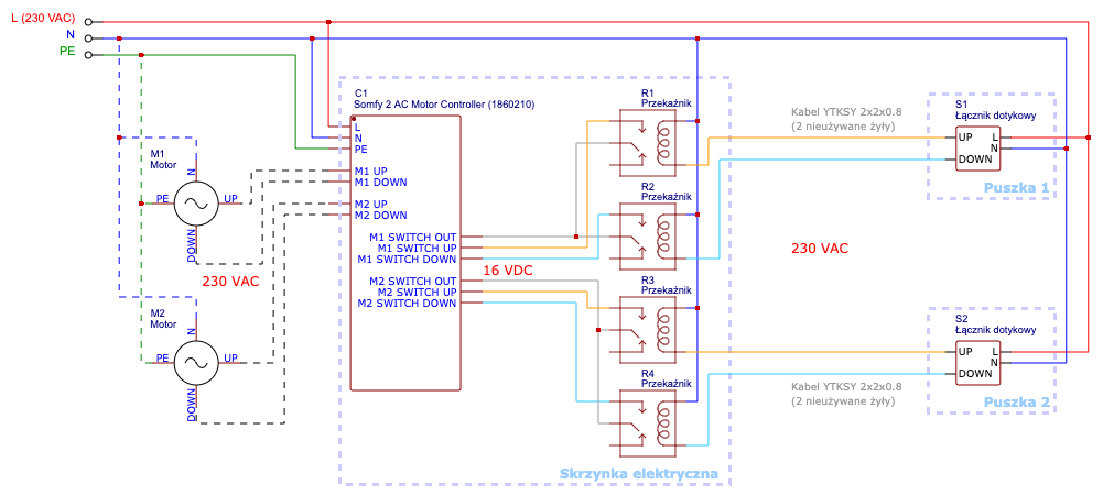

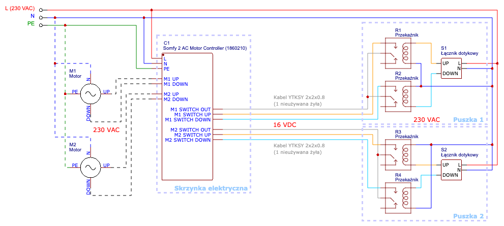

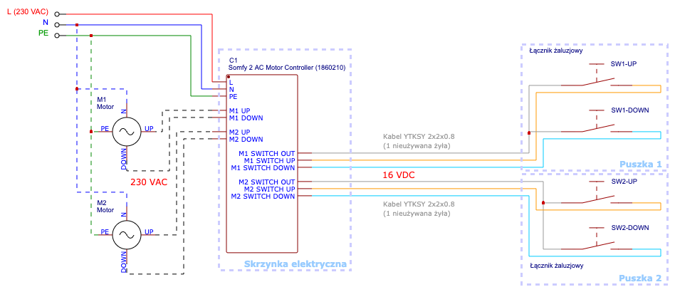

    I am posting some more diagrams illustrating the whole situation.
    The original layout:
    Integrating Touchme TM648 with Somfy 2 AC Motor Controller for Blinds .
    Proposal 1:
    Proposal 2:

    Suggestion #1 is correct in terms of NOT running power through those unfortunate cables. As for the tightness of the installation - if you can't fit in the existing boxes (under the switch) then you can cut out space in the immediate area (e.g. below) for a box for additional relays.
    Added after 22 [minutes]: .
    Something a'la
    https://sklep.avt.pl/avt1733.html?gclid=EAIaI...MImqeXoPHt6QIVTc-yCh3JYwThEAQYAyABEgKZn_D_BwE
    only you need to select similar size relays for 230 Vac.

    It worked – I made the circuit as in the diagram below:
    In the end I used the slightly cheaper but unfortunately also larger relays Zamel PEP-01/230 . Switching works flawlessly.
    Even though I was fortunate that the louvre switches were not installed in individual boxes and I had another box with a lighting switch next to each, it was still quite a challenge to cram everything in.
    Thanks for the advice, I consider the topic closed!
