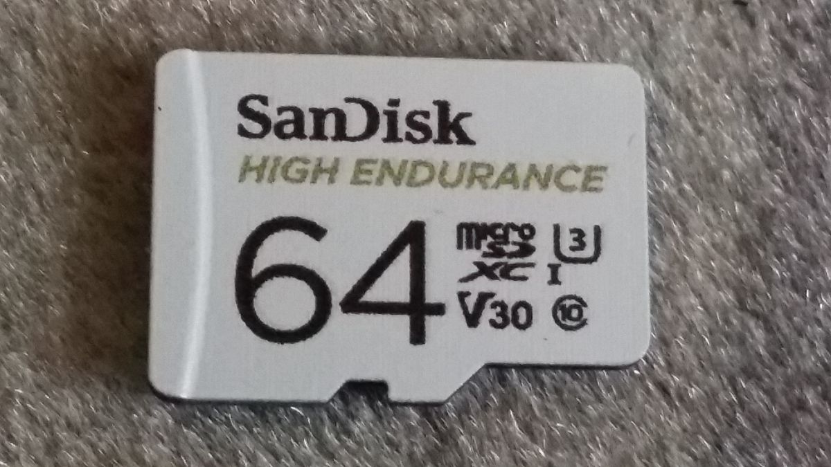

  • 8GB microSD card restores recording and notifications
    #32 19484844
    leotdipl
    Posts: 499
    Help: 51
    Rate: 153
    gradek83 wrote:
    Check on other memory cards not larger than 8GB
    @ gradek83,
    thank you - "hit - sunk" - YES, 8GB *) sees - and there was a formatting option from within CareCamPro - which I did too.
    and
    What's next ? Will the method of formatting (how) the capacity> 8GB solve the problem? I have no idea.
    Interestingly, the camera communicates "OK" right after the greeting. And that's not the case with the 32G and 64GB cards - read below
    *) Kingston micro SDHC class 4 (!)
    Now yes, 8GB is enough for my needs. But what @ gradek83 should I buy,
    since we have higher classes like C10? It may be that despite the capacity of 8G
    this faster class 10 will not see the card?
    I don't want to buy without being sure, because these cards aren't cheap vs. 32 or 64GB.
    ps.
    everything works as it should on the 8GB card, i.e. recording short 30 sec movies
    after "Human Detection" detection - even after power off (which became a problem for 32GB and 64GB cards).
    I have a list of such recordings and can play them. Interestingly, by inserting an 8G card into a PC
    Windows couldn't see the data and asked for formatting (there's some sort of writing system of its own here).
    Re-insertion into the camera after the PC - and all recordings are still available.
    The notifications are also great! The only problem is time. Approx. 5 min. delays.
  • #33 19485210
    gradek83
    Posts: 9107
    Help: 930
    Rate: 2103
    It is possible that maybe the webcam can't handle these faster cards, if the 32 and 64 were the fast ones, maybe it's better to buy the cheaper one, since you don't have 5MP in it anyway. I use such cards for cameras.

  • Class 4 microSD recommended over class 10 cards
    #34 19485241
    leotdipl
    Posts: 499
    Help: 51
    Rate: 153
    gradek83 wrote:
    It is possible that maybe the webcam is not able to deal with faster cards if the 32 and 64 were the fast ones
    @ gradek83,
    thank you for your reply. Yes, this 32GB (Taiwan) and 64GB (Samsung Evo) are class 10.
    So I will. I will not risk it. I will buy 2 Kingston micro SDHC class 4.
    This card of yours is dedicated to cameras and costs as much as 2 8GB cards,
    so 16GB for the price ... 64GB. The interest in such a purchase is definitely not.
    These 3MP webcams, despite the obvious fraud - offered and sold as 5MP - are quite enough.
    I don't have big requirements. It is to oversee, register "alien", and notify. Dot. And it works (!)
    The Kingston micro SDHC class 4 card performs all of these elements (as a whole) first-class.
    Also online video and notification - apart from my WiFi network - works flawlessly.
    To sum up:
    - all functions work as they should. If someone accepts 3MP for the price of PLN 140, - I can only recommend it
    the more that the IR (infrared) works very well.
    - I am not worried about this "deception". I can't digest 4: 3 (that's 1.33)
    and this is the format for 5MP. For these 3MP we have of course 16: 9 (ie 1.78) co
    it suits me insofar as it fills the entire screen of my smartphone, ultrabook or TV-Smart.

  • Kingston Endurance 32GB cards fixed online access issues
    #37 19509839
    leotdipl
    Posts: 499
    Help: 51
    Rate: 153
    skowron72 wrote:
    Generally, webcams are OK because there is RTSP but I have a problem with time synchronization. Setting the time zone does nothing, after restarting the time from Běij?ng. ONVIF DM allows you to set the time manually and it sticks to the reboot of the camera. Any ideas, maybe what am I doing wrong with the settings?
    It would be pointless to set the time manually after each power failure. Under Linux there is python-onvif but somehow it doesn't quite cope with breaking the timezone to "none" so the time to set with crone is also not certain.
    nothing can be done. I gave up (time is over 5 minutes delay).
    ... refresh the thread on the cards in these cameras.
    I bought Kingston Endurance 32GB cards up to 2 cameras.
    From now on, no problems with connecting online,
    and seeing the cards. I will not mention durability in the number of records.
    best regards
