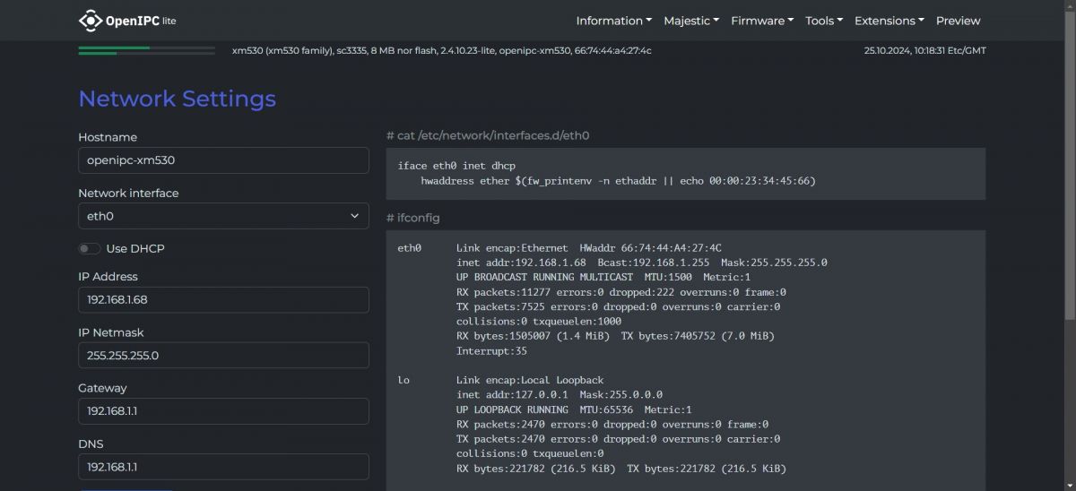

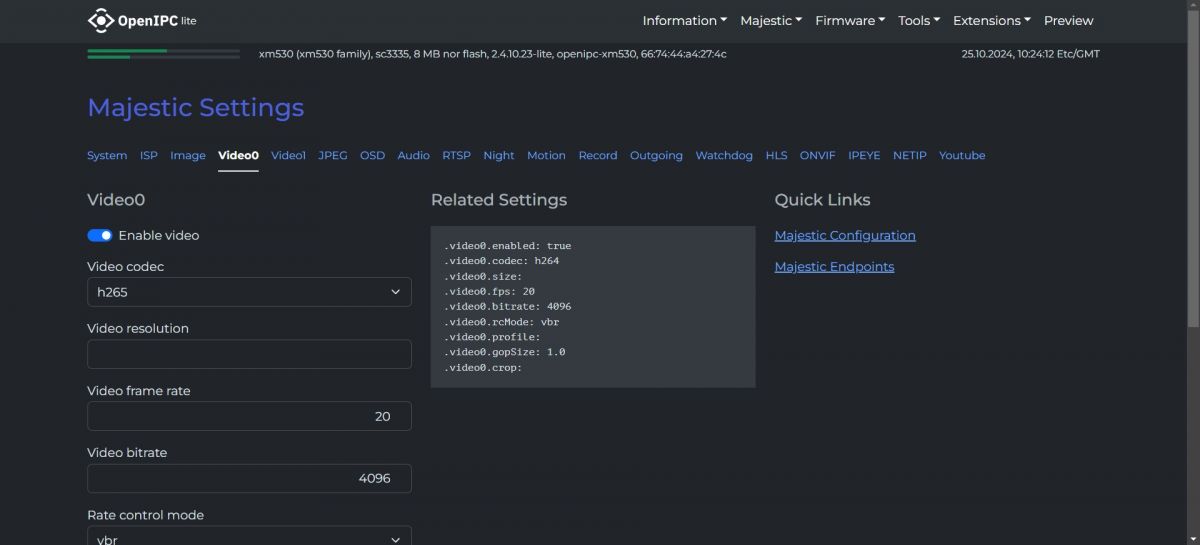

    With time, new possibilities emerge and 'Chinese wonders' can gain a second life. Namely I have successfully uploaded open source software from the openIPC project ( Link ) to a camera based on hardware from the first post , that is a board based on XM530. I uploaded the software to the sd card, and accessed the terminal via a UART connection based on this schema . I then based the instructions on the blog modifying it to use an SD card instead of using TFTP based on these instructions . This boils down to changing the instructions tftp to the instructions fatload mmc 0:1 .
    The camera works, RTSP stream is available and all limitations imposed by the manufacturer of the software disappear (such as the original problem with DHCP) and we gain many additional options, unfortunately the device requires additional configuration as to the specific hardware itself, i.e. setting to which pins of the processor are connected IR LEDs, PTZ motors, etc. The software is still being developed so in time there will be versions of the software ready for a specific camera where you no longer need to configure anything, the list can be checked here . Unfortunately there is still nothing with the XM530 chip at the moment.
    Screenshot of network settings in OpenIPC lite software on a camera with XM530 hardware.
    OpenIPC settings interface with Video0 tab displayed. .

    >>21276178 >>21276178 .
    Thanks for the inspiration. In my case done after TFTP.
    I have a question though, leaving aside IR, PTZ etc, do you have WiFi access perhaps? I don't see in the configuration via HTTP.
  • #65 21366525
    Brayan10
    Posts: 47
    WiFi probably requires additional configuration or drivers, but Ethernet worked fine from the start.
