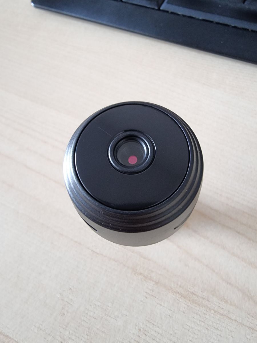

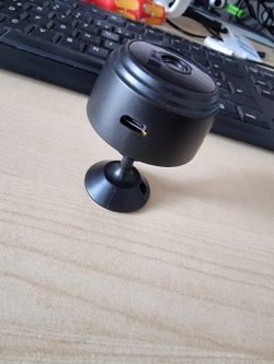

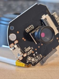

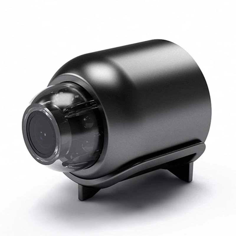

    Hi there,
    I found this tiny 1080p wifi camera on Aliexpress for less than 3€ (https://www.aliexpress.com/item/1005005938598467.html). It comes with an integrated rechargeable battery, the USB port does not seem to do anything else than charging (no data connection).
    Unfortunately, they want you to download and install a fishy app called "FtyCamPro". I would love to use this little cam freely, did anybody already look into it? Considering its price, this is a very interesting piece of hardware, but I do not have the knowledge and experience to remove the bloatware. When you start the cam, it provides a wifi network that you can connect to. It also assigns an IPv4 address, but a portscan did not show anything on the camera. Did anybody already play around with this device?
    Small black Wi-Fi camera on a stand, placed on a desk, with a keyboard in the background. Black, small Wi-Fi 1080p camera on a desk with a keyboard in the background. Small black Wi-Fi camera on a wooden desk.

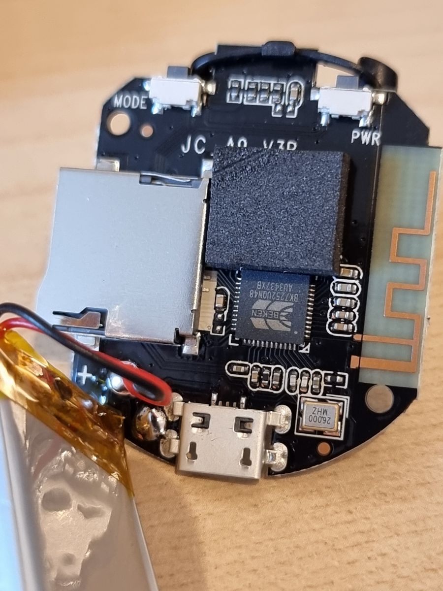

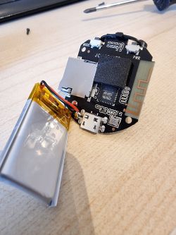

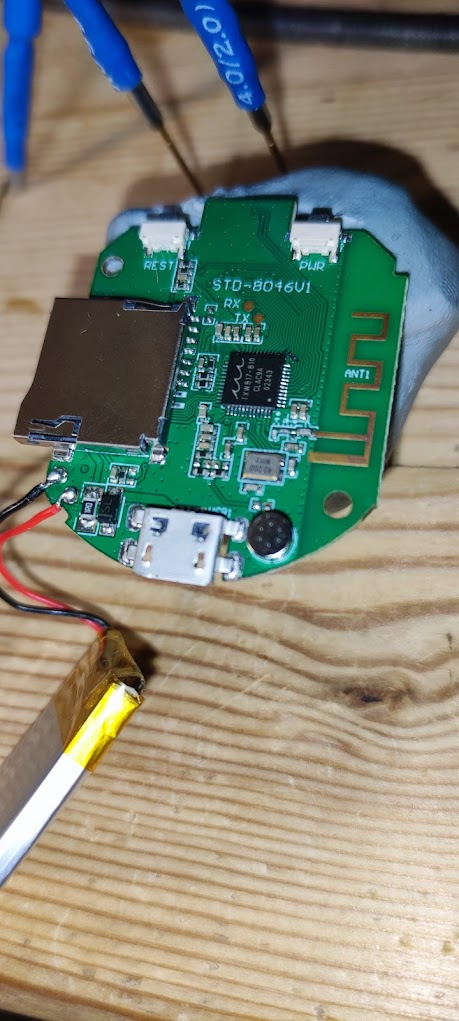

    We've managed to free one cam from the cloud with @DeDaMrAz , but it required opening the case. Is it possible to open the case of this camera without breaking it, and if yes, what kind of chip is inside?
  • Beken BK7252UQN48 chip identified inside camera
    #3 20946175
    Wuppiduppi
    Yes, I managed to open it without destroying anything. The chip is labeled with "Beken BK7252UQN48 AU3437XB". Close-up of an open electronic circuit with visible Beken BK7252UQN48 AU3437XB chip. Close-up of a circuit board with a Beken BK7252UQN48 AU3437XB chip. Close-up of the interior of an electronic device featuring a circuit board with a chip and a camera.

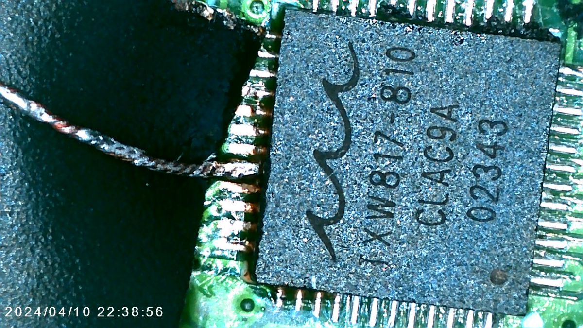

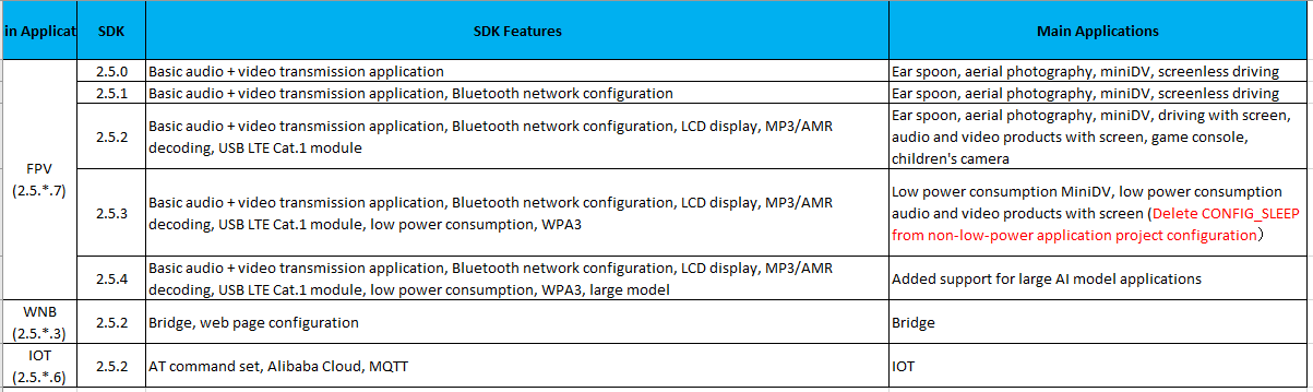

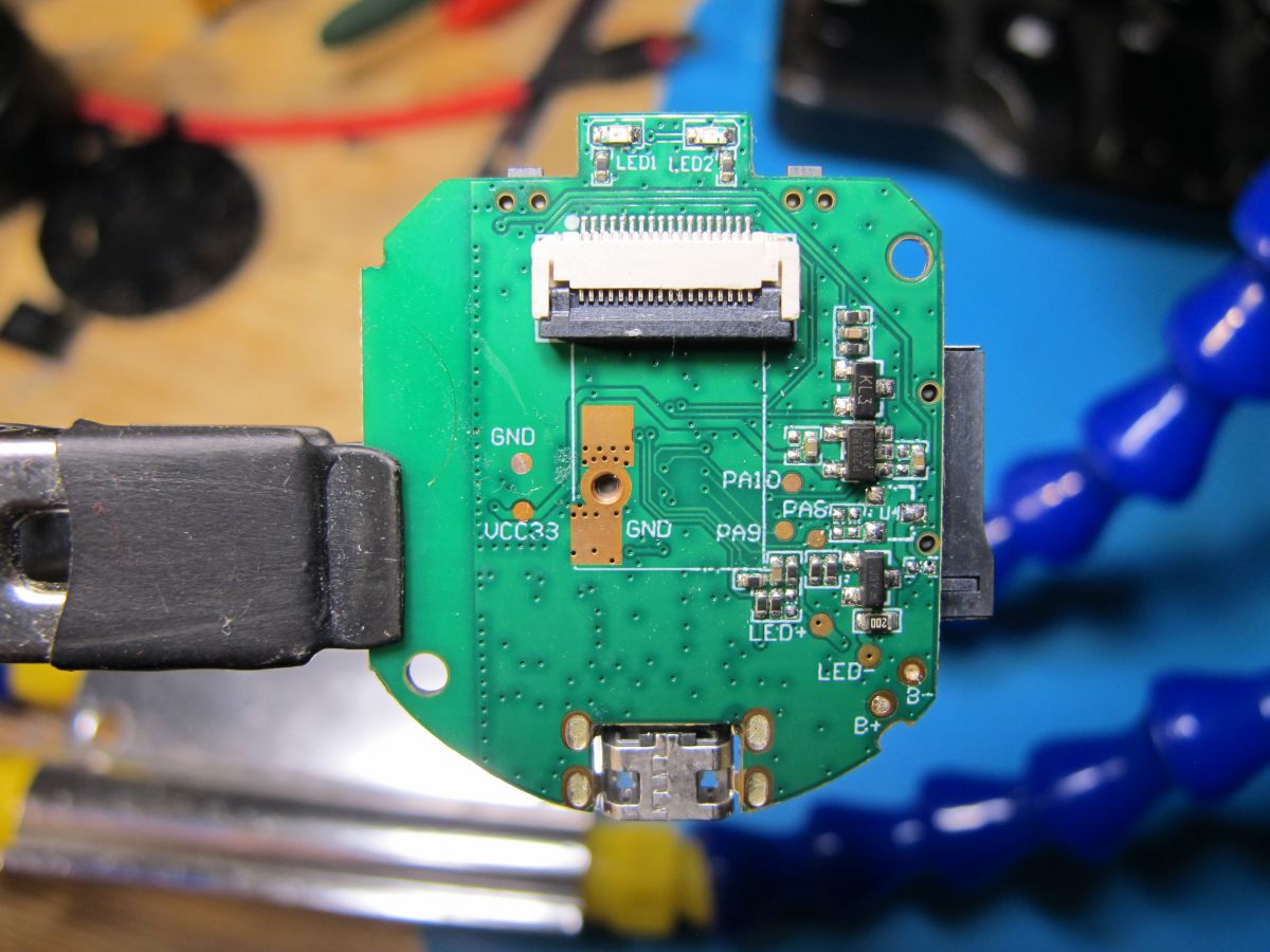

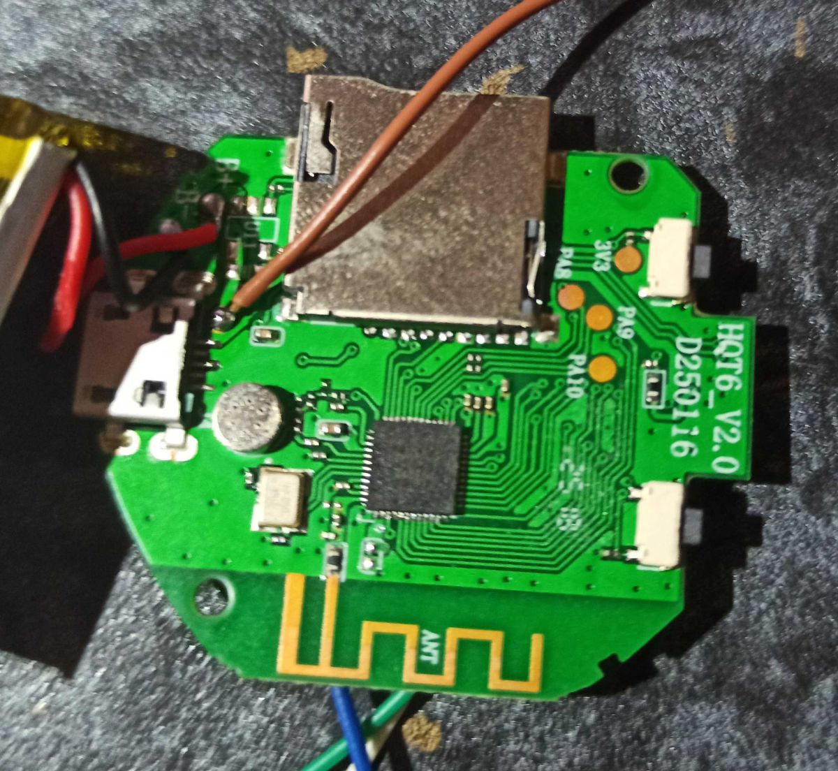

    annoyingly some, including mine, are Taixin TXW817s - https://community.home-assistant.io/t/popular...mini-wi-fi-camera-the-ha-challenge/230108/336
    just seen a reply to my post though https://community.home-assistant.io/t/popular...mini-wi-fi-camera-the-ha-challenge/230108/337
    Close-up of a circuit board with TXW817-810 integrated circuit. Image showing a PCB of an electronic device with connected wires.

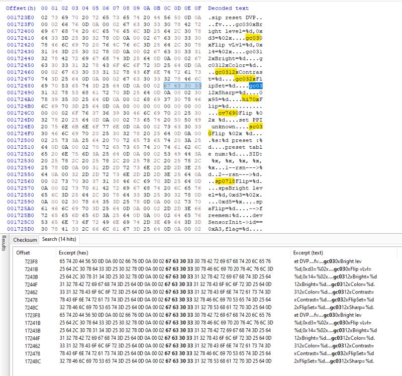

    Added after 53 [minutes]:
    uart boot. 921600 baud

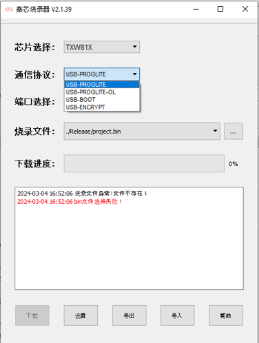

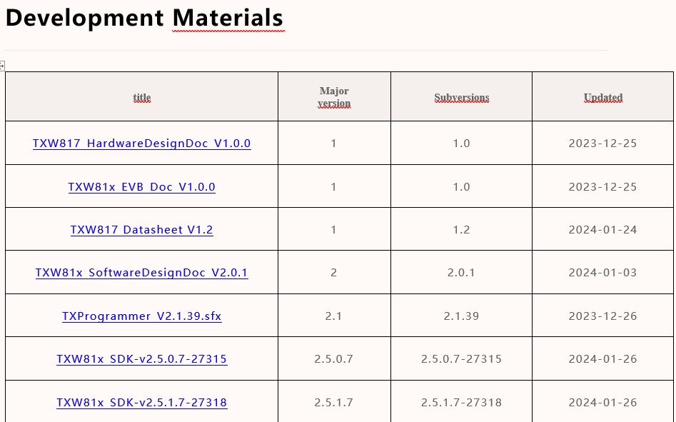

    Not that I know what to do with it, but there is this SDK for download
    Screenshot of a table listing development materials, including documents and software with versions and update dates.
  • #9 20990128
    Posts: 14754
    Rate: 12875
    That's a good find! Is there a flash tool? Can you check whether it's possible to read and write the flash of this chip?
    That "programmer" tool looks like a flash tool.
  • No UART flash options in burner tool
    #10 20990159
    Posts: 5208
    Help: 446
    Rate: 914
    yes. I had a look, but could see no obvious uart flash options. none of the drop-downs in the app reveal any com port settings, Burner PDF in english attached
    Screenshot of software with chip selection TXW81X and file download issue.
    • taixinprog_eng.pdf (4.79 MB) You must be logged in to download this attachment.

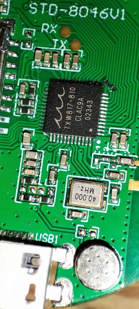

  • QSPI flash wiring attempt on TXW817-810 A9 failed
    #15 21239764
    Posts: 5208
    Help: 446
    Rate: 914
    Regarding the TXW817-810 based A9, I have attempted to use these pads to connect using QSPI/SPI to the internal flash memory
    CS (Pin 1 on CH341A) → PA7 (OSPI_NSS0)
    CLK (Pin 5 on CH341A) → PA8 (QSPI_CLK)
    MOSI (Pin 3 on CH341A) → PA10 (QSPI_IO1)
    MISO (Pin 2 on CH341A) → PA9 (QSPI_IO2)
    Close-up of a printed circuit board with visible traces and electronic components.
    PA7 doesn't seem to be exposed to a test pad. I couldn't find where it traced to, so I very delicately soldered a twisted copper wire (taken from several strands of a de-soldering braid) to the PA7 pin on the IC.
    Image of TXW817-810 chip with a soldered copper wire.
    Sadly no joy with NeoProgrammer. Looking through the Taixin docs there's only mention use of their TX-Link programmer device to write to these chips.

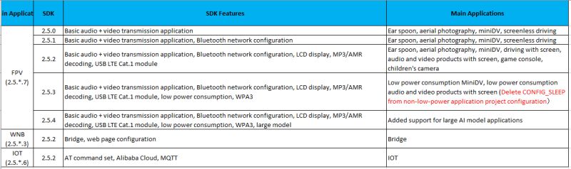

    Comparative table of different SDK versions with features and main applications.
    • TXW81x_FPV-v2.5.4.7-33915_20250414095601.zip (23.54 MB) You must be logged in to download this attachment.
    • TXW81x_IOT-v2.5.2.6-31320_20241106091716.zip (10.08 MB) You must be logged in to download this attachment.
    • TXW81x_FPV-v2.5.3.7-33908_20250414095532.zip (23.75 MB) You must be logged in to download this attachment.
    • TXW81x_FPV-v2.5.2.7-31320_20241106091643.zip (16.96 MB) You must be logged in to download this attachment.
    • TXW81x_SoftwareDesignDoc_V2.0.4_20250410113540.zip (24.44 MB) You must be logged in to download this attachment.
    • TXW81x_FPV-v2.5.0.7-31060_20241021174704.zip (14.01 MB) You must be logged in to download this attachment.

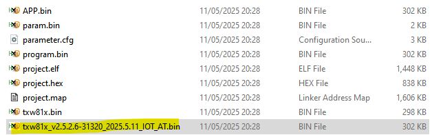

    TXW81x AT demo from IOT SDK - built with CDK
    Screenshot of a folder containing binary and configuration files for the TXW81x AT demo project built with IOT SDK, with the file “txw81x_v2.5.2.6-31320_2025.5.11_IOT_AT.bin” highlighted.
    • txw81x_v2.5.2.6-31320_2025.5.11_IOT_AT.zip (1.81 MB) You must be logged in to download this attachment.
  • #19 21546604
    Posts: 14754
    Rate: 12875
    That's good news, how did you compile it?

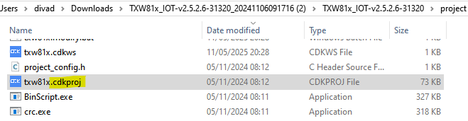

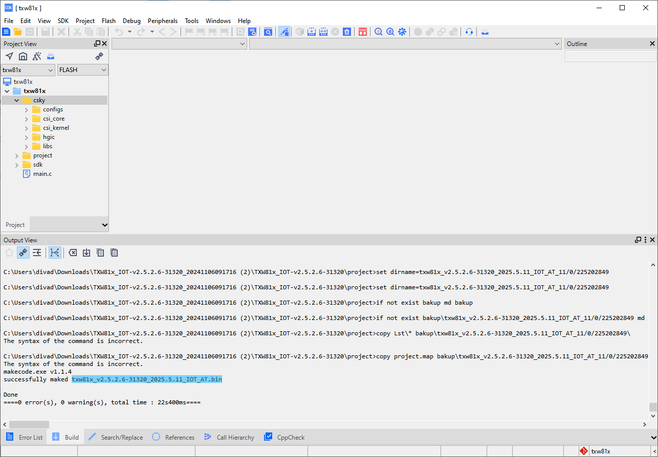

  • CDK builds TXW81x SDK projects directly
    #20 21546674
    Posts: 5208
    Help: 446
    Rate: 914

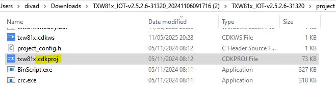

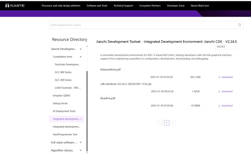

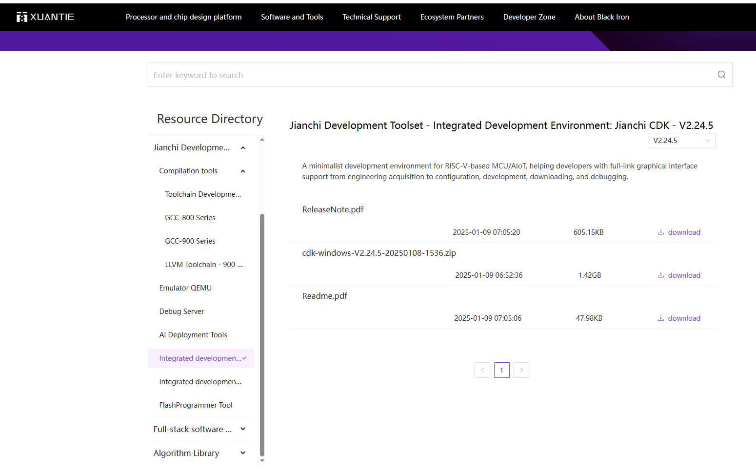

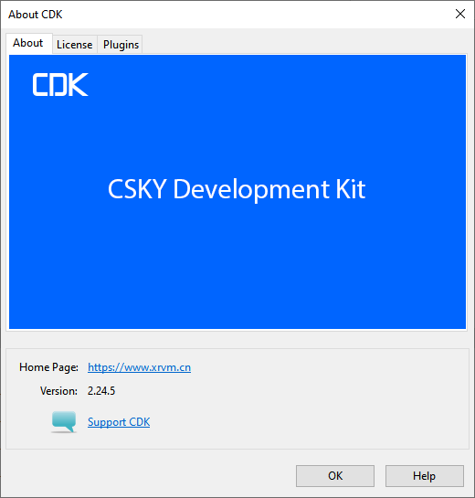

    CDK - C-SKY Development Kit can be downloaded from the same xrvm.cn XuanTie download pages as the CK804/W80x toolchain bits mentioned in the W806 thread starting here https://www.elektroda.com/rtvforum/topic4054074-30.html#21534187
    https://www.xrvm.cn/community/download?id=4397799570420076544
    Website download panel for Jianchi CDK tools, listing available files and download links.
    About window of CSKY Development Kit showing version 2.24.5.
    Like the W806 zip file provided by YourCee, the Taixin TXW81x IoT SDK download contains a .cdkproj file for opening with CDK
    Windows Explorer window showing project files in the TXW81x_IOT software folder.
    Then it just builds through menu Project -> Build Active Project
    Screenshot of an IDE showing a project tree, folder structure, and build log output.

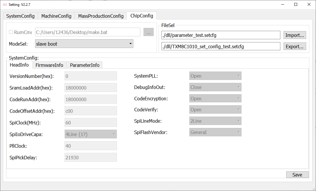

    >>20990159

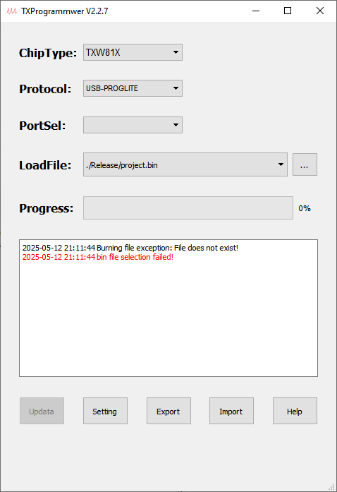

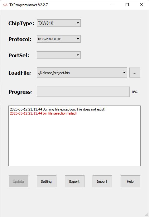

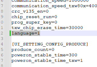

    TXProgrammer can be put into English by changing the language value in config.cfg under TXProgrammer\dll to "1"
    A fragment of a configuration file with setting parameters in a text editor.
    Screenshot of the TXProgrammer V2.2.7 application showing a bin file selection error message.
    A configuration software window displaying system and microcontroller parameters.
  • CK-Link access and 2 MB flash dump from TXW817-810 camera
    #22 21558806
    Posts: 5208
    Help: 446
    Rate: 914
    divadiow wrote:
    I was hoping it's just a CK-Link rebrand device. Maybe it is and I haven't got the process right with CK-Link. I ordered one from Taobao so that should arrive in a couple of weeks.
    This arrived but was not needed for flash read/write in the end.
    CK-Link:

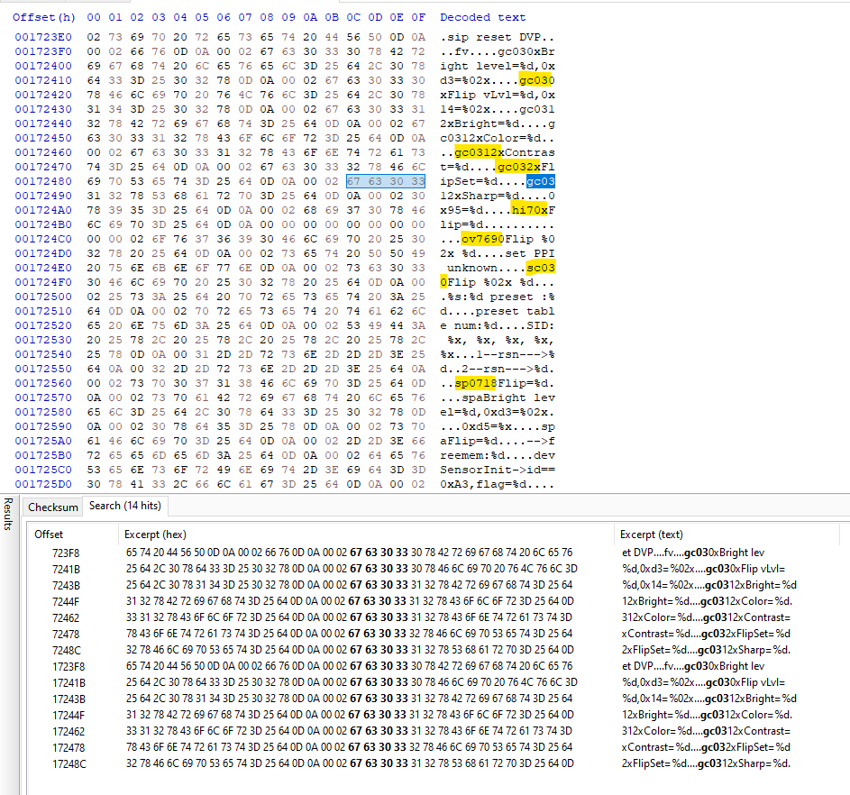

    and a 2mb dump, perhaps the world's first from one these TXW-based cams. This is from the X5 'barrel' type of TXW817-810.
    Black modern car camera in a sleek case on a white background.
    I've not explored it much yet but I attach the dump
    We can already see the cam sensors this has drivers for
    Screenshot of a hex editor showing binary data and decoded text with highlighted phrases.
    • X5_MiniCam_TXW817-810_CK803.bin (2 MB) You must be logged in to download this attachment.

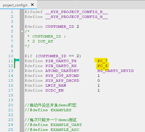

  • LVD fault during TXW817-810 demo boot
    #23 21559929
    Posts: 5208
    Help: 446
    Rate: 914
    >>21546674
    and now that demo running on a TXW817-810
    UART changed to PC6/7 which are exposed as test pads on cam PCB. Previously PA1/PA2
    Screenshot of the project_config.h configuration file with highlighted lines defining UART0 pins as PC_7 and PC_6.

    #26 21639247
    sebek2435
    Posts: 14
    I did some digging in the demos you provided in >>21527312
    After looking at the IoT demo yesterday I couldn't find anything camera related (though I could be wrong). So instead I decided today to try looking into the FPV demos and they seem to be a better fit for the board. I went with the FPV-v2.5.0.7 SDK since I don't think most of these chips have Bluetooth (correct me if I'm wrong. I have seen some of these cameras using Bluetooth but I don't know what chip they used.) and these demos support RTSP.
    I think I have correctly or mostly correctly configured it for my board but I'm honestly not 100% sure and cannot yet test since I don't have the debugger for now.
    I will provide the bin file here in case you wanted to test it. The Wi-Fi settings I set were SSID: Wifi_Cam_Test Password: 12345678 and the camera should stream to [camera-ip]/liveFeed or [camera-ip]:7070/liveFeed
    Here is a picture of my board in case you wanted to compare the pinouts:
    HQT6_V2.0 PCB with labeled pins, microSD slot, chip components, and PCB antenna
    If you decide to test it then have fun, I will report on my own findings/testing once I have my debugger.
    • txw81x_fpv_v2.5.0.7-31060_2025.8.19_.bin (396.02 KB) You must be logged in to download this attachment.

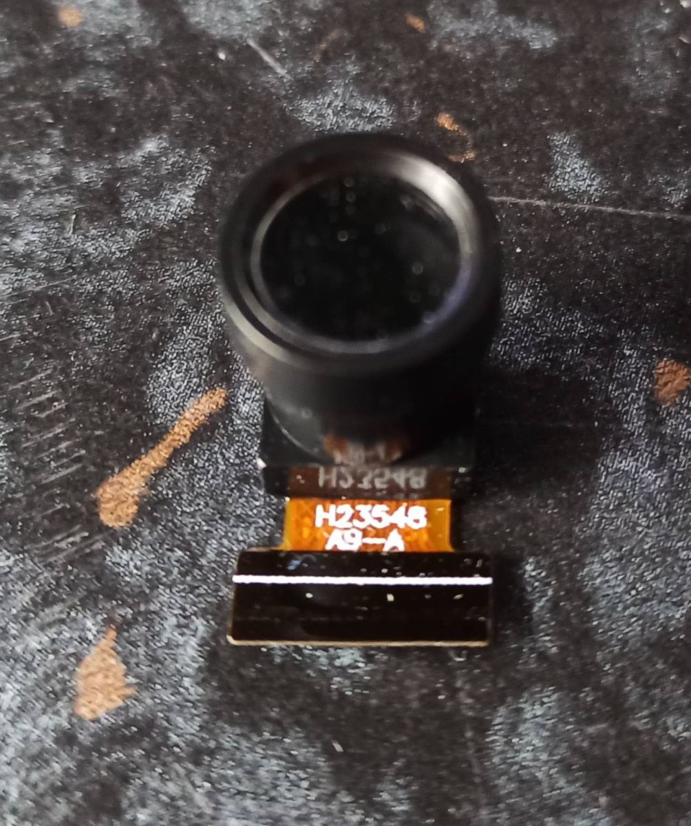

    #28 21639665
    sebek2435
    Posts: 14
    The default was set to gc0308 and ov2640 and I think the code auto detects and selects the camera. I could change that to whatever camera you want and recompile.
    This is the cam I have though I'm not sure what it is exactly. The closest thing in your list seems to be the SP0828.
    Camera module with lens and H23548 marking on flexible ribbon cable
    Added after 24 [minutes]:
    Here's a build with the GC0329 added. My list of supported cameras seems to be shorter than the one you provided probably since it's an older SDK?
    • txw81x_fpv_v2.5.0.7-31060_2025.8.20_.bin (396.02 KB) You must be logged in to download this attachment.
    the list in post 1 here? https://www.elektroda.com/rtvforum/topic4121965.html
    that's from an XF16 firmware dump. I've been using an XF16 A9 cam to identify various 18-pin sensors from all these types of cam. They seem interchangeable
  • Enabled DCDC and removed __NO_BOARD_INIT for booting
    #30 21644074
    sebek2435
    Posts: 14
    I have already set the TX and RX to PC7, PC6 and baud rate is set to 921600. I just enabled DCDC, might be needed for these boards. I also removed __NO_BOARD_INIT from the compiler in case it was stopping the board from booting.
    Also the LEDs might not work since I don't think they were defined in the SDK. There is some code and I tried writing some basing it on the code around it but it didn't work so I removed it.
    Here's the new build and the project.
