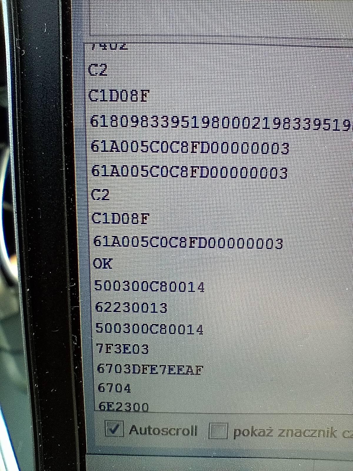

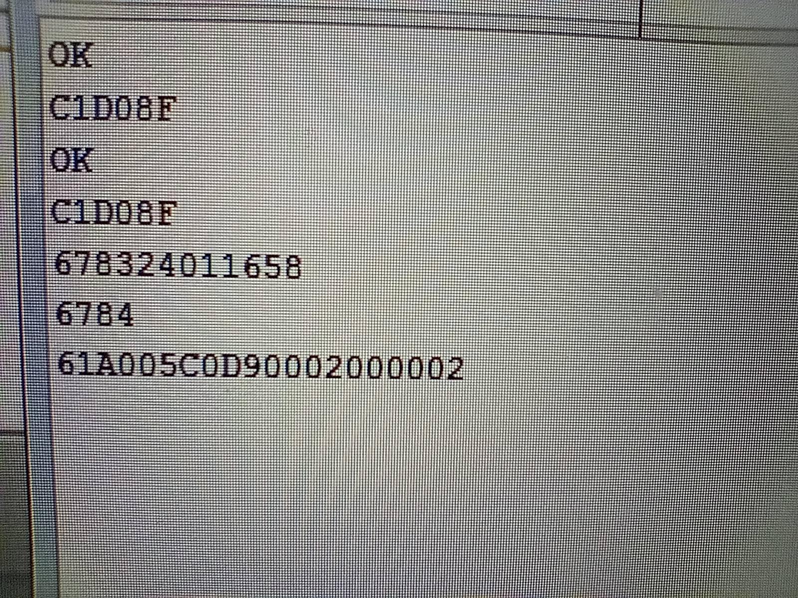

  • ParkAssist activation by swapping D9 to C8
    #272 20210901
    macinek102
    Posts: 6
    bbmax wrote:
    Generally, this is another way to encode with an offline diagbox, even a secured ecu (requiring connection to the server) will describe it in my free time :) but I think I'll do another thread so as not to mix here ...
    macinek102 wrote:
    glapsson wrote:
    Program corrected
    Below is an instruction on how to start ParkAssist
    or how to activate semi-automatic parking on a Peugeot 3008 II or 5008 II
    and I do not exclude that also in other models.
    Hi
    can you suggest which zone to change in the power steering in semi-automatic parking?
    Nac on, Bsi too, park module too, but my DG won't move the steering wheel and I have to do Arduino.
    Thanks
    give your configuration frame from this ecu what to do you can't count you crc and send yourself :)
    in fact, you will be able to count yourself because I will tell you where and how :)
    Thanks, but I made it :)
    I swapped D9 for C8
