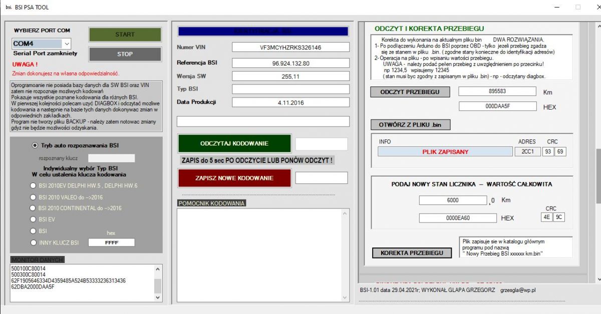

  • Telecoding software can save encoding to file
    #63 19422442
    glapsson
    Electronics specialist
    Posts: 557
    Help: 11
    Rate: 645
    Well, it sounds better now.
    Regards
    I like to get dirty sometimes.
    I did some sedation again on the program.
    There is a function of saving the encoding to a file.
    Help tab, some bells and whistles in the form of messages ....
    And a toolbox from which you can code any module - even one that is not on the list, as long as you know the encryption and key.

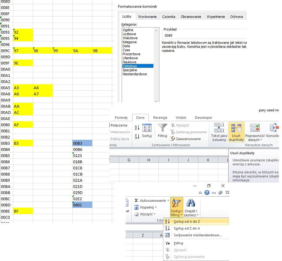

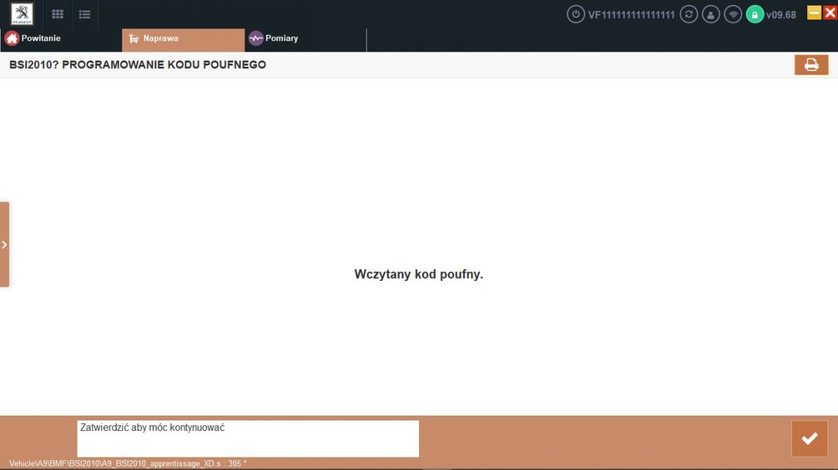

    SEARCHING FOR THE CODING KEY
    If anyone is interested, please read slowly and carefully ... because there are probably a lot of my mental shortcuts .. but people who already have some knowledge in the subject and excel are not foreign to them - they will not require an extension of this description.
    For the others, it will probably be necessary to create a film ... because it's hard to illustrate only with a description.
    It's not that simple - if we don't have any SEED coding pair.
    But it can be done.
    I am just after the search for the key for coding the Autoliv c3III pillow sensor - the same for the 3008 II, etc.
    And here to the moderator --- even the manufacturer allows coding the steering wheel page left right.
    that is, coding this parameter we do not act against the law.
    So please do not close or block - for photo proof:

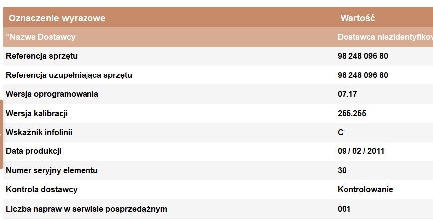

    BSI DELPHI series EL HW D6 - TELECODING READING BSI peugeot 208 II corsa F
    Another thing, the AIRBAG sensor was used here as a teaching aid to illustrate the operation.
    ATTENTION - which is important in this and probably in other controllers (ASS, ABS, AIRBAG ... these block at 100%)
    WHEN ENTERING A ERROR KEY, THE CONTROLLER IS BLOCKED !!!
    After blocking - it is not possible to generate SEED, i.e. the next encoding.
    BUT the driver works normally - we won't break anything except the fact that the fun with coding is over at the very start.
    So, before we start looking for the encoding key in such a driver, it is worth having a backup copy of the batch.
    there was no problem with the airbag sensor.
    After each wrong key, the sensor should be programmed with the output batch, because as I mentioned, it is impossible to trigger another SEED after the wrong SEEDKEY.
    Once we have it, we can start the game of looking for the key.
    Here is a description of how I approached it - maybe it's a longer way, maybe not ... I don't know - so far the only one for me.
    STAGE I version 1
    I take a pack of random keys or more ... I started with 20 random keys. (range 0000 to FFFF)
    of which are the two worth including in this package.
    And I'm starting testing on SEED SEEDKEY.
    we complete NON-OPERATING pairs - in order to rule out invalid keys.
    e.g.
    A0975BD3
    29FF774B
    11734302
    46BE36DF
    CEB81F58
    15F67BEF
    3CFCCD8A
    457333FD
    B907B220
    3FFB3FFF
    e.t.c.......
    As I wrote before, for some SEED SEEDKEY pairs, there may be from a few to several hundred keys or even several thousand keys.
    So if the key from the first 20 package does not work for us, it excludes quite a lot of other keys from the machine.
    I did a little redo my applet to generate the list of invalid keys faster (I need to fine-tune it - so it is not available for download at the moment - I used the console option) but what is possible to do it, although the process is quite slow - Generate SEEDKEY save all broken keys for given broken SEED SEEDKEY pair.
    And here I will refer to the further part of the description - if we do not have the ability to generate a list of all wrong keys, I would use the method mentioned later, i.e. we test the keys one by one 0d 0000 and sample each key several times for different SEEDs called.
    We are left to write down, for example, the first 100 or 200 keys and a bit of luck and a lot of stubbornness. (i.e. STAGE I version 2)
    I would like to add that all the keys are 65,535 pcs - so it's hard to hit ...... but it happens that we can hit a working key at the beginning (this is what happened to me when playing with BSI continental) and then we go to stage II - if we are satisfied it won't work, we repeat the operation for all 20 random keys.
    After these 20 keys, if we do not have any working pair, we collect all these keys to one list .. eg in Excel - we exclude duplicate keys (and it may turn out that we have about 5,000 keys that will not work - using only 20 seed seedkey pairs).
    it looks something like this - a snippet (there are several hundred of them ... but this is more or less what it looks like at the top of the list):
    0002
    0005
    000E
    0011
    0023
    0029
    002F
    0030
    0031
    0033
    0034
    0035
    0036
    0038
    003D
    003F
    0040
    0040
    0042
    0049
    004A
    ....... etc (several hundred, several thousand)
    now we can start driving successively from 0001 (unless it is on the list, it is the first one that is not available)
    as above 0001, 0003, 0004, 0006 ... etc
    we do another 10 - we generate SEED SEED KEY pairs - we find the keys for them and add them to our list (sort, exclude repeaters in excel etc.)
    It can be done on the basis of one program (someone ambitious may write it) ... but I don't want to write it - because excel will do it too.
    we set the column to text - because we use hex notation
    we remove duplicates
    we sort for a better search for free keys

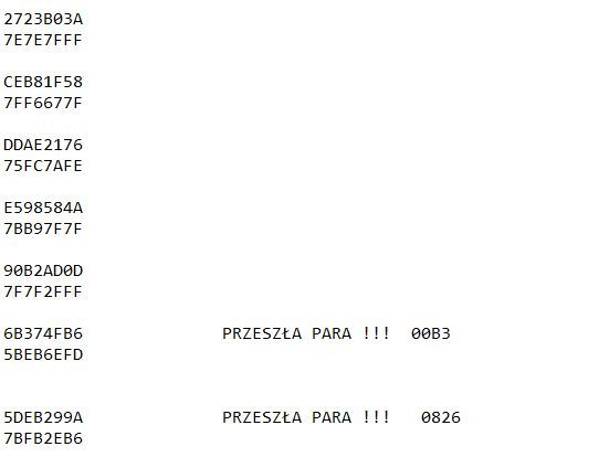

    Here I will add some very important information !!!
    we need to capture the CAN stream all the time to record SEED and SEEDKEY !!
    and VERY IMPORTANT !!
    We must note the working steam !! the key alone will get us nothing.
    we mark the keys to be checked
    This is an example of a procedure - how many looking for so many ideas - not the only way - just a tip.

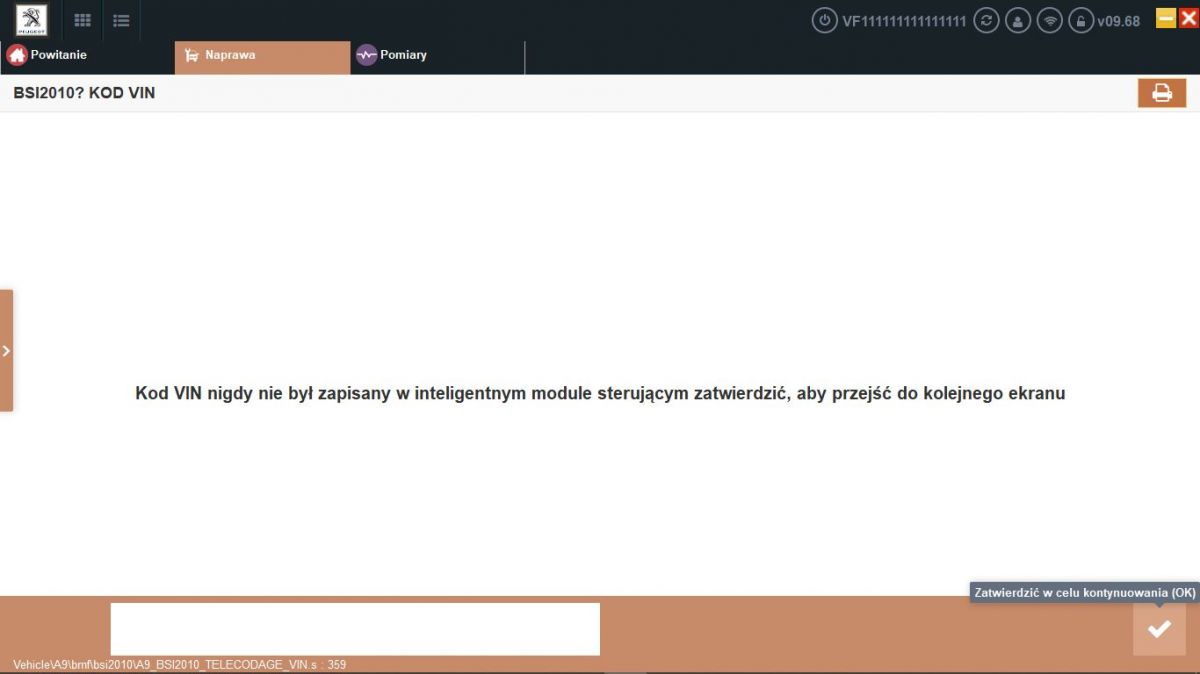

    I had to program the AIRBAG sensor about 120 times until I found the first working pair.
    the first key that worked is (00B3) - I will add that this is only a case that something will work or not, unless it is the correct key (the point is that a given key will work with one SEED and not another one - this is the case) - but it hits something like that and we are waiting for such a key.
    STAGE I version 2
    NOTE - it can also be done differently - for example for a SEED SEEDkey pair that triggered a working 00B3 key - the appropriate key would also be 0011
    so already on the 11th attempt we would have a pair --- but it all depends on the SEED that our ECU will generate at the moment.
    Following the stubbornness of a maniac, you can approach it in a different way - knowing that a given key can work with 1: 10 Seeds, you can repeat several codings for each key to call different seeds ... I think that the probability and the number of repetitions is very similar.

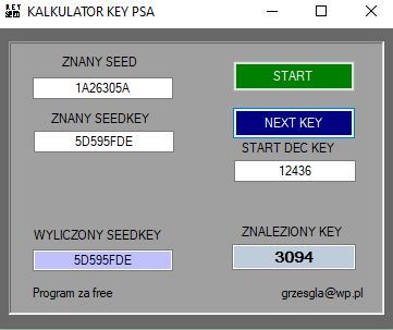

    When we get such a key, WE SAVE A PAIR OF SEED SEEDKEYS !!! and we go through STAGE II

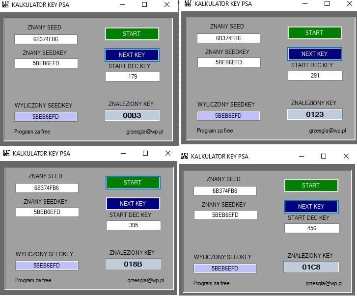

    STAGE II

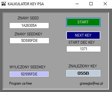

    Example with a working pair:
    And I will emphasize it once again - so that someone would not think that the key entered above is OK ....
    Such randomly operating keys are not the correct key. They work with one or more SEEDs that generate ECU data, but not all.
    There is only one key that will work with all SEEDs and the search process should be done on the exclusion of all others
    Finding a few random keys is to find the right one among them - because it definitely is there and will work with all SEEDs.
    for a working SEED SEEDKEY pair - generate all the keys.
    we generate them from my program which is a few posts above.
    You can already see that we can omit many keys !!!! we are starting to make big jumps.
    Compare the generated keys with the list made earlier and exclude those that will not work.
    now we start testing only those keys from this pair that we have not ruled out.
    we should hit a rutted pair pretty quickly and another ...
    Having already two pairs, I start to use my extended program (I made for 10 pairs)
    the more pairs we start to have, the fewer matching keys we have.
    In fact, after finding the first working pair (say 120, program about 6h with breaks)
    It took me 20 minutes to find the only key.

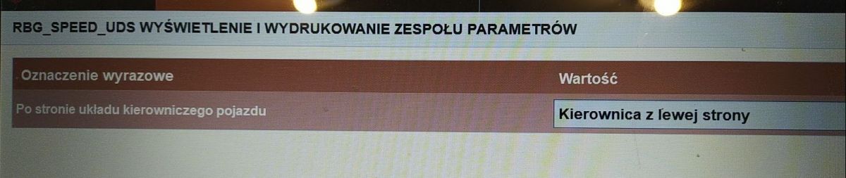

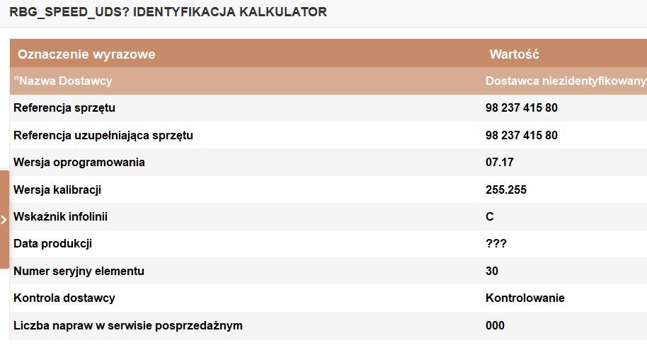

    RBG_SPEED_UDS
    I would like to add that one of the smaller drivers and easily available for such tests and cheap ... and no encoding key in the French inventory.
    Because there is no point in looking for something that already is ...
    But
    I used the key for ESP: ESP90 key 60A5
    as a certainty - and now I have ESP blocked for coding.
    Now I approach the issue of encryption keys more carefully.
    I will repeat drivers that are blocked with the wrong encryption key:
    ASS
    AIRBAG
    ESP

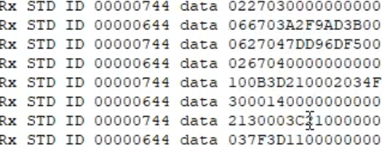

    98.237.414.80
    Rx STD ID 00000744 data 0322F08000000000
    Rx STD ID 00000644 data 101962F080982374
    Rx STD ID 00000744 data 30000A0000000000
    Rx STD ID 00000644 data 211480000D982374
    Rx STD ID 00000644 data 2214800711FFFF03
    Rx STD ID 00000644 data 2301000005240000

    For now, I will be testing the lock options because it's strange that everything will pass and not save.
    the coding area is extended by a dozen or so cells with "switches"
    the whole area of coding and "switches" ends with a -CRC-16 / MODBUS checksum.
    So there will be no problem to fight with "switches", maybe something will be explained ---- such a hobby.
    As for the various keys from the network - a colleague bbmax - asked to test a certain encryption key.
    unfortunately it doesn't work - which is why my decision to look for real codes.
    Because as I wrote ESP, I have already blocked --- I did not make a copy of the batch- a ...
    two movies with the code broken
    and with my code
    everything can be seen in the logs what has passed and what has not.
    FILM WITH CODE BE and here a warning - the code can be seen and not to use it.
    Maybe it works with several SEED codes but it just failed in my test.
    [movie: 20143d44fa] https://filmy.elektroda.pl/35_1621333781.mp4 [/ movie: 20143d44fa]
    FILM WITH CODE OK
    [movie: 20143d44fa] https://filmy.elektroda.pl/69_1621333806.mp4 [/ movie: 20143d44fa]
    I am also throwing logs from txt encoding.
    I will also put in here the identification readings of the batches that I tested.
    Because in previous posts there was such a request.
    I get coded on all of them, but I can't remember them.
    And that's why something from the blockage may be up.
    cross-section of various cars: c3 III, 3008 II, 208II and probably 508
    BSI DELPHI series EL HW D6 - TELECODING READING BSI peugeot 208 II corsa F BSI DELPHI series EL HW D6 - TELECODING READING BSI peugeot 208 II corsa F BSI DELPHI series EL HW D6 - TELECODING READING BSI peugeot 208 II corsa F BSI DELPHI series EL HW D6 - TELECODING READING BSI peugeot 208 II corsa F BSI DELPHI series EL HW D6 - TELECODING READING BSI peugeot 208 II corsa F BSI DELPHI series EL HW D6 - TELECODING READING BSI peugeot 208 II corsa F BSI DELPHI series EL HW D6 - TELECODING READING BSI peugeot 208 II corsa F BSI DELPHI series EL HW D6 - TELECODING READING BSI peugeot 208 II corsa F
    • B8D6.txt (2.21 KB) You must be logged in to download this attachment.
    • MOJ KLUCZ.txt (2.37 KB) You must be logged in to download this attachment.

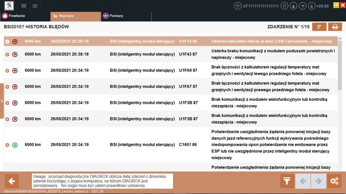

    sorry there was a bug in the CAN commands, but that's not what the movies were about ... just accepting the key.
    I've already improved the movies --- and the next two tests were done, which confirms what I'm saying because the same thing happened again.
    and I added logs so as not to take screenshots of the procedure - only it can be traced in the file.

    I will come back to the topic (question about) random keys.
    as the name suggests .. from a random translation
    Do I understand it correctly?????
    so you might as well call all random keys that will fit into a SEED pair
    e.g. for a pair that does not pass to the proper key, it additionally generates such keys:
    and a few others - and from time to time such keys "surprise"
    Can they be called random ?????
    This time I ask because I don't know?
    Interestingly, I used a few pairs and none of them gave the answer B8D6 ...
    but someone took this key from somewhere ...

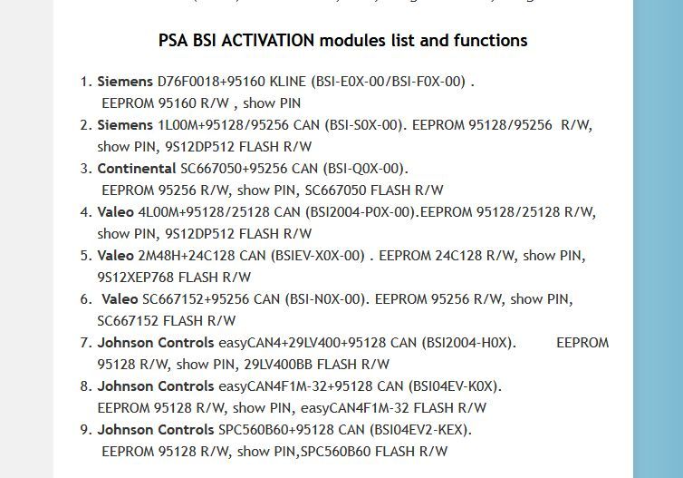

  • BSI preparation panel for virgin and PIN reset
    #81 19451635
    glapsson
    Posts: 557
    Help: 11
    Rate: 645

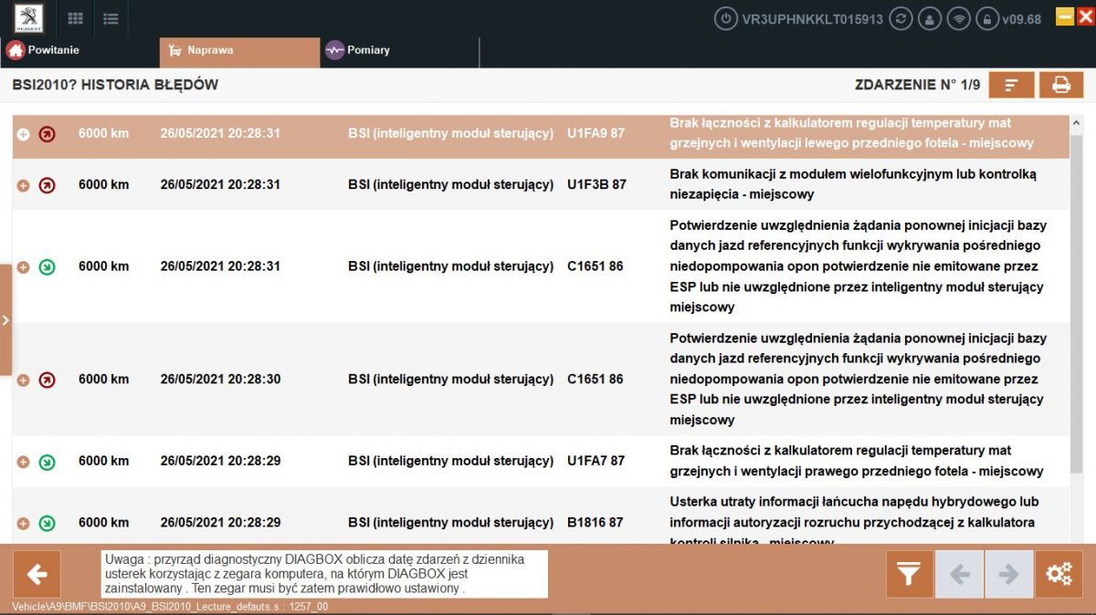

    Another panel appeared in my application.
    It is a BSI preparation panel as VIRGIN
    PIN RESET
    VIN RESET
    HISTORY DTC RESET
    of course, all changes are made together with the CRC counting - so, for example, the history area is not damaged and can save new DTCs.
    Doing this area just for cleaning without a CRC blocks that area.
    I have a Conti Abs sensor to do airbag support and maybe smega in the second program for coding other drivers.
    But in BSI I only had to get eeprom and flsah after OBD and crack the PIN key.
    [movie: dc729692f8] https://filmy.elektroda.pl/49_1622012847.mp4 [/ movie: dc729692f8]

    there is a classic 2703 random login
    2704 authorization in response
    And since the key looks 32-bit there, you must either know the algorithm or have 5GB of data for 1 session. Only that scanning such a number of keys, assuming only 10s per pair and 60 years ...
  • Seed-key algorithm enables ECU telecoding response
    #83 19452532
    glapsson
    Posts: 557
    Help: 11
    Rate: 645
    I do not understand what you're asking
    it's all already ............... when it comes to coding, of course.
    i am not talking about downloading flash or eeprom.
    2703
    you get SEED from ECU 4 bytes ....
    the answer algorithm is here - I'm using it
    it is enough to have the key.
    There are 65535 possible keys for such a SEED to generate a response.
    having a response you send 2704 and 4 response bytes)
    However, the ECU accepts the specified response, not the key
    but it happens that a random key is able to generate a good answer ....... and the ecu will also click.
    Of course, there are a lot of drivers that don't code anymore after the wrong answer.
    But it was all there
    THE ALGORITH IS !!!
    It took me 6 hours with many interruptions to break the key ... not 60 years.
  • 60-year keyspace makes brute force impractical

    2 byte key is enough .. that is 65535 key combinations.
    And because there is an algo, I don't understand what your problem is.
    Maybe with the numbers you want to discourage others who like to play with it.
    And another thing, what I have already written, are SEEDs for which a specific answer can be generated with even several hundred keys.
    so having SEED and SEED key pairs that work - it's easy to find those keys that will handle both pairs.
    And with such pairs, e.g. 6, the number of keys that will handle all these pairs can be from several to even 1 of the right one.
    and a few keys, it is easy to test over coffee.
    Because it's not about testing all the keys.
    Only those that "surprised"
    maybe I don't know something but I went to the official website of IOTerminal and somehow I don't see DELPHI

    https://github.com/ludwig-v/psa-seedkey-algorithm
    Read the description .... how to find the key ... because it makes no sense for me to write it a second time.
    If you do not try, you will not understand that there is not one key, but even several hundred, to generate an answer.
    for one SEED only
    For example
    e.g. 12 34 56 79
    it works on the following keys (after an algo of course) and gives a good answer - such a seed repeats from time to time and goes to "hit".
    00 22
    00 45
    00 79
    01 03
    e.t.c
    a e.g. SEED
    23 45 78 92
    works on keys
    00 25
    00 47
    00 79
    01 13
    for example, 00 79 was repeated for both of them - so it is more likely - the others can be completely ruled out because they did not work with a different seed
    and this way of exclusion is quickly ruling out those not working with everyone
    The operation is not about looking for only the exclusion of the wrong ones.
    Having two three pairs that worked with one key
    after writing the appropriate formula .....
    one can throw away the thousands that do not act in favor of the few who act with all the known

    Added after 3 [hours] 43 [minutes]:
    Yesterday the tests went - everything works great.
    I had to make a few corrections.
    among others mileage - it is now calculated for bin search ... no need to know mileage - mileage algorithm and CRC is enough to find it directly in the batch - no OBD needed.
    I changed it because it was cumbersome to manually enter the mileage ... once with a comma, once without ... I corrected it.
    Of course, for the mileage - it would be more elegant if I reset the sub-meter because it looks stupid in the screen ...
    but no problem with that.
    other functions elegantly
    VIN
    PIN
    HIST
    I set the mileage at 6000 km
    The mistakes are fine .... BSI has a lot of DTCs on the table, but I had an airbag sensor plugged in and I unplugged it - adding works.
    Everything is so prepared that it can be done on .bin files, but with the possibility of a quick switch to OBD - I will only add the batch reading after the OBD.
    Change of mileage ...
    And now someone will ask, but why are these CRC and HEX ...
    Of course, they are unnecessary here ... but at the testing stage - I have an automatic preview of whether the program actually found the lines with the course.
    not a random area to match as a trace line ... likeI will process a dozen batches and everything will be ok - it will probably fall out or it will stay that way because it does not bother anything.
    [movie: dba0abd48e] https://filmy.elektroda.pl/25_1622130954.mp4 [/ movie: dba0abd48e]
