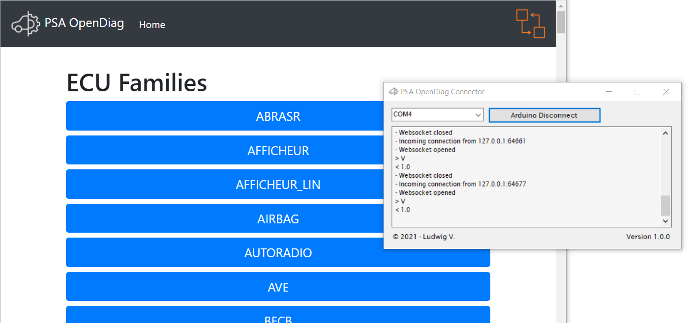

    Breaks in the recording are - technical breaks for switching the OBD pins or connecting an immo emulator.
    [movie: 93351bba8f] https://filmy.elektroda.pl/49_1657304378.mp4 [/ movie: 93351bba8f]
    In the attachment, the Arduino batch - someone accused me of being a piece of software that is supposed to be free.
    So it is.
    but in my version it basically supports CAN and serial.
    It does not perform the encodings or any functions visible in the program, nor the SEEDkey calculations.
    Maybe it will be useful to someone ... but I rather doubt it.
    Because you have to add the rest in Arduino or Windows.

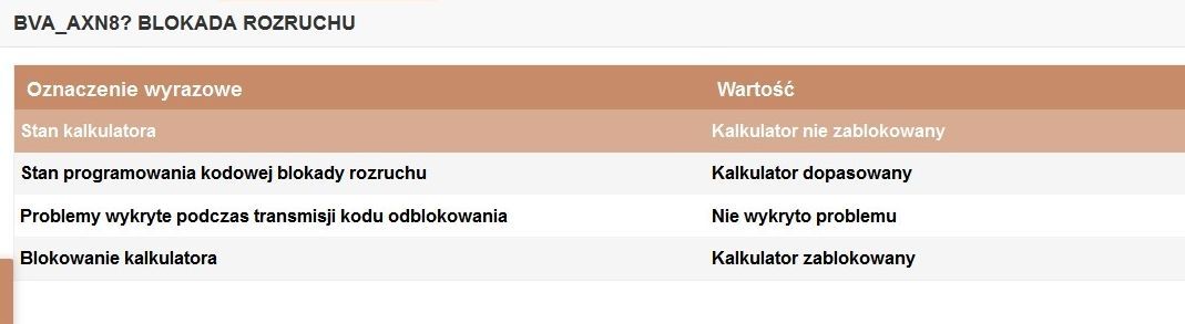

    I just read the pin from the AXN8 box driver.
    After emulation it seems to work.
    I have to test in a car

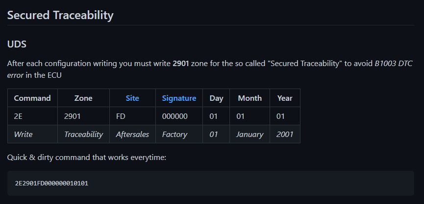

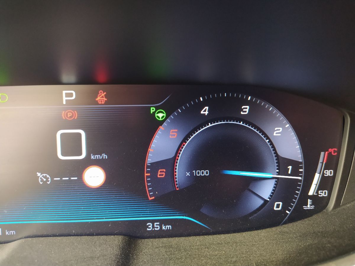

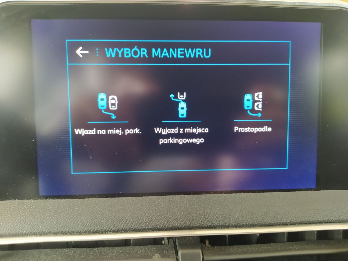

    I am just after a successful semi-automatic parking activation operation on a Peugeot 3008 II.
    There is still a little mic, but maybe it can also be overcome.
    After coding a new CPK G5 parking module, the module accepts the key, codes correctly - but at the end it adds an error
    B1003 and parking controller not working (locked mode)
    There is communication, it continues to code, read and delete DTCs, except for this one - no distance recognition and no response to sensors.
    Restoring the settings doesn't help.
    The other modules code correctly
    with the appropriate (originally coded for parking) parking module everything went without a problem.

  • AXN8 pin emulation appears to restore parking controller

  • #254 20153111

    2901 does the dtc thing
    Tomorrow I will check if the module works with the rest.

    #256 20153393
    glapsson
    Electronics specialist
    Posts: 557
    Help: 11
    Rate: 645

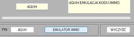

    As for the AXN8 - only eavesdropping on the saved.
    And I wrote a standalone arduino batch that emulates the pin for the AXN8 - but it would be better to use something smaller.
    I used the Arduino-mini but it is still quite a big platform for the immo emulator.
    Interestingly, I was knocking with this 2901 somewhere out there, but I got so absorbed that it could be started in the car that I got away with it somewhere.
    There are a few more modules that often have this error stored and it does not affect operation.
    And here, as it turned out, it blocks the operation - after deleting it is OK.

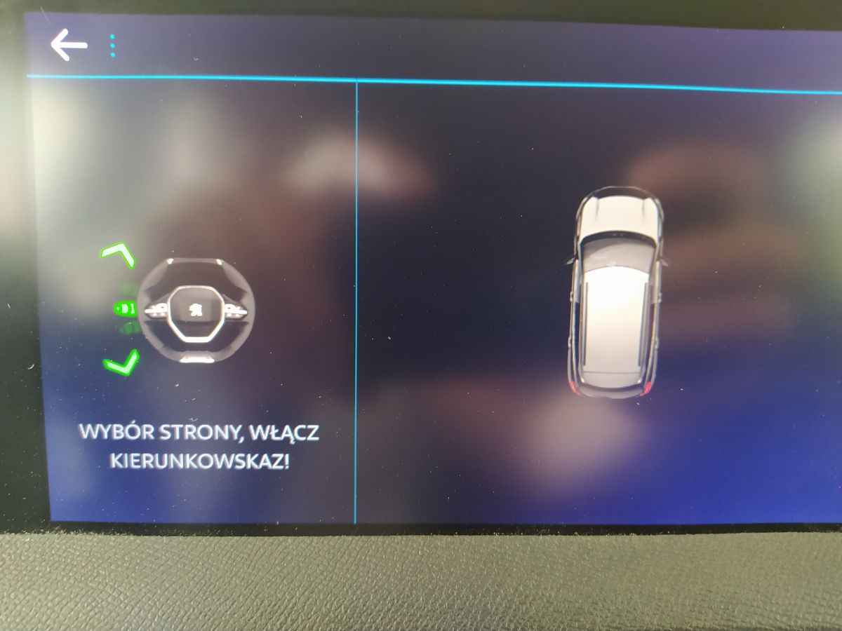

    Program corrected
    Below is an instruction on how to start ParkAssist
    or how to activate semi-automatic parking on a Peugeot 3008 II or 5008 II
    and I do not exclude that also in other models.
    • PARKOWANIE PÓŁAUTOMATYCZNE.pdf (2.14 MB) You must be logged in to download this attachment.

    glapsson wrote:
    Program corrected
    Hi
    can you suggest which zone to change in the power steering in semi-automatic parking?
    NAC on, BSI too, park module too, but my DG won't move the steering wheel and I have to do Arduino.
    Thanks
  • #266 20207591
    LaimonasBacevicius
    Hello, anyone knows what this software is?
    BSI DELPHI series EL HW D6 - TELECODING READING BSI peugeot 208 II corsa F
  • CAN frame CRC needed for ParkAssist coding
    #268 20210728
    glapsson
    Posts: 557
    Help: 11
    Rate: 645
    macinek102 wrote:
    glapsson wrote:
    Program corrected
    Hi
    Nac on, Bsi too, park module too, but my DG won't move the steering wheel and I have to do Arduino.
    Thanks
    It will not be easy ..... it has to do with completing CAN frames - in Vlud
    I do not know if he corrected it - but if not, you will not code it.
    It is not enough to change zones and know the encryption key - you still need to calculate the CRC on the fly and integrate it into the CAN transmission.
    PSA TOOL
  • #269 20210821
    bbmax
    Posts: 132
    Rate: 62
    No need to fly, just change the CRC count and send
  • #270 20210832
    glapsson
    Posts: 557
    Help: 11
    Rate: 645
    I wrote it right because my program counts on the fly.

  1. Replace the CPK with G5 module.
  2. Telecode BSI, NAC, CPK and Instrument cluster to PARK_ASSIST YES.
  3. In Power-Steering zone 2100 change byte D9→C8 and send frame 2901 to clear DTC B1003 [Elektroda, macinek102, #20210901; bbmax, #20210863].
8. How can I read the vehicle PIN from an ECU on the bench?

11. How do I recover BSI communication after fault B1003 (locked mode)?
After coding send diagnostic frame 0x2901; it clears B1003 and re-enables CAN messaging [Elektroda, bbmax, post #20210863]
