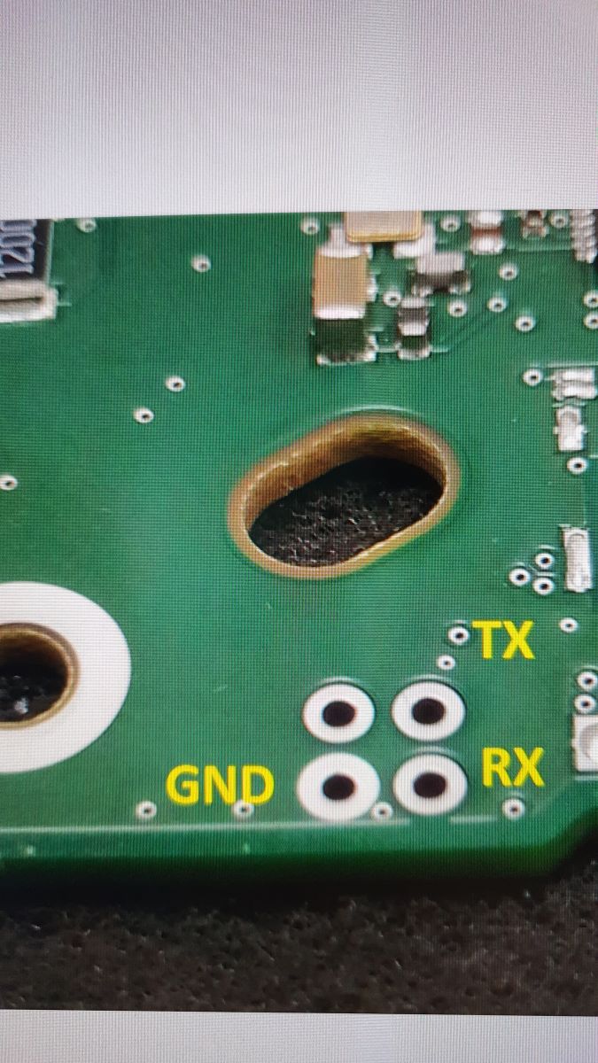

    At 6.4 you can connect to rs2ttl on the board there is a connector BSI DELPHI series EL HW D6 - TELECODING READING BSI peugeot 208 II corsa F

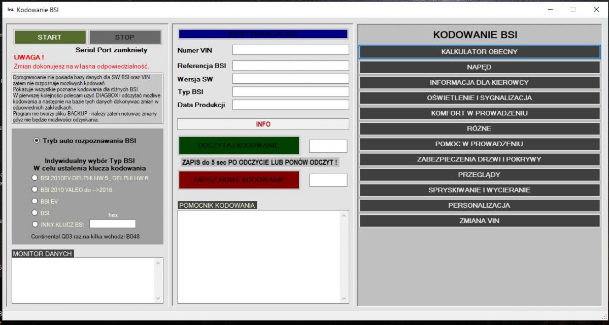

  • Working telecoding app for post-2016 modules
    #38 19373603
    glapsson
    Electronics specialist
    Posts: 557
    Help: 11
    Rate: 645
    I managed to write an application .... more or less successful in terms of programming .. but I can't do better yet because I have been working in c # for only two months.
    The most important thing is that
    IT WORKS !!
    https://youtu.be/6K7bUKgThQc
    I am looking for someone who would make parts available for work:
    Of course, these are the modules after 2016, those that need to be coded online:
    CIROCCO clocks (e.g. 3008 II)
    handsfre module
    ABS ESP
    Radar
    gearbox driver
    SMEG
    if someone is willing to cooperate, contact us by email.

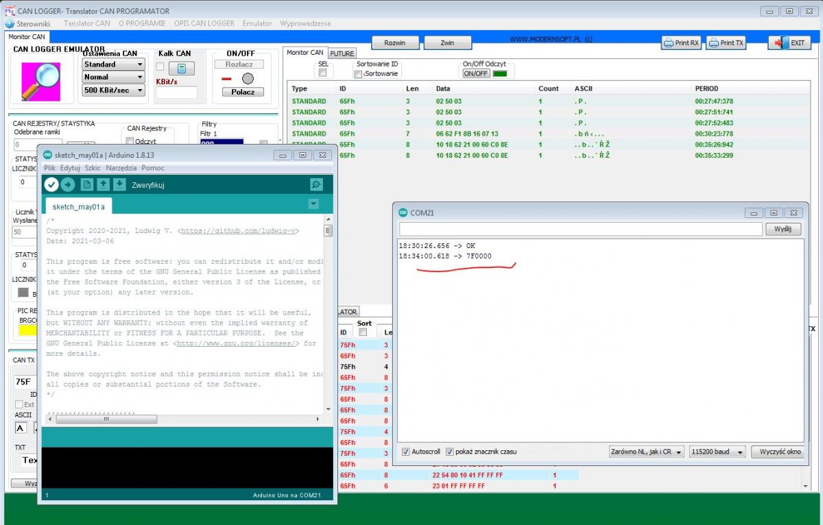

  • #39 19373693
    bbmax
    Posts: 132
    Rate: 62
    You started working nicely
    Cirocco can be encoded by French and Arduino apps
    And the rest of the terminal and diagbox for reading

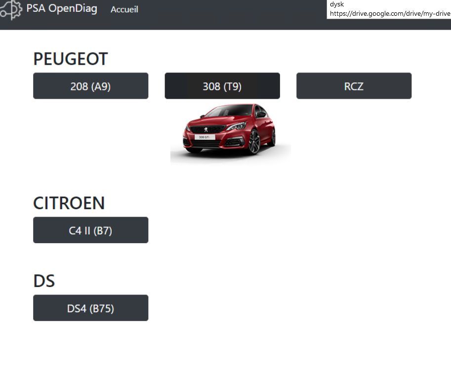

  • #41 19373754
    bbmax
    Posts: 132
    Rate: 62
    glapsson wrote:
    doing it with a terminal is a nightmare ...
    what I wrote is just for french arduino only wrapped in an apke for windows
    cirrocco and the rest on the same principle want to do because patting commands on foot is .... so-so.
    I need to write off bytes and all setup options.
    I was supposed to do it but the French does it OpenDiag will make no sense to duplicate each other

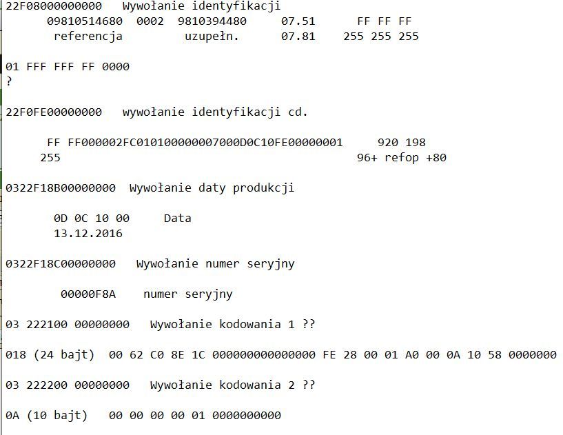

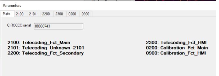

  • Telecoding containers are around 2100 and 2200
    #42 19373758
    glapsson
    Posts: 557
    Help: 11
    Rate: 645

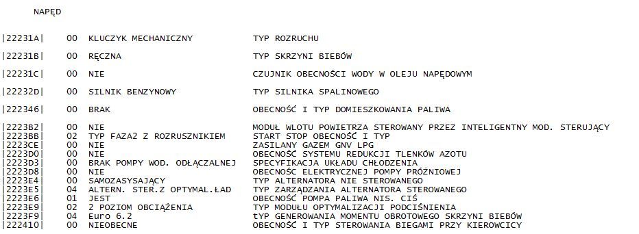

    I will not wait for the ready ... sorry but it's nice to add something from yourself or do it yourself.
    I took a peek
    208 c4II
    it will take a while to get to the 3008 II and 208II DS7
    and the new ones only interest me
    another thing is that in his cirocco there are coding containers that I can't see at home ....
    I have 2221 and 2222
    adjustment !!!!!
    and HERE MY ERROR BECAUSE I BREAKED ZERO !!
    I do not delete, but informs everyone who has managed to assimilate incorrect information.
    it's around 2100 and 2200
    for me it looks like this:
    3008II 2018

    Well, it took some time, moreover, you can follow the French forum in my posts :)
    The bezel is new modeled in fusion360 printed with abs and fused to the top org bezel
    In the board you have to cut the bottom part, the LCD almost touches the contact area, some 4mm of play remains :)
    as for the new clocks from 208 P21 is Visteon and there is no eeprom here, in prock in the countryside

    for me from the menu
    as you can see in the video and also for each bsi because the encoding container is the same for a given function
    automatic unlocking as seen in the video
    I do not play with the options that diagbox does - except for identification because then it automatically recognizes bsi.
    I left a gate for other bsi in the form of a window on the KEY

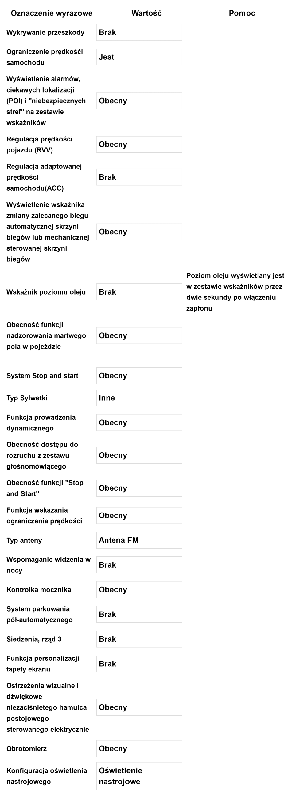

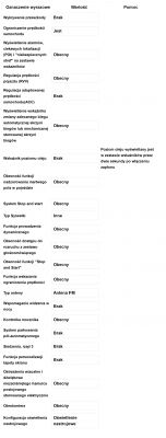

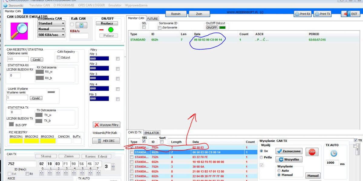

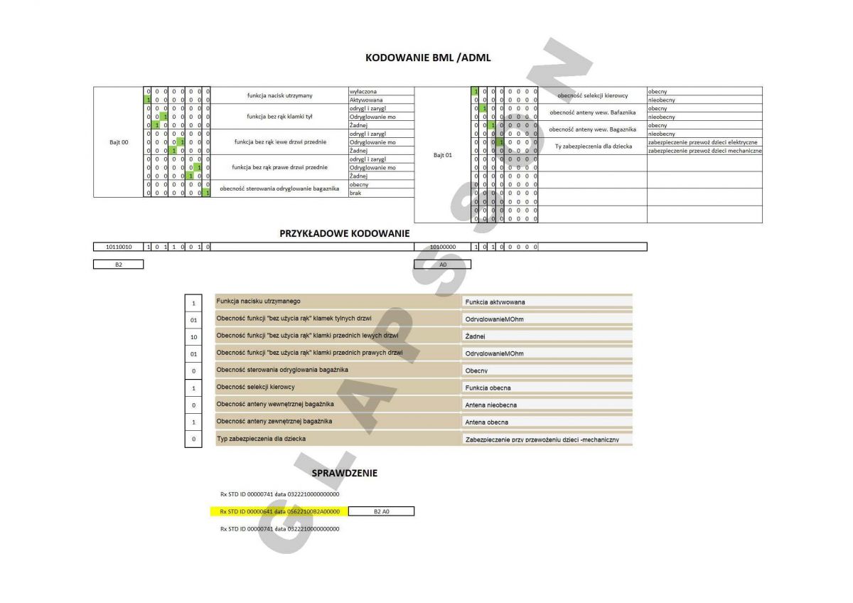

    Continuing the topic of encoding in PSA, below is an example of encoding one of the modules:
    ADML Encoding Schedule and Bytes Calculations:
    CIROCCO is similarly written below
    • rozpisanie bajtów i bitów kodowania.jpg (1.75 MB) You must be logged in to download this attachment.

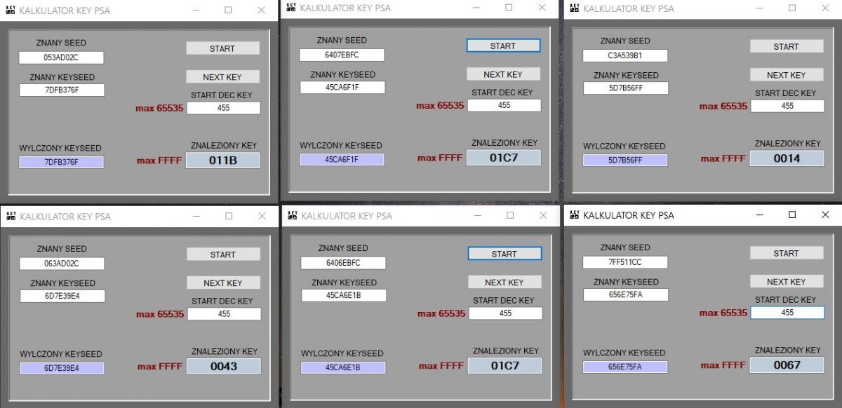

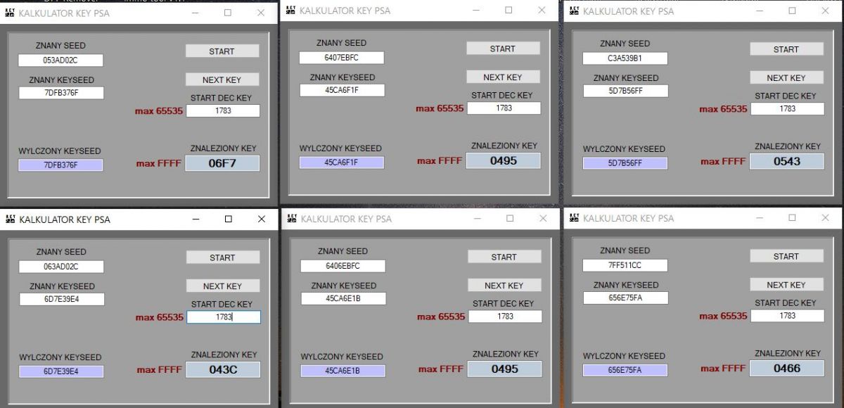

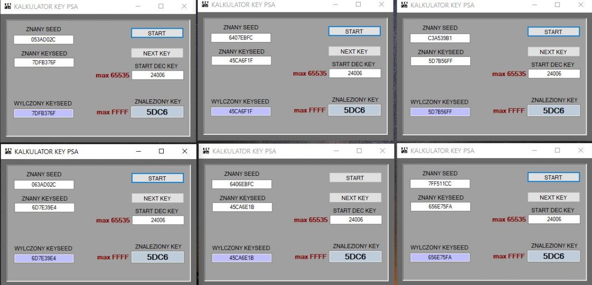

  • PSA coding app calculates encryption keys from SEED pairs
    #50 19388952
    glapsson
    Posts: 557
    Help: 11
    Rate: 645

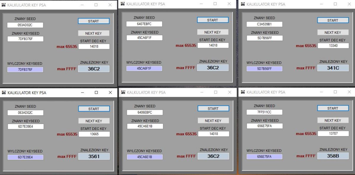

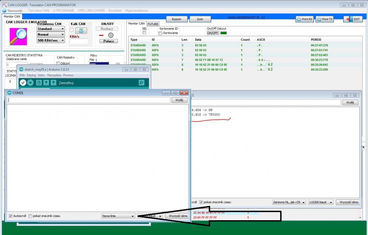

    Another edition of PSA coding
    There is already an OUTLINE - what it will look like.
    Of course, some windows are not needed and are currently used for control purposes - I will probably give them up at a later stage.
    Controls in order to test the radio buttons in the program (check boxes) - I have to see if there is a reaction and if it is correct - with incorrect radio assignment - I see an error in the test.
    To code in PSA you need an encryption key.
    I wrote a little applet which uses the well-known SEED and SEEDKEY to calculate the KEY.
    Of course, the program is not very perfect and calculates from a few to a dozen or so keys for one pair.
    But with 6 pairs of these two values - the code was calculated perfectly, which confirms the operation of the PSA program.
    the last photo shows 6 compatible keys
    BSI DELPHI series EL HW D6 - TELECODING READING BSI peugeot 208 II corsa F BSI DELPHI series EL HW D6 - TELECODING READING BSI peugeot 208 II corsa F BSI DELPHI series EL HW D6 - TELECODING READING BSI peugeot 208 II corsa F BSI DELPHI series EL HW D6 - TELECODING READING BSI peugeot 208 II corsa F

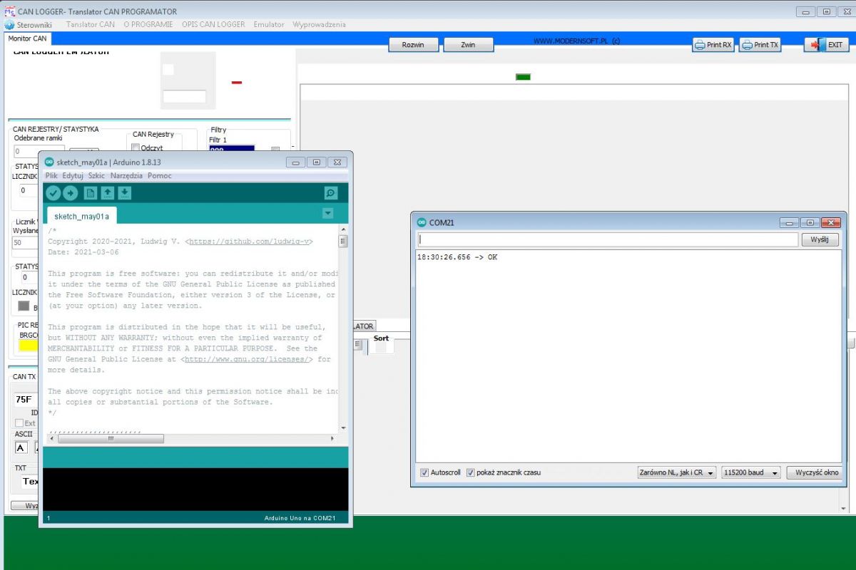

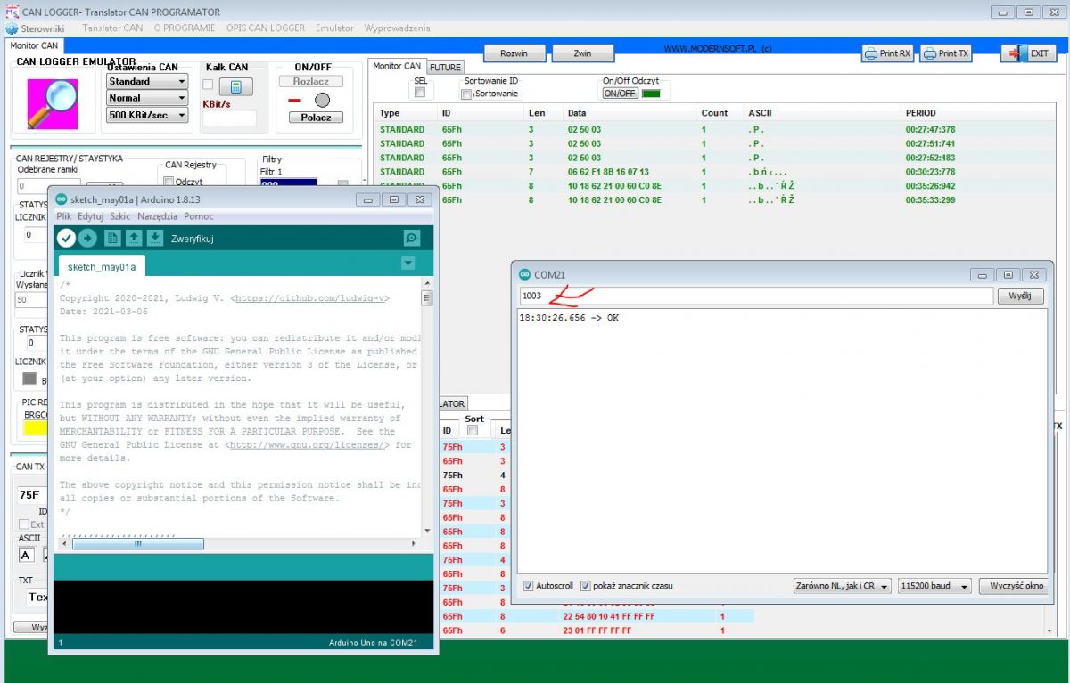

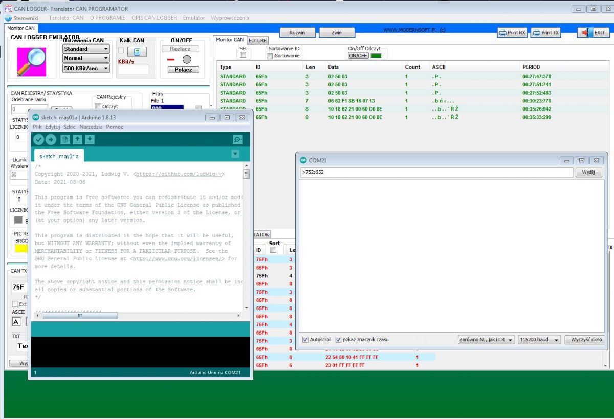

    Below is a video of the program's operation - so far I have ADML done because I had a spare.
    But the shape of the program is already there and the concept of how it is supposed to work - the rest will go faster.
    [movie: 8d971c4720] https://filmy.elektroda.pl/41_1618822193.mp4 [/ movie: 8d971c4720]
    Previously developed BSI coding.
    [movie: 8d971c4720] https://filmy.elektroda.pl/96_1618822791.mp4 [/ movie: 8d971c4720]
    And so that there would be no understatements ... there will be no commercialism here.

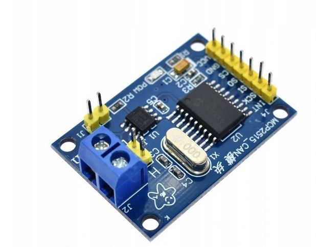

    I show that it can be done on Arduino on the French software shown a few posts earlier.
    It can be done and that's it on ... the so-called "crap even Chinese" Arduino .. and it probably hurts some people.
    By the way - I didn't write the Arduino software.
    You can download them for free on the French website.
    But working on an Arduino is just patting digital codes in the serial port console ... it's a bit weak.
    As you can see, I only have a graphic interface.
    And I come back here to comments about commerce ... how can it be commercialized when it's for free ......
    I greet those who had comments on PW.
    My version will not be shared .... in any way.
    Rather, it is an incentive for those who click a bit to act themselves, as long as they like to pick at their dogs.
    Maybe this will stop commercial companies from mowing heavy money for their interfaces - just because someone bought a car from them ...
    Or the next generation of security will be created ... for the next big money and thanks to this the cars will have to become more expensive once again.
    I think that the topic of coding the new BSI PSAs can be closed - everything has already been said and for my part ... I can not add anything else.
    Greetings to everyone in the PSA group.

  • BSI responds in CAN logger but not Arduino monitor
    #53 19411023
    kalisz1
    I can see a lot of work put into "programming" PSA great praise
    I decided to face the arduino with the program what you presented from the French PSA-Arduino-CIROCCO and PSA-Arduino-NAC forums
    it works !!!
    but I am interested in BSI as well as you
    I have a problem with connecting to BSI in ARDUINO in the port monitor does not respond to the command
    > 752: 652
    okay
    1003
    7F0000
    if I send the frame in the can logger, BSI will answer
    what am i doing wrong
    thanks
    I have CAN LOGGER, IOTerminal, Smok, DB
  • Use Arduino PSA diagnostics and verify wiring setup
    #54 19411356
    glapsson
    Posts: 557
    Help: 11
    Rate: 645
    From what I can see you are using different software
    Use the arduino for diagnostics
    https://github.com/ludwig-v/arduino-psa-diag
    arduino-pies-diag - you have probably already loaded the libraries
    everything will walk
    unless the problem is some external factor - wiring ... bsi itself etc.
    You did not write how do you connect .. in the car or on the table?
    the software grows all the time:
    Below are the effects
    I added a toolbox for drivers that are not yet listed in the tabs.
    You can encode directly from a byte string.
    Of course, there is no fear - you can save the string and, if necessary, paste and upload.
    Second thing - no driver can be encoded with impossible (wrong) coding.

  • MCP2515 setup and 16 MHz quartz replacement

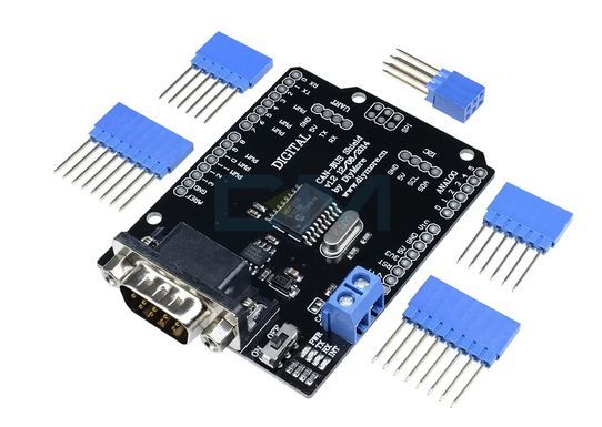

    #55 19411435
    kalisz1
    Super hats off
    arduino works on the programs of the french connects to the counter on the table
    but if i want to execute serial port via monitor it doesn't go
    a program downloaded using raw may copy something wrong
    do you have a sketch in the file you share?
    in the connection on the table it is rather ok because the logger goes to call 1003
    I wanted to play because I have all 3008 on the table
    Added after 28 [minutes]:
    forgot to say i have mcp2515
    I replaced the quartz with 16 because it was not even with PSA-Arduino-CIROCCO.exe
  • Arduino PSA coding tool with SEED/KEYSEED calculator
    #56 19411554
    glapsson
    Posts: 557
    Help: 11
    Rate: 645
    I have not tested on the MCP you showed
    I use one
    You do not need a schematic because it is 1: 1
    Added after 6 [hours] 28 [minutes]:
    ANOTHER SCENE ...
    It can't just be that it shows what I have.
    At the bottom, a tiny PSA encoder for those online.
    Of course ARDUINO
    - of course, arduino needs to be loaded with arduino-dog-diag from the French forum.
    link a few posts before.
    I am adding a key calculator based on SEED and KEYSEED.
    [movie: 13e998c556] https://filmy.elektroda.pl/41_1619962380.mp4 [/ movie: 13e998c556]
    I'm throwing in a tiny coding tool.
    It is mega imperfect - it lacks exclusions and is not immune to mistakes.
    but it's just a few lines of code.
    use with caution !!
    I have tested various heaps and it is hardly possible to enter the wrong encoding ... but you can get confused if you do not know the assigned encoding containers (bytes).
    below is an example of BSI encoding for container 2308
    2308 MISCELLANEOUS - Right-hand drive vehicle 00 NO 01 YES
    and the second EDC17C60 encoding
    Oil vapor recirculation heater not present
    I have the coding of most options in the new BSI written off
    also bytes of other drivers - but it cost a lot of work.
    and money - investments in calculators.
    I'm not giving away!
    And so I made a big nod to everyone who wants to code their PSAs.
    And the applet refers to SEED and sends SEEDKEY which enables encoding.
    a few posts above there are two schedules for BLM and CIROCCO
    ATTENTION PLAYING WITH CODING MAY LEAD TO BLOCKING THE DRIVER FOR CODING WITH THE ERRORLY ENTERED CODING KEY.
    I refer to reading the entire topic and not a selective treatment of information. - consisting only in downloading data.
    Because a lot of information is just starting to emerge as the topic is developed.
    It seems logical - as long as the thread is not closed.
    He writes this so that everything is clear and nobody had any claims after the fact because they did not know or read something.
    • Kalkulator KEYSEED.7z (9.47 KB) You must be logged in to download this attachment.

    #57 19417224
    kalisz1
    thanks for the applet, it helps me a lot at the beginning
    is working on getting information from can
    I have a question for you, I have ripped coding from BSI 2010 EV, e.g. drive
    will a different version of hw sw (or nr) have the same addresses encoding
    e.g.
    | 22231A | BOOT TYPE if there is something else under this call in other BSI 2010EV or not
    I am asking because I do not have another bsi and I cannot check it
    The topic with the broken monitor in ARDUINO was overwhelmed by an oversight
    Greetings

    #59 19417509
    glapsson
    Posts: 557
    Help: 11
    Rate: 645
    e.g.
    I call it the encoding container.
    I took the name from someone else and that's how I stayed - is it correct ... hmmm, I don't know. But it is a convenient name.
    231A - that's what I would leave as a container in the descriptions because when uploading for 22, it enters 2E.
    The container itself is a constant value for all BSIs.
    Just check the two values 231A and 231B again because I think you swapped them.
    For my part, I will also check because maybe I was wrong ... I have the opposite.
    I checked - I was right - I'm fine with you, your error.
