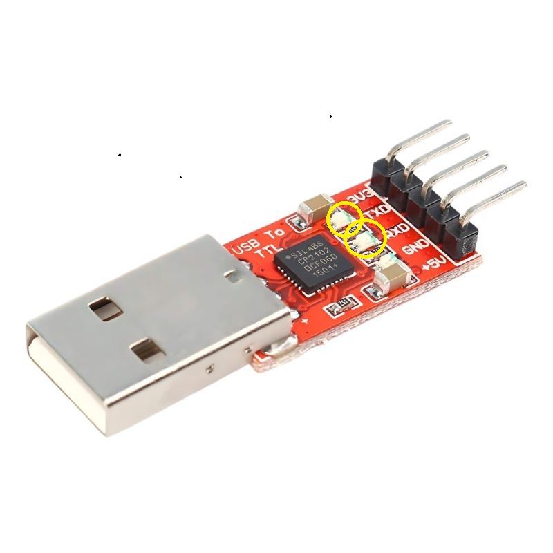

    How do the LEDs on the USB converter react when an attempt is made to transmit data or when power is supplied to the ESP module?

    >>21923174 When I connect it with no 3.3V red light is on and middle blue, when I connect 3.3V than middle blue is off and third blue is blinking and than I get error no connection

    >>21923381
    I meant the LEDs on the USB adapter (marked with a circle).
    Red USB-to-TTL module with USB-A plug and header pins labeled RXD, TXD, GND, +5V

    >>21923547 I meant that too, one red and 2 blue.
    when I disconnect 3.3v middle blue is light when I connect 3.3V middle blue is gone and last blue is blinking. after that I get connection time out.

    >>21923547 It follows from this that the ESP8266 is not transmitting any information. If possible, it would be worth measuring the signals using an oscilloscope.

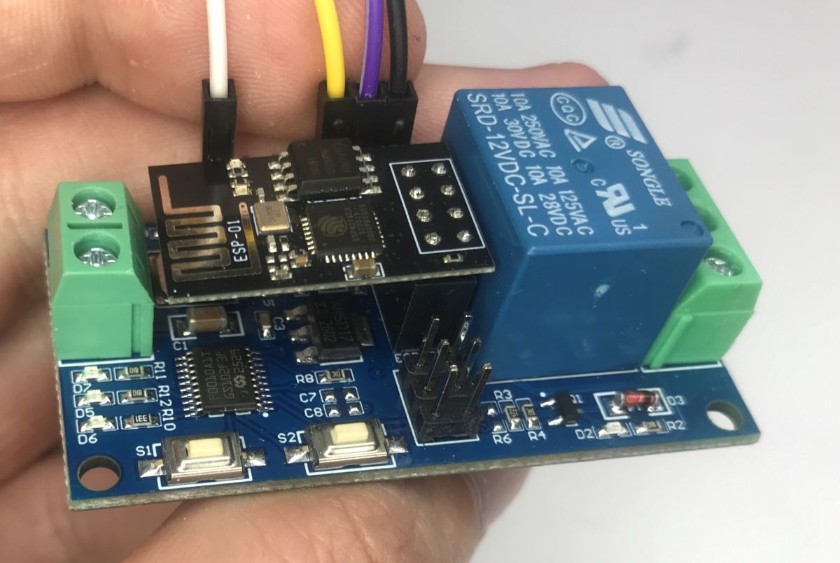

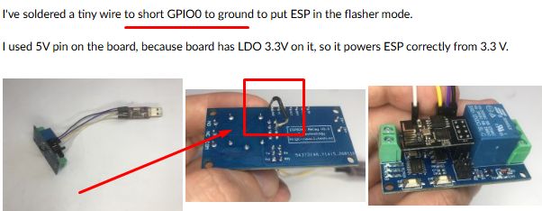

  • GPIO0 grounded for ESP8266 flashing mode
    #39 21927150
    Posts: 14770
    Rate: 12913

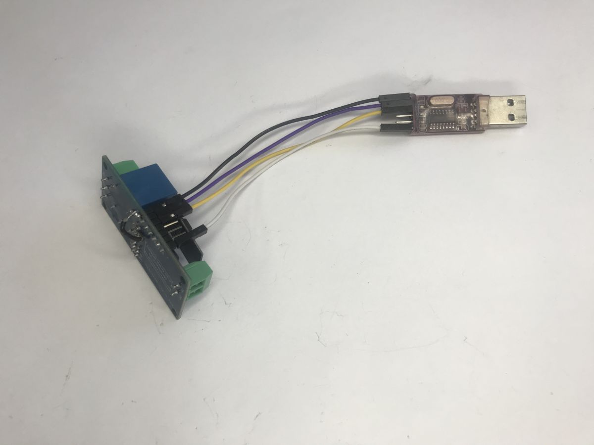

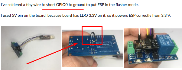

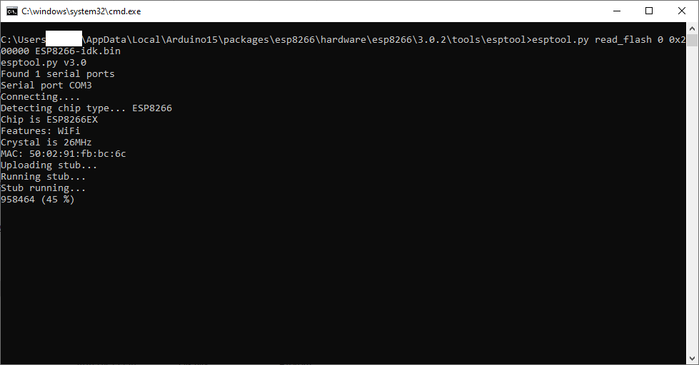

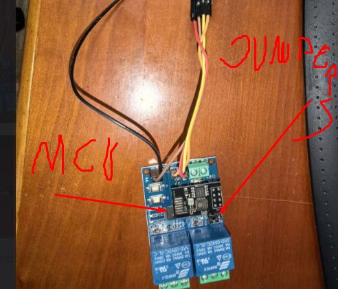

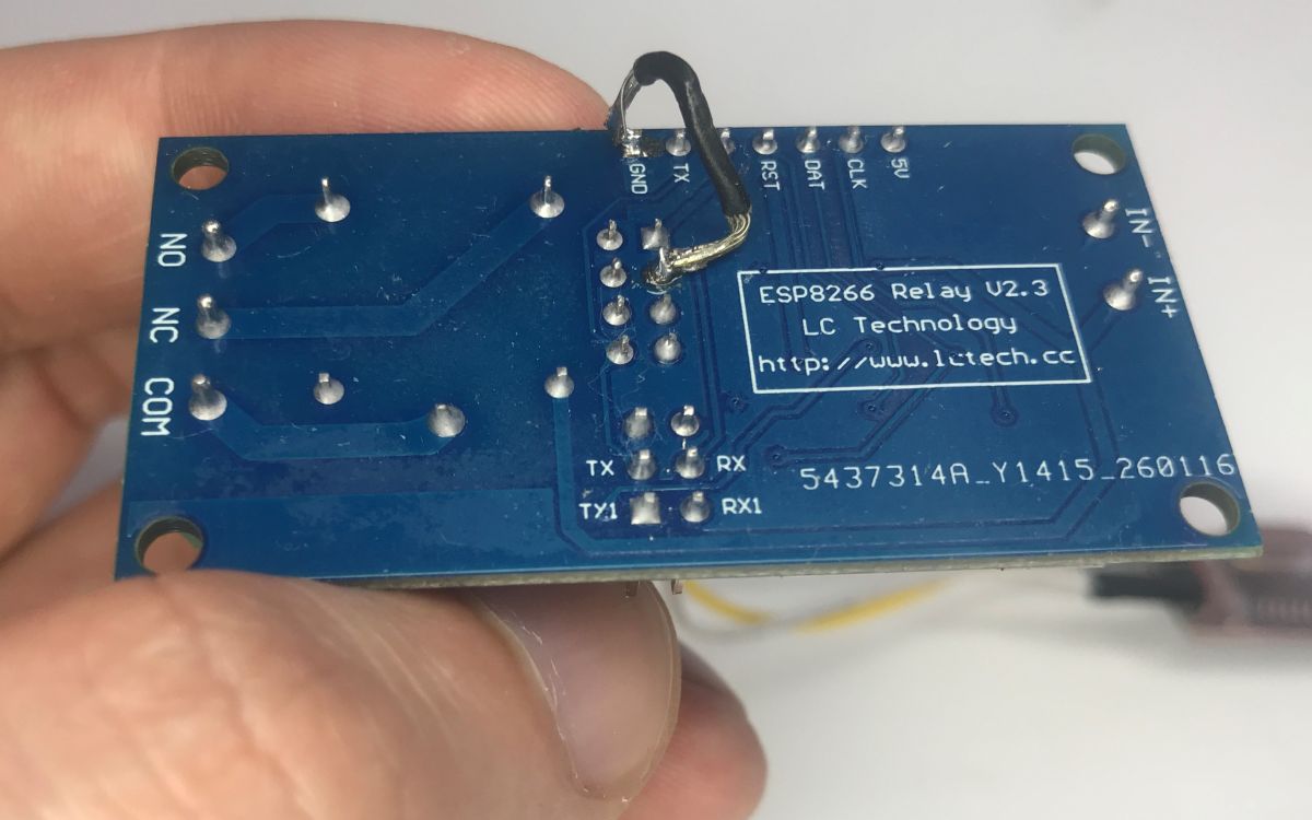

    I've got a device from @Blisk to diagnose and it flashes just fine.
    I've soldered a tiny wire to short GPIO0 to ground to put ESP in the flasher mode.
    I used 5V pin on the board, because board has LDO 3.3V on it, so it powers ESP correctly from 3.3 V.
    ESP8266 and Tasmota - controlling the WiFi relay step by step ESP8266 and Tasmota - controlling the WiFi relay step by step ESP8266 and Tasmota - controlling the WiFi relay step by step ESP8266 and Tasmota - controlling the WiFi relay step by step Relay module with blue Songle 12V relay and ESP-01 board, held in a hand Two electronic boards: a Songle 12V relay module and a smaller pin header module on a white surface
    Windows cmd.exe screenshot: esptool.py reading ESP8266 flash via COM3, 45% progress
    I will attempt to flash Tasmota next.

    >>21927150
    As shown in the last attachment, communication with the ESP8266 is working, so it is difficult to understand why the original poster was unable to achieve this result.

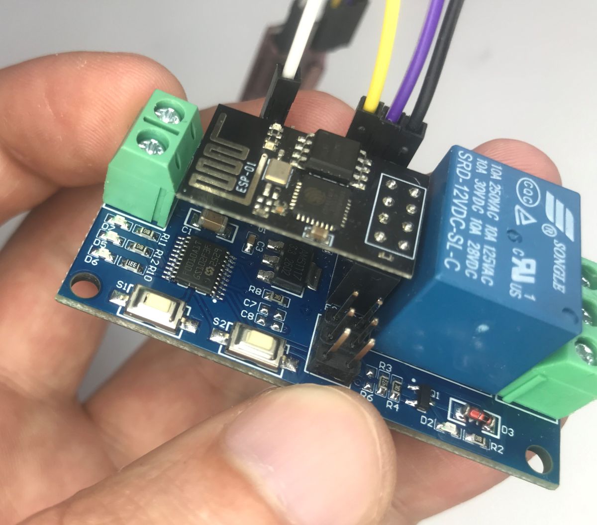

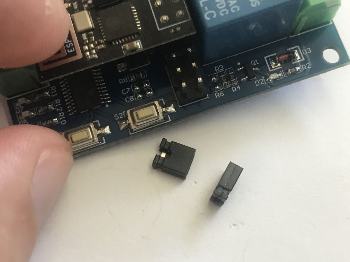

  • UART-controlled relay uses programming lines
    #41 21927216
    Posts: 14770
    Rate: 12913

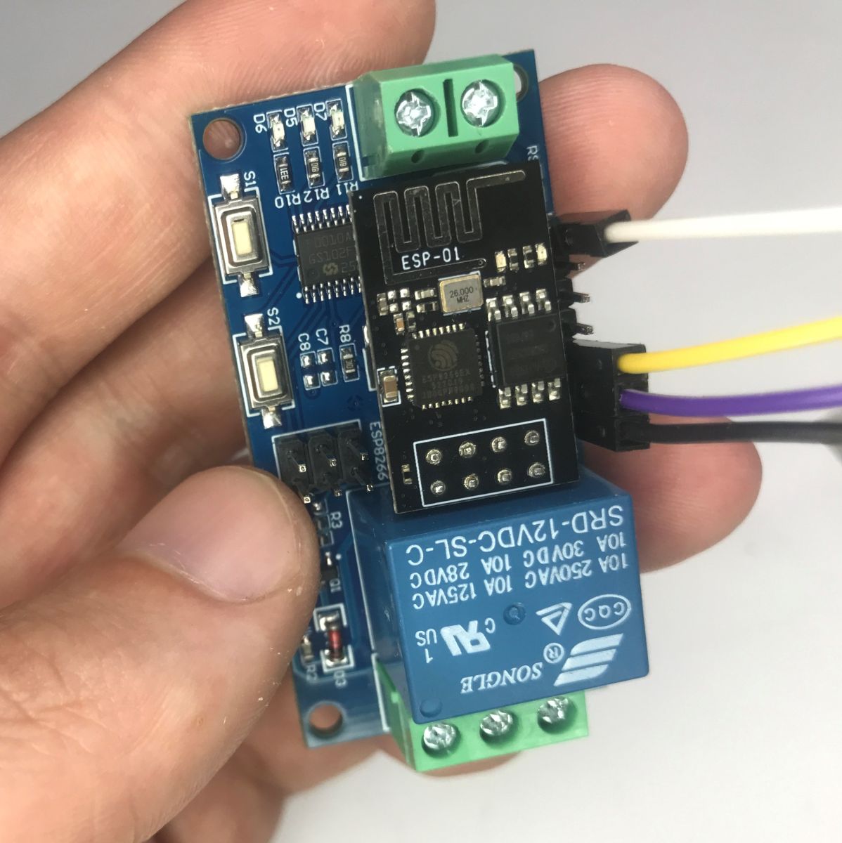

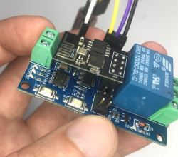

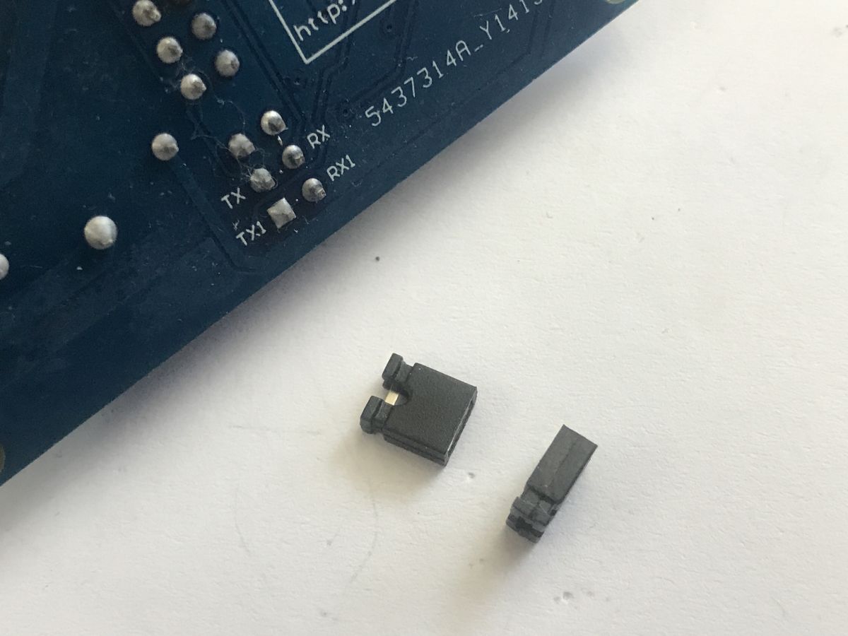

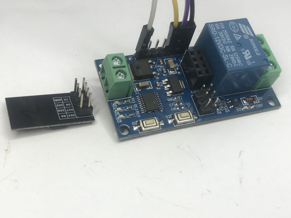

    Ah, I just realized what was wrong. This module has a relay that is controlled via UART, which uses same lines that are used for programming. It worked for me , because I removed the jumpers upfront.
    Close-up of a PCB with a relay and buttons; two small black jumper caps lie beside it.
    Yes! I can see it on his image as well:
    Relay module on a wooden desk with connected wires and red handwritten annotations
    That solves it...
    https://tasmota.github.io/docs/devices/LC-Tec...-Relay/#lc-technology-wifi-relay-single-relay
    LC Technology WiFi Relay - Single Relay~
    The LC Technology relay devices use GPIO1 and GPIO3 for the serial communications used to control the relays. You do not need to specify these in the template. SerialSend uses these standard serial communications GPIO by default.
    I tried to flash it with that module mounted on relay or just module and nothing worked, I hope there is a way to upload tasmota. tasmota didn't connect with it.
    I even don't know how to use it withouth flasihn it, so I contacted seller and he give me some manuals which still don't know how.

    Posts: 14770
    Rate: 12913
    It's as I said - you need to remove the two jumpers. Do you have any more pieces at hand, besides the one you sent me? You can remove them and try.

    >>21928006 I have another module with 2 relays I will try and post pictures here

    Please remove 2 jumpers (RX and TX jumpers) and try flashing it. First do flash read, ok? Flash backup.

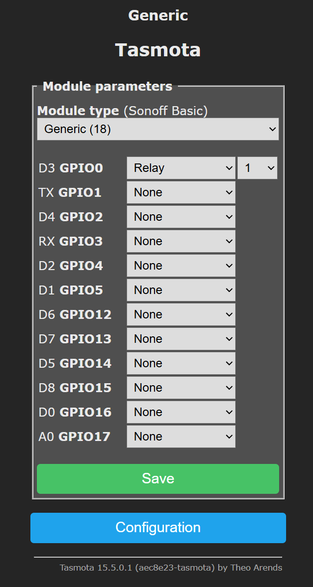

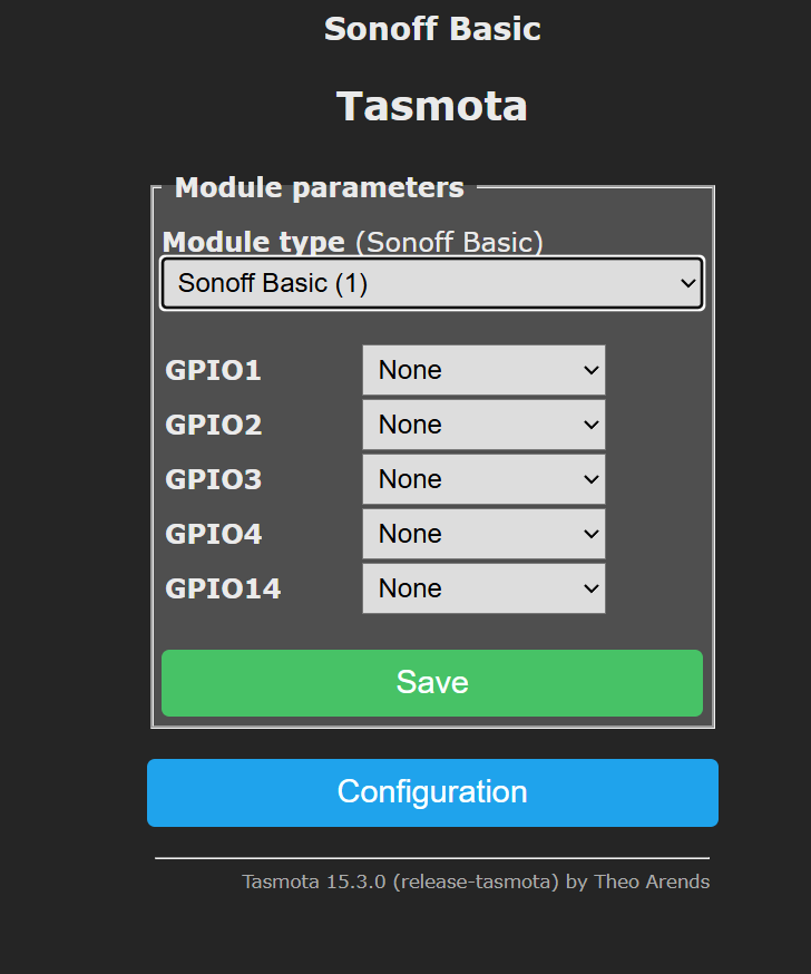

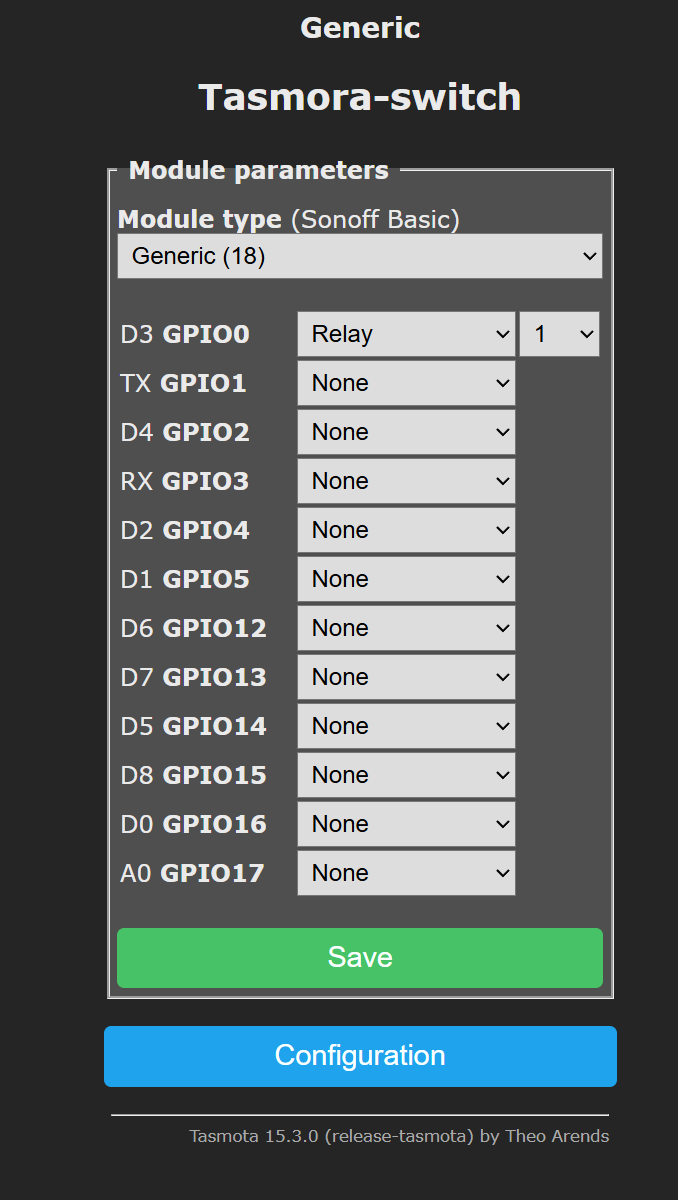

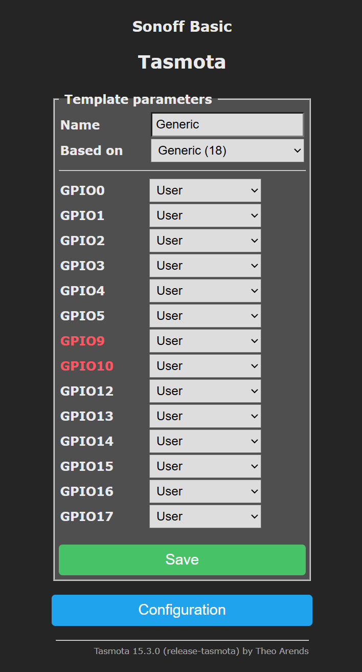

    Now I am trying to make this relay ON and OFF, but doesn't work, what I need to steup under module?
    Screenshot of Tasmota configuration for Sonoff Basic with GPIO dropdowns and a Save button
    Tasmota configuration screen for Sonoff Basic showing GPIO dropdowns and a “Save” button.
  • #52 21930652
    Posts: 14770
    Rate: 12913

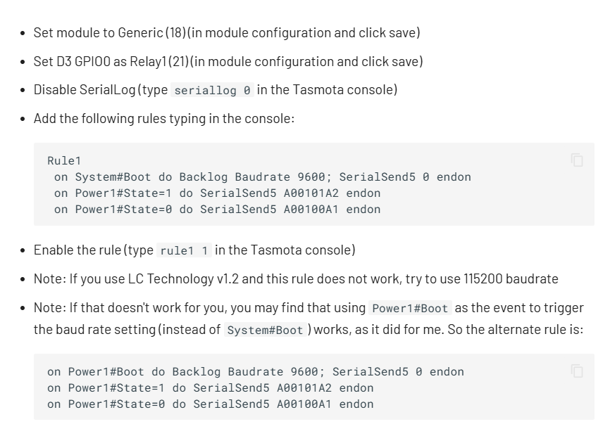

    I haven't managed to make a guide for it myself yet, but according to Tasmota page, you need to script it to use UART.
    Screenshot of Tasmota UART setup instructions with step list and console rules code blocks.
