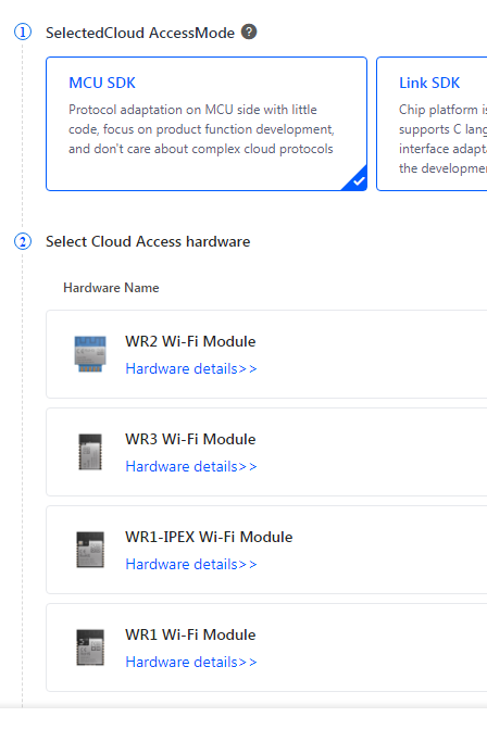

    Please tell me if it is currently possible to make it so that I can control the ESP8266 using the Tuya app?
    I have a free ESP8266 board and would like it to be seen in the Tuya app as a WiFi socket - that is, I turn on the socket and the relay connected to one of the CPU pins turns on. I would also need to be able to select which pin the relay is on.
    I found such a tutorial:
    https://developer.tuya.com/en/docs/iot/genera...ing-for-other-chip-platforms?id=Kamckr2dn7ku7
    But I'm stuck on step 4. Click Tuya Standard Module SDK and select TYWE1S or TYWE3S. Both these two modules use the ESP8266 chip. where I cannot find the ESP8266 module.
    Anyone has perhaps dealt with this topic successfully?

    People are figuring out how to upload an open-source Tasmota program to the ready-made Tuya modules, and you are combining in the other direction. The TYWE1S or TYWE3S modules are with an ESP8266 chip, this can work as with other modules on ESP8266. Tuya in the description of the TYWE1S module has the information that the chip is ESP8266EX, which is the same as I see in my ESP-01, they made their board, added FLASH and done.
    However, in the link of this topic you have:
    This topic has stopped updating, and the content is for your reference only. For more information about firmware flashing, see Flash and Authorize."
    Tuya doesn't use ESP8266 anymore, because I guess they were too easy to convert to Tasmot. I no longer see any modules with ESP when creating my own device:
    Screenshot of Wi-Fi module selection interface.
    Have you actually managed to get to the ESP selection or are you just asking so theoretically?

    Well, I've just managed to get to the modul selection, but I didn't find any for ESP8266 there.
    I mean, this way I won't do it anymore. Or would it be possible to upload something else that would make the ESP8266 module detectable by the Tuya app?
