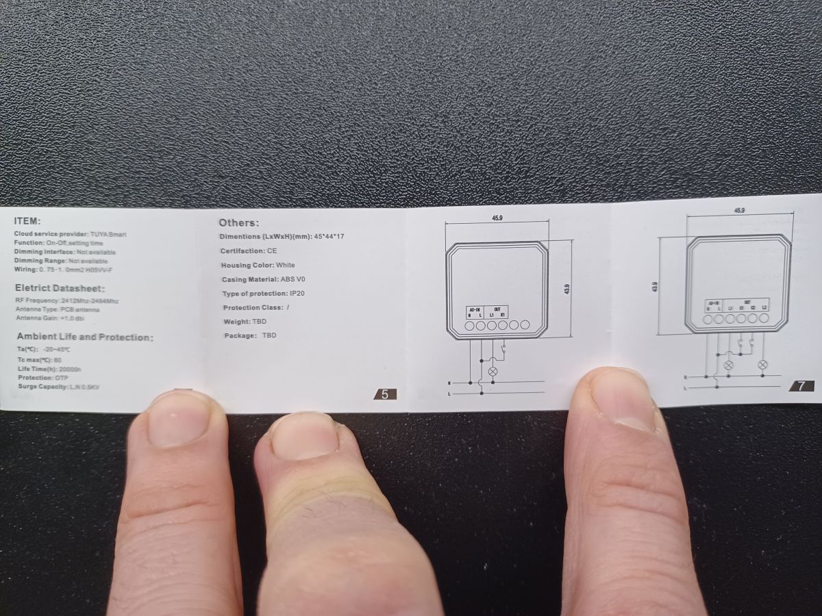

    These are pictures of the manual:
    User manual of a smart switch from Aliexpress, featuring technical data and connection diagram.
    User manual of a WiFi smart switch from Aliexpress.

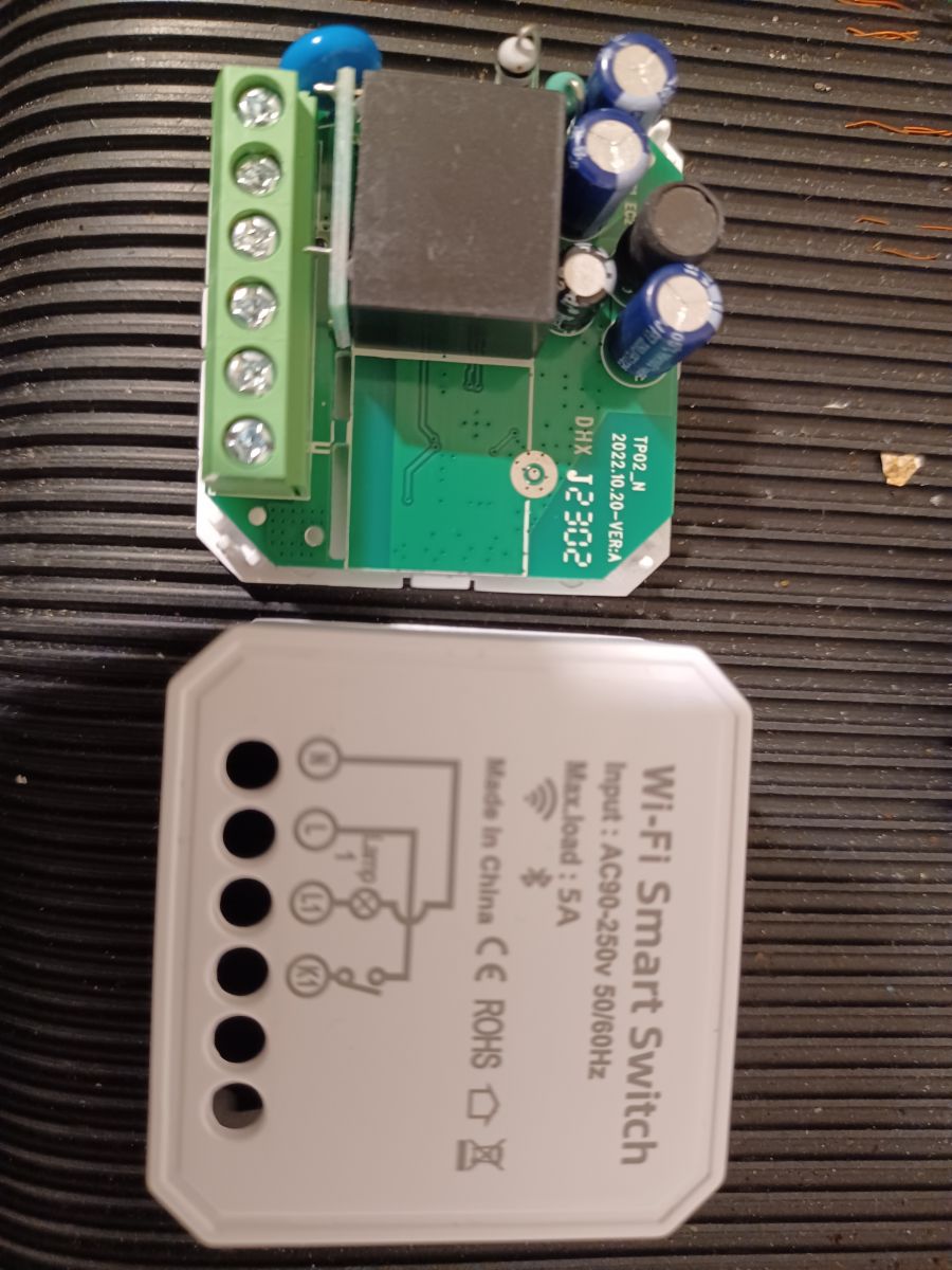

    The smart switch:
    Circuit board and casing of a Wi-Fi smart switch.

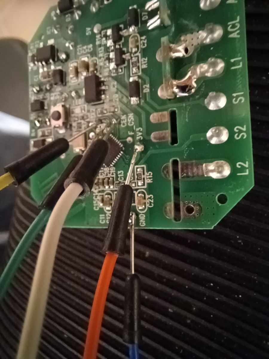

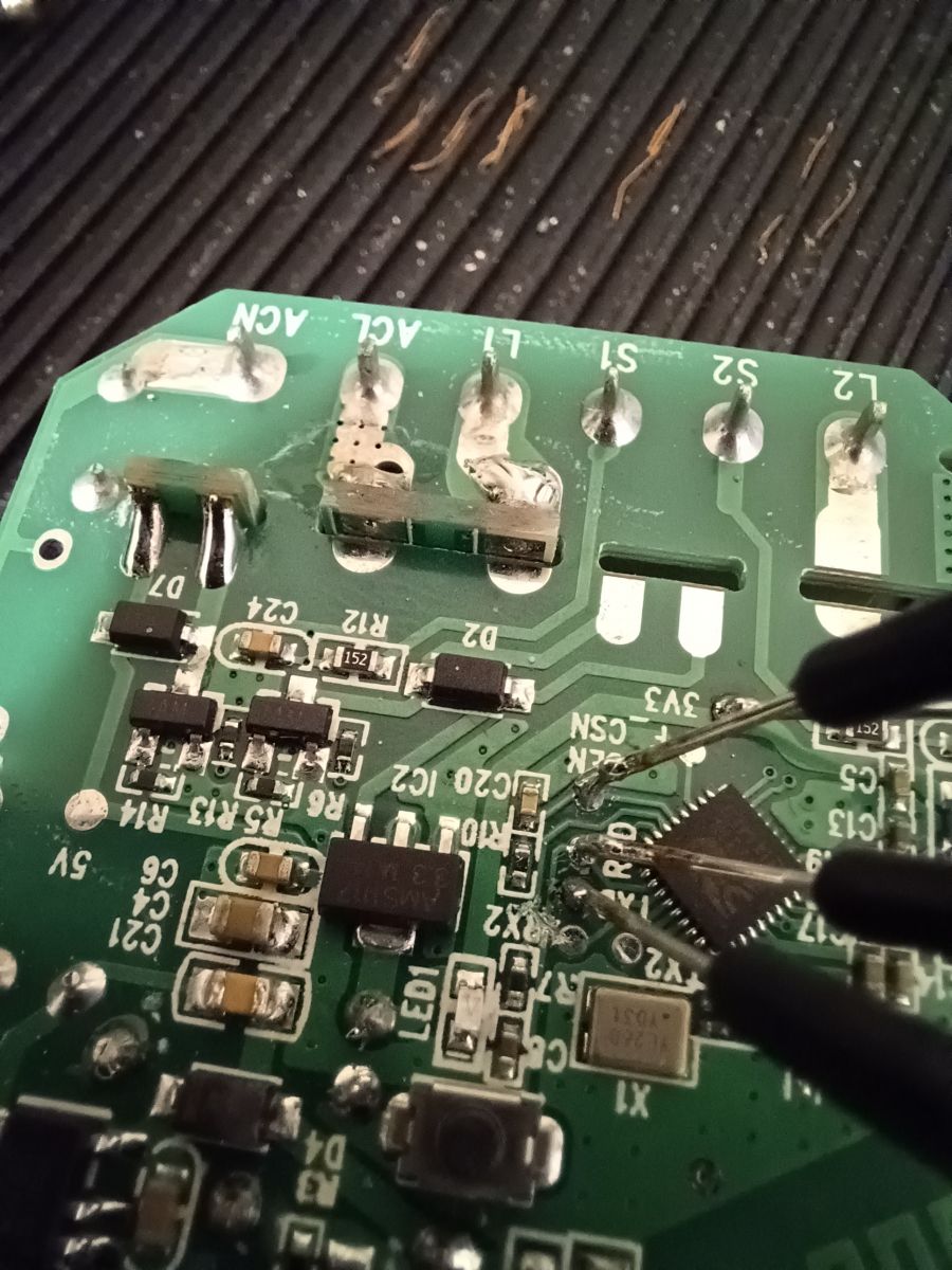

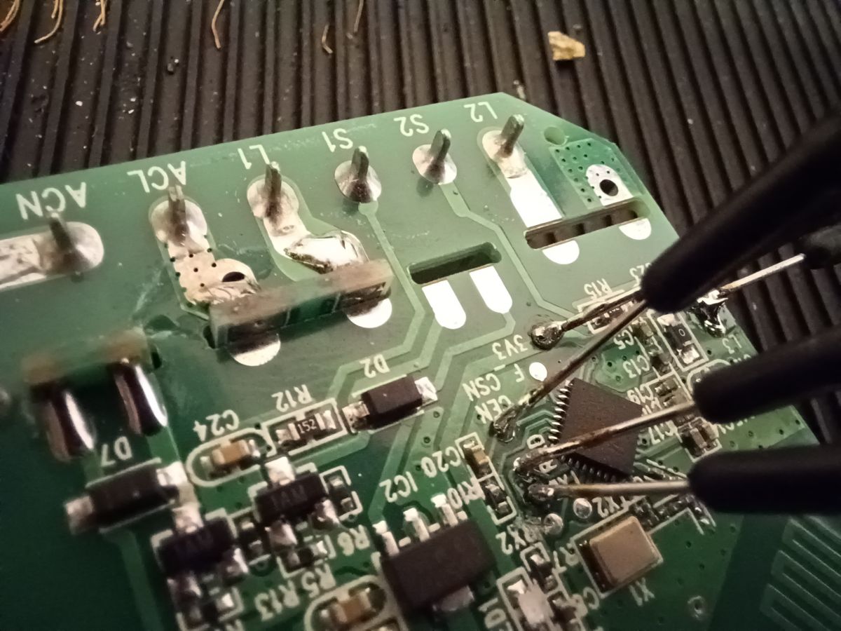

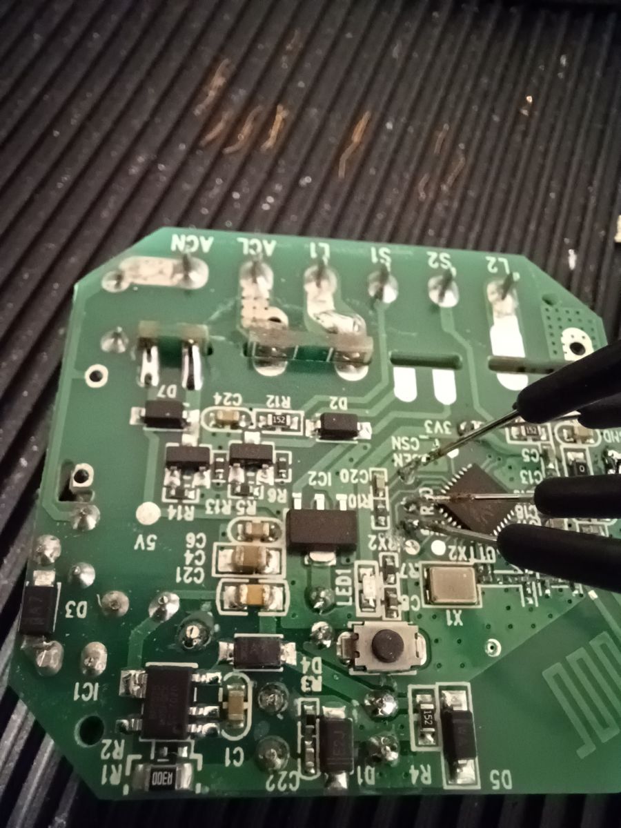

    In order to program it, I soldered, as usual, TX1, RX1, GND, CEN; I was not able to use the 3.3v power supply from my USB/TTL converter due to the fact that probably the board uses too much current! I used an external 3.3v power supply connecting both GND together.
    Close-up of a smart switch PCB with soldered wires. Close-up of a circuit board from a smart switch with wires connected to specific points. Printed circuit board of a smart switch with connected wires. Close-up of a smart switch circuit board with connected probes.

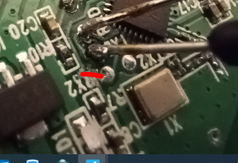

    The communication doesn't start until I cut the RX signal from the board (it was very difficult!)
    Close-up of a circuit board with RX2 marking.
    but, after that, everything goes as per your guide. The automatic configuration works perfectly.

    You had to cut RX1 signal from the board because P10 (RX1) is used for a pair button that may have debouncing capacitor.
    It's the same situation as here:
    Btw, here is GPIO config:
    Device seems to be using CB2S module, which is BK7231N chip.
    - Relay (channel 1) on P8
    - WiFi LED on P6
    - TglChannelToggle (channel 1) on P24
    - Pair/Toggle All Pin on P10
