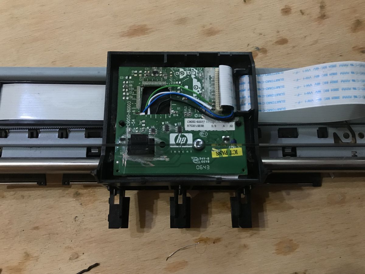

    Inside, we can see the moving mechanism of the carriage with two ink containers (which move along with it).
    Interestingly, this mechanism is based on a regular DC motor, not a stepper motor. At this point, you can't see it yet, but you can easily see it after dismantling the whole thing - there are only two wires going to the motor.
    The motor itself and the mechanism of the carriage are also screwed with torx screws:

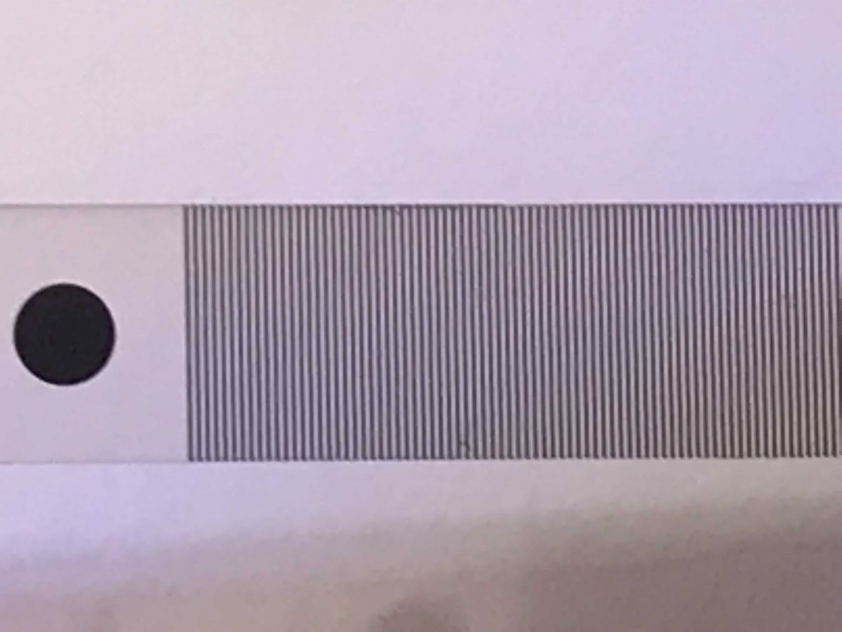

    The printer determines the position of the carriage based on the encoder (here this encoder is double - it has one diode and two phototransistors, but more on that later) which counts color jumps on the foil strip:
    HP Deskjet D1360 printer Teardown and step by step carriage control with Arduino
    Now I will show these stripes up close. I had to use better lighting and background (white sheet of paper) to take this photo.
    Here's a foil strip (so-called 'encoder strip') in a good quality photo:
    Here with zoom:
    And with a bit more magnification:
    The stripes are clearly visible.

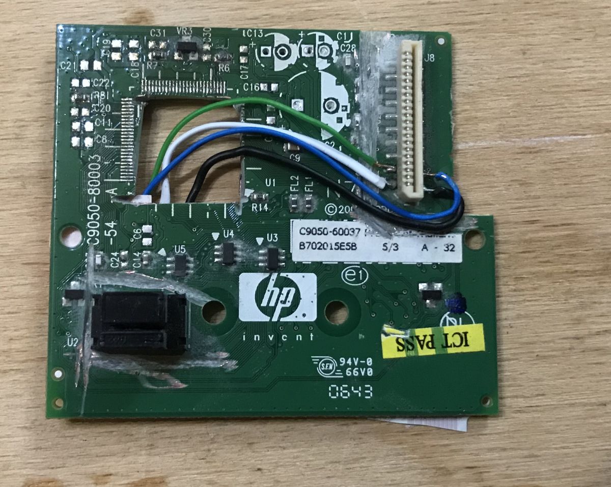

    Encoder pinout from carriage
    The first thing that interested me was the encoder that allows us to determine the current position of the carriage. The encoder has a slot for the previously mentioned strip:
    This encoder has 6 leads, two on one side and four on the other:
    This encoder contains one diode and two sensors. I have sketched its diagram below:
    Between the diode and the two sensors, the previously shown bar moves - while moving, it covers the sensors (sometimes one, sometimes the other, sometimes both), which allows us to determine its movement and thus the position of the carriage.

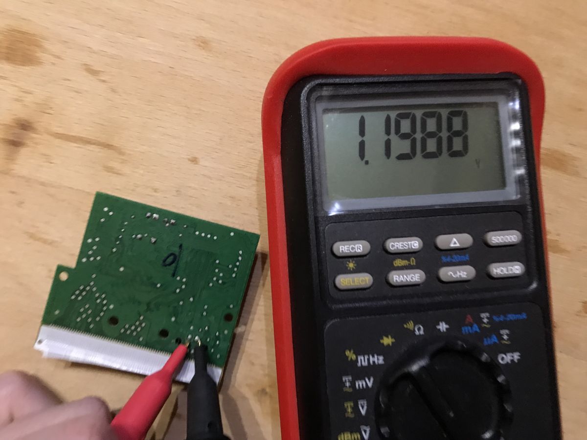

    The encoder pins themselves are not marked and I was unable to find its documentation on the Internet, although I found information that they are not standardized and may vary depending on the printer model.
    That's why I think it's worth knowing how to determine which pin is which.
    You can start with the simplest - mass:
    This pin, of course, will be connected to the mass of the entire system / mass screed on the board. In the picture above, I show that there is a direct connection between the selected encoder pin and the test ground pin on the PCB.
    Then it is worth recognizing VDD - power supply - in my case it was on two pins:
    The fact that it is VDD can be guessed by elimination. If it is not mass, what else can be on two pins in such an encoder? Just the power supply - VDD. It is connected both to the diode from the encoder and to the phototransistors from it. VDD is also often connected to the + electrolytic capacitor.
    Next, I made sure of the diode leads. They are on one side of the encoder where there are only two pins. I used a diode test in my multimeter for this - it shows the voltage drop. Of course, the diode conducts only in one direction, the other side of this reading will not be.
    At this point, it is possible to determine which pins (the other two) are the signal outputs of the sensors using the elimination method.

    Then I made connections directly from the encoder pins to the ribbon connector pins. For this I put a resistor there:
    HP Deskjet D1360 printer Teardown and step by step carriage control with Arduino HP Deskjet D1360 printer Teardown and step by step carriage control with Arduino
    Finished carriage board:
