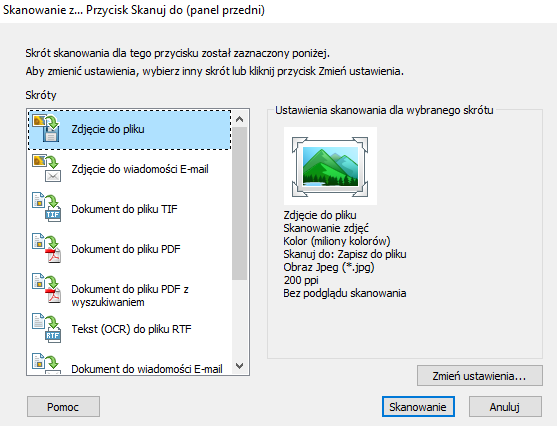

    It looks the same for me, but it doesn't save. Immediately after the scan, the scanned page flashes for a fraction of a second in the upper left corner and that's it ... I have Windows 7, maybe that's why? I do not know what to do...

    It is possible that via win7 .... You can try to set the applications to the mode of compatibility with windows7, otherwise you have to look for other replacements for HP, e.g. NAPS2 etc.

    I was also surprised, I have an HP 4370 scanner, in the software I found and launched c: \ Program Files (x86) \ HP \ Digital Imaging \ bin \ hpiscnapp.exe. The window opened as usual, I scanned it, saved it to pdf and ok.
    I have installed NAPS2 - IT WORKS !!!!!! :) :) :) Thank you very much for help !
    For me, the same file also works and scans.

    I have a Win10, 32 bit, Hp Scanjet 3800 scanner.
    I tried NAPS2 and HP Scan Extended, also HPiscnapp.exe from the bin directory.
    However, all this did not provide the same possibilities as the original program.
    So, in another computer, where by some coincidence there was no Flash Player cutout, I found the C: \ Windows \ System32 \ Macromed directory.
    I copied the Flash directory and replaced it on my laptop. Everything started and works the old way. I hope it won't be cut anymore.
