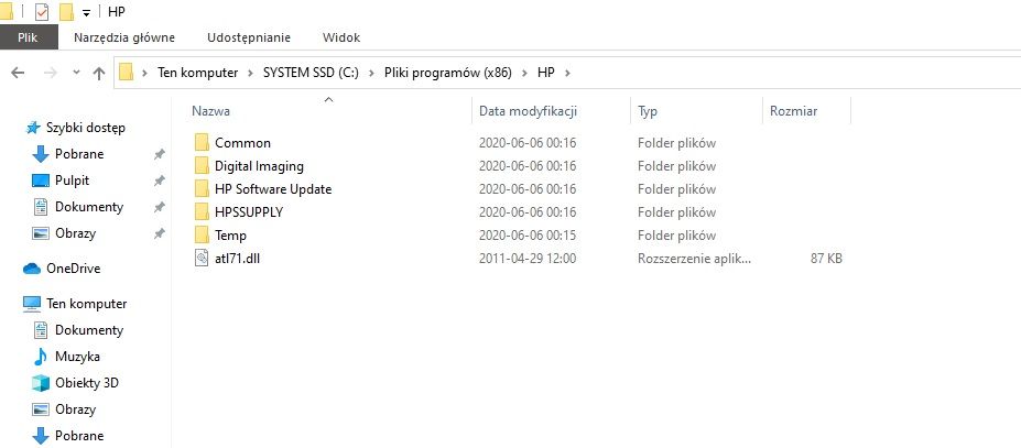

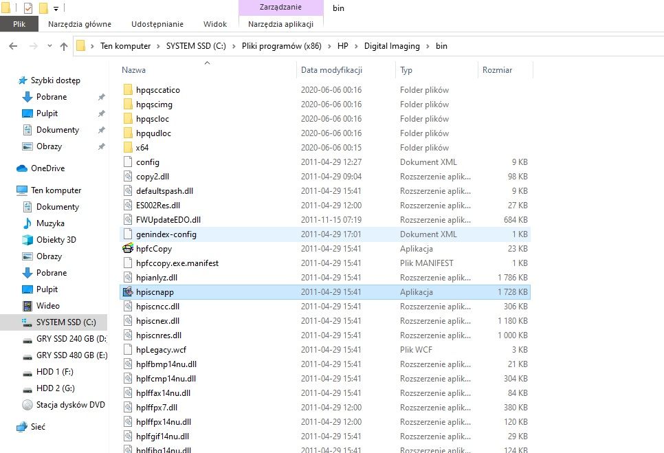

    For me it is like this:
    HP Support Center does not work due to the lack of Adobe Flash Player support.
  • #16 19196185
    vfdbfjjkt
    Rate: 16
    Which one, the main HP or another? Because like everyone under hp and there are over 70 of them, I probably prefer to rewrite Pan Tadeusz :(
  • #17 19196188
    bogdanzieba
    Posts: 3202
    Help: 5
    Rate: 982
    I am just looking for those proposed by you with the .exe ending and I can not see anything.
    Edit. I found it and I scan it :)
    The path and the selected application scans images and documents :)

  • #21 19196914
    Tunias86
    Rate: 22
    Unfortunately, this file can be scanned, but only single pages and for me only as an image, not a pdf; (
