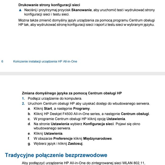

    Hello, do you have an idea how to enter the network configuration menu in this printer? It used to be possible to do this through an HP Service Center, but it is known to not work.
    I would like to configure it to work on the network, but unfortunately I cannot.
    HP Support Center does not work due to the lack of Adobe Flash Player support.
  • Flash Player workaround restores HP Support Center on Windows 11
