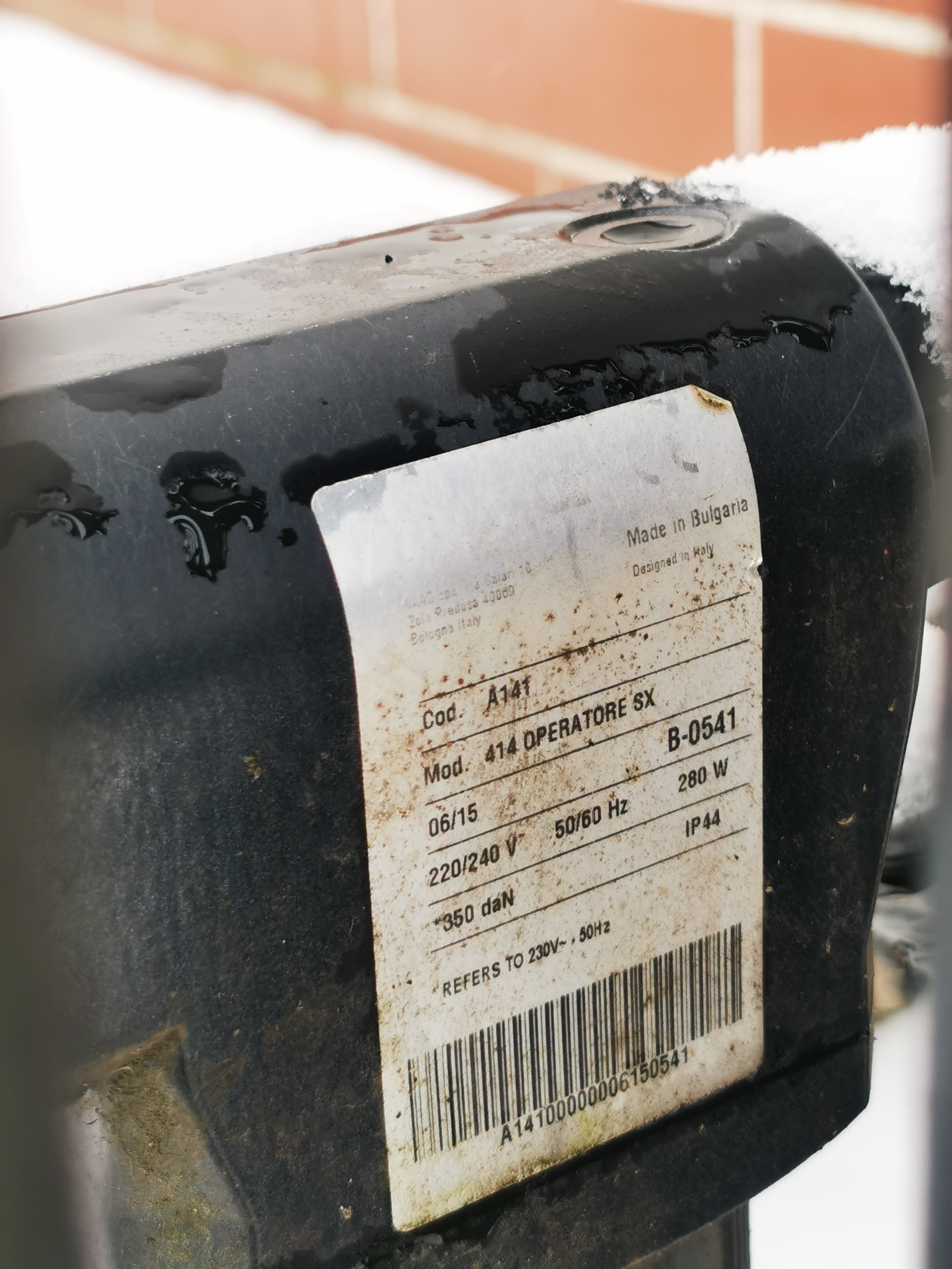

    Fellows I have a FAAC 414 operator and would like to fit LED lights /lamps on the posts so that they light up when opening and light up when closing.
    Where to connect? Which PINs? 7 i 8?

    Which switchboard?
  • #5 19199416
    Songoku8
    Posts: 71
    Rate: 13
    faber wrote:
    Which panel ?

    Yes, 7.8 FAAC 414 how to make the entrance light during opening and closing? .

    Outputs 7 and 8 are where you need the voltage. We usually connect a flashing (warning) lamp there, but this is not a requirement.

    Pay attention to the max load of this output - 60W. If using a higher wattage light source then use a relay, contactor, etc.
    Connect a light bulb for a test run and see if this is satisfactory. You can add e.g. extension of the operation or a light sensor (it can e.g. shine longer to get to the door, or e.g. not switch on when it is light).

    Regarding that 60W output, with led lamps, just give two 10W each and it will be bright enough. Besides, the lamps of the car also shine.
