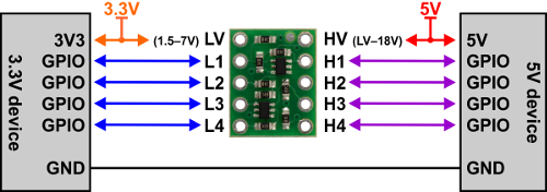

    I did some more searching and found the Pololu2595 - a logic state converter. The operating diagram looks more or less like this:
    ESP8266 Node MCU v3 and LIKA SMAX-MB-PRG-L2 linear encoder: displacement measurement in IoT .
    All you need to do is provide the supply voltage for the sensor on one side, the esp on the other and short the grounds. I'm just wondering if it has to be the same power supply pushed through some kind of stabiliser, or if it can be 2 separate power sources. In other words, can I connect the ESP to a 3.3v power source and the sensor to a separate 10v power source and short the earths? What could be the consequences of doing this?
