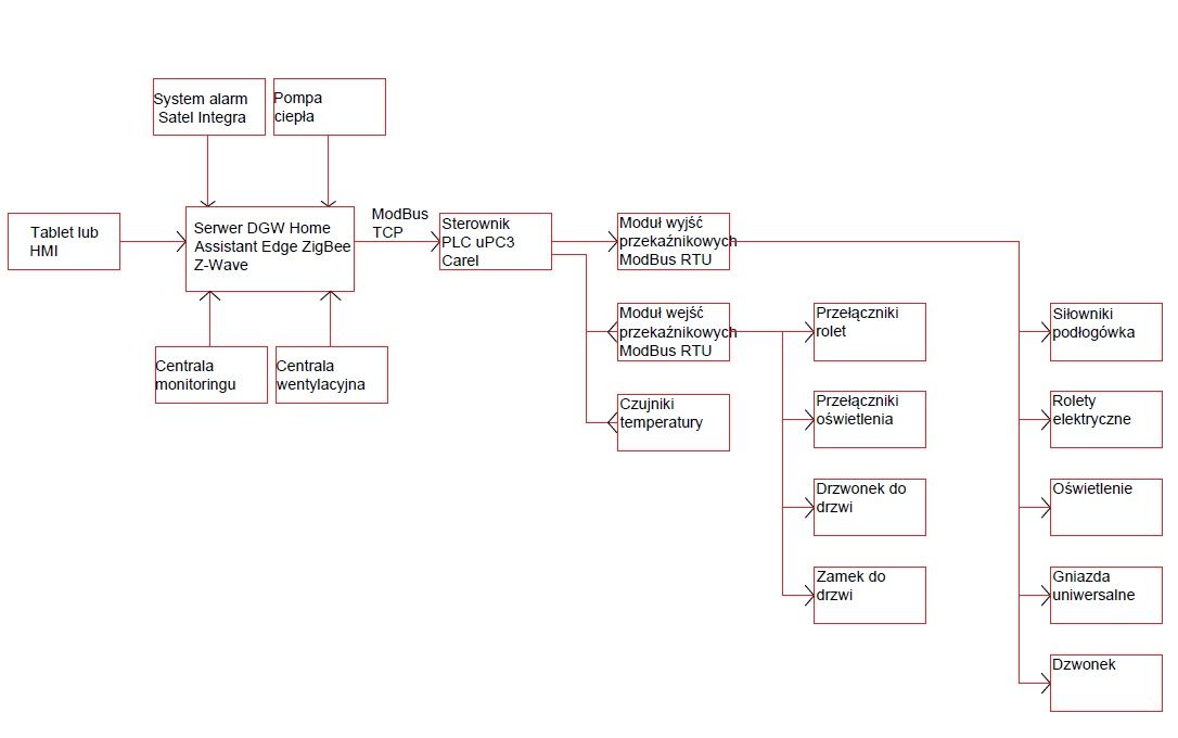

    I generally have 2x Carel PLCs with 12 AI, 10 DI, 12 DO, 4 AO also they would not be a cost.
    Hence I would want a Carel PLC + cMT from which I would make a SCADE. In addition, the display would be somewhere in the corridor.

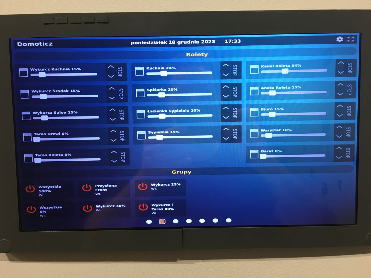

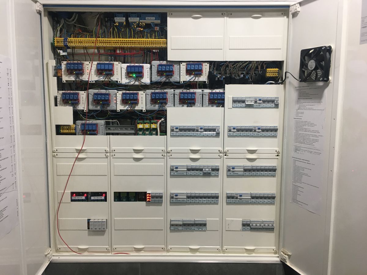

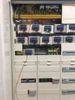

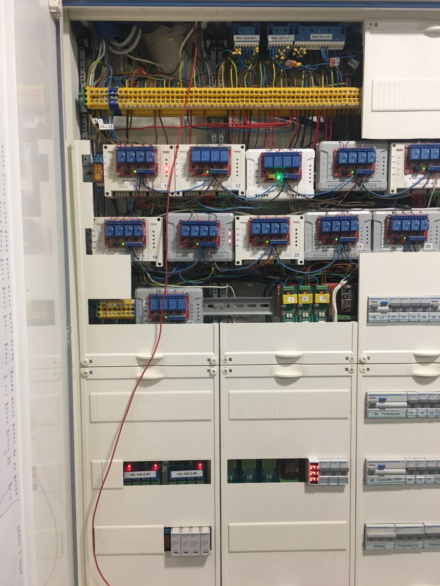

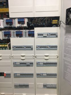

    ad 1. I have 14 roller shutters control on modules shelly 2.5 cool percentage opening / closing work in the cloud and possible integration with Domoticz and HA. Now new shelly 2.5 PM dice have come out. As far as the installation is concerned, I have connected wires from the motors to the distribution board and from the local control buttons to the distribution board, thanks to this solution I always have access to the controllers and their quick servicing, replacement or complete reconstruction of the roller shutter control.
    I think the idea of not making switches on the walls at the windows for local control is quite bad because while being in the room I want to cover one roller shutter and search in the phone by applications he he defeat.
    What about the controllers schelly 2.5PM - 150zł ready software nice working cheaper while there are sonoff dual R3 based on ESP8266 but the program must be loaded to the blinds well but cheaper 50zł.

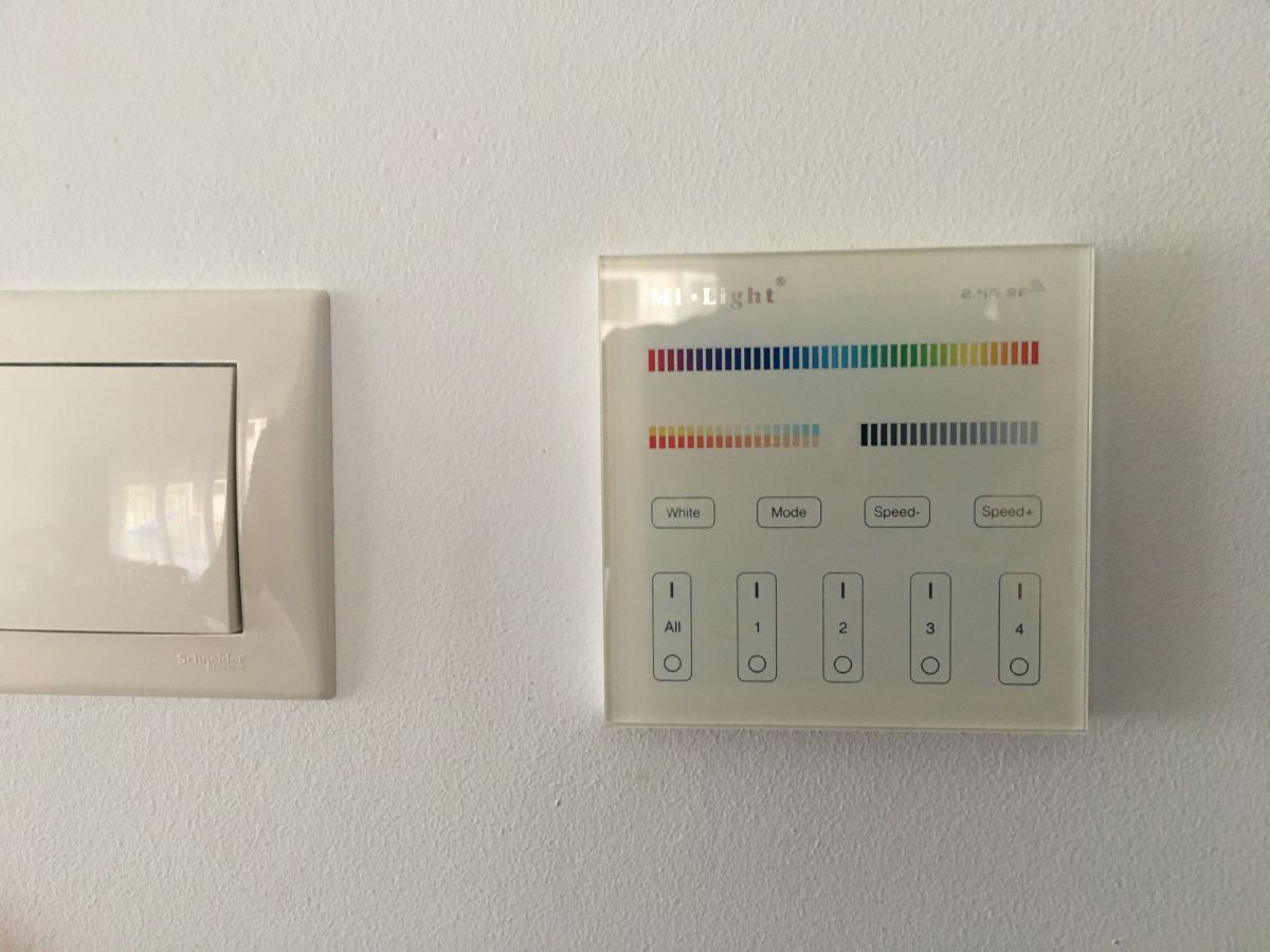

    ad 2 Lighting you have to choose according to you I pulled the cables from the lamps to the switchboard and in the switchboard I have sonoffs 4CH which on the basis of the AFE software control the lighting.

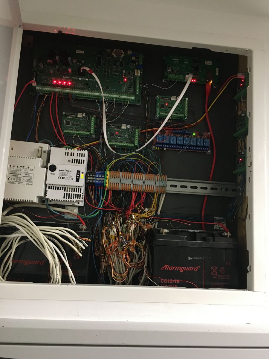

    ad 3 Satel Integra using ETHM integrates with Domoticz and sends all data to it works for me alarm sensors are used to turn on the lights and to collect information such as whether there is someone in the house or in which part of the house is present so you can turn on and off various devices. I recommend Satel has logic functions so that you can also automate something.

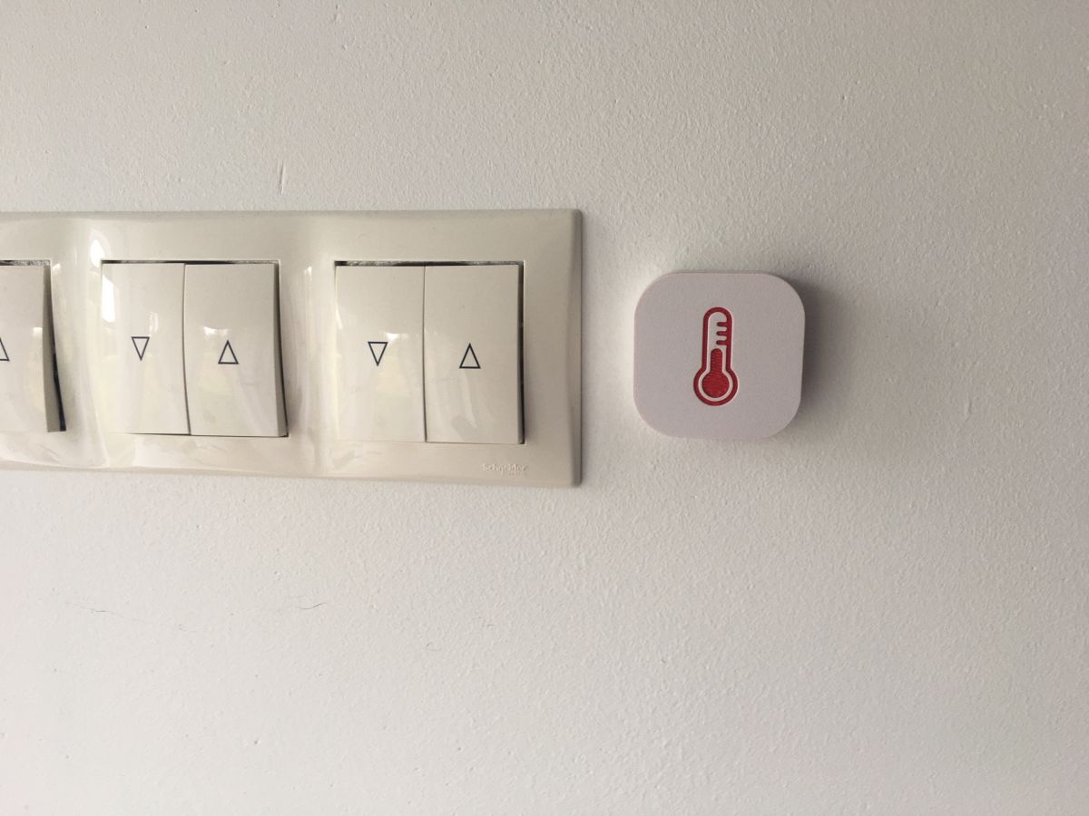

    Ad. 1 Ok, so local switches for roller shutters remain. You are right. The shelly 2.5 module costs a bit, but replaces 2 modular contactors and can be mounted. I'll consider it.
    So generally you have control of the roller shutters over wi-fi, but in case of emergency, the wires are pulled up to the switchboard - forward thinking.

    I mean, however, I will use switches for lighting and roller shutters. I'm thinking of simply connecting them to the DI inputs of the controller.

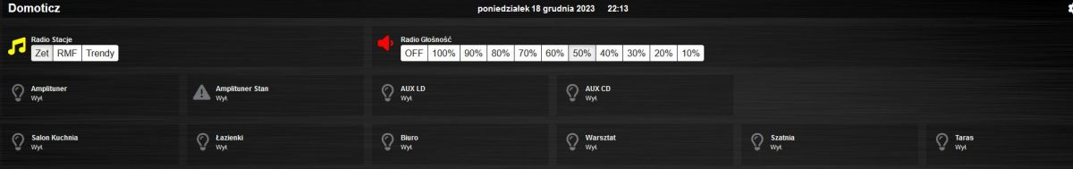

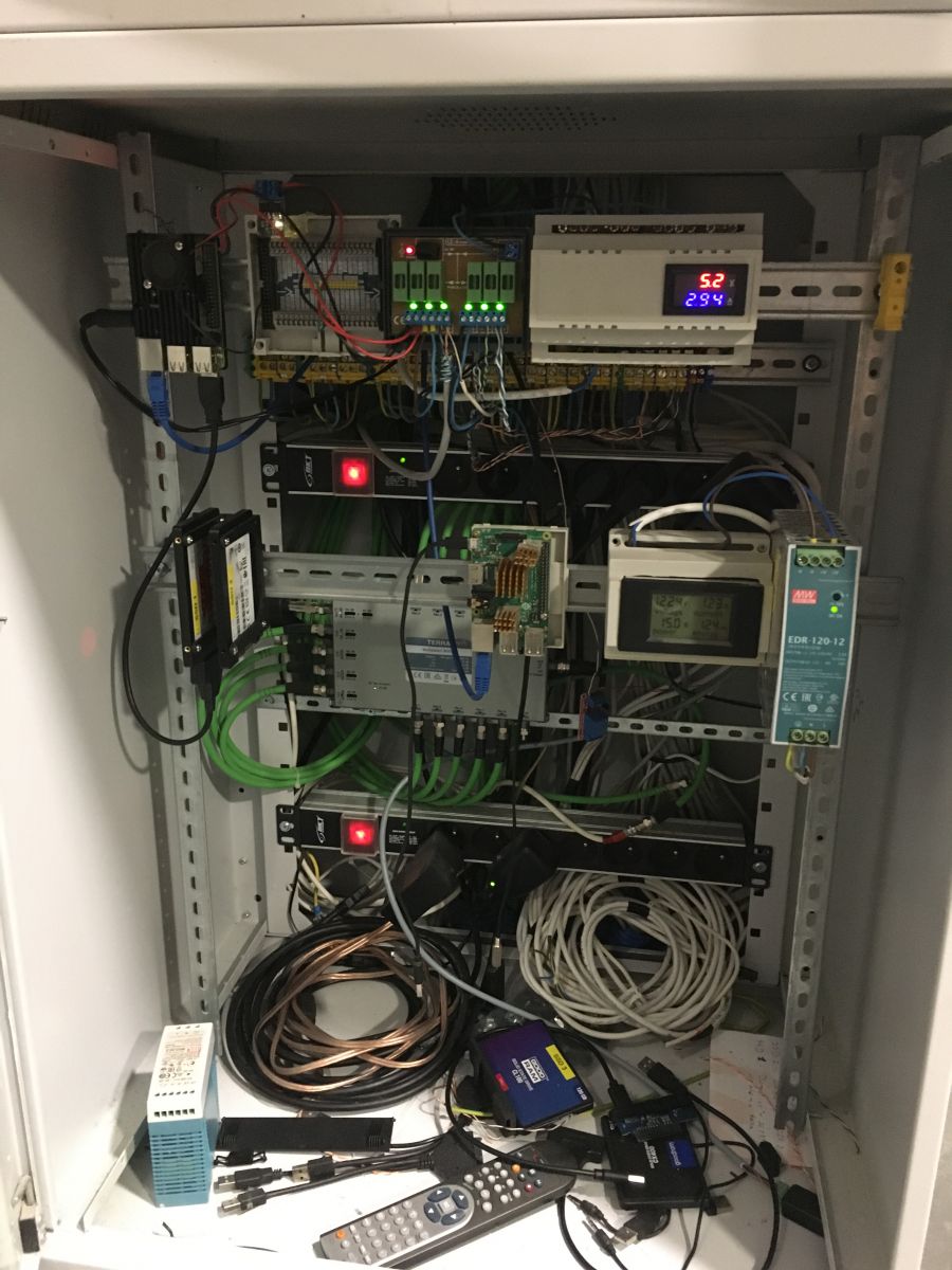

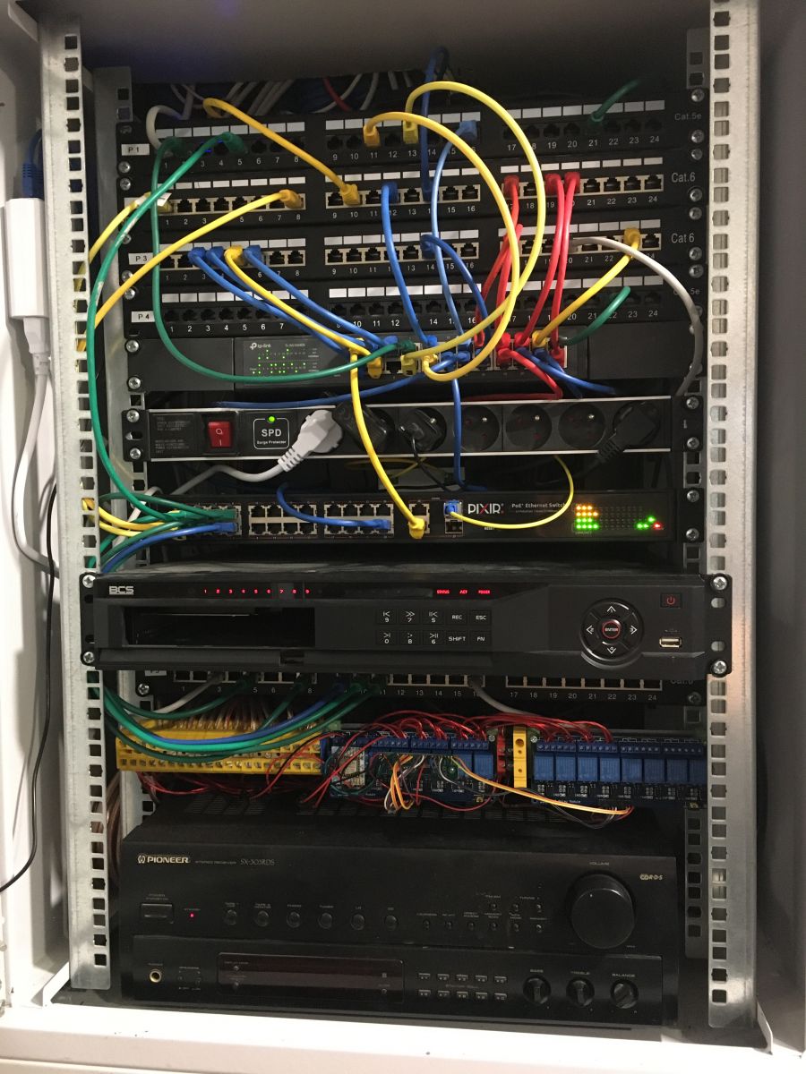

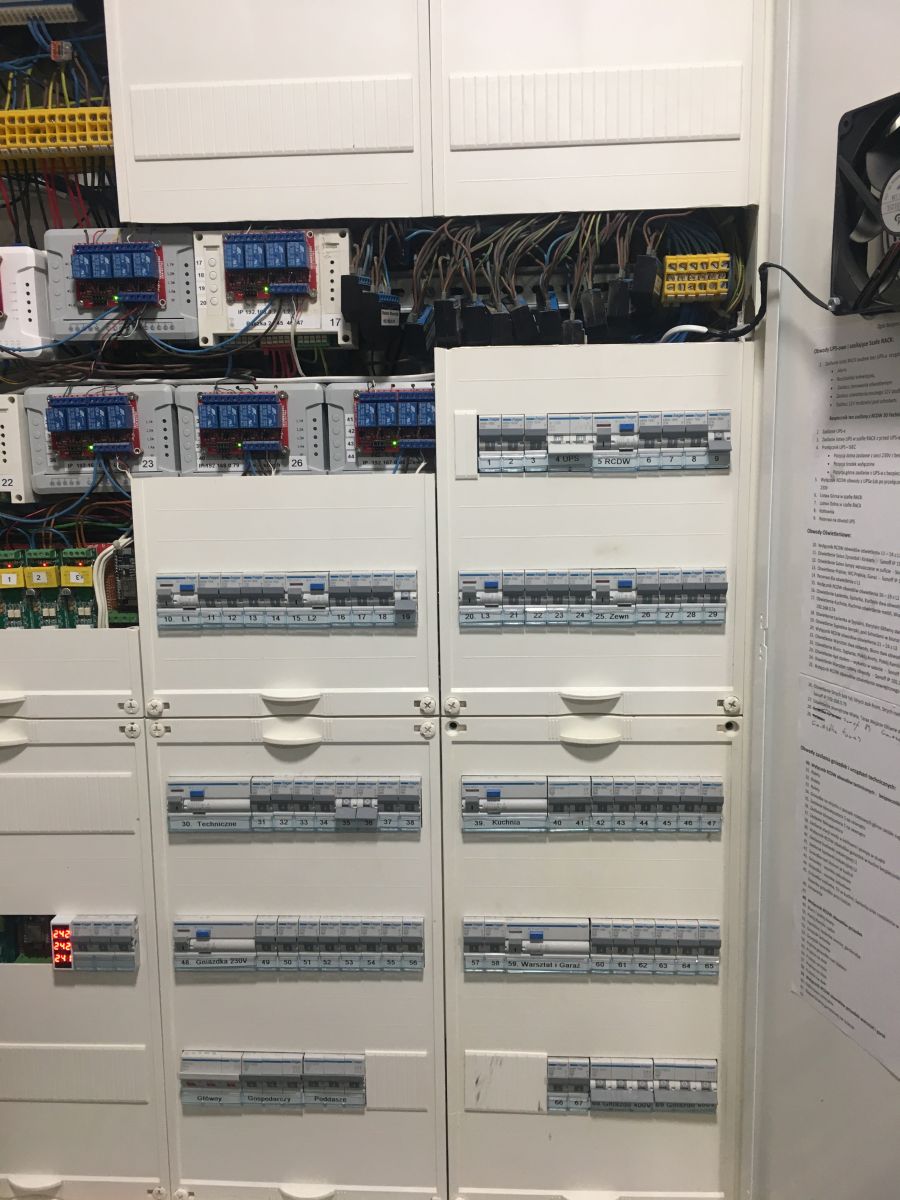

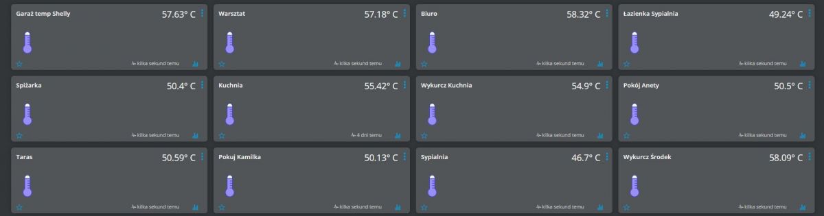

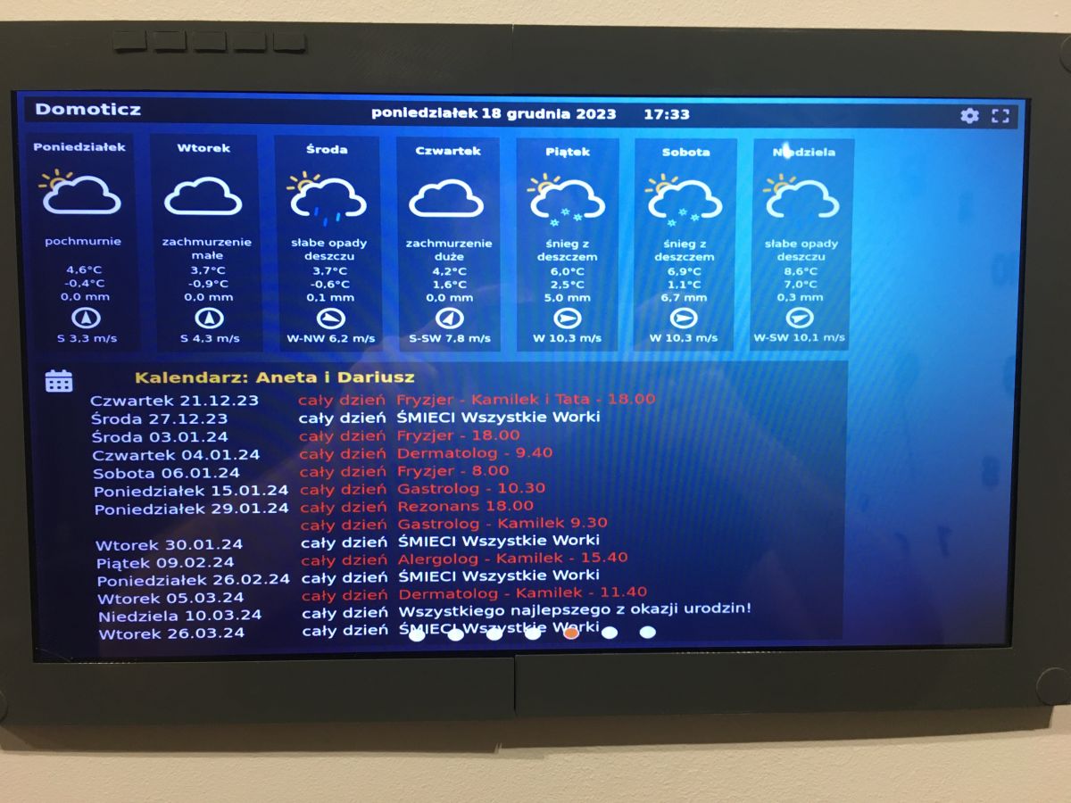

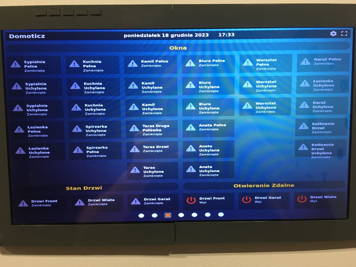

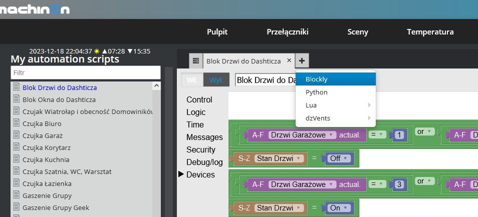

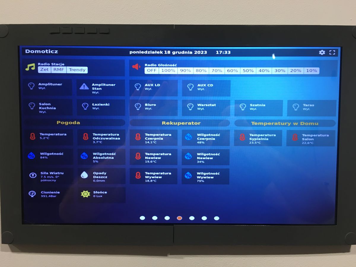

    Domoticz and HA are systems with their own desktop.
    They can run on anything even on an old laptop some people put or for example on a synlogy file server I put on a Raspberry and SSD.
    With stability there is no problem wakes up normally after power resets.

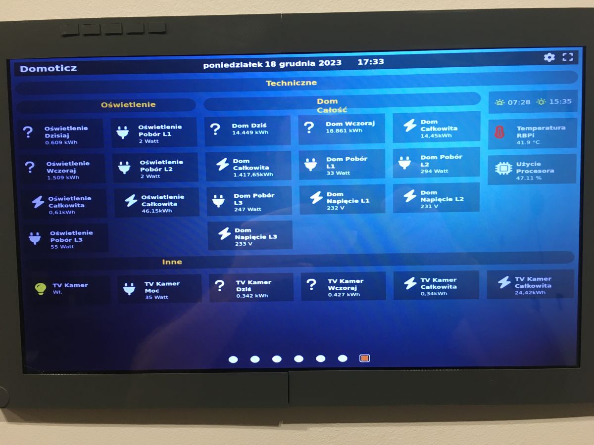

    If you are programming a PLC then you would certainly cope with these systems Domoticz has blocks and others see:
    Screenshot of Domoticz user interface showing automation scripts.
    If it comes to stability in the subject of the whole thing then:
    Worse e.g. with stability after resets of 230V power supply of other devices e.g. shelly or sonoff sometimes like to fall into configuration mode or restore itself to the factory, but this is not every piece and not always at home on 14 sonoff 4Ch such happened to me in total probably with 3 pieces so I replaced them while with shelly bigger problems because they heat up therefore I do not recommend tight boxes. In my case the electrolytic capacitor failed (and still sometimes fails), after replacing it again the shelly cube works without any problems. I have already replaced it in about 8 out of 14 shelly units, maybe that is why a new version of shelly 2.5 PM was released, precisely because of this type of defects. Sonoffs I also see newer and newer in total I have with me three different editions died those first copies.
    No but when it comes to the price of the shelly 2,5 I bought at 90PLN sonoffy 4CH at 60PLN so at such prices there is no need to experience a fallen piece.

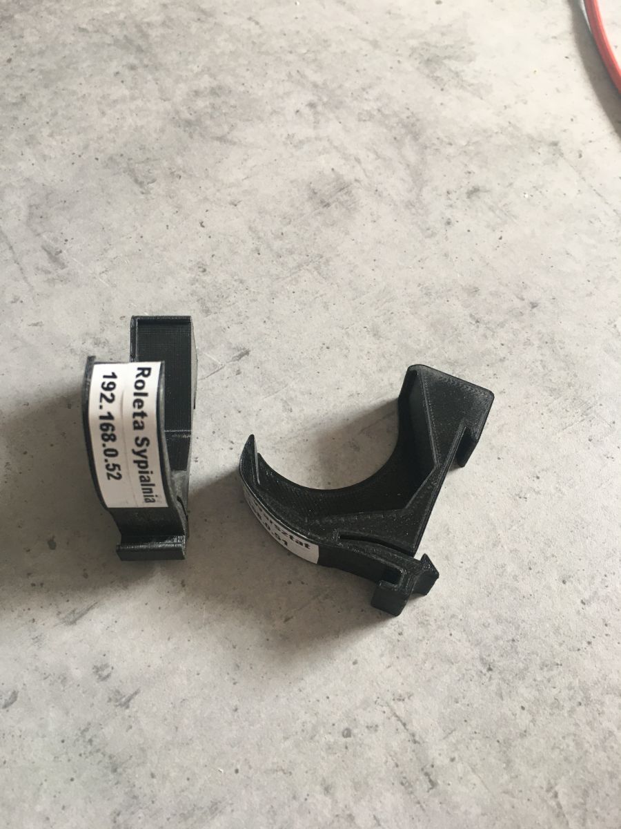

    Recently I noticed that they also make roller blinds on the sonoff dual which costs 50zł so much cheaper than shelly with the fact that you have to software yourself.
    As far as Satel is concerned, there is nothing to say here, stable as a rock for years. But it has its own emergency backup.
    On the Sonoff 4Ch I have loaded the AFE software in general sonoffs all easily flashable.

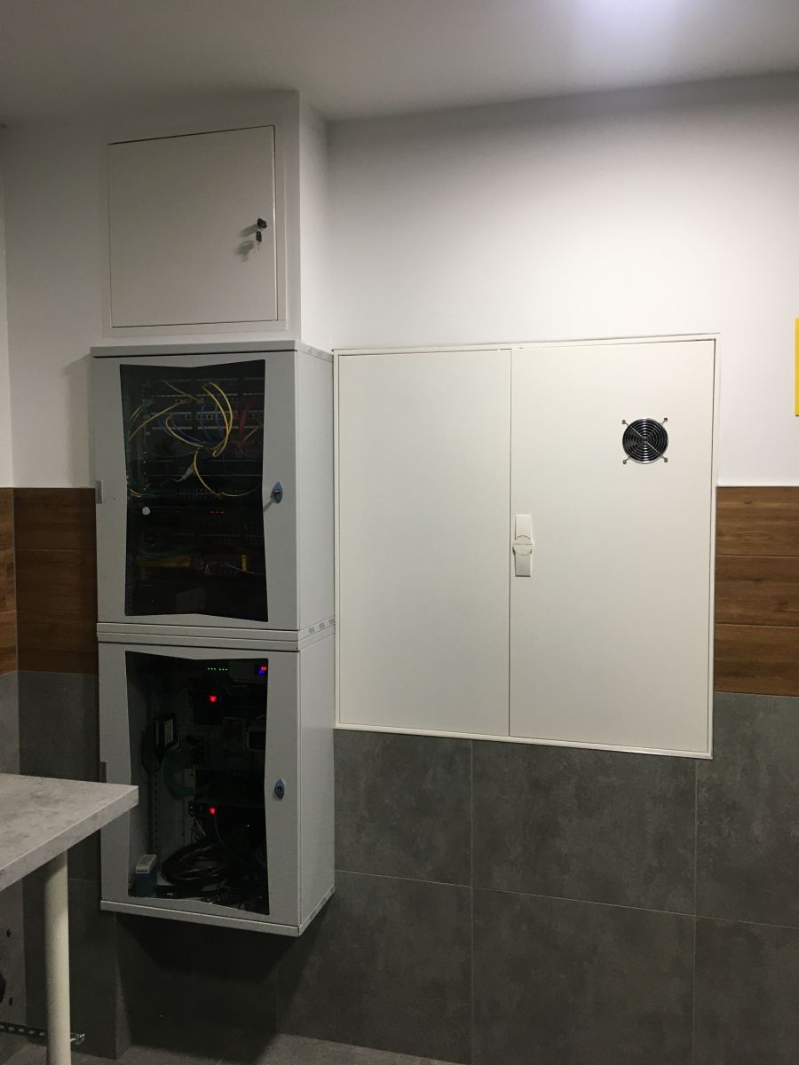

    The sound system is 100V 12W ceiling speakers and for this I used an old Pioneer I soldered under the buttons on/off, aux, etc. thanks to this controls the sound system remotely. Yes I know 100V is nowhere near a normal amp but I found if it dies I will buy a typical HQM.

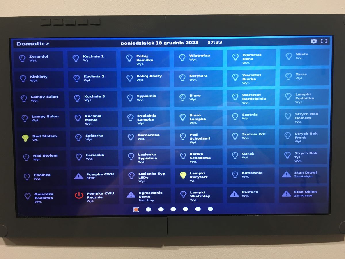

    Control from the desktop:
    Screenshot of Domoticz interface showing radio and lighting control options.

    I originally planned to do the electrical supply switchgear on the PLC, plus the PLC control switchgear + modular contactors (or relay modules with modBus RTU)+ telecommunication, but despite the small house, I was coming up with some "big cow" switchgear.
    And here throwing in these shelly 2.5 or SonOffs, I throw it into a can and I have a much smaller switchboard.
    What about this HomeAssistant and Raspery, I have never programmed in C or Python, mostly when I worked it in FBD or some functions in SCL (ladder I skip).
    Won't this be some kind of obstacle
    I also saw on the channel "SmartMyHome" a video where the guy on Beckhoff made a house and HomeAssistant.
    Visualisations and sensors wireless over BlueTooth and Zigbee and the whole system in a PLC.
    How do you approach such a solution?

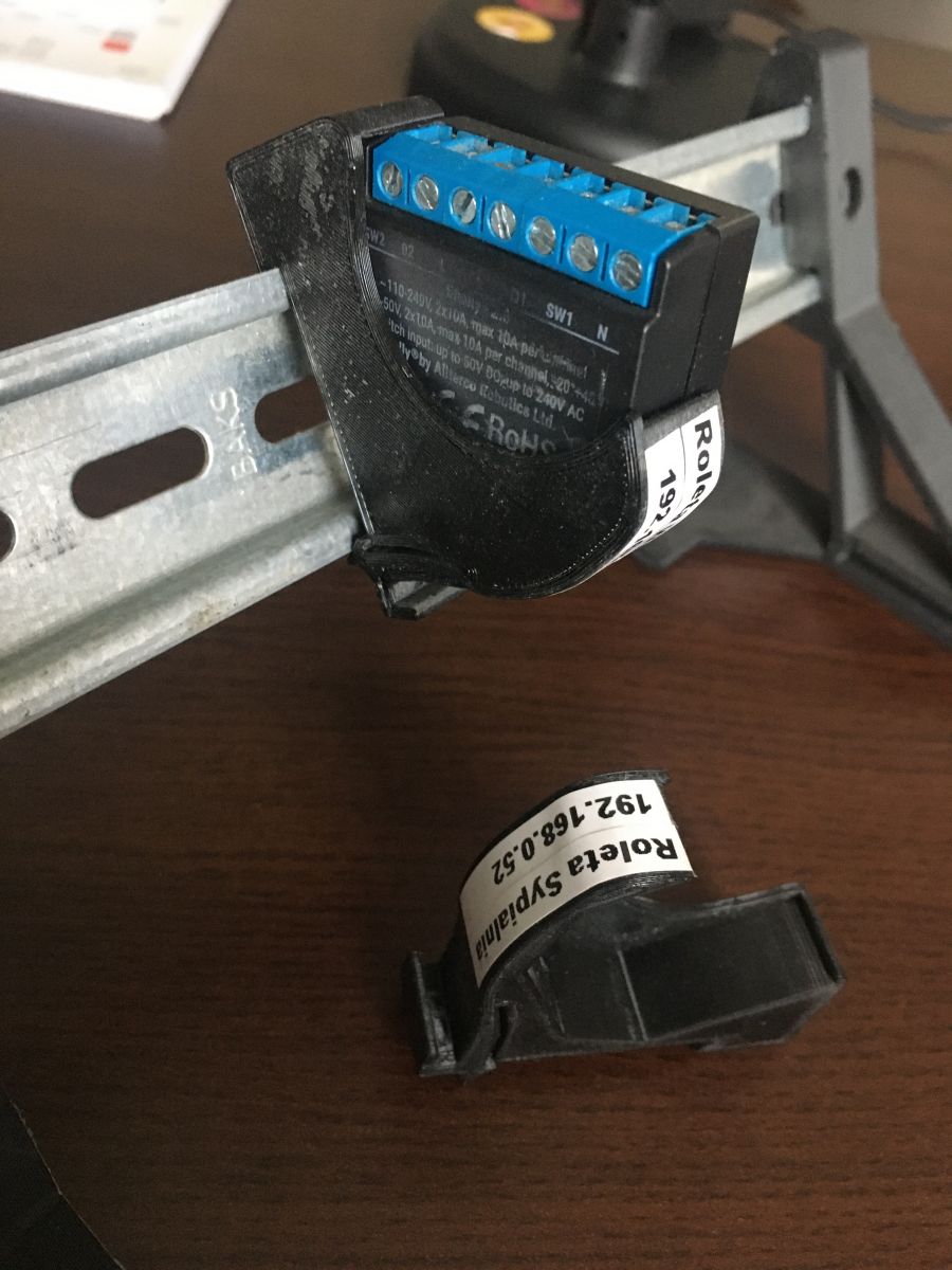

    3 years of use one year time of construction two years I almost live and problems:
    - replaced 3 sonoffs 4ch after resets of mains power sometimes fell into configuration mode so I replaced them at a cost of 100PLN new so it was a waste of effort.
    - out of 14pcs shelly 2,5 two died irretrievably in 3 years while in about 8 I replaced the electrolytic capacitor and they work well, well that is their charm not all designs are successful a new version came out certainly improved
    - problem with the Raspberry heating up in the summer - fan fixed the issue.
    Acurate such problems I would not worry about, the bone is dead and that's it, everything unfortunately breaks.

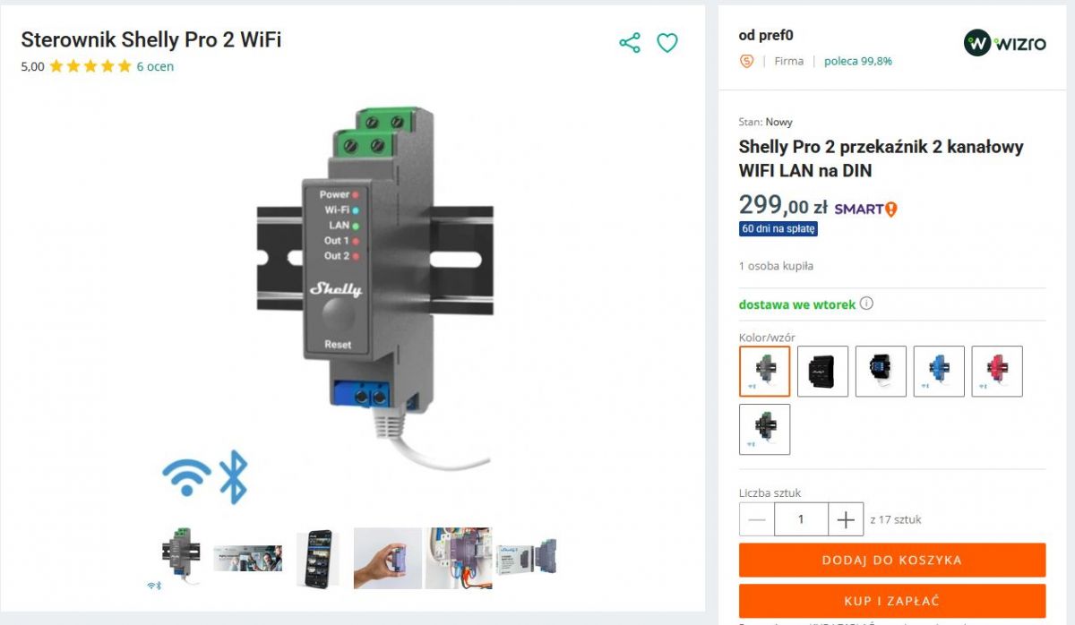

    Of course there are controllers for LAN such as shelly 4 PRO or roller shutters is also on the rail and with a LAN plug, but the prices knock me out at least because shelly 4 PRO costs PLN 600 and supports 4 bulbs and sonoff 4CH costs PLN 100 and also supports 4 bulbs.

    P.S Can you post a photo of the switchgear, how does it look like in you?

    Shelly controllers overheated when mounted on rail brackets
    #14 20872166
    Daro1003
    Posts: 2716
    Help: 295
    Rate: 608
    Where did the 120 devices in the network come from? I'd have to list them all, but in general it's 14 roller shutter controllers, 17 lighting controllers, 2 Rspberry's, 5 ESP's for temperature and lux intensity, a vailannt cooker, a recuperator, a satellite ETHM, a dishwasher, 5 routers - wi-fi and lan access points, two DVRs (including an outbuilding), POE managed switches, 2x managed LAN switches, 16 IP cameras, 2 satellite decoders, games console, chromecast, network multifunctional device for printing scanning, SP111 sockets and some other ESPs I've forgotten about and they work somewhere in the background for something. You'll see it will add up.
    Berend wrote:
    And how is the longevity of this domoticz or home assistant, I know it's fortune telling, but I also don't want the company to die in 10 years or something.
    In this regard, I know as much as YOU do not know what will be in the world the same can be said of any other company The only certainty is how you have a switch and a bulb old reliable installation. I just have to install in the switchboard 12V relays and 12V power supply and the usual switches will turn on the relays and relays light bulbs all the cables I have in the switchboard so only to string therefore I think pushing in the control boxes is a poor idea.
    A few pics I have allocated such an angle in my workshop but for the moment I would definitely do it differently.
    Cabinet with control modules and wiring on a workshop wall.
    Server rack with cabling and networking devices. Server cabinet with network devices and wiring.
    Interior of an electrical cabinet with controllers and wiring.
    An electrical box filled with electronic devices and controllers, with a mounted fan. View of an electrical cabinet with installed Shelly controllers. Electrical panel with numerous shelly controllers and cables in a workshop.
    As you can see the mess on the shelly controllers but when they were mounted on the brackets nicely on the rail they heated up terribly so they were detached from the brackets and hang loosely so that there is air ventilation and they are sometimes cooled down by a fan when their temperature rises. Shelly controllers share their temp in Domoticz so making the fan control was not a problem.
    There is still a screen in the living room:
    Domoticz system screen showing a list of devices and their statuses. Domoticz system screen with various controls for managing devices. Computer screen displaying the Domoticz interface with information about the status of windows and doors in a house. Domoticz system screen displaying energy consumption and technical statistics. Screen with Domoticz interface displaying temperature, humidity, and device status in the home. Living room screen displaying weather forecast and calendar in Domoticz system. Domoticz calendar screen displaying events and holidays. Domoticz calendar screen displaying events and holidays.

    By the way, how do they count the % opening of the blinds with these shelly 2.5 modules. On the basis of scaling the time of opening/closing and current loss (electronic or mechanical end) ?

  • Request for review of planned home electrical circuits
    #16 20986201
    Berend
    Posts: 552
    Help: 15
    Rate: 88
    Hello again
    I will slowly be getting together to do the electrical installation at my place.
    The house is a ground floor with the possibility of adapting the attic in the future (structurally there are no objections)
    Around it will be built a wooden garage + electrical installation to it.
    Could you please evaluate what I have prepared in the appendix?
    Do not I exaggerate?
    The sheet is divided into 4 tabs:
    1) Power supply circuits, there is quite a lot of it, I wonder if I do not combine several
    2) Telecommunication circuits.
    3) Alarm circuits, generally with this I have no experience in the case of using standard systems such as satellite, I have selected some ordinary for 4 sensors, not necessarily satel because they have ugly screens.
    4) Control. The number of elements I would like to control. It came out to be a lot.
    If you have the time, please give me your opinion on whether I have exaggerated. Or what is missing...
    • Instalacja elektryczna i sterownicza.xls (2.19 MB) You must be logged in to download this attachment.

  • Centralized wiring and dimmer planning concerns
    #18 20987063
    Berend
    Posts: 552
    Help: 15
    Rate: 88
    I have uploaded a pdf of the ground floor.
    And a 2D interior design (not all rooms of the ground floor)
    As I wrote, it is a single-storey house, where the upper floor with an attic will be adapted (in a few years), so it is a 10x14m building.
    Constructively the house is raised and the ceiling reinforced, so it will be a full adaptation.
    Heated PC monoblock, mechanical ventilation.
    I had a circuit thrown in there for an electric heater socket in the bathroom.
    With this inverter, you are right, it could be so.
    Now I have so:
    - 37 electrical circuits 230V and 400V
    - 9 teletechnical circuits
    - PLC with Home assistant , 16AI, 61NO, 36DI.
    I intend to pull all signals to the main switchgear.
    I have one 1x0,8m. maybe I can accommodate,
    but I'm not totally convinced with this concept of mine.
    especially with the lighting, whether to play with some dimmers or not etc....
    • Projetk wnetzr.pdf (1.77 MB) You must be logged in to download this attachment.

  • Shelly cube overheating and DIN rail mounting options
    #21 20988191
    Daro1003
    Posts: 2716
    Help: 295
    Rate: 608
    Berend wrote:
    (by the way, such modules what you specified are for TH-35 rail?).
    Unfortunately these are aftermarket cubes but you can buy 3d prints for them clipped onto the din rail:
    Electrical module mounted on a metal DIN rail. Two black plastic components with a curved shape lying on a concrete surface. One component has a label with text.
    Minus of this solution - at me they heated terribly so I washed out and let loose on the wires something helped but poorly I used a fan which cools as the shelly temp rises each shelly cube gives the temperature in domoticz so a thermostat is easy to do. But this was probably some flaw in this edition because as I wrote above there is no longer this model is shelly 2.5 PM.
    And if you want to invest is a typical model on the rail:
    Shelly Pro 2 WiFi, two-channel relay for DIN rail with Wi-Fi and LAN connection options.
    Heat control I have not implemented - yet but I have the wires in the distributors and in the plans to purchase actuators. Detectors in the rooms DS18B20 in such housings:
    Switch panel and device with a thermometer icon on the wall.
    The rest is already control in the boiler room and switching on / off the actuators on the floorboards - in the plans.
    Which for the lighting control I aimed at the system:
    Mi-Light lighting control panel next to a switch.
    Collaborates with domoticz by means of a dedicated router, the controller as you can see on the wall is but the bulbs not bought ie - not realised but if necessary prepared everything.

    ad 6 I find sensational Satel INT- code locks.SCR as part of the Satel alarm system I have 4 pieces at the front door and at the garage door solution like this gives me the fact that the house is always locked householders enter using codes visitors ring the bell button. I recently installed a 4th unit at the outbuilding door. I can't imagine the house now without such a solution.
    Is this a system with some kind of electric door strike?
    Do you have to do anything more than press on the door handle, or possibly turn the door lock, to leave the house?
  • Questions about shutter wiring, NTC sensors, and electric door strike control

    By the way, this visualisation of the movement of the roller shutter is counted after time?
    If so, is there a basing function? (I have electronic load detection in roller shutters and it can disconnect when ice falls or something).

  • Satel Integra lock wiring and bell relay setup
    #24 20988360
    Daro1003
    Posts: 2716
    Help: 295
    Rate: 608
    misiek1111 wrote:
    Is this a system with some sort of electric door lock?
    Do you have to do anything more to exit the house than press on the door handle, or possibly turn the lock on the door?
    Electric lock in the door frame.
    Exit the house using a standard door handle.
    Entry into the house in the event of a system failure (power failure is realised by backing up from the buffer power supply) by keying in by reversing the tongue in the lock.
    Berend wrote:
    It really must have been poorly made that it heated up so much, after all how much do these roller shutters drive,
    The controllers heat up in standby not while the roller shutter is running what best see:
    Screenshot showing temperatures in various rooms.
    Berend wrote:
    By the way to the roller shutter switches, did you pull some UTP twisted pair or normally some digital cable...
    I pulled the usual electric LGY 3x1 plus teletechnical 8x0.5 for some other applications.
    Berend wrote:
    Is this kind of door connected to the satel control panel or to some kind of home assistant relay?
    By the way, I need to add some kind of circuit to power the door lock. 24V DC or 230V AC such doors are?
    Wired to satel integra 128 control panel because INT-SCR locks only work with integra control panels.
    If you want to use the lock alone without the control panel then you can use the Satel PK-01 lock
    Bell button implemented via the integra output and relay, so you can set the ringing time or some intermittent ringing.

    Looking at the fact that this Shelly 2,5 costs as much as it costs,
    it would be cheaper for me to buy DI and DO expansion modules under ModBus RTU
    e.g.:
    8-channel RS485 Modbus RTU relay module with digital input (enter e.g. on alledrogo)
    or something like this:
    SDM-16I - 16 digital inputs
    SDM-16RO - 16 relay outputs
    Diagram of a home automation system with Modbus RTU, ZigBee, and Z-Wave integration. .

    But perhaps with Shelly's price comes quality. I personally do not associate Son off, Zamel or F&F with good durability.
  • Electrolytic capacitor failures causing Wi-Fi dropouts
    #30 20990333
    Daro1003
    Posts: 2716
    Help: 295
    Rate: 608
    The quality is also poor because out of 14 units, 3 died irretrievably and in practically every pillar I replaced an electrolytic capacitor because they lost the wi-fi network and went into configuration mode.
    So if I were to fit them to someone it would be on a regular service. I can understand one or two out of 14 units but not practically every one.
    If it were not possible knowing the causes of the malfunction of which he writes then I would have replaced each one already i.e. objections 3 years because that is how many windows I have and how many roller shutters working and connected lies 14 pieces.
    Maybe the manufacturer noticed and made a new version.
    By the way, I wonder how it was supposed to function in a tightly closed box.
