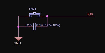

    According to this page the pins with touch are pins #0,2,4,12,13,14,15,27,32 and 33.
    I have this simple test code
    void setup() {
      Serial.begin(115200);
      delay(1000);
      Serial.println("ESP32 Touch Test");
    void loop() {
      Serial.println(touchRead(4));  // 0,2,12,13,14,15,27,32 i 33
      delay(1000);
    After uploading it and touching the GPIO4 leg with a screwdriver (such a touch simulation) the results in the serial monitor change from 80-90 to 4-5, which is the expected result. However, I have strange results for pins 0, 32 and 33.
    When touchRead(32) and touching the GPIO32 pin, nothing happens, the value changes when touching GPIO33 (and vice versa). Conclusion: the pins marked GPIO 32 and 33 are clearly swapped places.
    The problem is always a low state on GPIO0 equal to 1. Why? Does anyone have a correct pinout diagram?

  • Arduino core swaps ESP32 touch pins 32 and 33
