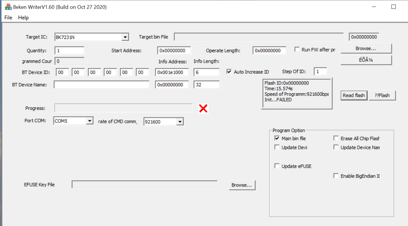

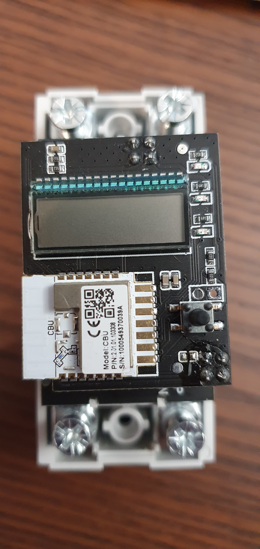

    I tried to read out the flash of the module before I flash a new software.
    Zmai-90 CBU Module Flash Reading Issue: Beken Writer 1.60 Error & Python Script Troubleshooting
    I soldered Rx1/Tx1 /CEN + 3,3V and connected it to two different USB / serial adapter.
    Rx1 is connected to Tx and Tx1 is connected to Rx.
    Used "Beken Writer 1.60" with the following config:
    Press on "Read flash" connect CEN to GND for a short period and wait.
    I can see that the display changes and the two LED on the board are changing (so rest works) but got only an error.

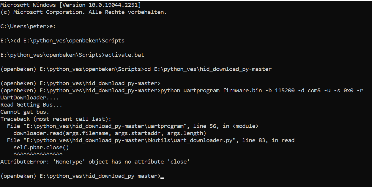

    Next step I have tried to read out the flash by python script with the following result :
    - I have changed Rx and Tx with out any result
    - check several baud rates without andy result.
    Woud be great if someone has an idea. Thank you Peter
  • Disconnect RXD1/TXD1 from TuyaMCU to flash WiFi module
    #2 20320753
    Posts: 14765
    Rate: 12899
    Hello. Your device is most likely using some kind of UART protocol (if it's an older version of Zmai-90) or TuyaMCU protocol (if it'a a newer version). UART protocols are using the same pins that are used for programming - RXD1 and TXD1. TuyaMCU packets sent to WiFi module from the MCU may interfere with programming.
    In order for it to work, you basically need to disconnect Wifi's RXD1 and TXD1 from TuyaMCU. This is done in various ways, depending on the device, sometimes you have to desolder a chip, sometimes to cut the trace...
    In case of this switch, we had to desolder the buttons controller: https://youtu.be/JCqq-gn-X2c?t=190
    In case of this relay, we had to remove capacitor and cut the trace: https://youtu.be/0V0kaRVnk18?t=257
    but in case of this device...
    Can you take off the PCB with WiFi module, power it from your 3.3V power supply (something with a reliable LDO, AMS1117, because current capability is important) and try again?

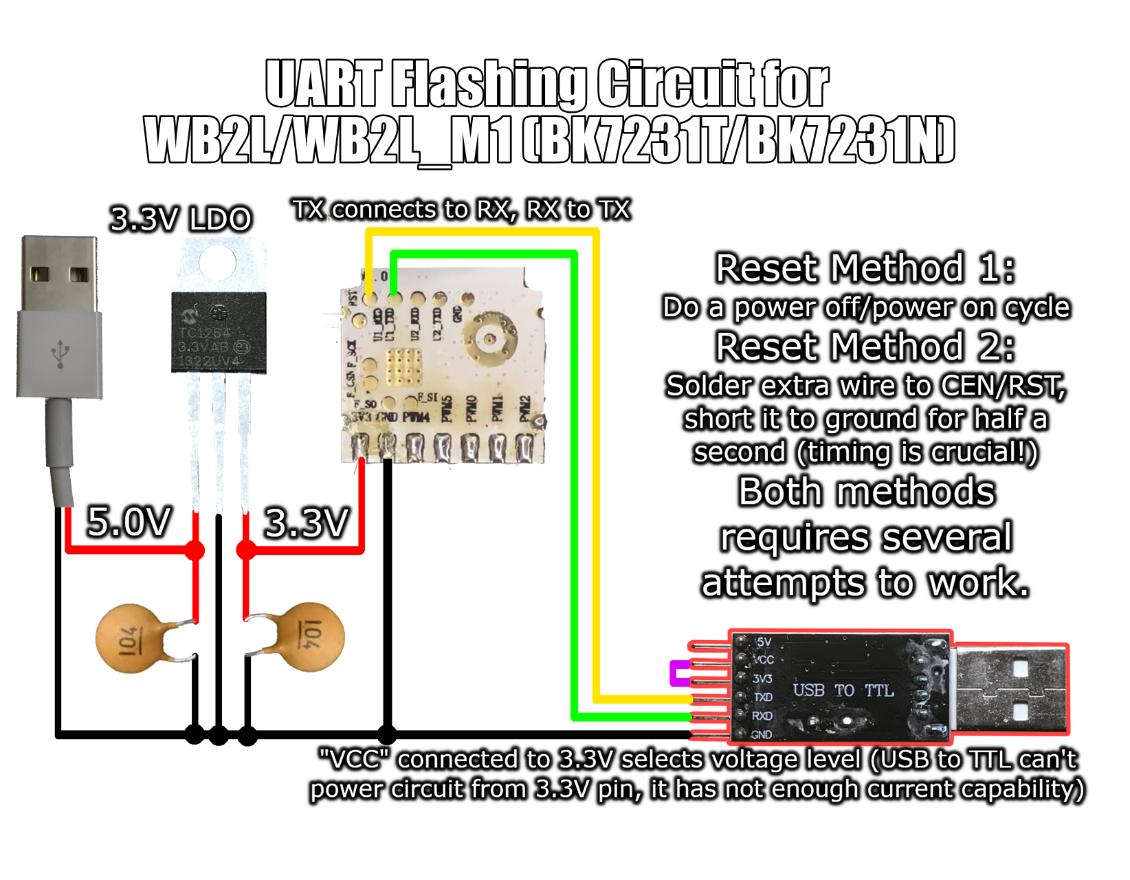

    If the UART lines are in use and you don't want to cut the traces to remove the interference, you can always use this method:
    Bk modules can be easily programmed outside circuit.
    just adjust pinout to your need

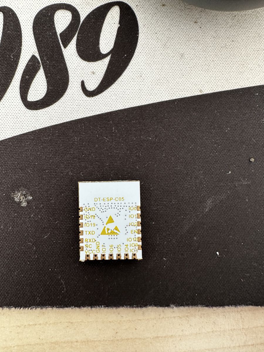

  • #11 20391969
    lionboy
    Posts: 69
    I have this esp c05 but i think is not same pinout like cbu:
    Yea is different because my chip have only 6 pins on left and right and cbu have 7 with 7.

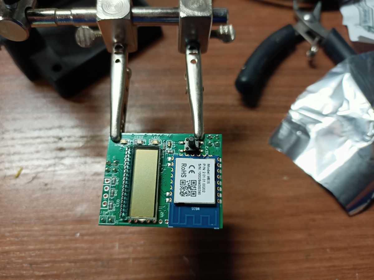

  • #12 20396756
    djlukas
    Posts: 1606
    Help: 94
    Rate: 266
    Actually different pin spacing. I thought every Zmai had the same one.
    Here's mine after disassembly
