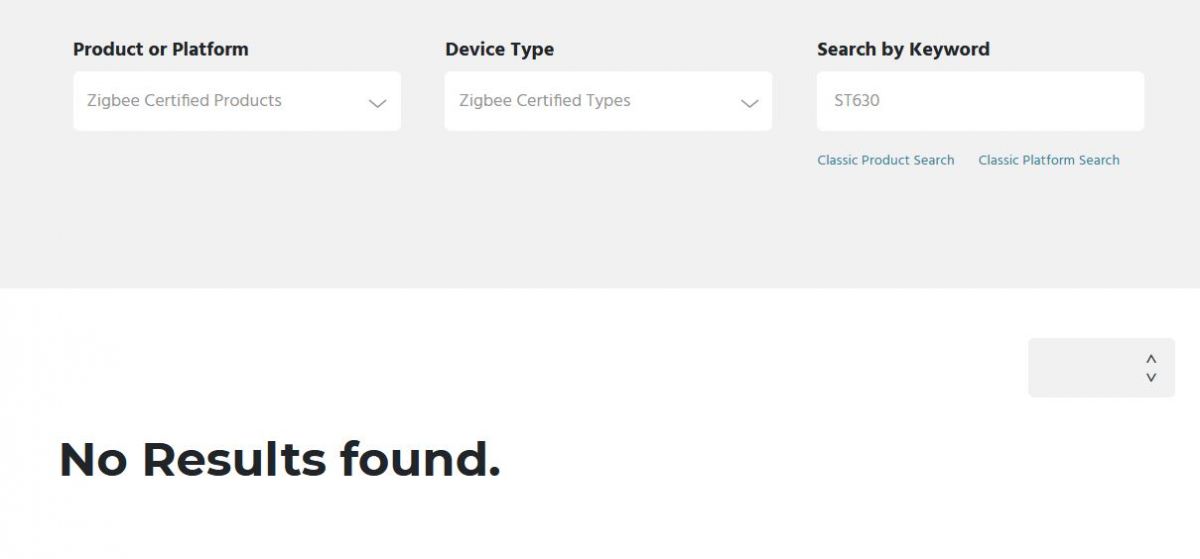

    #7 19413229
    yarko1
    Posts: 44
    sk1977 wrote:
    sk1977 wrote:
    yarko1 wrote:
    Those that have joined and we're talking about those should have an open standard, otherwise it doesn't make sense.
    - the manufacturer of the Fireangel ST630 has joined? I don't see it on the list, so we're talking rather mainly about the one that hasn't joined....
    Those that have joined and are introducing new products - compatibility is already there, but old products are not affected. Whether it makes sense - everyone can have their own opinion. In my opinion, the use of manufacturers' gateways only makes sense in some cases and I don't see much of a problem here - just check what you are going to buy. There is still the issue of app compatibility with devices - any app would have to support all devices.... Fortunately there are multigateways.
    https://zigbeealliance.org/zigbee_products/zb-module/
    https://zigbeealliance.org/member/fireangel-safety-technology-limited/

    yarko1 wrote:
    Fireangel ST630
    - does not search by this name.... By an incorrectly specified model...
    How do I configure a Zigbee Tuya 3.0, Fireangel ST630 smoke detector with a Zigbee module? .
    There is still the question of how to connect, how to configure, how to apply.
