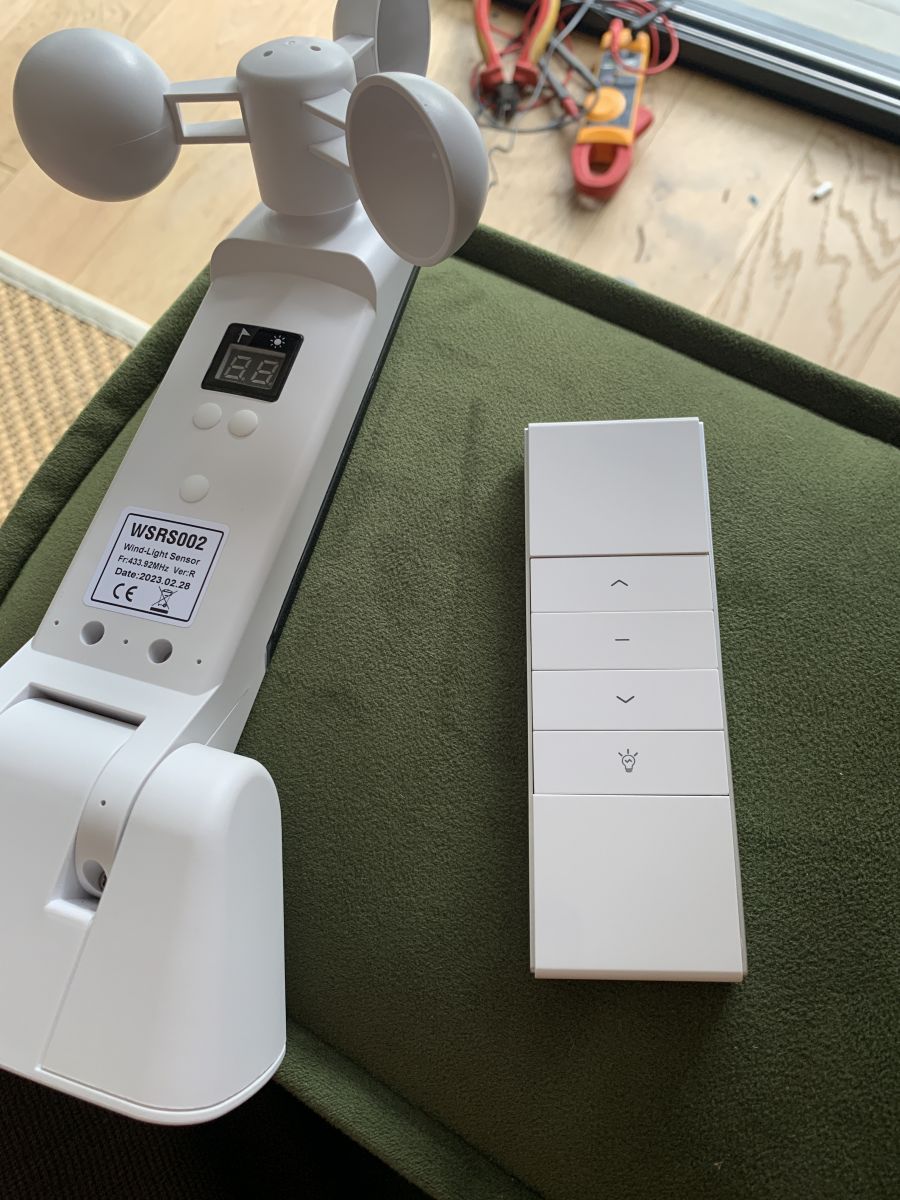

    #6 20631107
    sc0rpion
    Posts: 62
    Rate: 42
    I have ordered a dc116 sensor for my nori2 awning and the chinese have sent me a wsrs002 sensor saying that it is a newer model and should work but it will not pair and simply does not work. I am waiting to hear back from them but it looks like a return.
    Does the YOODA DC-116 sensor work with the DOOYA DM45RM-40/15 awning?
    Added after 10 [hours] 27 [minutes]:
    Ok I got confirmation that they sent me the wrong model for my remote control. The one above works with WSRE series motors with remote control WSRE1101. This time they are sending me the DC116, I will let you know when it arrives and if it works.
    Does the YOODA DC-116 sensor work with the DOOYA DM45RM-40/15 awning? .

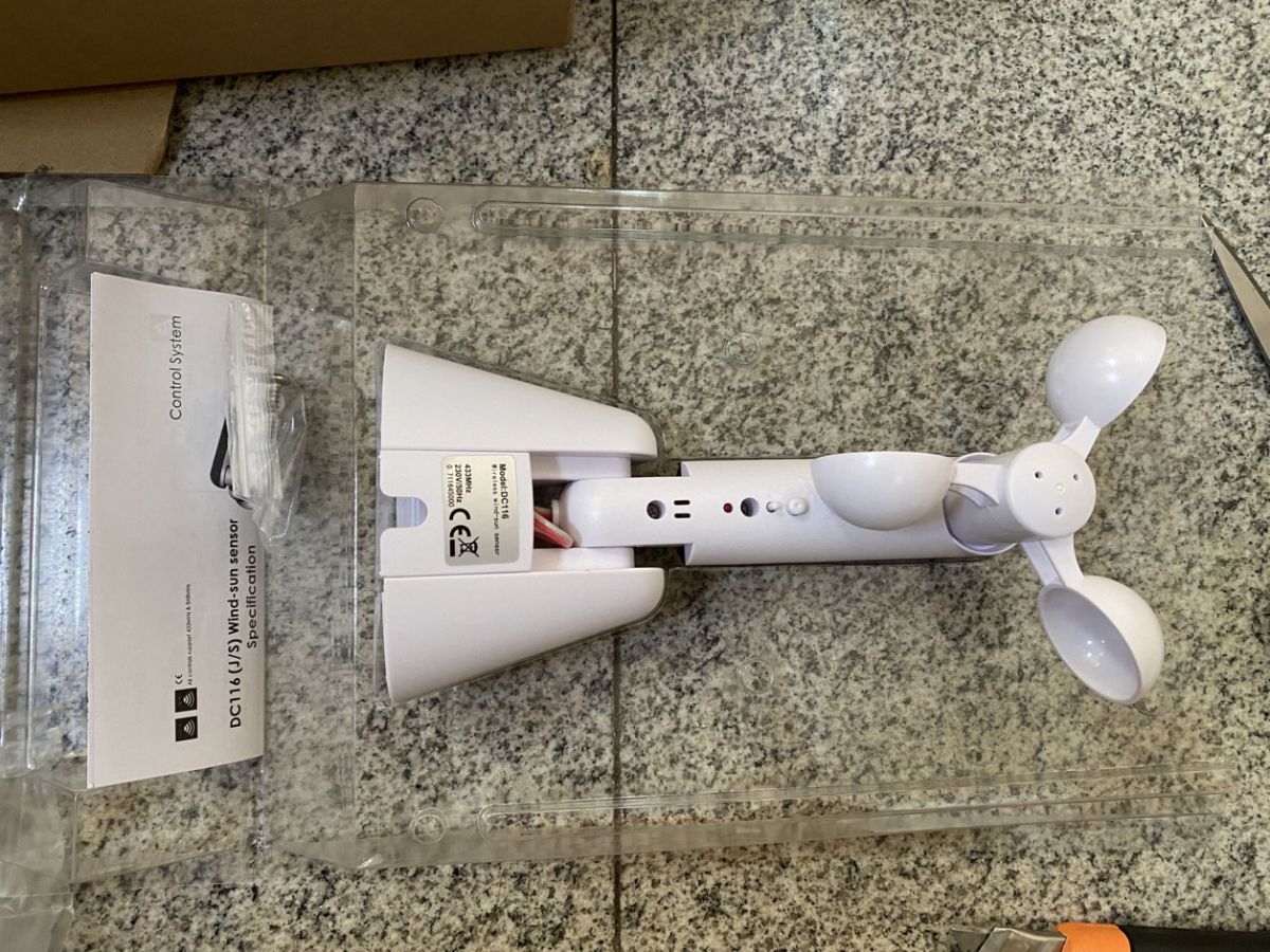

  • #7 20634732
    sc0rpion
    Posts: 62
    Rate: 42
    Ok I already have a DC116 but this is nonsense, it only works half the time. It folds down the awning for the wind but also for the sun, it's paranoia, it can't be programmed any other way, I guess I'll have to make another complaint 🤦🏻‍♂️
  • #8 20636414
    sc0rpion
    Posts: 62
    Rate: 42
    It seems to me that the sensor may be ok but my testing is failing due to lack of enough sunlight to process it properly. I have been using artificial light and have not been able to generate enough lumens for it to activate and when it does not detect the sun after 15 minutes it sends a signal to retract the awning. It should be ok when it gets a bit warmer in the UK
  • #9 20639973
    sc0rpion
    Posts: 62
    Rate: 42
    I can confirm, the DC116 sensor works with the Nori2 awning. The sun sensor can be deactivated, but it is better to install a power switch for the awning, because when the sun sets the sensor will send a signal to retract the awning, e.g. if we want it to stay open e.g. during rain etc.
