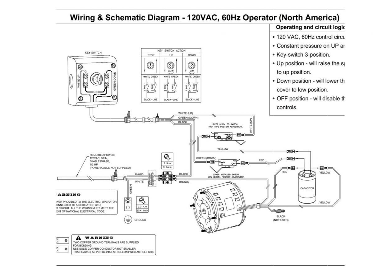

    Greetings to the Honourable Members,
    I have a device which at the moment is operated by a 3 position switch with a key.
    I would like to add a wireless control and if possible leave the key as well.
    I have searched for controllers and found several but they do not meet the conditions, I would like the controller to be installed in a motor box outside (it is not raining but it is only a metal casing so it looks to me more like a device to be installed inside the house), the operating temperature -25C to 50C, an external antenna would be a bonus because the metal casing will be very blocking the signal
    But my basic question is it possible ?
    I think I could simply separate the white and green wires and connect them to the control unit, I understand that there could be a problem if someone uses the key and remote control?
    I was thinking of something like this
    https://shopusa.shelly.cloud/shelly-2.5-ul-333-wifi-smart-home-automation#237
    finally ( no wifi )
    https://www.carymart.com/2000-meter-distance-...ut-wireless-remote-control-device-p-1431.html
    Thank you

    Shelly 2.5 alone, not so much due to the fact that there are no motorless contacts. Additional relays would have to be added and wired in such a way that both contacts could not be switched on at the same time.

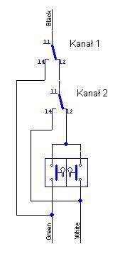

    You can find (on Allegro ....też) a 2-channel remote control in which the relays have changeover contacts (Com-Nc-No or ... A-B-C). Rebuilding the control of your motor:
    Wireless keyed device control - controllers for extreme temperatures .
    When attaching a remote control to White, Green (using only Com-NO contacts) there should not be a problem either - at worst the same "phase" will appear on both capacitor leads - the motor will "buzz" and heat up, but rather with a short term drive of this type - it will not burn up.

    Thanks so much for the info on Shelly and for the diagram to the other colleague!
