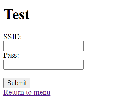

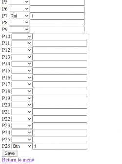

    That's a great job, @btsimonh ! I will try out your fork soon.
    Don't worry about bricking the BK chip, I just received a small donation of several WB2S modules and I will try to program them with ST Link:
    WB2S/BK7231 Tutorial - writing custom firmware - UDP/TCP/HTTP/MQTT
    About MQTT receipt crash.... I will look into it. It wasn't crashing before your changes, right? So the Tuya removal has broken something?

    It has WiFi creds form:
    And this is the configurator:
    You can have any number of relays, the buttons on the first page are generated automatically.
    The physical button on the board is also supported, and also linked automatically:

    I think there already might a place in the memory where the WiFi creds are stored because after my first flashing (by UART) my WB2S device that was paired to my WiFi by Tuya mobile application still remained connected to my network.
    And it was connected there even after multiple firmware updates. I wrote about that some time ago in the XR809 topic, even before I posted this WB2S/BK7231T tutorial.
    Also, it would be useful to find where the device name reporting to DHCP comes from, because in my case both WB2S/WB3S devices are seen by router as "wlan0".
    EDIT: That's how they do this, just need to find a good position in memory
    Code: C / C++
    Maybe SSID_PASSWORD_TOKEN type?
    Code: C / C++
    Here's an open-access point setup method (working):
    Code: C / C++
    Here is a function to get MAC address (it's different slightly for AP and client modes) and use it to create unique device name:
    Code: C / C++
    Here is wlan0 name set:
    ah, i see, net_dhcp_hostname_set
    * OpenBK7231 has joined the network *

  • Added 64-byte pin configuration field to build
    #60 19844572
    Posts: 14724
    Rate: 12806
    TLV header is earlier:
    but the code for setting was indeed not included in the build. Still, I have modified it and added 64 bytes field for storing pins configuration, let's see if it runs.
    Btw: @btsimonh if you want to do OTA upgrade, you should first download bytecode to specific OTA area and then allow old update mechanism to write it to user area, I think
