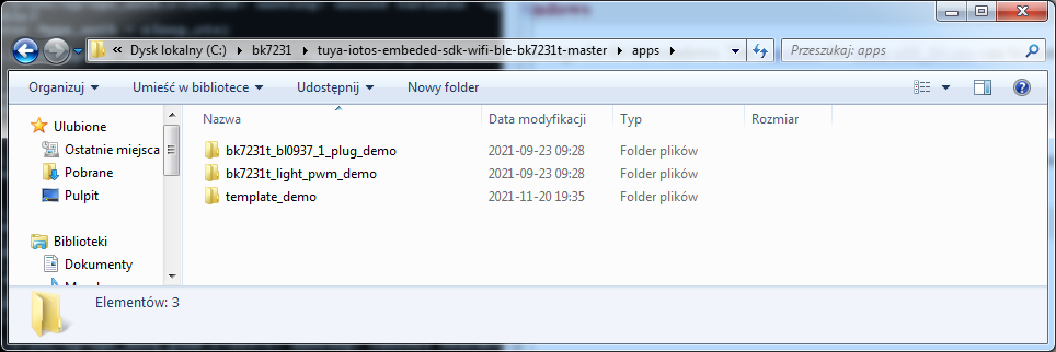

    We get acquainted with the contents of the folder. Under the path \ bk7231 \ tuya-iotos-embeded-sdk-wifi-ble-bk7231t-master \ platforms \ bk7231t \ toolchain we have a nice surprise - toolchain is here, gcc-arm-none-eabi-4_9-2015q1 :
    WB2S/BK7231 Tutorial - writing custom firmware - UDP/TCP/HTTP/MQTT

    The build_sh.sh script there contains everything we need.
    We run it through:
    ./build_app.sh apps / template_demo template_demo 1.0.0
    The arguments indicate which project to build from the apps folder:

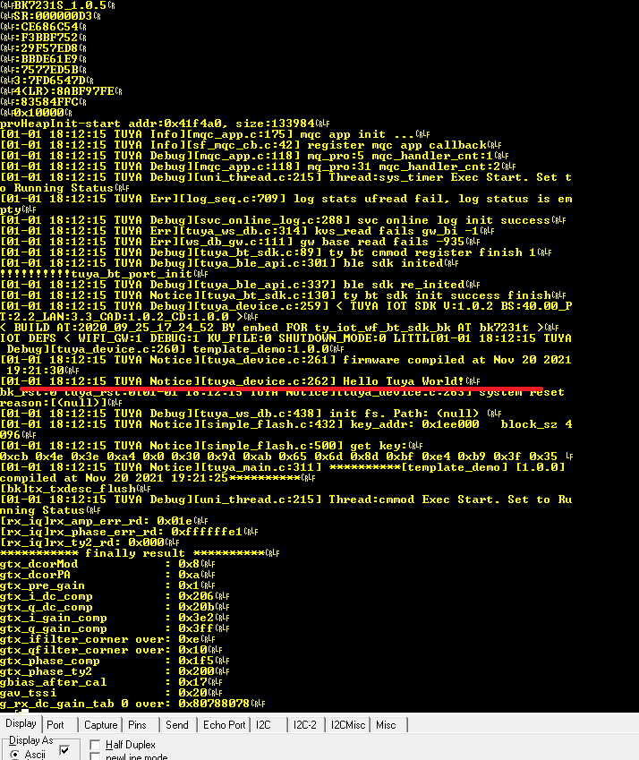

    The first hello world
    Compilation is already working, but we still need to somehow verify that we can actually edit these projects meaningfully and that the entire build is going well.
    I suggest adding a printf somewhere, let's say the famous "Hello world".
    This can be done in apps / template_demo / src / tuya_device.c in pre_device_init:
    We're compiling, it's time to upload the firmware.

    After restarting the device, our message appears:
    Then the WB2S will automatically run the uploaded firmware.

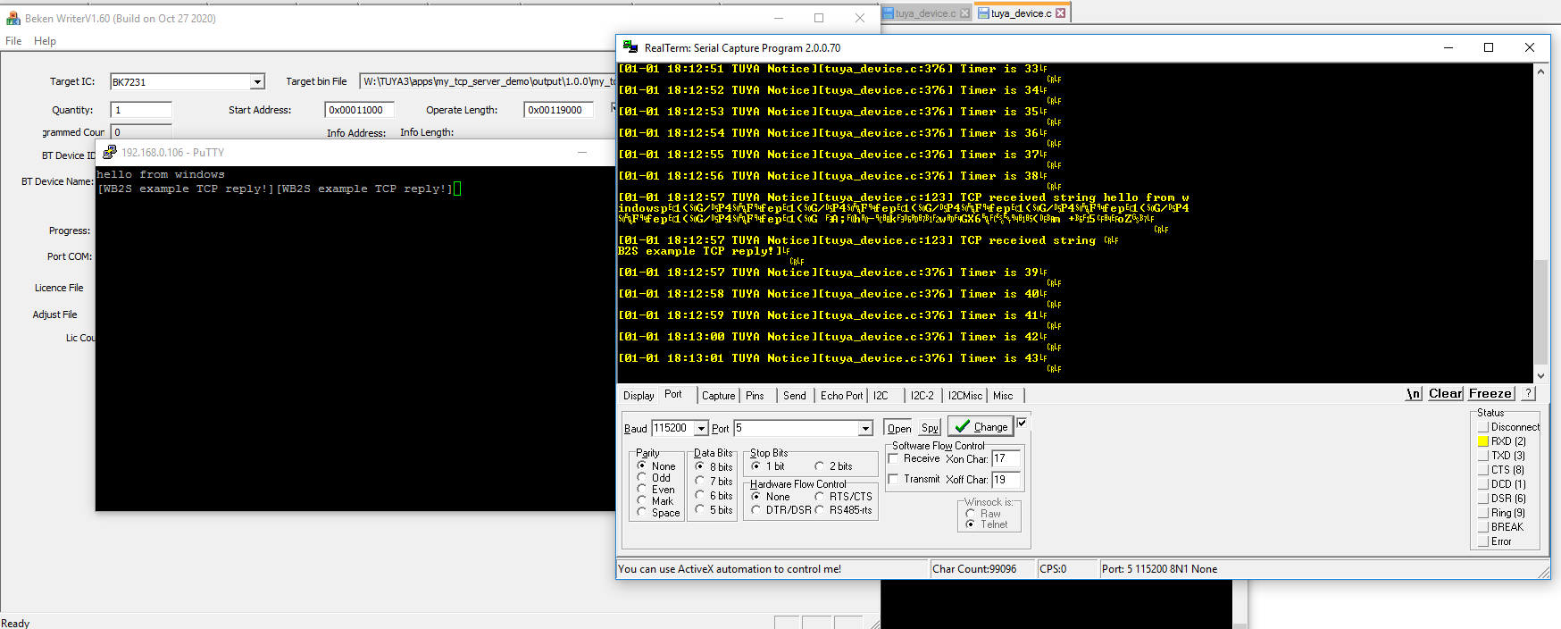

    TCP server
    We have already launched UDP, but UDP is not suitable for more serious applications because it does not have a reliability layer, it does not support automatic packet retransmission. Of course, we can implement something like this on UDP, but why?
    That's what TCP is for.
    TCP allows you to create a permanent connection with the client, separately we have the act of connection, data transfer, and connection closure.
    Therefore, with TCP, each client will receive its own thread, which will run until the connection is broken.
    Let's start by creating a TCP server thread:
    Code: C / C++

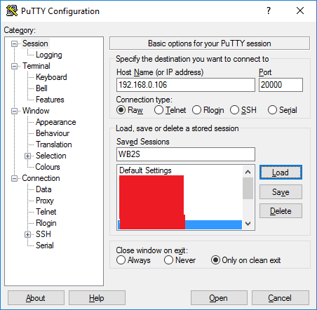

    On the computer side, you can use Putty in Raw mode. The computer will connect to the server and send it what we type in the console.
    Let's check if TCP works now:
    It works the most, but you can see that I lost the 0 character somewhere (byte zero, not in ASCII), as a result of which "bushes" entered the received message. This is not a problem, we can either send these 0 in the packet, or artificially add them to the end after receiving the packet (buff [len] = 0).

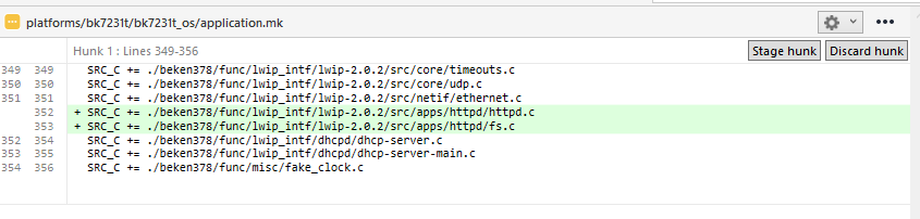

    We also have the HTTP server ready, it is in the lwIP [/ b] library. Only this time we need to add its sources to the [b] makefile [/ b] so that the compiler knows that its code should be included in the project.
    HTTP server code is in [b]httpd.c
    and fs.c from platforms/bk7231t/bk7231t_os/beken378/func/lwip_intf/lwip-2.0.2/src/apps/httpd.
    Let's add them to application.mk:
    If we don't add them, we'll get linker errors when compiling, for example:
    W:\TUYA3\platforms\bk7231t\bk7231t_os/../../../apps/my_http_server_demo/src/tuya_device.c:736: undefined reference to `httpd_init'
    Now we still need to start the server. For now, let's just call httpd_init in device_init:
    Code: C / C++
    And that's enough - the WB2S web page is working now!

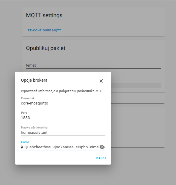

    You will also need a server for the demonstration - I will use the Home Assistant server here, prepared according to my tutorial:
    https://www.elektroda.pl/rtvforum/topic3777098.html
    We need the MQTT username and password from our server. We take them from the settings of the Mosquitto MQTT broker:
    In the code, they are represented by the mqtt_connect_client_info_t structure. Let's initialize it with the appropriate fields:
