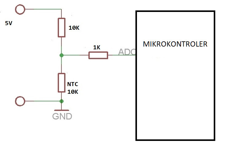

    Hi, first of all I'd like to point out that I'm a beginner and I'd like to start my adventure with Arduino and programming. As my first project I'd like to make a thermometer which depending on the temperature would turn on a blue or red diode, for example at a temperature of 0-15 degrees the blue diode would be on and when the temperature exceeds 15 degrees, the blue diode would turn off and the red one would turn on. Is such a thing possible at all, if so I would ask for some hints, articles, tutorials, how to go about it and how to do it, I have a probe from the thermostat and a nodemcu v3 board

  • 10 kΩ NTC thermistor on ADC input
    #4 19754048
    gps79
    Level 37  
    Posts: 2212
    Help: 495
    Rate: 798
    This probe looks like a very common 10kOhm NTC thermistor (for you to check what the resistance is at room temperature).
    You connect it like this:
    NodeMCU v3: Creating a thermometer with temperature-dependent LED control .
    then you read the value on the input of the ADC (10-bit) by software.
    The value read is inversely proportional to the temperature (higher the temperature, the lower the value read). At room temperature you should read a value of about 775 (from 0-1023).

The discussion revolves around creating a temperature-controlled LED system using a NodeMCU v3 board. The user, a beginner in Arduino programming, seeks guidance on building a thermometer that activates a blue LED for temperatures between 0-15 degrees Celsius and a red LED for temperatures above 15 degrees. Responses indicate that this project is feasible, with suggestions to use a 10kOhm NTC thermistor or an LM35 temperature sensor. The NTC thermistor's resistance is inversely proportional to temperature, and the LM35 can be integrated with various online tutorials available. However, it is advised to use a digital temperature sensor instead of the ESP8266's ADC due to its poor quality and susceptibility to noise.
