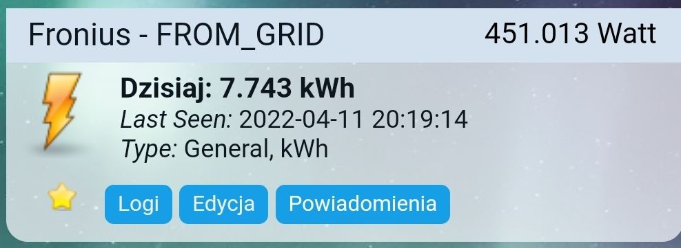

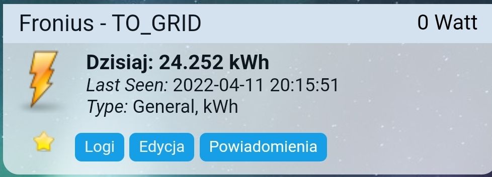

    The system is Domoticz.
    In general, my idea is to create a script that calculates how much energy from photovoltaic production remains to be used.
    Energy sent to the grid x 0.8 - energy taken from the grid, over a period of 24 months.
    Transmission of readings + calculations to the virtual sensor. .

    2022-04-20 18:12:18.368 Error: dzVents: Error: (3.1.8) .../pi/domoticz/scripts/dzVents/generated_scripts/E_Mag.lua:9: attempt to perform arithmetic on a table value
    2022-04-20 18:12:19.299 Error: dzVents: Error: (3.1.8) An error occurred when calling event handler E_Mag

    Please advise what is causing the error
    return {
    	return {
    	on = {
    	    devices = {'Fronius - TO_GRID'}
    	execute = function(domoticz, item)
    	    local togrid = (domoticz.devices('Fronius - TO_GRID')*0.8)  -- do sieci *0.8
    		local fromgrid = tonumber(domoticz.devices('Fronius - FROM_GRID'))  -- z sieci
    	    local storage = fromgid-togrid
    	    local licznik = tonumber(domoticz.devices('Mag').state)  -- utworzyć wirtualny czujnik rfx meter counter o nazwie w apostrofach  np. 'Magazyn'
    	    local ecounter = domoticz.devices('Mag')
    	    licznik.updateCounter(storage.WhTotal)
    	end
    error:
    pi/domoticz/scripts/dzVents/generated_scripts/E_Mag.lua:10: attempt to perform arithmetic on a table value
