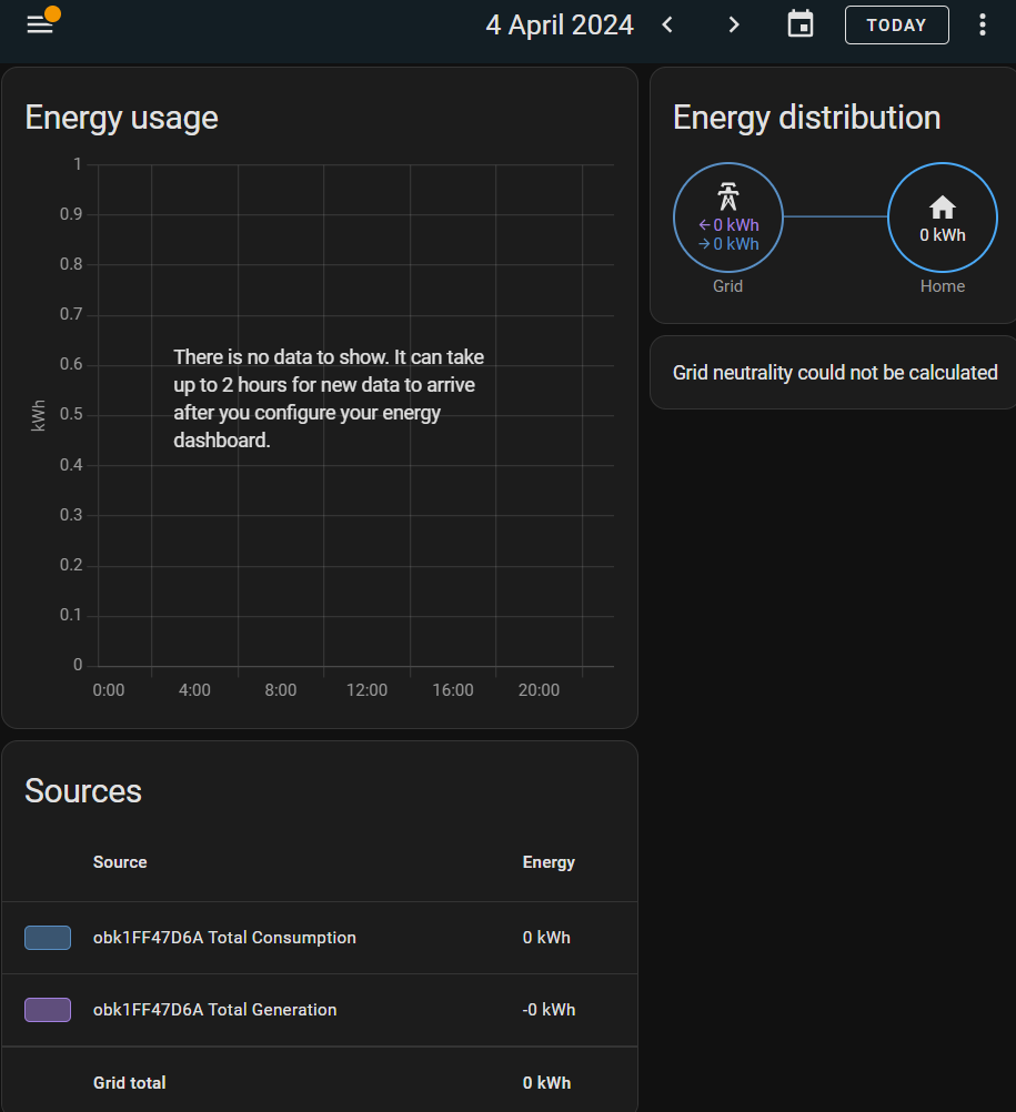

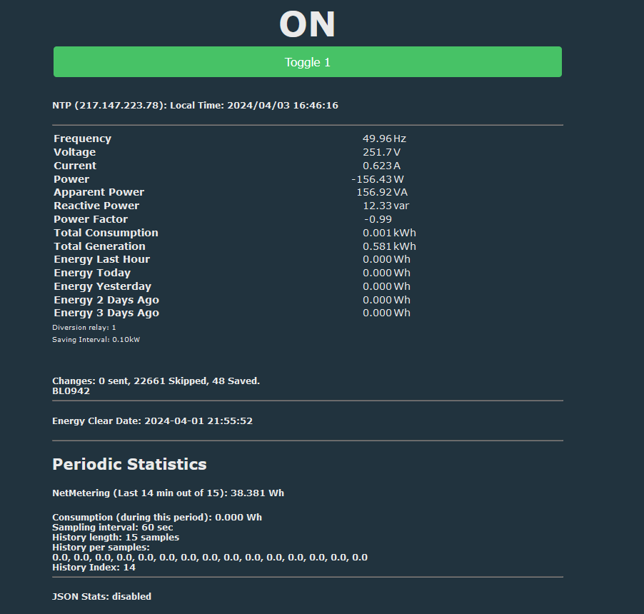

    Just updating this to reflect the work done on this project.
    It's now possible to measure reverse and forward energy consumption on devices based on the BL0942.
    I have also implemented Netmetering, so that we know how much is self consumption and how much is actually exported to the grid.
    Netmetering is the sum of the consumed and produced balance. Say f you produced 1000W and used 500W, your balance will be 500W positive,
    Normally this would be exported to the grid to use later, but in recent tarifs, utilities have reduced the time you can do so, typically in between meter readings (15 to 60min). Any excess will be marked as 'Export@ and sold to the utility company for very little, compared with the purchase price.
    To better make use of this provision I added a feature to enable a remote relay when there is a certain ammount of positive balance. This allows diverting some of this energy to a water heater, a heating system or any other appliance.
    It can be used standalone or fed into home assistant to run automations.
    Further details as we go on...

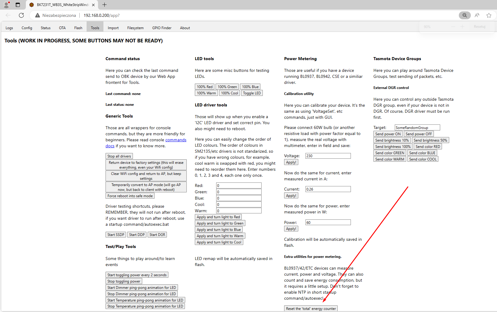

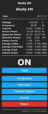

    On the other topic Link I have added support for forward and reverse energy on BL0942 based smart plus.
    OpenBecken has one global counter for energy - there is no way to display the aditional readings for energy exported.
    I would like to enable aditional ones, but i don't know how to do this - It's not really well documented like in tasmota. Are there any custom builds where this functionality is implemented?

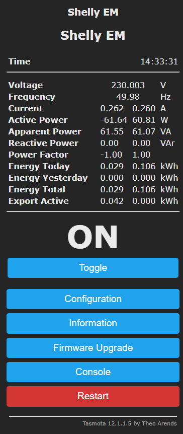

    Something like this, which is enabled on the Shelly 3EM using ADE7880:
    Shelly EM user interface showing energy consumption data.
    I see that on the file drv_bl_shared.c there are stats for various statistics such as 'Energy today', 'Energy yesterday', 'Energy last hour', etc. Are these used on a particular device? Is there a way to enable them on the webinterface somehow?
    Thanks!

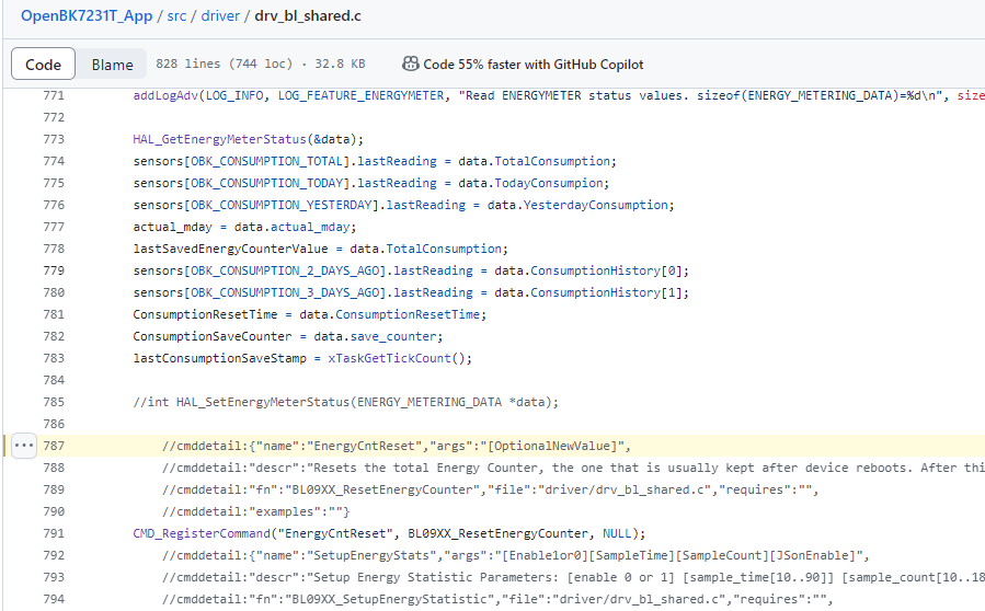

    I think you need to edit this file:
    https://github.com/openshwprojects/OpenBK7231T_App/blob/main/src/driver/drv_bl_shared.c
    Namely this array:
    Code: C / C++
    You also need to update the corresponding enumeration:
    Code: C / C++
    In order for extra counters like "energy today", etc, you need to enable NTP and setup energy counters. See our documentation for more details:
    Related command is SetupEnergyStats.

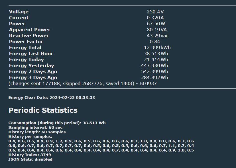

  • #6 21025220
    Honsu
    I have autoexec.bat entered in the file
    startDriver NTP
    ntp_timeZoneOfs 1
    SetupEnergyStats 1 60 60
    Screenshot showing energy consumption statistics with various measurement data.

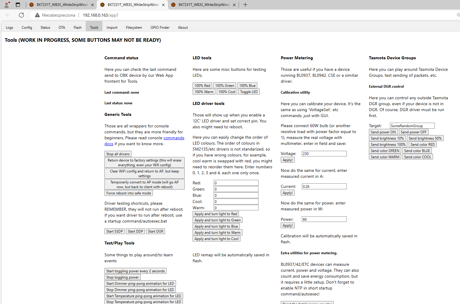

    cdtdsilva wrote:

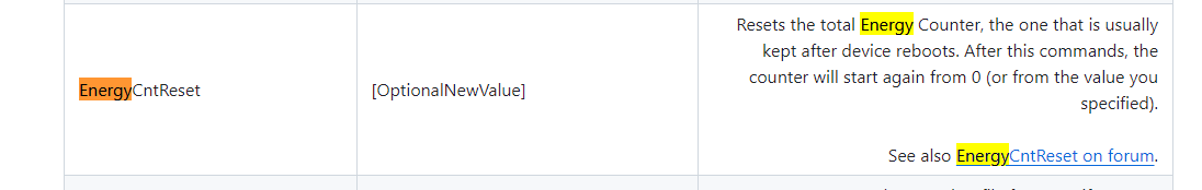

    Where is the code for the webpage located? I want to add an extra button to reset the generation statistics, next to the one for the totals
    Please do not add any special buttons to native HTTP page. We need to preserve flash memory. Some devices have only 1 MB. You only need to add console command like here:
    Snippet of a table with a command for resetting the energy counter and an optional new value.
    Screenshot of OpenBK7231T application source code in drv_bl_shared.c file.
    Then you can edit our Javascript web app code here:
    https://github.com/OpenBekenIOT/webapp
    in order to add a button to call this command, like I did here:
    Screenshot of a web app with tools for managing IoT devices.[/quote]

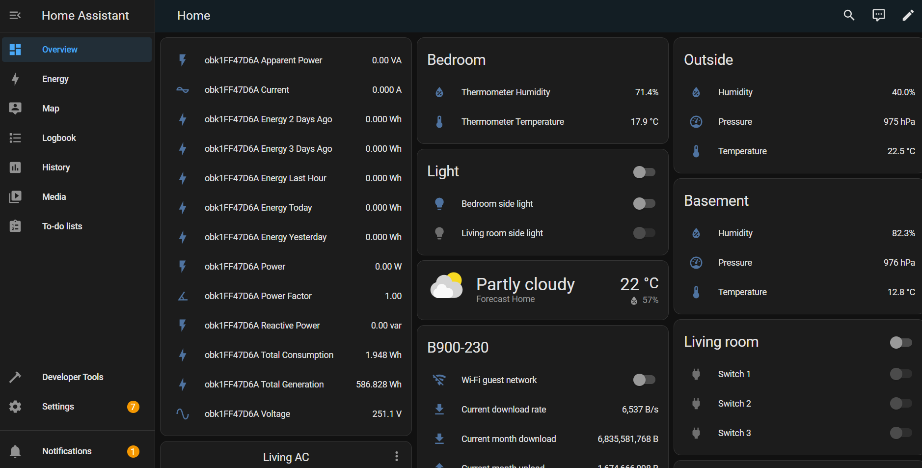

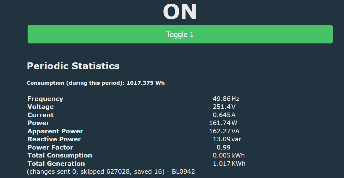

    Energy metering is now working, just neet to add the net metering feature and change the 'TotalGeneration' to the new variable you will be creating plus some tidy up of the code
    Screenshot showing energy consumption statistics with values such as frequency, voltage, current, and other electrical parameters.

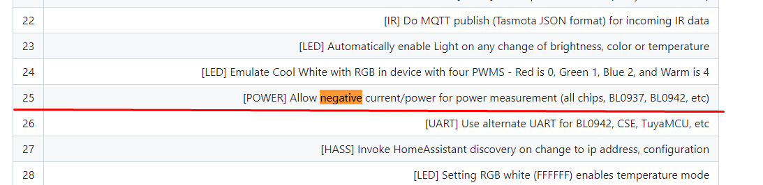

    Also - can you respect Flag 25 in your changes?
    Fragment of a software feature list with a highlighted row in orange.
    To be more precise - only run your changes when this flag is set?
    I am asking becaus we had reports saying that some power metering chips are reporting negative values randomly...

    @cdtdsilva I have a little update. I have checked the code and I now know where the data is saved. The following feature was added by our contributor so I couldn't just figure it out from the memory.
    You need to search for BL09XX_SaveEmeteringStatistics
    See: https://github.com/search?q=repo%3Aopenshwpro...pp%20BL09XX_SaveEmeteringStatistics&type=code
    There is a conditional statement in the bl_shared.c which determines the frequency of power metering data saving.

    The piece of code I used to save the generation variable is for development purposes. I will use your code, once you're finished. For now i just made sure the correct memory positions were used, so it's backwards compatible with the final code.
    I may need some help to sync your repo to mine - last time it just over-wrote all my changes (good thing I had a backup). This time, too many files were changed to do it by hand. I'm not a daily github user, so not sure on all the perks there...
    I noticed power data is saved in 10Wh intervals. That's probably usefull to document.
    10Wh increments is probably fine for a smart plug, for whole house power consumption, it will likelly write the flash 1000+ times a day.
    I sugest users change the default value to 100W and have added a small indicator showing the set value.
    The variable that writes the flash is the one below, inside src/driver/drv_bl_shared.c. I have re-written it to save whenever either of the values goes above the threshold set by 'changeSavedThresholdEnergy'.
    if (((sensors[OBK_CONSUMPTION_TOTAL].lastReading - lastSavedEnergyCounterValue) >= changeSavedThresholdEnergy) ||
            ((xTaskGetTickCount() - lastConsumptionSaveStamp) >= (6 * 3600 * 1000 / portTICK_PERIOD_MS))

    For reference, here's a screenshot. For anyone wanting to try the binaries, they are added as an attachment to this post.
    Screenshot of an energy monitoring interface displaying various electrical parameters.

    The 'diversion relay' part of the code is an if loop with conditional statements, which calls out the Send Get command to send an HTTP request to turn on or off a remote plug. All the code is contained inside That's makes use of the already included code inside selftest_http_client.c, example:
    ///CMD_ExecuteCommand("SendGet http://192.168.0.103/cm?cmnd=POWER%20TOGGLE", 0);
    You might have a good idea of the memory use of that feature. The rest, I think it's negligible. A few more variables and loops.
    90% of the aditions are inside src/driver/drv_bl_shared.c.
    I did some previous changes on how metering data is obtained from the BL0942 inside /src/driver/drv_bl0942.c
    The rest is adition of variables here and there. I'm pretty confident no backwards compatibility was lost, but due to the memory structure, the generation data is probably sent via MQTT regardless of flag 25 (As a 0 value). That needs to be tested, to ensure nothing goes out of place on HA, etc.
    I know all of the variables can be changed via the console. Are you kindly telling me there is no space to make the changes? I would find it more user friendly to have them on the webinterface, but understand if space is an issue. We could also make a separate version, a bit like tasmota (with an #ifdef) specific for users that require reverse metering. It's quite a niche application, after all.
    Either way I will prepare some details covering the various variables of interest. I will probably forget them in a few weeks, so better have them documented :-)
    Meanwhile, these work fine via MQTT on home assistant.
    Energy monitoring panel displaying graphs and tables. Home Assistant user interface displaying various home statistics.
  • #19 21032496
    That looks very good and promising!

  • #21 21051414
    cdtdsilva
    @p.kaczmarek2
    With the aim of making the code as compatible as possible to different devices, can you please add a new flag to invert direction of AC power?
    That's because some devices measure consumption as positive or negative.
    I have have repurposed flag 40 on my tests and that works well, but need one to add to the final code. Something like: 'Invert direction of AC power Flow'
    Thanks
  • #22 21053679
    Sure, here is the flag you requested:

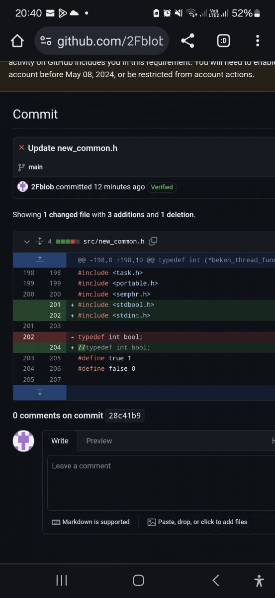

    On another point, I've been having issues compiling to the BL602. the error messages are rather confusing do you have an idea what the problem might be? Link
  • #26 21058799
    miegapele
    That strange error might be due to conflicting bool definition. Try replacing bool definition with stdbool as I've done here
  • #27 21058992
    cdtdsilva
    Screenshot of a GitHub commit showing changes to the new_common.h file with three additions and one deletion. That didn’t work.
  • #28 21059123
    miegapele
    new_cfg.h needs to be included as it is in many other drivers. bl602 build seems strict on implicit function declarations
  • #29 21060367

    Remote Relay (The flag would enable or disable a storage heater or heat pump based on excess generation)
    Storage system: When there is no consumption, at the end of the netmetering period, it enables a battery storage, to ofset consumption.
    Disable net meteing: Shows Import and Export exactly as metered.
    This is a lot of flags. Maybe we should consider just giving you an extra byte for "power flags" in config struct?
    That would give you 8 flags.
    But I am not sure, I would need to think about it.
    Futhermore... are those strictly related to power metering? SHouldn't be the "enable cooling fan" be in external driver?
    The same goes for remote relay. Hmm

How do I enable forward and reverse (import/export) energy counting on a BL0942 plug?
  1. Flash the recent OpenBeken build that includes bi-directional code. 2. Run backlog Powersave 1; startDriver BL0942; startDriver NTP; ntp_timeZoneOfs <ofs> to start the driver. 3. Set flag 25 (SetFlag 25 1) to allow negative readings. 4. If your device reports export as positive, also set flag 48 (SetFlag 48 1) to invert the sign [Elektroda, cdtdsilva, #21070093; #21025841].
Where are the extra energy counters defined and can I add more?
Counters live in drv_bl_shared.c inside the sensors[OBK__NUM_SENSORS] array. Add new entries and update the energySensor_e enum to match the order [Elektroda, p.kaczmarek2, post #21022822] Compile after enabling NTP and running SetupEnergyStats so daily statistics work.
What does the `SetupEnergyStats` command do?
SetupEnergyStats <enable> <sampleSec> <samplesPerSum> sets up circular RAM logging. Example SetupEnergyStats 1 60 60 records 60 values (1 h) at 60 s intervals, letting the firmware compute net-metered energy every hour [Elektroda, p.kaczmarek2, post #21022822]
Can I choose any net-metering period, not just 15 or 60 min?
Yes. Omit the old flag pair and instead set SetupEnergyStats 1 60 <periodMin> in autoexec.bat. The firmware will average import and export over that many minutes, e.g., SetupEnergyStats 1 60 30 for a 30-minute window [Elektroda, p.kaczmarek2, post #21068748]
How do I divert surplus solar to a water heater or battery charger?
Use change-handlers: 1. addChangeHandler NetMetering > 40 SendGet http://192.168.0.69/cm?cmnd=Power%20ON 2. addChangeHandler NetMetering < 5 SendGet http://192.168.0.69/cm?cmnd=Power%20OFF [Elektroda, p.kaczmarek2, post #21060974] "Scripts keep firmware small and flexible."
Edge case: Wi-Fi drops make the module reboot—why?
Long MQTT bursts (up to 7 messages s⁻¹ at 4 kW) can swamp LWIP when Wi-Fi links flap, triggering the watchdog [Elektroda, cdtdsilva, post #21084669] Increase changeSendThreshold or disable HA auto-discovery during testing.
How many configuration flags are left?
The structure holds two 32-bit words, providing 64 flags total. Unused count equals 64 − current usage (≈50 after this patch) [Elektroda, p.kaczmarek2, post #21054964]

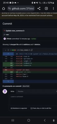

I get a BL602 compile error about ‘bool’. Fix?
new_cfg.h must precede other headers and define #include <stdbool.h>. Adding it resolved implicit-function errors in BL602 builds [Elektroda, miegapele, post #21059123]
How do I move TotalGeneration without breaking existing flash layout?
Cast the last two savedValues (4 bytes) in ENERGY_METERING_DATA to a float instead of enlarging the struct. The helper HAL_FlashVars_SaveFloatGeneration() added in commit 9003bc6 handles read/write [Elektroda, p.kaczmarek2, post #21025864]
Does Home Assistant auto-discovery still work after these changes?
Yes. Sensors energycounter, energy_export, and net_metering publish via MQTT and appear under HA Energy Dashboard automatically in testing builds [Elektroda, cdtdsilva, post #21070093]
