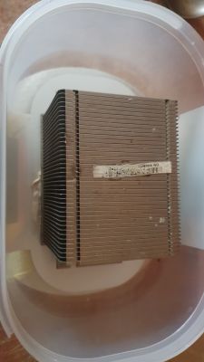

    For further tests, I made a revised design.
    Prototype cooling system with TEC1-12706 element in a plastic container. Close-up of a homemade structure with TEC1-12706 element supported by metal legs. Ice cream container with an attached TEC1-12706 module. Square copper plate mounted on a cardboard surface. Heatsink in a plastic container. TEC1-12706 element undergoing a self-cooling test.
    Now for some details about the TEC1-12706
    It is a normal coincidence that I have such an element in use.
    Power supply 12 V - current 2.8 A, power 33 W.
    The power given by the manufacturer / seller is 60 W, which is available with a power supply of about 15 V. How is the efficiency of such an element as a cooling one, another story.
    The measurement results I got from this element as a "generator", temperature difference ~ 110 ° C
    No-load voltage = 4.7V
    R = 1 ?, U = 1 V, I = 1 A, P = 1 W.
    R = 2 ?, U = 1.8 V, I = 0.9 A, P = 1.62 W.
    R = 3 ?, U = 2.6 V, I = 0.86 AP = 2.25 W
    R = 6 ?, U = 2.7 V, I = 0.45 AP = 1.2 W
    R = 7 ?, U = 3 V, I = 0.42 AP = 1.2 W
    R = 8 ?, U = 3.3 VI = 0.41 AP = 1.3 W
    R = 10 ?, U = 3.8 VI = 0.38 AP = 1.4 W
    Measurement with a load between 2-3 ? is noteworthy, it achieves the highest efficiency. (Match the load resistance to the source?)
    LED diode test 3 V, 1 W - the diode is supplied with full power of 3.2 V, 0.35 A.
    There is even electricity left for the fan, which will then serve as cooling only.
    Current measurement on a 0.1 ? resistor
    Multimeter measuring voltage next to a glowing LED on a desk. Lab setup with TEC1-12706 component, multimeter, and LED on a wooden surface. TEC1-12706 element with a fan, meter, and notes. Fan with connected wires and a multimeter showing a 4.938 V reading on a table.
    The video shows a self-cooling test.
