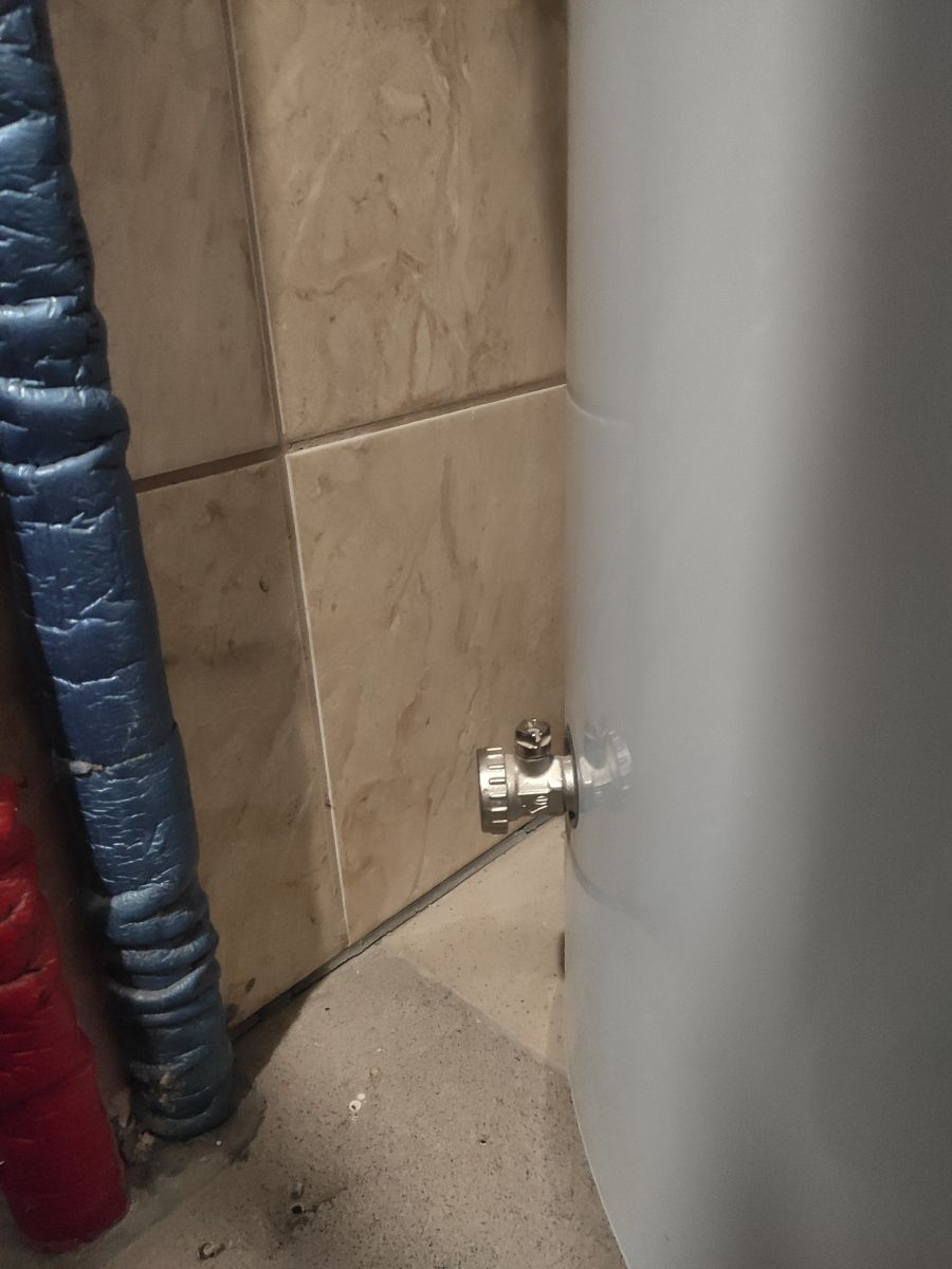

Can I install an electric heater in a Vaillant VIH R 150/6 B storage tank by using the drain valve port?
Yes, but only if the heater physically clears the internal coil; the top connections are a bad idea because they have plastic inserts and water-guide tubes, so the drain valve port is the proper place to try [#19977708][#19977796] The fit is not universal: the exact coil position and tank version vary, so before buying it is worth opening the drain, probing the opening with a rod of the heater’s length, and checking whether anything blocks it [#20401317][#21846475] If it fits, the best solution is to screw the heater directly into the tank connector; later notes say not to use a tee or extension because that can create an overheating section on the heater body [#20388828][#20715446] People reported successful installs in VIH R 150/6 B with a 900 W heater, and in similar tanks with 1.2 kW, but mainly as auxiliary heating rather than the only DHW source [#20935498][#20961672]

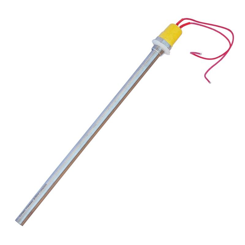

    I just tried to mount this heater https://egrzalki.pl/pl/p/Grzalka-do-grznika-lazienkowego-2000W-GTN,-biala/1420 in the VIH R 120/6 B tank.
    Unfortunately, I do not recommend it, there is an element protruding from the top (perhaps a coil) that makes it impossible to screw in this heater (It draws in one place and does not allow you to screw in the muff) PLN 300 was wasted.
    Ps. This element protrudes exactly 8 cm from the entrance.

    I repeat the question, maybe someone tried to install the heater in the place of the drain valve in the VIH R 150/6 B tank?
    You could order a heater, drain the water, unscrew the valve, check it as I wrote above and if there is a place to mount it, if not return the heater.

    You have to try. Apparently, each tank and its coil may be slightly different. It is enough that the socket for the drain valve will be welded at a different angle, it is significant at a distance of 50 cm.
    One more note:
    when I screwed the heater into the 120L tank, I used a tee (to which I screwed the drain so that it was) and a short extension. It turned out that the heater must be screwed directly into the tank connector without any extensions and a tee. The point is that in this short section there is water that does not receive heat properly, which causes overheating of the element of the heater housing!

    I plan to screw the heater directly into the tank, i.e. completely get rid of the drain valve.
    The installation is 4 years old and so far there has been no need to use the valve. Are there any disadvantages of such a solution, in what situations is the water from the tank drained? And if needed, couldn't I just unscrew the heater?

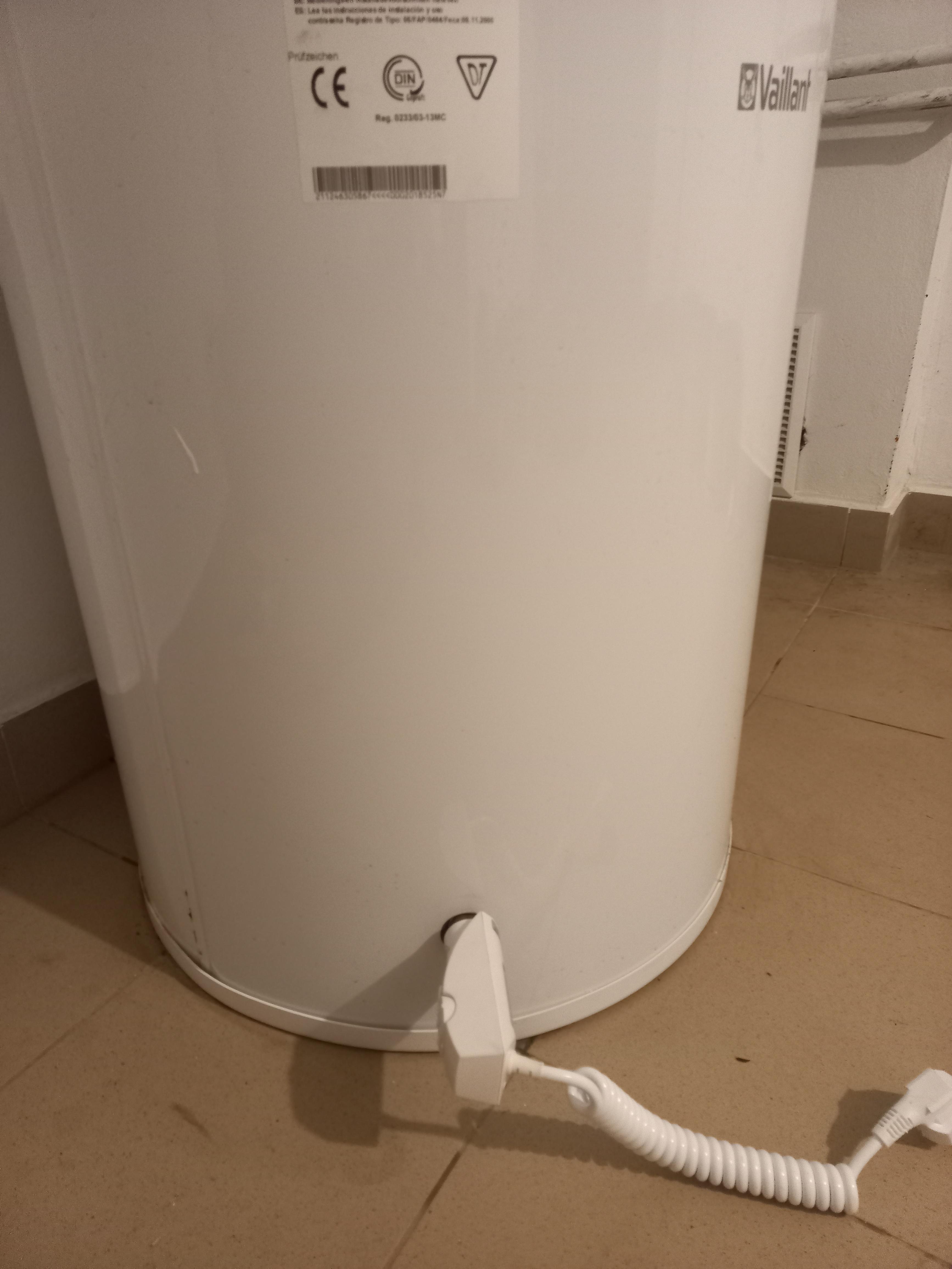

    I was able to install the heater without any problems and everything works great.
    Vaillant VIH 120 tank

  • Short tank heater without thermostat recommended
    #43 20619450
    rbalog
    Installation of a heater with a thermostat is unnecessary, it is for rooms, look for heaters without a thermostat that are much cheaper.
    I installed a heater from Proecosolar.pl, a special one for tanks, and luckily it was short because I had only 40 cm of space in the tank.
    https://proecosolar.eu/pl/electric-heaters/55...-1000-w-36cm-g-12-cassette-5902734702234.html Installation of an electric heater in the Vaillant vih r 150/6 B storage tank
    also available on allegro for PLN 58.
    you don't even need a controller because there is no possibility of overheating the tank - a tuya or shelly socket is enough.
    You just need to enlarge the hole in the housing a bit, because I had an off-center in relation to the holes and the gasket was badly arranged.
    I also sealed it with tow to be sure.
    Only one heater was needed because I have raised voltage only on one phase. Someone has a single phase inverter and bears the voltage on that phase.

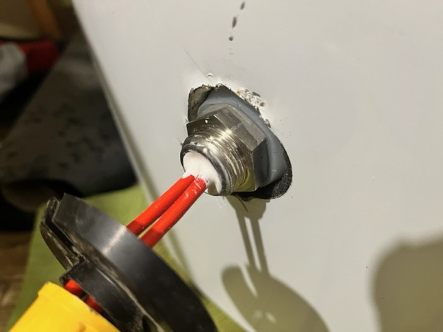

    I also managed to mount the heater in place of the drain valve. VIH R 150/5. Maybe it's a matter of vintage in terms of whether the heater will fit there or not. My quite old, teenage years.
    The hole in the outer housing needed to be corrected. Heater with proecosolar.

    Without the extension, because I was afraid of what they wrote about here, that then creates a place where the heater overheats, so directly.
    With the thread there is all ok - no change. I enlarged the hole in this outer tin housing, with a small grinder (I had no other suitable tools). Maybe it doesn't always need enlarging, it depends on how they make it. Mine was made somehow so strangely, crooked, by the way, you can see that originally they also undercut it a little to even screw the drain valve in. The heater on the outside is a little larger than the valve, so it had to be enlarged.

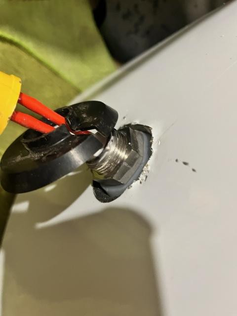

    I decided to supplement my entry with details of the heater installation.

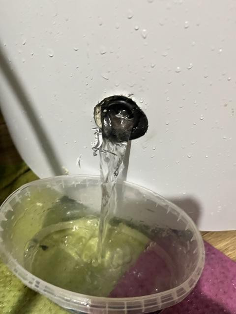

    1. I turned off the drain valve. The water started flowing continuously, but slowly. Two cloths underneath, replaced every now and then. A second person is useful.
    2. I put the recommended heater in to test to see if it would fit. It was ok, the coil was not blocking.

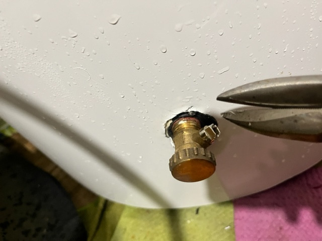

    3. I screwed a plug into the hole to stop the water flow and used tin snips to enlarge the hole in the casing to freely screw in the heater.
    4. I wound the tow with paste onto the thread of the heater. I didn't cut the thread. It doesn't leak.
    5. I screwed in the heater carefully, using an open-end wrench.
    6. I prepared the electrical installation, initially with a 0.75 wire, but it got slightly warm so I changed it to 2.5 because that's what I had. In my opinion, 1.5 is enough.

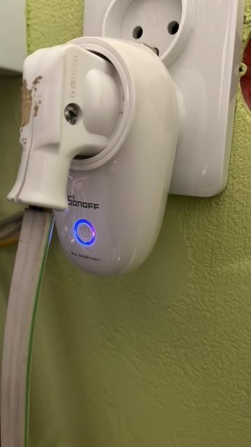

    7. I programmed the previously purchased Sonoff WiFi socket to turn on 3 times a day for 2 hours. 9-11, 1-3 p.m. and during bathing 7-9 p.m.
    8. I connected the heater and everything is OK.
    1000W heater (checked with a meter gives approximately 1035W) 120 liters of water for a daily shower for a family of 4. If that's not enough for someone, he can turn on the gas. Personally, I have surplus energy from panels, and currently I do not intend to install a pump.
    Everything works, I recommend it.

  • Gas boiler F28/F54 cleared by tapping stuck tee
    #56 20767233
    lary79
    Posts: 14
    Rate: 9
    I give my comments after installing the electric heater.
    After using the electric heater for a few days, I found that I would disconnect the gas boiler from the electricity, because the heater fully met my DHW needs. After about 3 weeks of disconnecting the gas boiler from electricity, I started it up to heat the entire tank with hot water using gas. The boiler showed error F28 and F54 - no gas supply. To make the boiler forget about the error, it is necessary to press the button of the crossed flame next to the boiler - reset. Removing the plug from the power supply does not help.
    To fix this:
    1. In the gas box by the regulator there is a wire that you need to slide up and unscrew the plastic plug to pull the metal pin back towards you (plenty of videos on YT on how to do this). You should be able to hear the venting (hissing) and refill the system with gas. In my case, this did not help.
    2. After consulting with the boiler installer, I did a restart and tapped the copper tube inside the boiler about 5 times. He said that there is a tee that likes to hang up during idle and gives such an error. It helped, the boiler started correctly.
    To avoid such a situation, I set the startup of the electric heater to 9-11 a.m. and 12-14 p.m., and the gas boiler to 7-21 p.m. It is important to also use gas, having a gas boiler.
  • Using the gas boiler as backup for the heater

  • Angled heater fitment in slanted tank opening
    #58 20801141
    akm97
    Posts: 274
    Rate: 78
    I am asking for advice from people who installed a heater in a Vaillant tank (I have VIH 120). Well, as if there weren't enough problems, in my case the opening is inclined obliquely to the wall. Depending on the place of application, there is 15-18 cm of space. Is there a chance that the heater (without a thermostat) could enter the tank opening at an angle? Vaillant tank with visible heater opening installed close to the wall.
  • #59 20801377
    VPS
    Level 25  
    Posts: 547
    Help: 87
    Rate: 230
    You need 360mm
    1000 W electric heater with technical description and application.
  • #60 20801516
    akm97
    Posts: 274
    Rate: 78
    I understand that this is the length of the heater. But should I understand that the design of the radiator and heater makes it impossible to even partially insert it into the tank "at an angle"?
