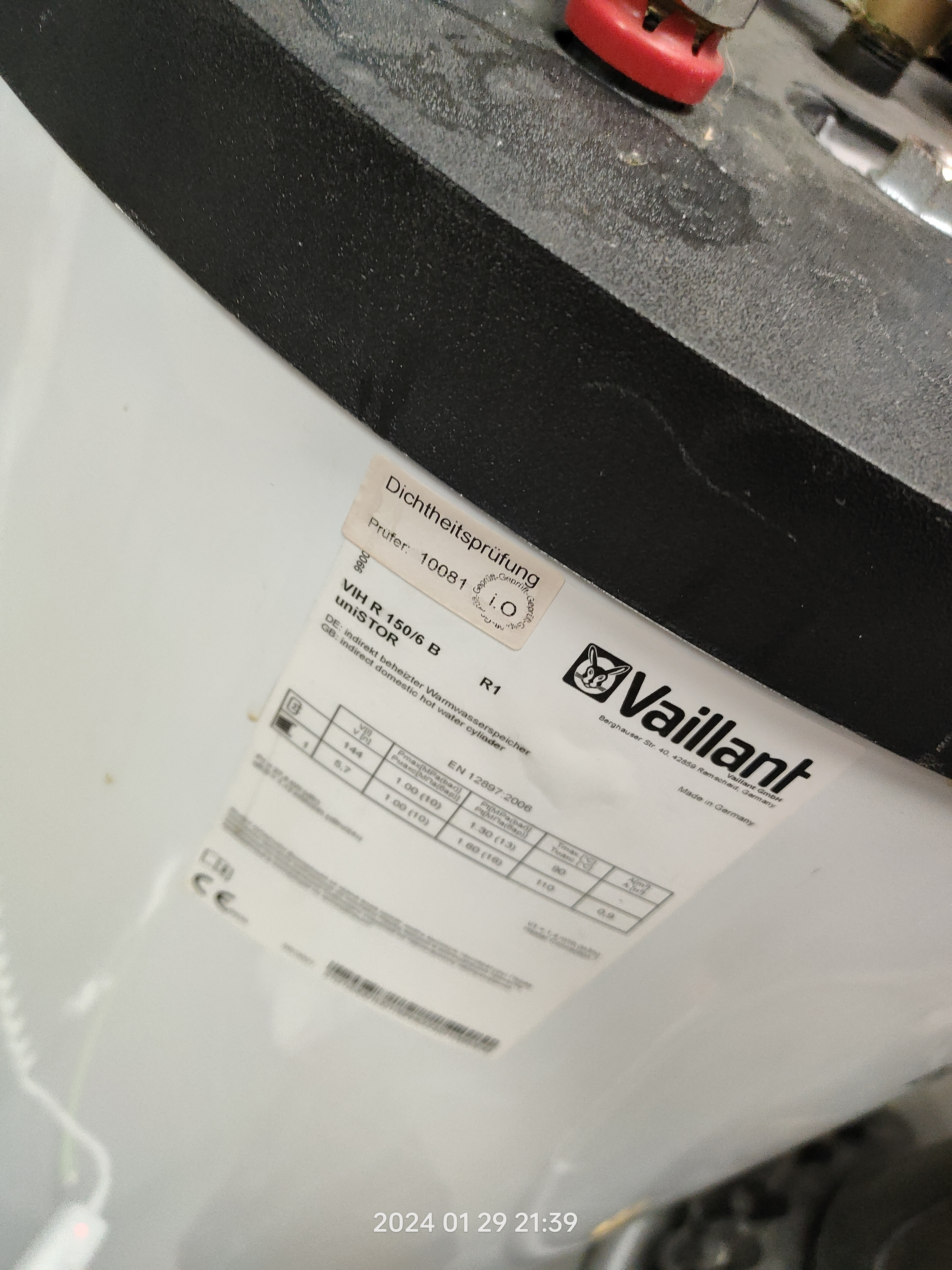

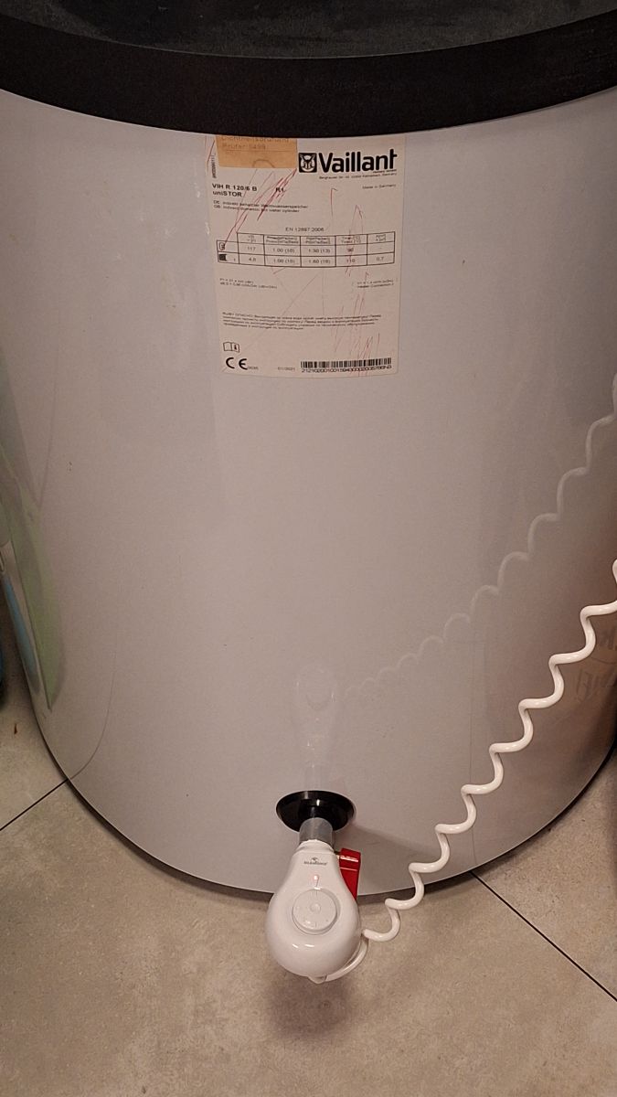

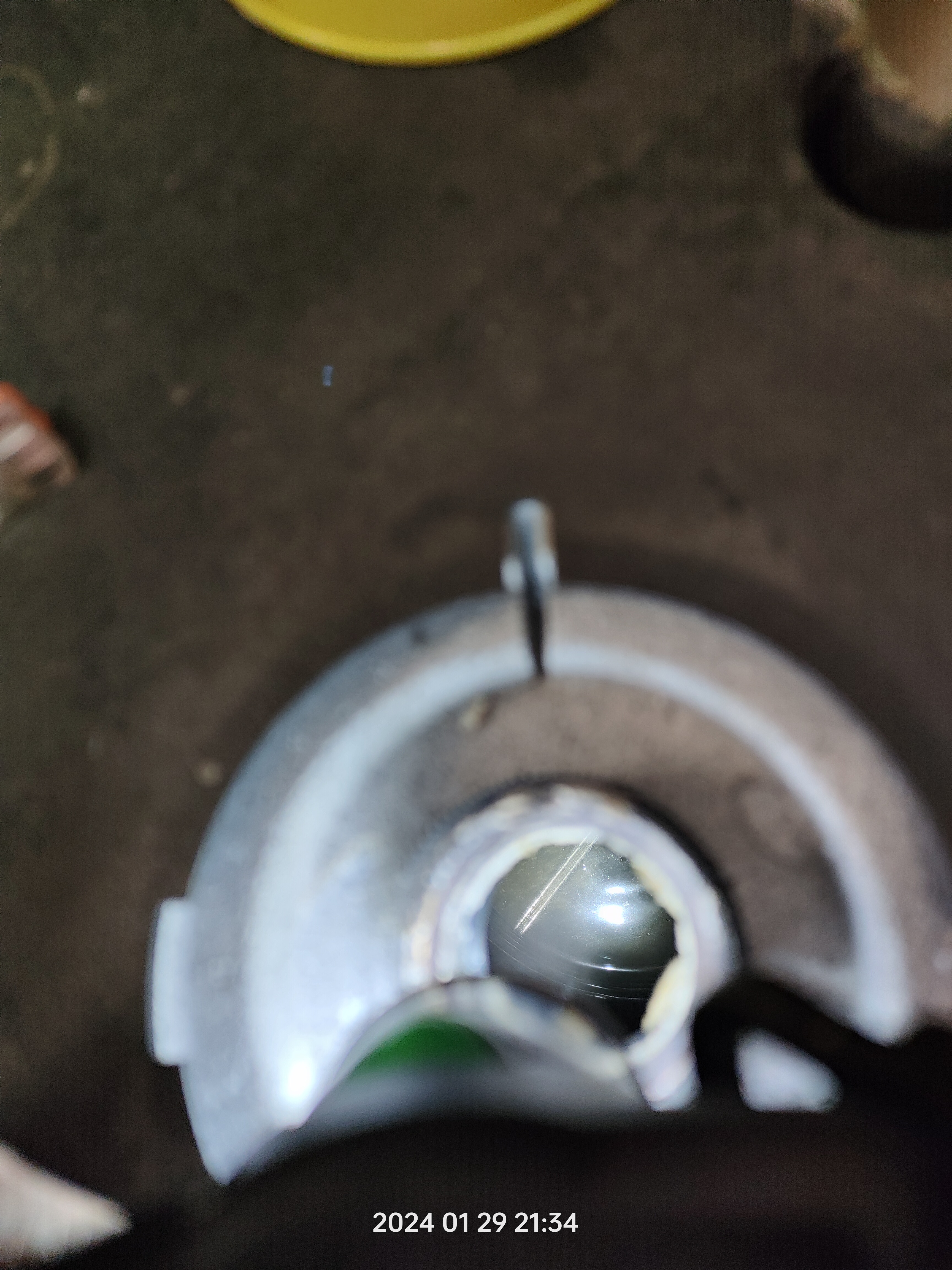

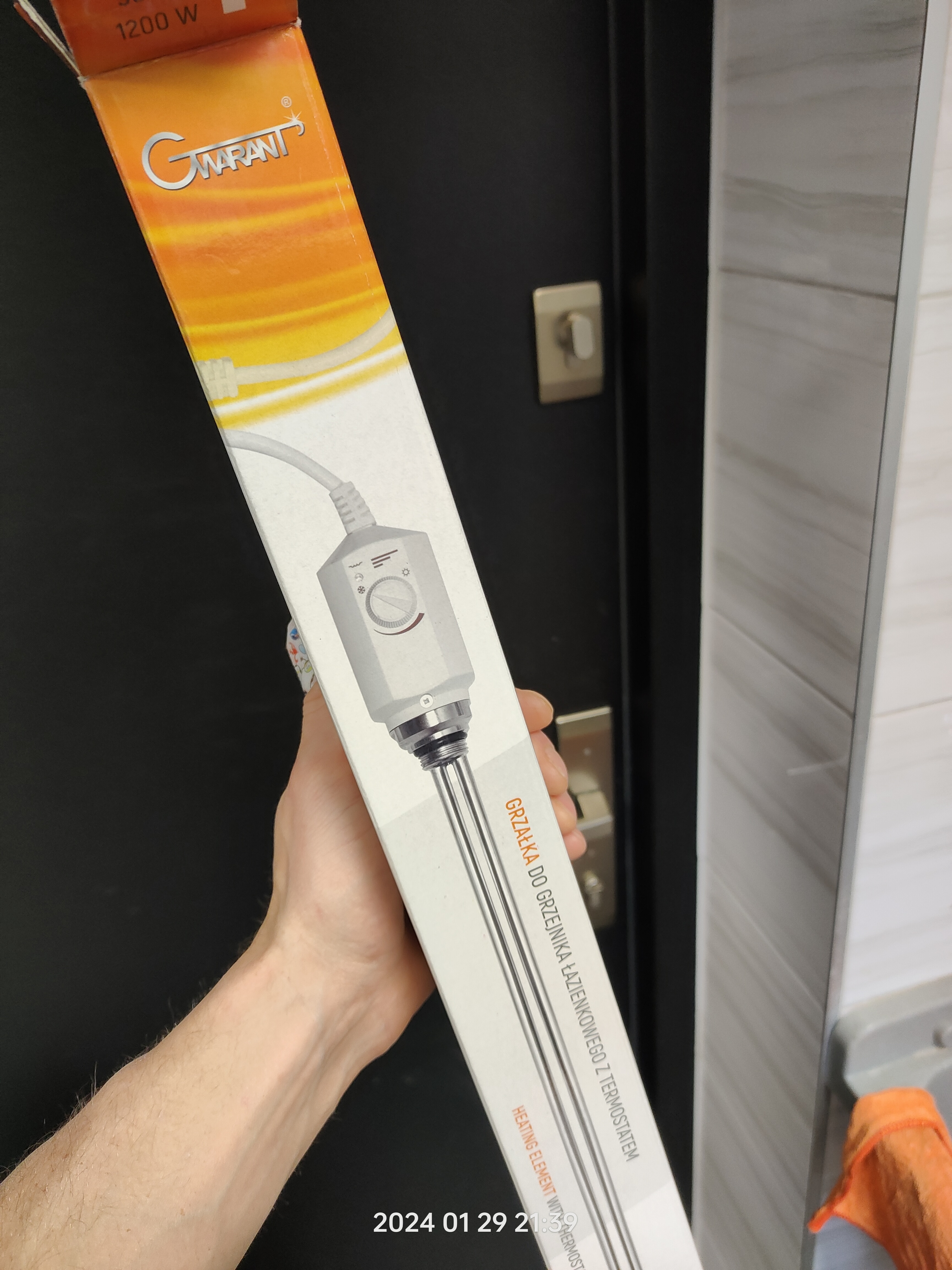

    I managed to install the heater of the Vaillant 150/6b tank as in the photos. It's 900w.
    • Installation of an electric heater in the Vaillant vih r 150/6 B storage tank IMG20240129213438.jpg (2.87 MB) You must be logged in to download this attachment.
    • Installation of an electric heater in the Vaillant vih r 150/6 B storage tank IMG20240129213900.jpg (3.62 MB) You must be logged in to download this attachment.
    • Installation of an electric heater in the Vaillant vih r 150/6 B storage tank IMG20240129213902.jpg (3.26 MB) You must be logged in to download this attachment.
    • Installation of an electric heater in the Vaillant vih r 150/6 B storage tank IMG20240129213940.jpg (2.35 MB) You must be logged in to download this attachment.
  • #68 20935859
    podleckipawel

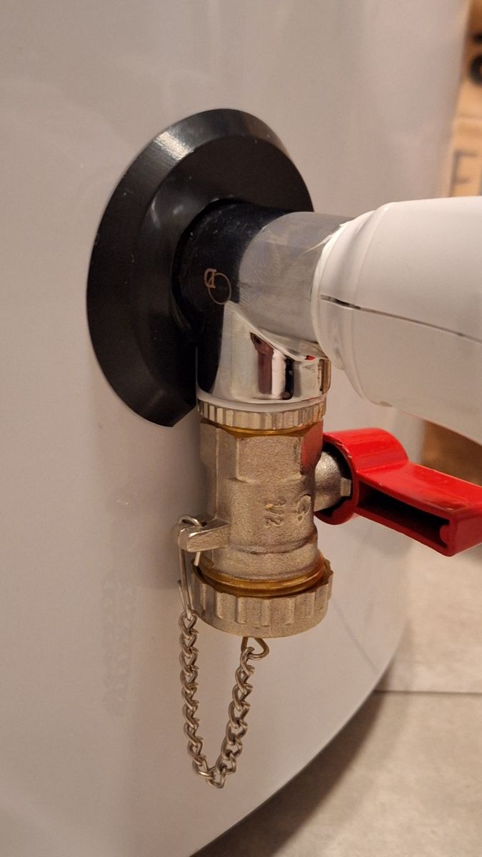

    By installing it without a tee, you have deprived the tank of the drain valve. Close-up of a plumbing connection without a tee fitting.

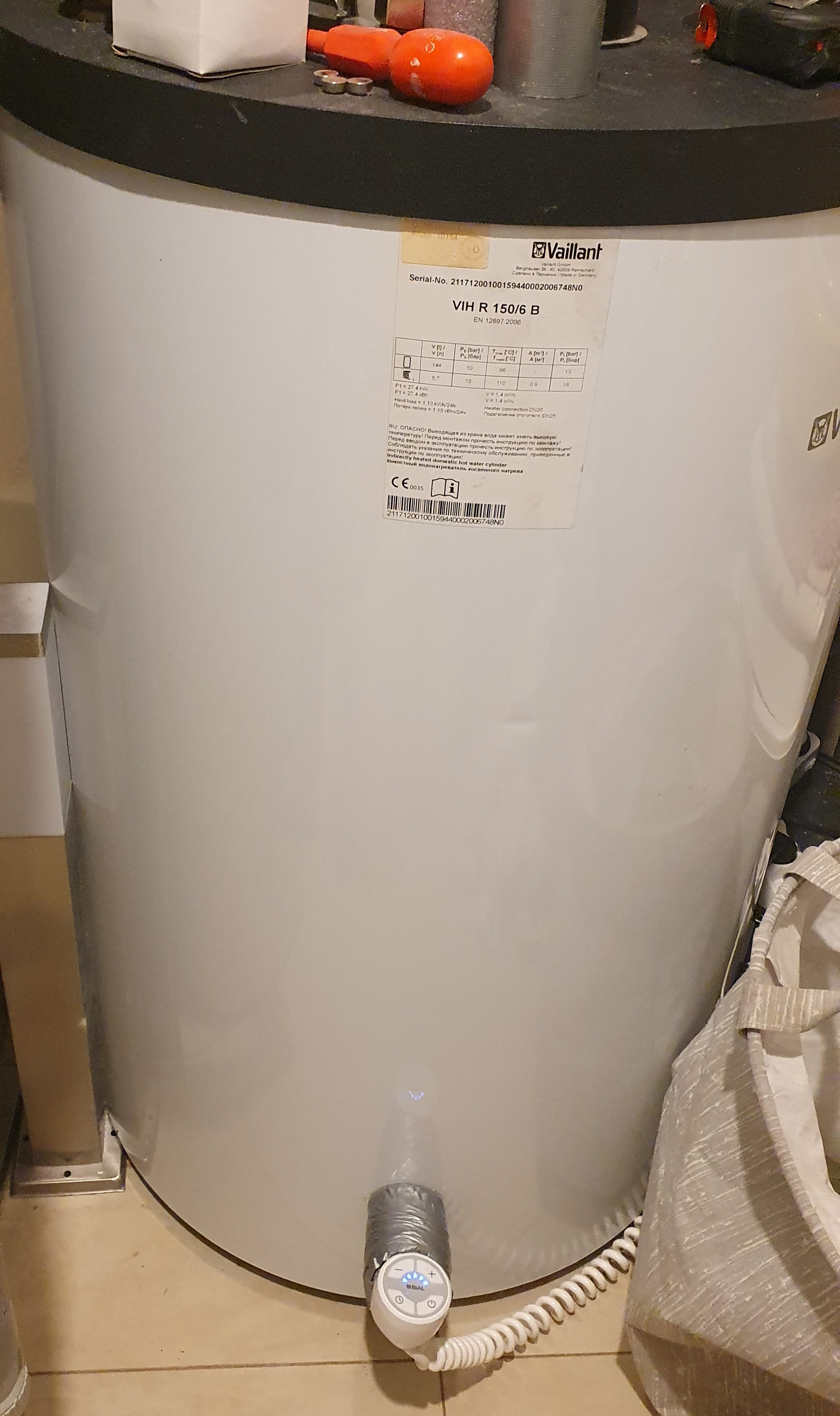

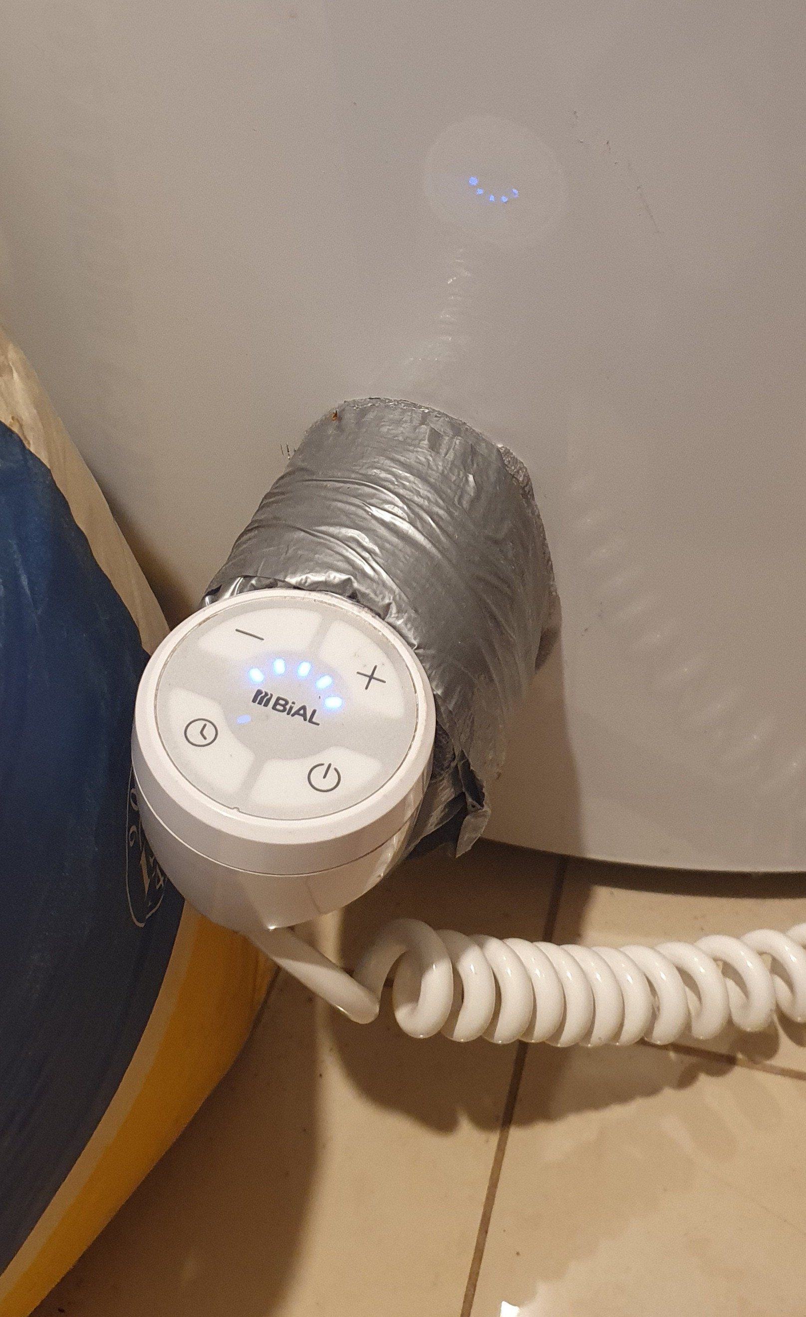

  • #70 21050767
    wagen
    Posts: 31
    Rate: 8
    Hello, I added the heater, screwed in the T-connector and it was hard to screw it in, but it worked 😁
    • Installation of an electric heater in the Vaillant vih r 150/6 B storage tank 20240418_203026.jpg (1.02 MB) You must be logged in to download this attachment.
    • Installation of an electric heater in the Vaillant vih r 150/6 B storage tank 20240418_202957.jpg (650.81 KB) You must be logged in to download this attachment.

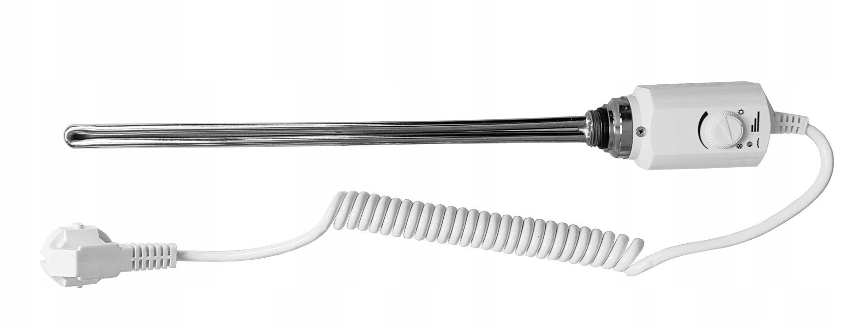

    Hi. As I wrote a few posts earlier, I have an additional problem because of the wall at the storage tank, through which theoretically only a heater with a length of 18, maybe 20 cm will go in. And I have found such heaters on Chinese allegro, which look very similar to those of the Proecosolar form, but are shorter:
    20 cm - 1kW
    15 cm - 800W
    Cost approx. 40-50 zł. Perhaps these will work for some people who are bothered by the coil. Of course, there is a risk that the Chinese watts will be weaker than the European ones, but I decided to take the risk:-) After purchase, I will measure and post the actual current draw of the heater. I also did a test inside the tank and a thick rod about 21 cm long goes in and doesn't hook on anything, and one 26 cm long I couldn't put in the hole at all because of the proximity to the wall.

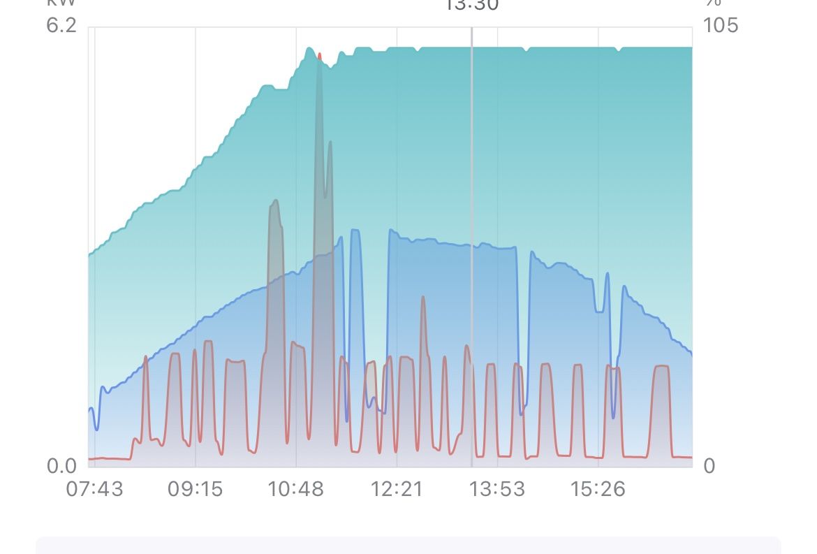

    I have had a Volux 1200w heater fitted for 2-3 days and I have encountered that the heater switches off very frequently. On the photovoltaic preview it looks like it is running for 5-10 mins and then a pause of 10-15 mins. Recently it raised the water temp from 32 to 47 throughout the day (seemingly good, but could do better). Would it be possible to work out how to make it run continuously?
    The heater is screwed directly into the Vaillant VIH R 150/6 cylinder, without a tee.
    Chart showing the operation cycles of a heater and photovoltaic energy production throughout the day. .
  • #83 21540249
    akm97
    Posts: 274
    Rate: 78
    Quite strange looking. The bottom graph is surely the mains voltage? I'm not sure a 1200W heater would have that much effect on it. I understand that the heater is connected bypassing any 'controller'? If so, it looks like it is being disconnected by a 'thermistor', but why I don't know. Perhaps it is faulty? To be sure, it would be a good idea to connect it via a socket with a current draw measurement.
  • #84 21541003
    jakubowczarek
    >>21540249 .
    The cause of the heater disconnecting and jumping operation has already been found. The plumber had connected the heater through a screw, because it was impossible to turn it in the tank, the coil was blocking it. The screw is by the casing itself and gets hot, so the thermostat reads its temperature and switches off the heater.
    I have two options: either remove the thermostat in this heater or buy a new one, the one you inserted above, without any electronics 😀.
