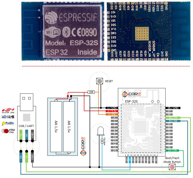

Corrections to ESP32 WROOM 32D pinout: RTC 21, 22, Battery, TFT Touch
domus12 4332 30
How should I correct the ESP32 WROOM-32D pinout for the RTC, battery measurement, TFT, touch inputs, and power/reset connections so the circuit works properly?
Use GPIO21/22 for the RTC I2C SDA/SCL, add a 10 kΩ pull-up from EN to 3V3 so the ESP32 does not randomly reboot, and do not leave EN floating [#20086680][#20086864] The battery measurement should go to GPIO32, not GPIO21, because GPIO21 is not an ADC input [#20088465] For the touch controller, the corrected mapping given was X+ -> GPIO25, X- -> GPIO26, Y+ -> GPIO27, and Y- -> GPIO33 [#20088465] TFT reset should be connected to GPIO17 as in the schematic, and the backlight/power section needs checking because the shown schematic had the cathode and anode tied together [#20088465] Also, ESP32 GPIOs are not 5 V tolerant, so the LED/diode drive must use proper series resistors or MOSFETs rather than driving them directly from the ESP32 [#20088442][#20088454]

    Oddly enough, these chips work with my duco, but I had to give it a separate power supply for programming because the one from the programmer couldn't handle it.
    reset is shorted to plus
    • Corrections to ESP32 WROOM 32D pinout: RTC 21, 22, Battery, TFT Touch 1.jpg (90.13 KB) You must be logged in to download this attachment.
The discussion revolves around correcting the pinout for the ESP32 WROOM 32D, specifically addressing connections for RTC pins (21, 22), battery, and TFT touch display. Users suggest connecting a 10k resistor to the EN pin to prevent random reboots. The conversation includes inquiries about the correct pin assignments for various components, including RTC (using RTClib.h), TFT display (ILI9341), and touch inputs. There are concerns about the power supply for LEDs and the necessity of using resistors to ensure compatibility with the ESP32's GPIO limits. The importance of verifying the schematic design and ensuring proper connections for functionality is emphasized throughout the discussion.

Why add a 10 kΩ resistor to the EN pin?
EN must stay high; a floating EN pin drops low and powers the core down, causing random resets. A 10 kΩ pull-up to 3.3 V keeps EN > 0.75 × VCC as required [Elektroda, khoam, post #20086864]
Which pins should I use for the DS3231 RTC on Wire/RTClib?
Use the hardware I²C lines: GPIO 21 for SDA and GPIO 22 for SCL. These pins support open-drain and already appear in many libraries [Espressif DS, 2020; Elektroda, domus12, #20088422].

Which ESP32 pins suit the resistive touch (X+, X-, Y+, Y-)?
Assign ADC-capable pins only: X+ → GPIO 25, X- → GPIO 26, Y+ → GPIO 27, Y- → GPIO 33. All four belong to ADC1, avoiding Wi-Fi interference on ADC2 [Elektroda, inot, post #20088465]
How can I read Li-ion battery voltage safely?
Route the divided battery line to GPIO 32, an ADC1 input. Use a 100 kΩ/47 kΩ divider to keep the ADC node ≤ 1.1 V when the cell is 4.2 V. Resolution: ±7 mV after calibration [Espressif TRM, 2020].

How do I stop the backlight from staying off?
Ensure LED+ connects to 3.3 V (or 5 V) through a 10–15 Ω resistor and LED- sinks via a MOSFET or directly to GND. In the faulty schematic, anode and cathode were shorted, preventing current flow [Elektroda, inot, post #20088465]
