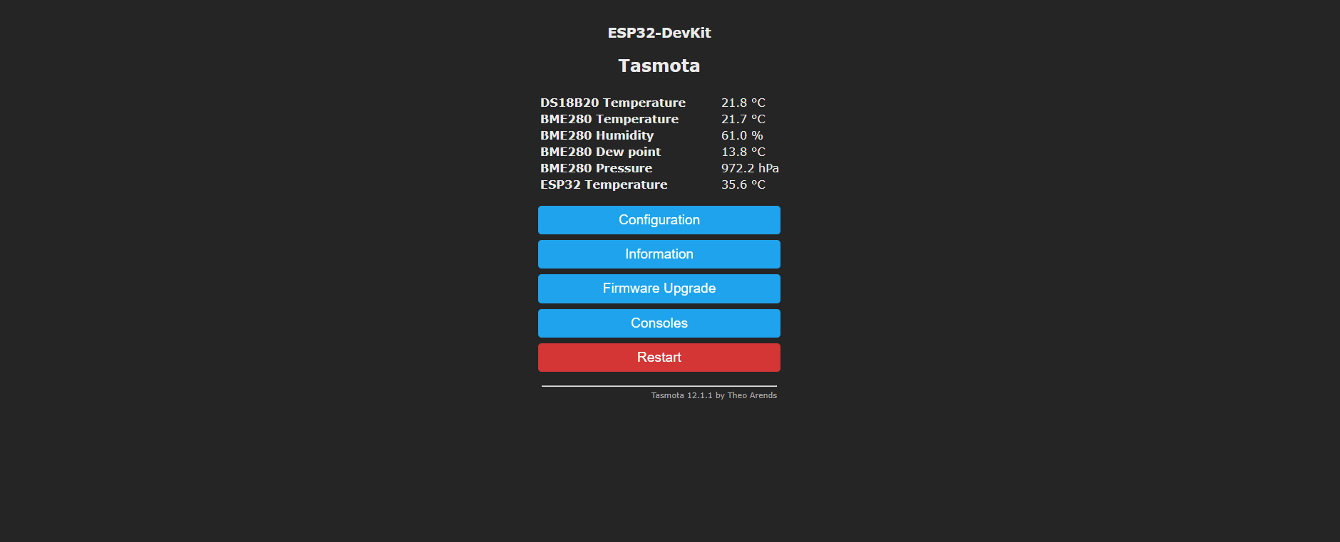

    Hi. I have connected a BME280 module to the ESP32, while the temperature shows fine, the humidity is also rather good, the pressure is rather wrong. It comes out about 30hPa too low, is there any way to correct the pressure gauge in tasmot?
    • BME280+Tasmota+ESP32: Pressure correction, pressure gauge calibration, improved readings BME280.png (25.38 KB) You must be logged in to download this attachment.

    In relation to what is given by the smartphone app and the current msn forecast service.
    Are you suggesting to me that my barometer is giving the right one in relation to the altitude it is at, and the forecasts are giving the pressure at sea level altitude?

    The last hint solved the problem.
