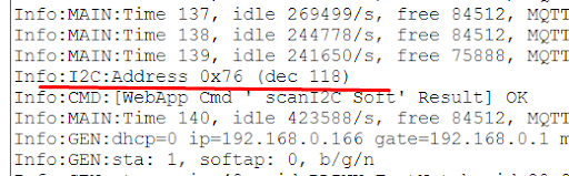

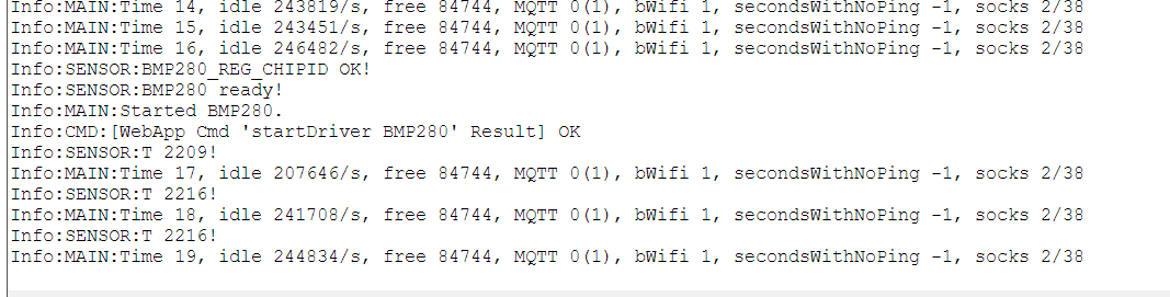

    I've got it almost ready for you, here are first signs of life:
    Screenshot of system log showing I2C address: 0x76.
    And here is temperature read:
    Screenshot of temperature readings from the BMP280 sensor.
    I will try to commit it soon and let you test. Are your BMP280 (or E, they are similiar, right?) sensors ready?

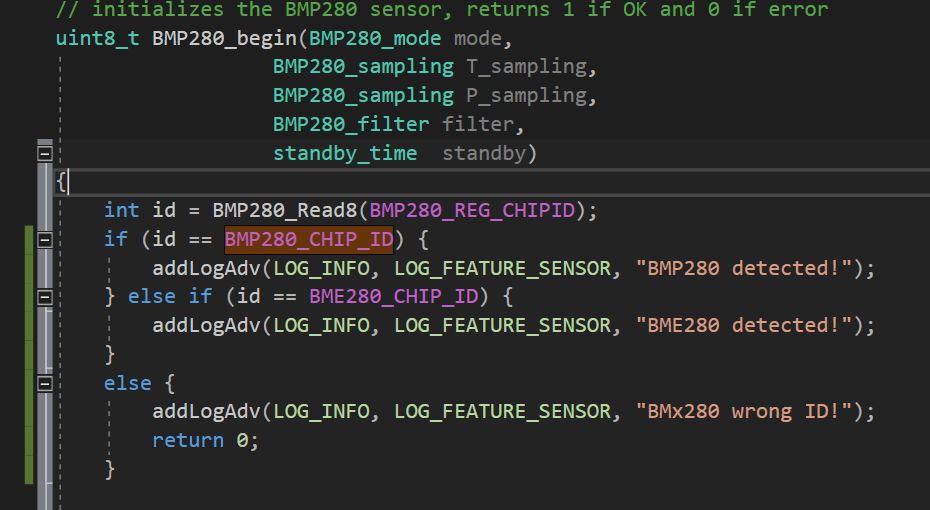

    BME280 library gains address selection and ID detection
    #14 20862222
    Posts: 14764
    Rate: 12897
    Thank you for your kind words, the library I used is the same which I used in this topic: https://www.elektroda.pl/rtvforum/topic3961713.html#20467262 , it was originally for PIC but I ported it, it was created by https://simple-circuit.com/
    I am adding ability to choose address now, I also added ID detection:
    Code snippet for initializing the BMP280 sensor with ID detection.
    I will next ook into the humidity measurement.

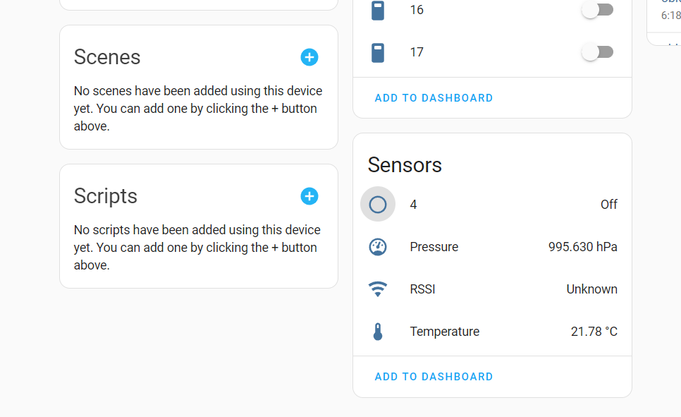

  • Temporary HA workaround using humidity channel type
    #19 20863167
    bilbs84
    Posts: 14
    Helmi_B wrote:
    Folks, hope you've read the datasheet of the BME280: the temperature value is only for correcting the humidity and pressure values.
    Wow, I'd never noticed that. I'd never even bothered to question the reading straight off the chip, as of all my IoT things, it's the one that reads closest to my home's thermostat. If I place the BME on top of it, I get a reading, usually within 1 degree of it. The BME280 that I have is actually sold as a temperature sensor, and the Datasheet also mentions that the temperature reading can also be used for estimating ambient temperature. So I figure that for my purposes, it's accurate enough.
    That's a good point, I can add a simple calibration mechanism (just an offset) for people who insist on using that value
    I think that's a good solution, kind of like the CHT8305 sensor that's in one of my devices.
    Well, there are many ways it can be done. You can wait for me to integrate BMP280 into HASS discovery. Or you can just set channel type (like Temp_div100) and use channel-type-based Discovery:
    My temporary workaround is to set the pressure channel type to Humidity so that both values are published to HA, then I apply the correct divider and measurement unit with a template sensor for dashboard display. Not the best way of doing it, I know, but at 3am, it was about the best that I could manage.
    With the rate of development on the OpenBK project in general, I suddenly find myself no longer looking past any devices with the WB2S modules like I used to.

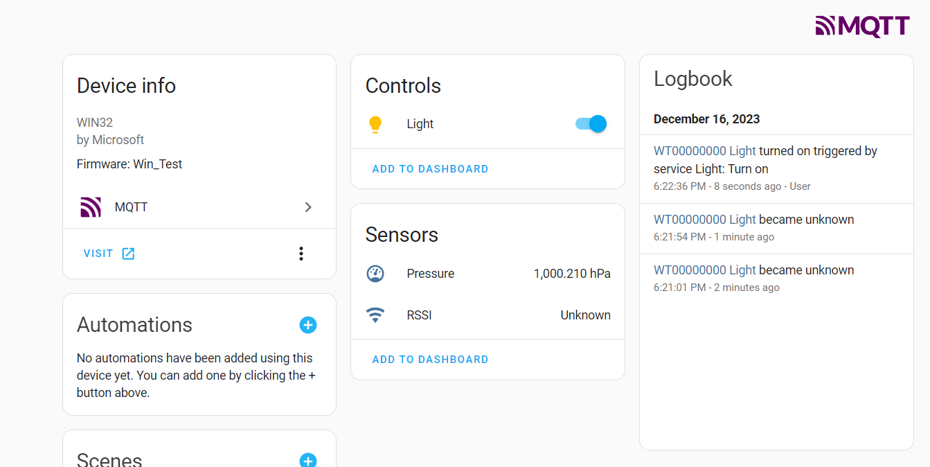

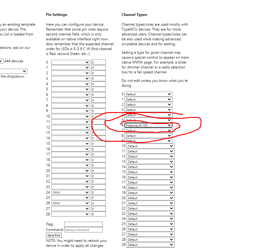

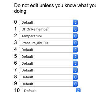

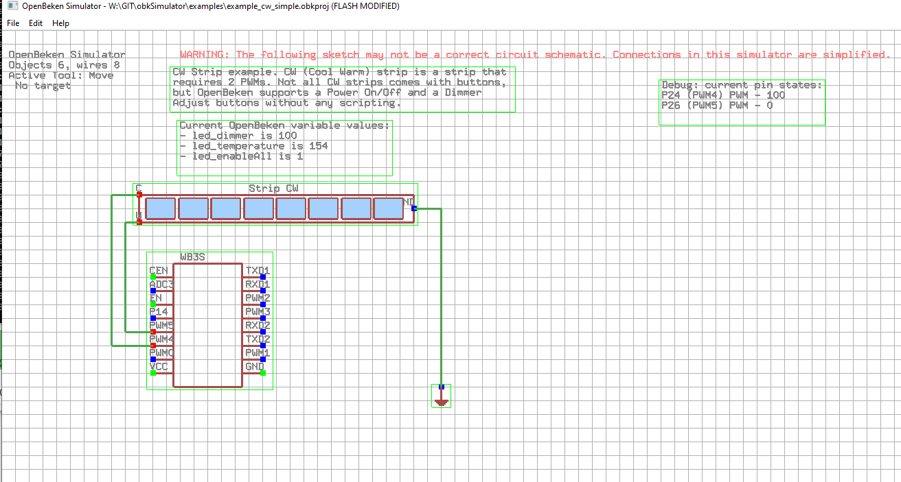

    Ok I have added pressure, but I only tested in simulator:
    Screenshot of a control panel with device information and logbook.
    Screenshot of the OpenBeken simulator showing the connection schematic of LEDs and controller.
    Screenshot of device pin settings and channel types with Pressure_div100 entry highlighted.
    I will commit changes now, let me know if it works for you

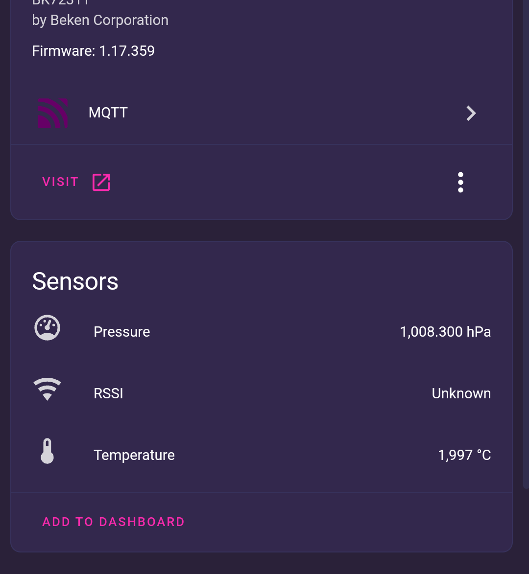

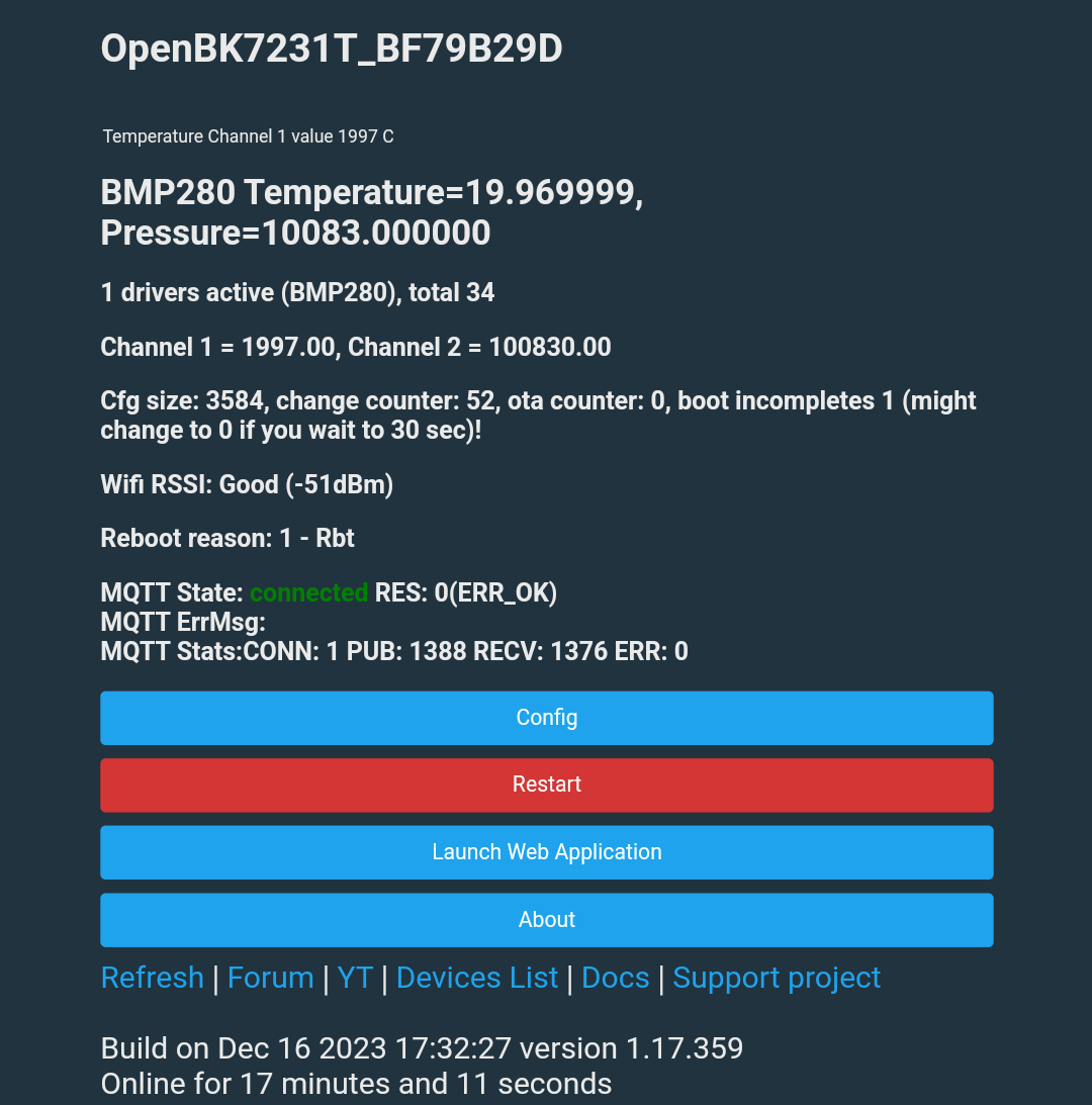

    bilbs84
    Posts: 14
    I see the channel type. If I set it (Ch2 on my configuration), then the HA autodiscovery works and it adds the pressure channel. However, in the device web page, the value is blank where the channel types are usually displayed.
    User interface displaying sensor information: pressure, RSSI, and temperature. OpenBK7231T device status page showing temperature, pressure, and MQTT connection info.
  • #22 20864475
    Posts: 14764
    Rate: 12897
    Well, on my own screenshot, it doesn't seem blank, so maybe you need to refresh your page? As far as I remember it fetches the channel type names from OBK itself.
  • #23 20864517
    bilbs84
    Posts: 14
    Sorry, I may not have been clear.
    The function in HA is perfect, the missing part is in the OBK device webpage. At the top, where it displays the channel types with scaling. In my screenshot, you see the temperature, but not pressure.
  • Pressure_div100 bug divides by 10, not 100

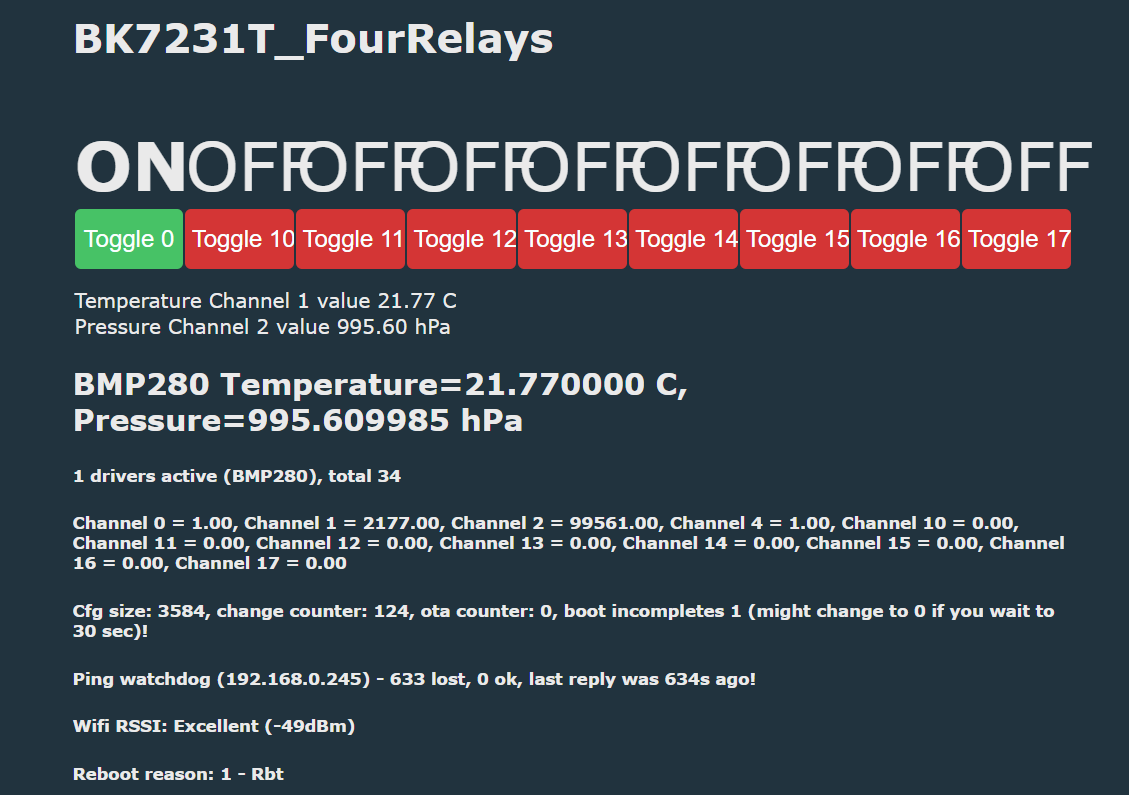

    #24 20865409

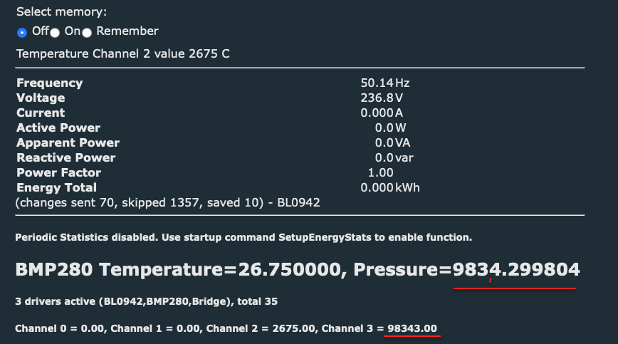

    Osrx
    Posts: 11
    Hello! Thank you for your work.
    I have BME280 sensor and it's generally work.
    Firmware: Build: Build on Dec 17 2023 11:15:27 version 1.17.360
    Autoexec: startDriver BMP280 14 16 2 3
    Screenshot showing a dropdown list with various sensor settings.
    But in Index page Pressure not calculated properly. Pressure_div100 actually divided by 10 not 100.
    Screenshot of a BME280 sensor reading panel showing data on temperature, pressure, and energy.
    Humidity not work for now.
  • Correct BMP280 pressure scaling from deka to hectopascals
    #25 20865733
    bilbs84
    Posts: 14
    Hi
    Glad to see another with the BME280, it will be good to have another that can test.
    The unit reading in the index page, is in deka pascals, not hecto pascals. I think that in the long run, it would be best to apply the correct scaling to hPa here too. If you're familiar with C, and building your own version of OBK, it's actually fairly trivial to change how it is displayed here.
    in drv_bmp280.c Change the line,
    hprintf255(request, "<h2>BMP280 Temperature=%f, Pressure=%f</h2>", g_temperature*0.01f, g_pressure*0.1f);
    to
    hprintf255(request, "<h2>BMP280 Temperature=%f, Pressure=%f</h2>", g_temperature*0.01f, g_pressure*0.01f);
    and then the index page will be in hecto pascals pascals instead.
    I've just not bothered changing it during any of the development, as right now, I'm just glad that it IS being actively developed, and I don't want to waste the devs time with such a trivial change. The scaling in Home assistant is correct however, and that is where I'm viewing all my sensors anyway. I guess this is all stuff that we can wait until humidity is working to iron out.
  • #26 20865737
    Posts: 14764
    Rate: 12897
    I will push a fix and required channel types in few moments. You were correct @bilbs84 that something was missing.

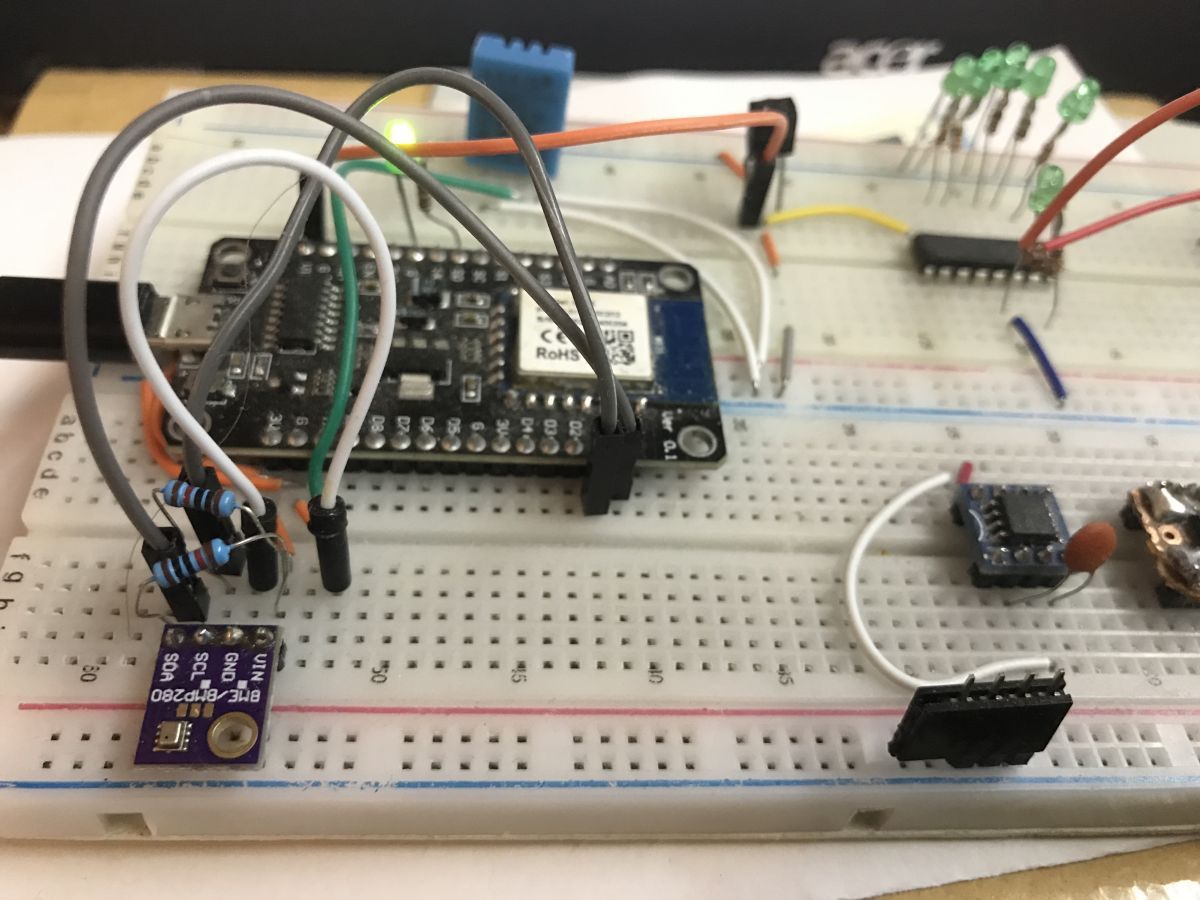

    A breadboard with connected electronic components, such as sensors and modules.

    My testing setup:
    Breadboard with ESP32, BME280 module, and other electronic components.
    Certainly a lot more practical than mine. I just have wires soldered to a WB2S module, powered by an ESP32, and dupont pins on the BME salvaged from my old weather station, all precariously balanced on a shelf lmao

How can I publish BMP280 or BME280 temperature and pressure readings from OpenBK to Home Assistant over MQTT?
Use OpenBK channels with MQTT publishing, then let Home Assistant discover them or publish them manually. The thread gives two direct commands: publishFloat myTemp $CH1*0.01 and publishFloat myPress $CH2*0.1. You can also trigger updates on change with addEventHandler OnChannelChange 1 publishFloat myTemp $CH1*0.01. One user said the target platform was Home Assistant over MQTT, and the developer confirmed both discovery-based and script-based publishing paths. [#20862313]
What's the correct way to scale OpenBK BMP280 pressure and temperature values for Home Assistant, including Temp_div100 and Pressure_div100?
Scale temperature by 0.01 and pressure by the correct divider for the channel type you use. The thread shows raw values like T 2391 and P 100185, which correspond to about 23.91 °C and 1001.85 hPa after scaling. In OpenBK, Temp_div100 is the expected choice for temperature, and pressure needed its own corrected handling during development. One fix changed the web display from g_pressure*0.1f to g_pressure*0.01f for hectopascals. [#20865733]
How do channel types and the divider flag in OpenBK affect MQTT values for BME280 or BMP280 sensors?
Channel types control formatting and discovery, but MQTT can still send raw integers unless the divider flag is enabled. A BL602 user saw 2660 over MQTT instead of 26.60, even though the web page displayed scaled values correctly. The developer answered that a divider flag solves that mismatch because OpenBK still follows the TuyaMCU-style integer storage model. Turn that flag on if you want MQTT payloads to honor the selected divider. [#21013349]
