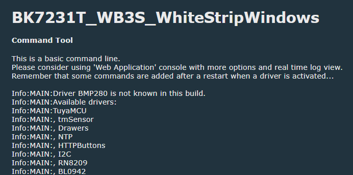

    If the uploaded binary file does not contain the BMP280 driver, which can be checked with the command "startDriver BMP280", as below:
    Screenshot of the BK7231T_WB3S_WhiteStripWindows command tool. .
    This we can look for a version with BMP280 enabled in Pull Requests on Github and download the binaries from there, or independently enable in obk_config.h for our platform ENABLE_DRIVER_BMP280 , create a PR and download the online compiled binaries from there. Details:

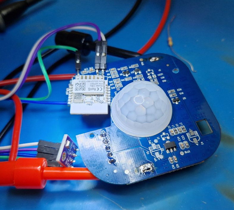

    The BMP280 controller also supports the BME280. We connect the sensor to the free pins, and remember the power supply. Then, in autoexec.bat:
    We enter:
    //startDriver BMP280 [CLK] [DATA] [ChannelForTemp] [ChannelForPressure] [ChannelForHumidity] [Adr8bit]
    startDriver BMP280 7 8 3 4 5 0x76
    The meaning of the arguments as in the commentary. We determine the CLK and DATA pins for the I2C bus. The number 7 in the example code snippet means P7 on the Beken platform, for other platforms it is worth looking at the Pins tab and there is a numbering spread. Then we specify the channel indexes for temperature, pressure and humidity.
    The controller, named BMP280, also supports BME280 and automatically detects which type of sensor is connected.

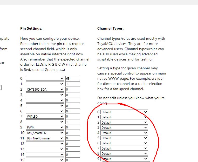

    Step 3: Channel types and Home Assistant Discovery .
    It is now necessary to set the selected channels to the appropriate role (Temperature, Pressure, Humidity, etc.). This is done in the Web App:
    View of pin settings and channel types in the configuration application. .
    Next, Home Assistant Discovery can be performed to make the whole thing appear in HA.
    Home Assistant Discovery is based on channel types, so setting these up is essential.

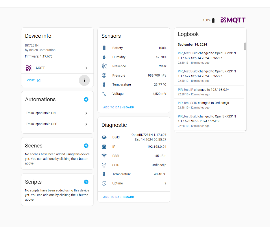

    This is what the paired device looks like in the PIR sensor + BME280 version:
    OpenBeken user interface for BK7231N device showing device info, sensors, and logbook. .

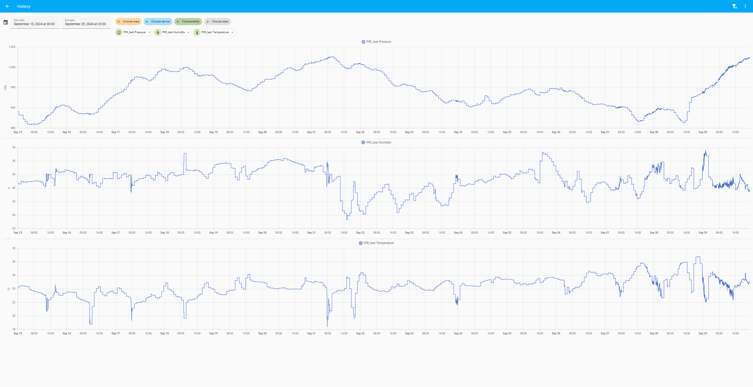

    In this way, graphs of the collected measurements can be obtained in Home Assistant:
    Graphs from Home Assistant displaying pressure, humidity, and temperature data from the BME280 sensor. .
    Example of modification: PIR sensor + BME280 .
    In the manner described here, we have modified the PIR sensor that I have previously described:
    [CBU/BK7231N] Tuya PIR motion sensor Kraslaw 120°, deep sleep, battery powered .

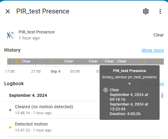

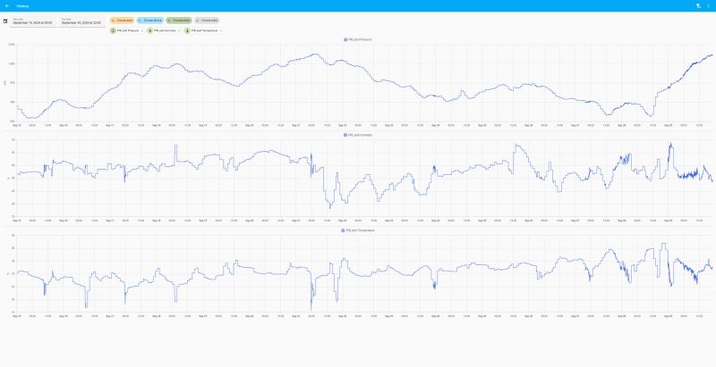

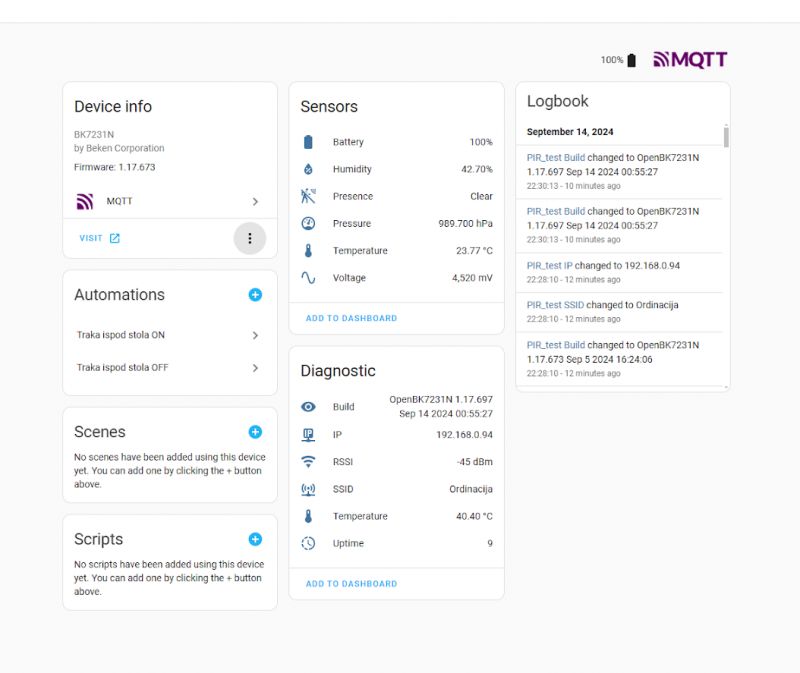

    We modified it to be USB-powered, which relieves us of the problem of power saving. The Temperature, Humidity, Pressure channels were added to the Presence - Presence channel, and we gave the corresponding pin the role of dInput, which is a digital input - 1 or 0. The result:
    Home Assistant user interface displaying motion detection history from a PIR sensor. .
    The device correctly performs a number of functions, and what's more, it can either be scripted additionally in OpenBeken (e.g. when a given temperature is exceeded, it switches on a relay or sends a GET packet to another device), or in Home Assistant (just like any other device in HA).

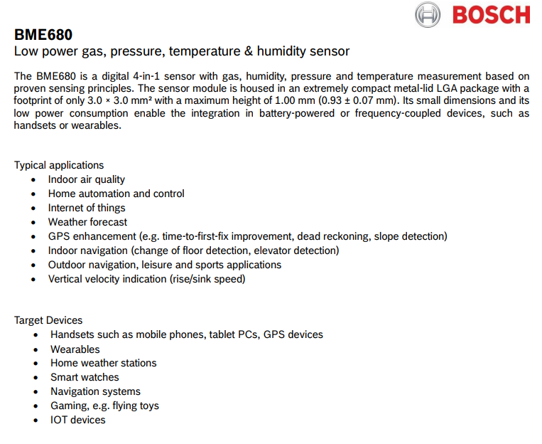

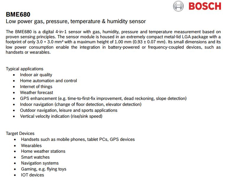

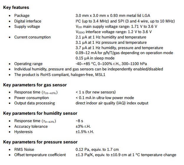

    I suggest using the BME680 instead of the BME280.
  • #3 21261974
    Posts: 14764
    Rate: 12897
    BME680? 4in1, not bad. Thank you for the recommendation, I will order and try it out.
    Specification of the BME680 sensor for gas, pressure, temperature, and humidity measurement. .
    BME680 sensor specification with key features and parameters. .
  • #4 21262001
    Andrzej Ch.
    Posts: 2243
    Help: 223
    Rate: 393
    I use in various projects instead of the BME280. There may be some problems with atmospheric pressure calibration.

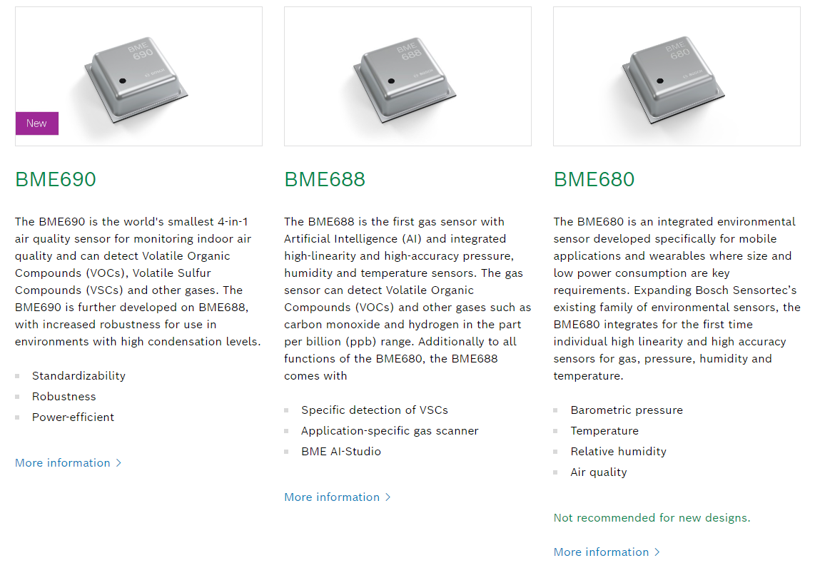

    >>21261951 .
    It looks impressive, but we see "not recommended for new designs" on the manufacturer's website.
  • #6 21263174
    Posts: 14764
    Rate: 12897
    Image of three Bosch air sensors: BME690, BME688, and BME680, with descriptions of their functions and applications. .
    I can still see BME690 and BME688 on this page.

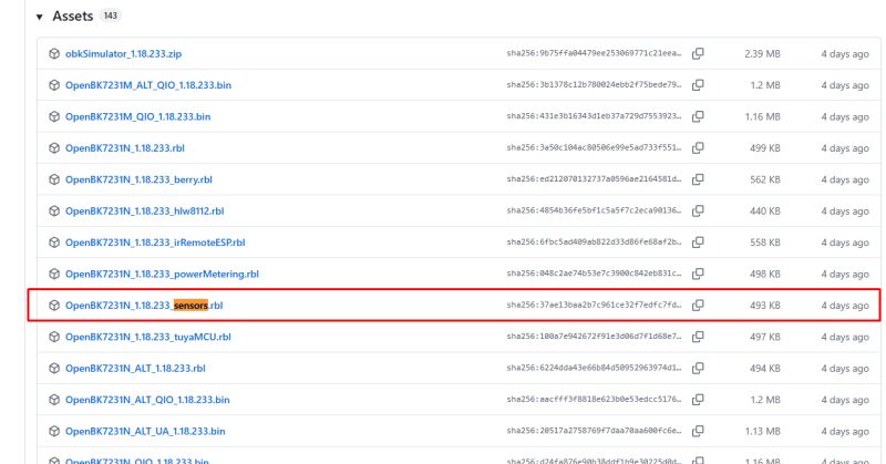

    If anyone is looking for a firmware compilation with the BME280, they can try downloading the sensors version:
    Firmware list with highlighted OpenBK7231N_1.18.233_sensors.rbl file
    There, additional sensors are included (the ones you include in obk_config.h)
    https://github.com/openshwprojects/OpenBK7231T_App/releases
