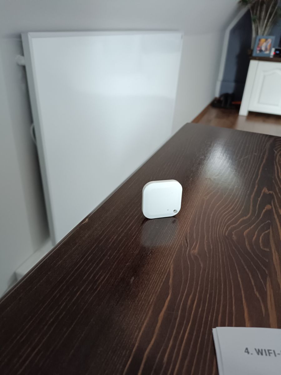

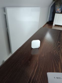

    I have three Heidenfeld radiant heaters controlled by the Tuya app.
    Each radiant heater comes with a thermosensor, according to me a radio connection. A very similar design of temperature and humidity sensors are on a popular shop with an annoying song. Connection type. Zigbee protocol, WiFi connection. I assume it is similar here.
    The problem is that in the app, each radiator shows a fixed 16°C, no matter how many degrees there are in the house.
    How to figure this out?
    In no way does the Tuya app see this sensor, I assume it should connect to the radiant. The radiator, on the other hand, transmits information via the app.
    Not having the sensor configured does not allow me to use the radiant properly, it is useless. Because it will play the desired temperature indefinitely, without being disconnected.
    The shop cannot help, they claim they will contact the Germans.
    It takes them a week.
    Please help, cheers Filip.
     Configuration of Heidenfeld thermosensors and radiant heaters with Tuya app, Zigbee/WiFi connection  Configuration of Heidenfeld thermosensors and radiant heaters with Tuya app, Zigbee/WiFi connection
    The instructions say nothing about the sensor configuration. Only that it is supposed to be at a radius of up to five metres, it is at a distance of one metre.

  • Sensor lacks pairing button and model marking
    #3 20229271
    cichockifilip
    Hello, Mr Zdzisław,
    Unfortunately, the sensor has no designation....
    The model of the radiant heater is HF-HP106-2.
    While the Tuya and derived apps add a radiant heater, the temp in each room shows rigidly 16°C.
    In my opinion, this sensor should automatically connect to the radiant, and then the radiant sends information to the app.
    The infrared heater is connected via the home WiFi network.
    According to the instructions, when pairing the infrared with the app, the sensor is supposed to be up to five metres from the infrared and that's it....
    Yesterday, I tried to add this sensor separately, category sensors and for every possible option. No effect. The sensor has no pairing button.
    There is also no marking, pathetic.... :( .
    Pairing-time hypothesis for sensor and panel
