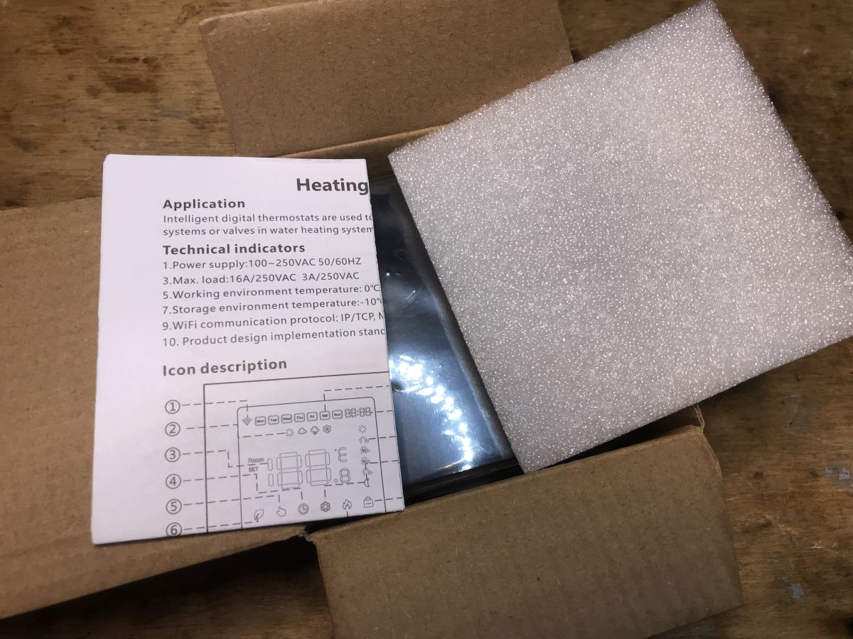

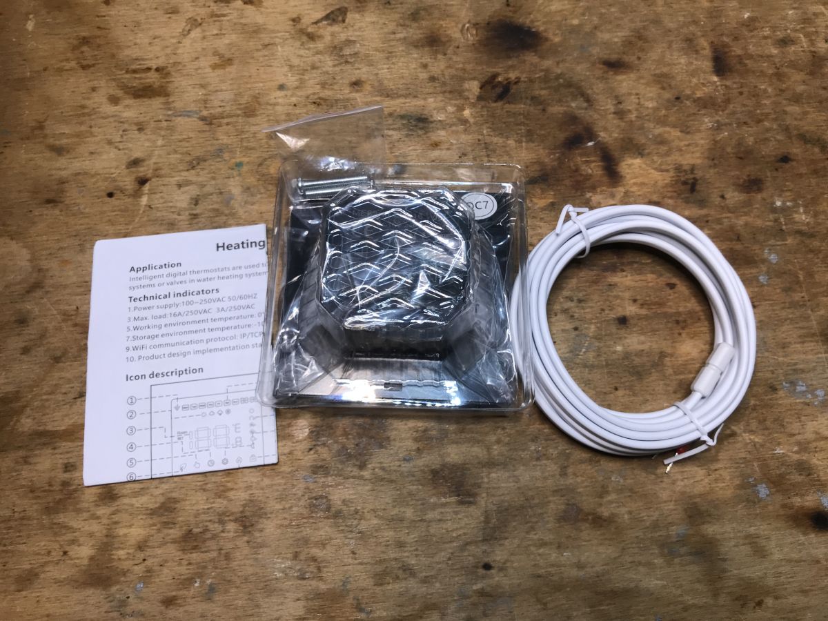

    We bought the thermostat for PLN140. Let's start with the contents of the kit.
    White cardboard box with barcode label and product information on top Side box label with manufacturer info and QR code on white packaging WiFi thermostat with English manual and protective foam in cardboard box .

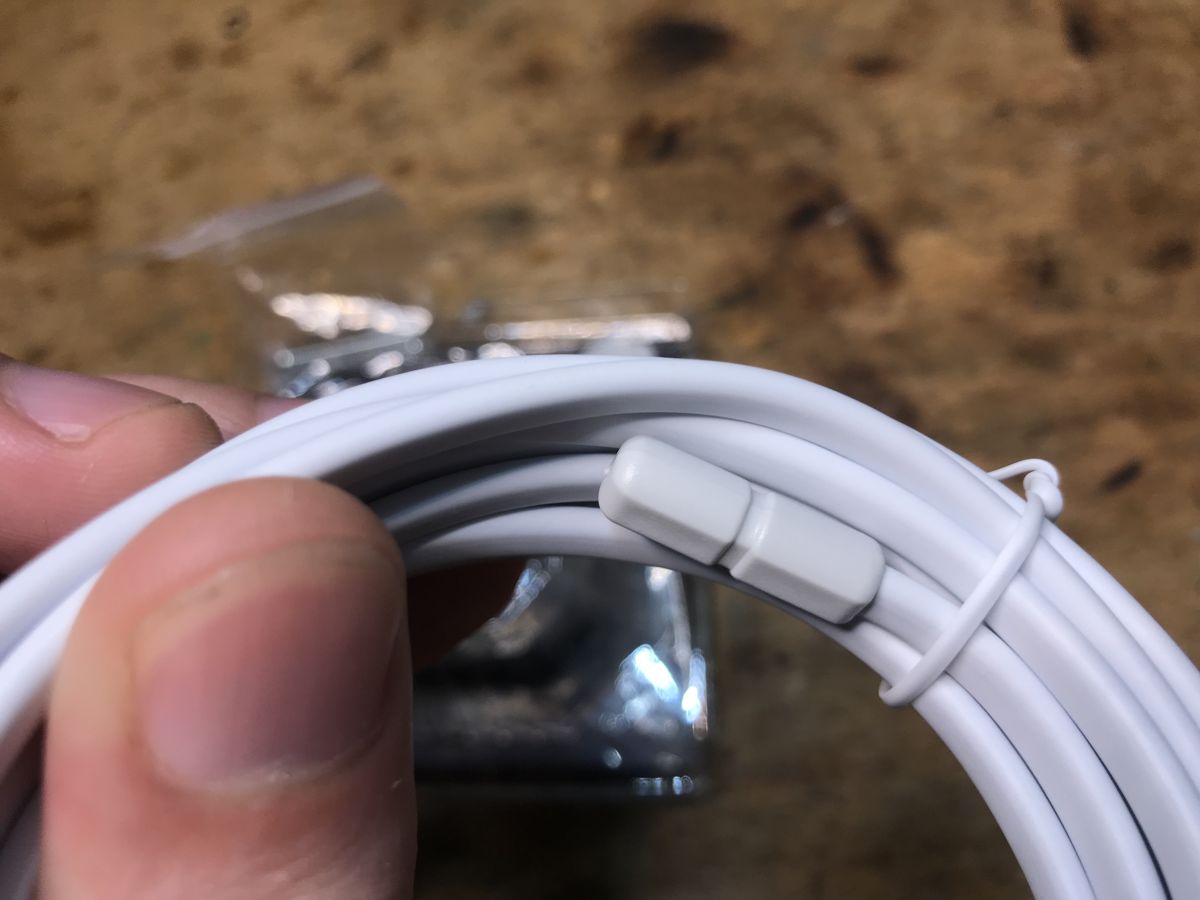

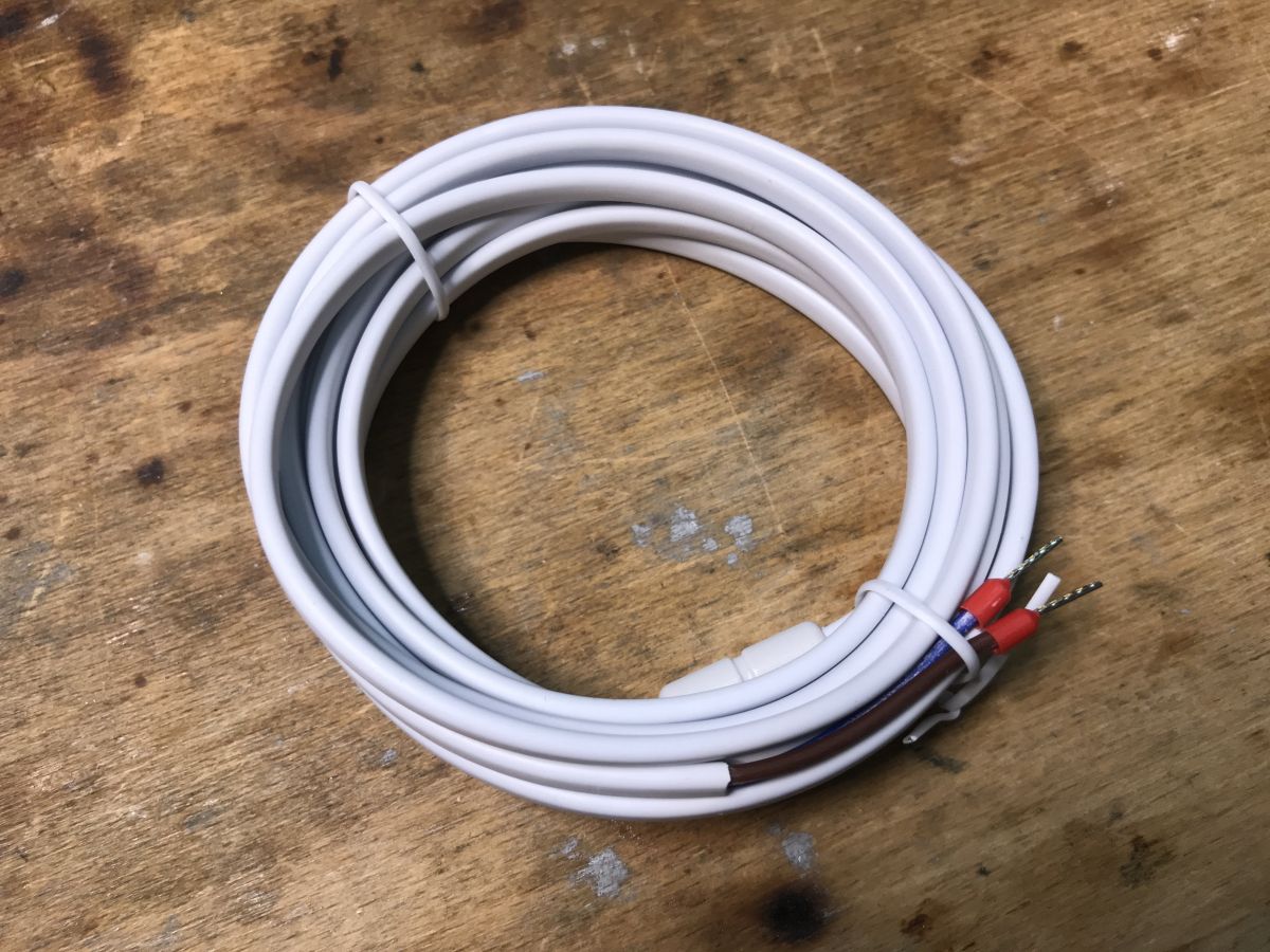

    The unit, probe and instructions are included.
    WiFi thermostat kit: instruction manual, wrapped device and white sensor cable. Coiled temperature sensor probe with stripped wire ends on wooden surface Close-up of a white temperature sensor attached to a coiled cable .
    Images of the English-language manual:
    Thermostat manual showing icon descriptions, default settings and operating modes Thermostat manual showing parameter settings table and wiring diagram .
    English thermostat manual with wiring diagrams, dimensions, and QR code for app pairing Thermostat instruction sheet with QR code and app interface screenshots .

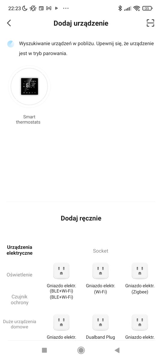

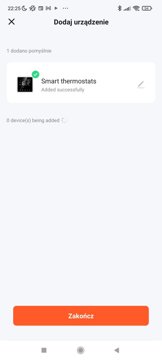

    Pairing goes without a hitch - the device is based on the BK7231, so it is already detected over Bluetooth:
    Pairing screen in app showing detected WiFi thermostat Smart thermostats App screen showing successfully added WiFi Smart thermostat .

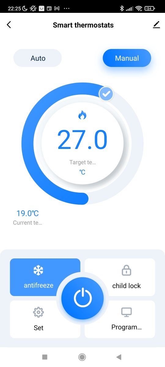

    The device panel is quite complex. We have here mainly two modes of operation:
    - automatic (according to a programme)
    - manual (we set the temperature ourselves at a given moment)
    We also have options such as child lock, which allows the touch panel of the appliance to be deactivated.
    Thermostat app screen: manual mode, 27°C target, antifreeze function active .
    There is also an antifreeze option, which automatically starts heating when the temperature is far too low.

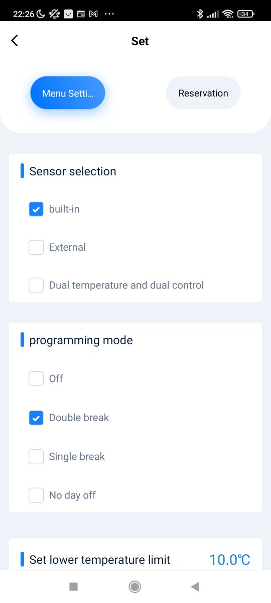

    Thermostat app screen showing sensor selection and programming mode options .
    In the settings there is a choice of programme and probe - it can be external or internal.

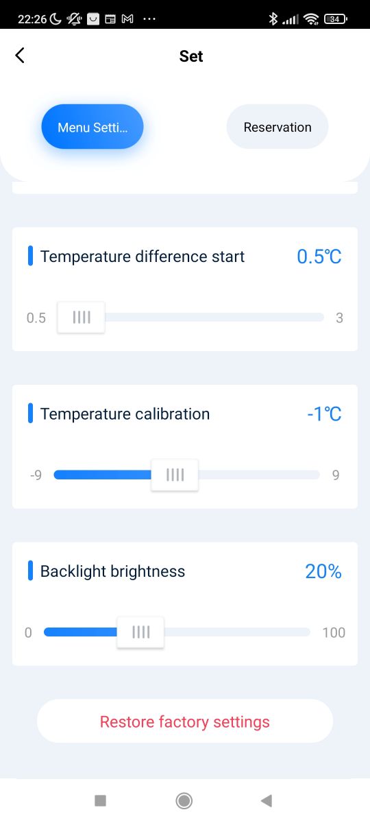

    Thermostat app screen showing calibration and backlight brightness settings .
    Probe calibration is also available and there is even an option to control the backlight level.

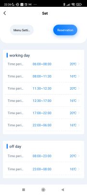

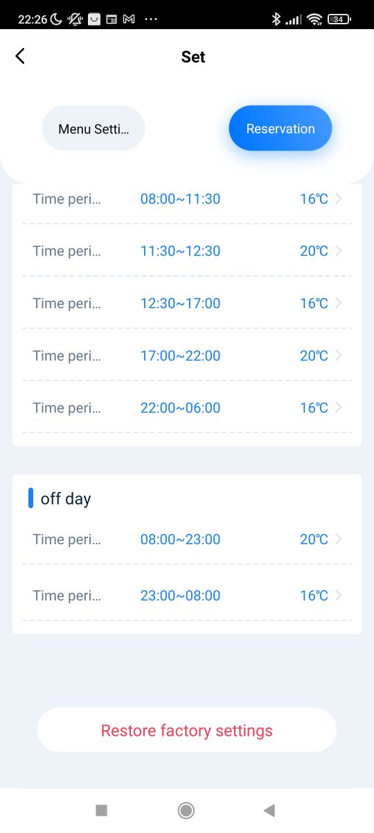

    Thermostat app screen showing time slots and set temperatures Thermostat app screen with heating schedule for workdays and off days .
    The creation of the programme itself is quite simple. We select the periods and temperatures.

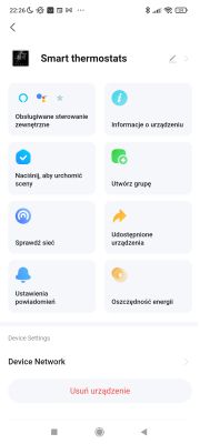

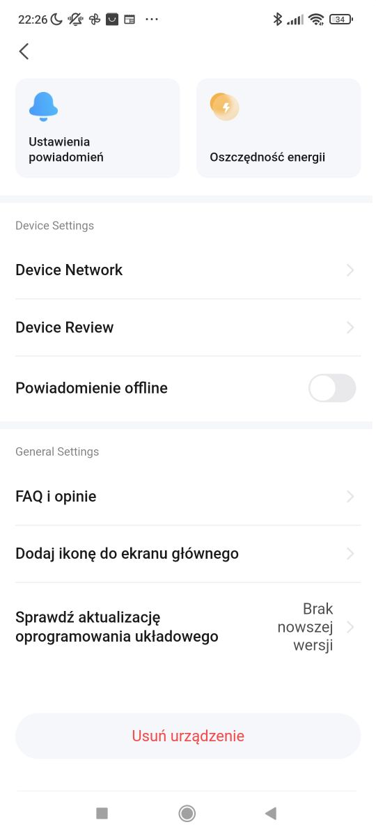

    Tuya app screen showing smart thermostat settings and control icons Mobile app settings screen for Wi-Fi thermostat with Polish and English options .
    The rest of the options do not stand out - as we usually have the option of sharing a device, for example.

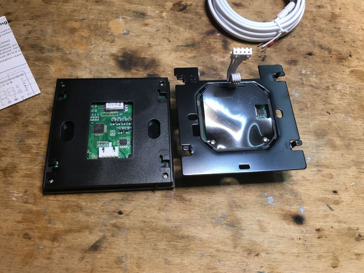

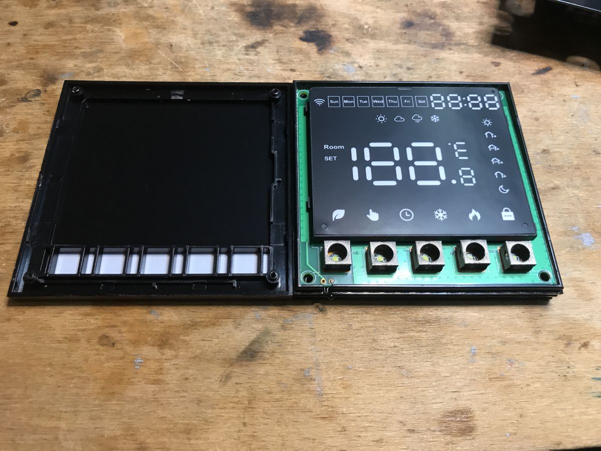

    Interior of the device .

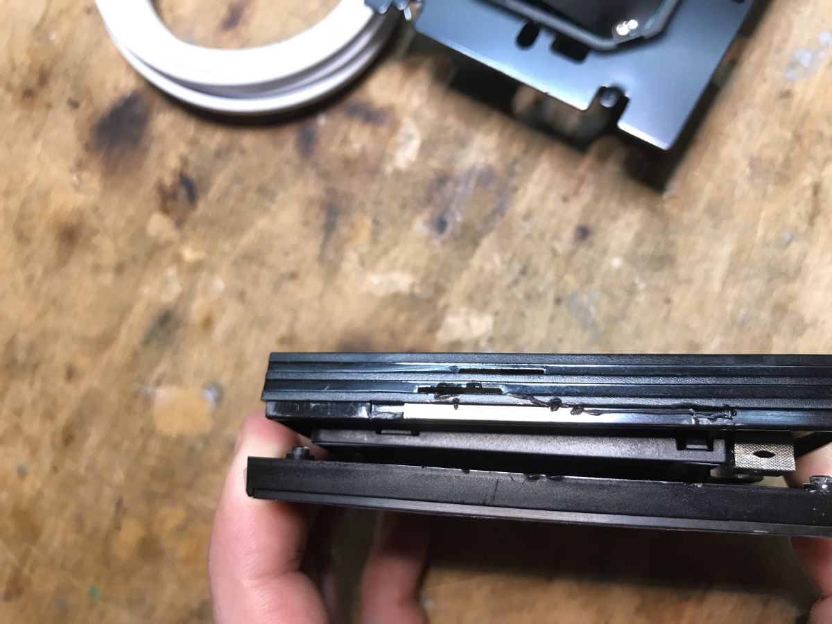

    The device is built like a typical WiFi controlled light switch. We remove the front panel.
    Disassembled WiFi thermostat with visible electronics and temperature probe. Close-up of thermostat PCB showing SC92F8547P and DS1302Z integrated circuits .
    You can already see some of the electronics, but here, however, there is an additional plastic component inside. More needs to be removed.
    Close-up side view of disassembled thermostat with visible casing layers Opened wall thermostat with visible LED panel and screw connectors .

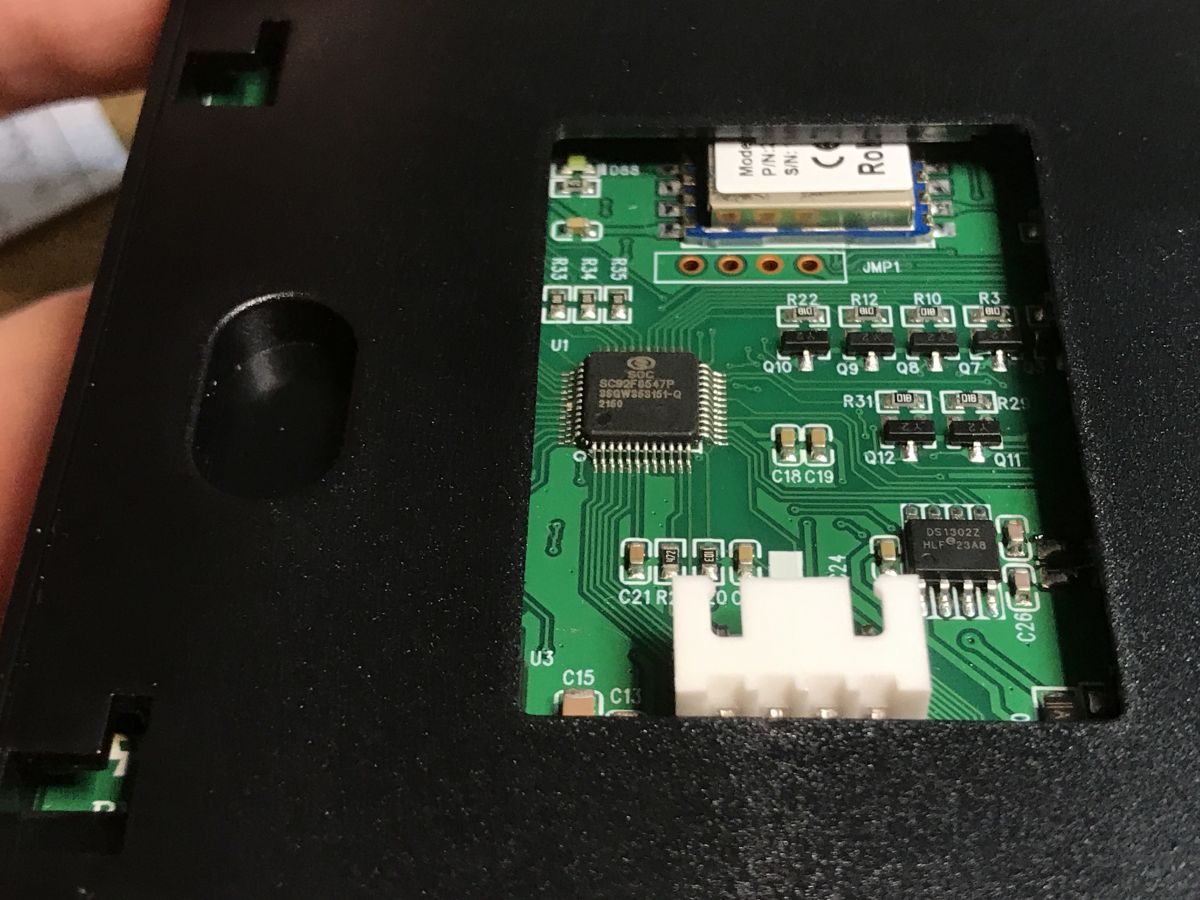

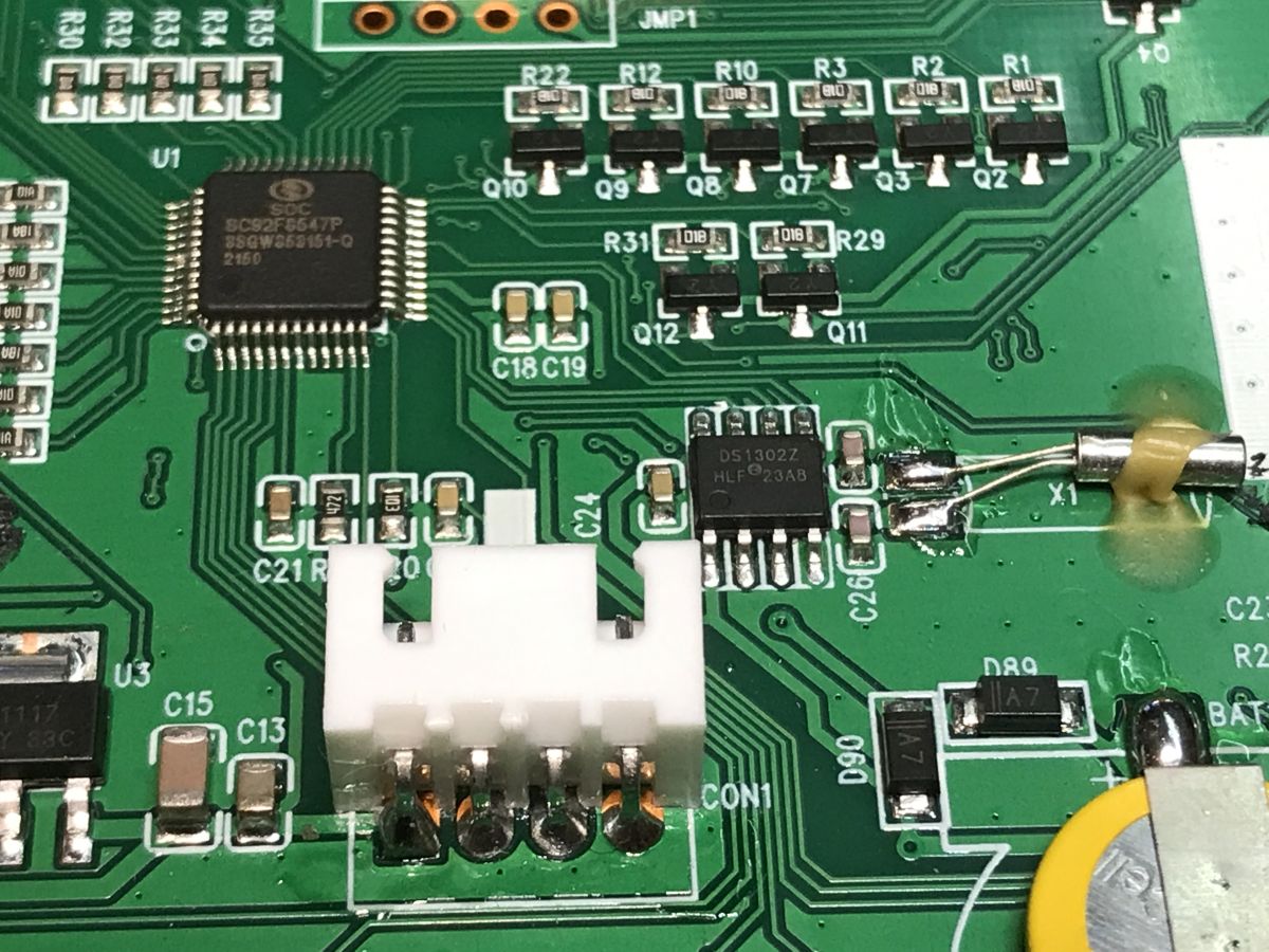

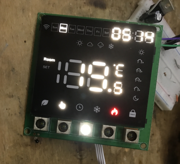

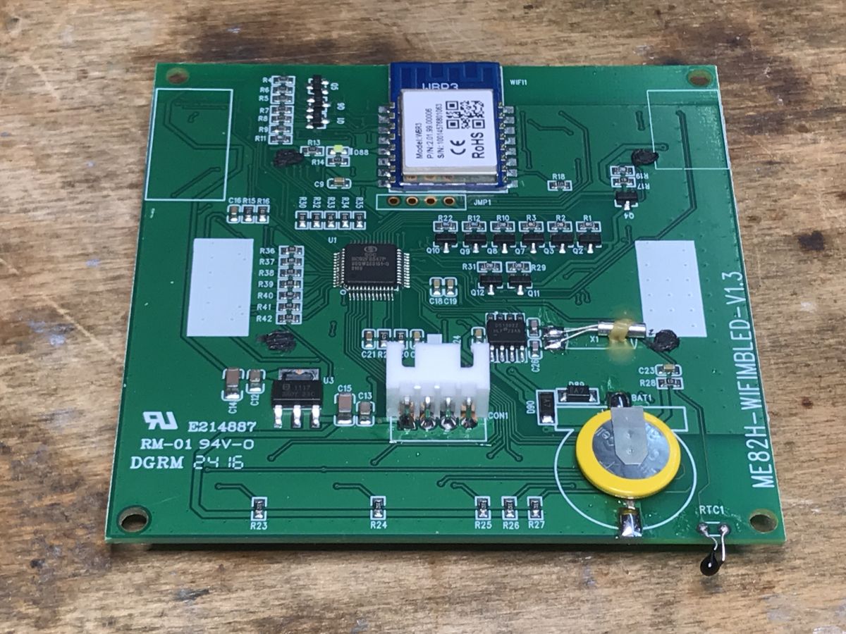

    It appears that there is no LCD here after all. The screen is based on LEDs. The seller has provided information that is not true.
    Thermostat PCB ME82H-WIFIMBLED-V1.3 with WiFi module and backup battery .

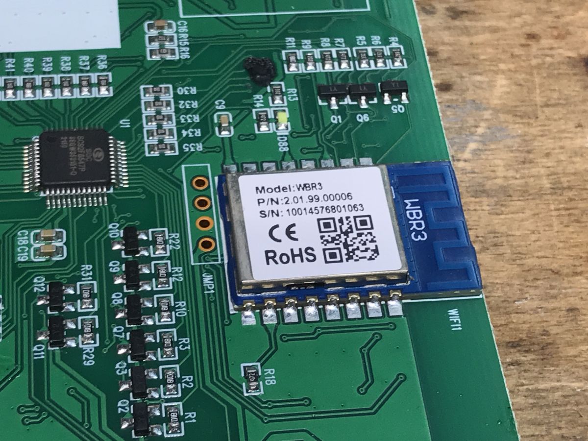

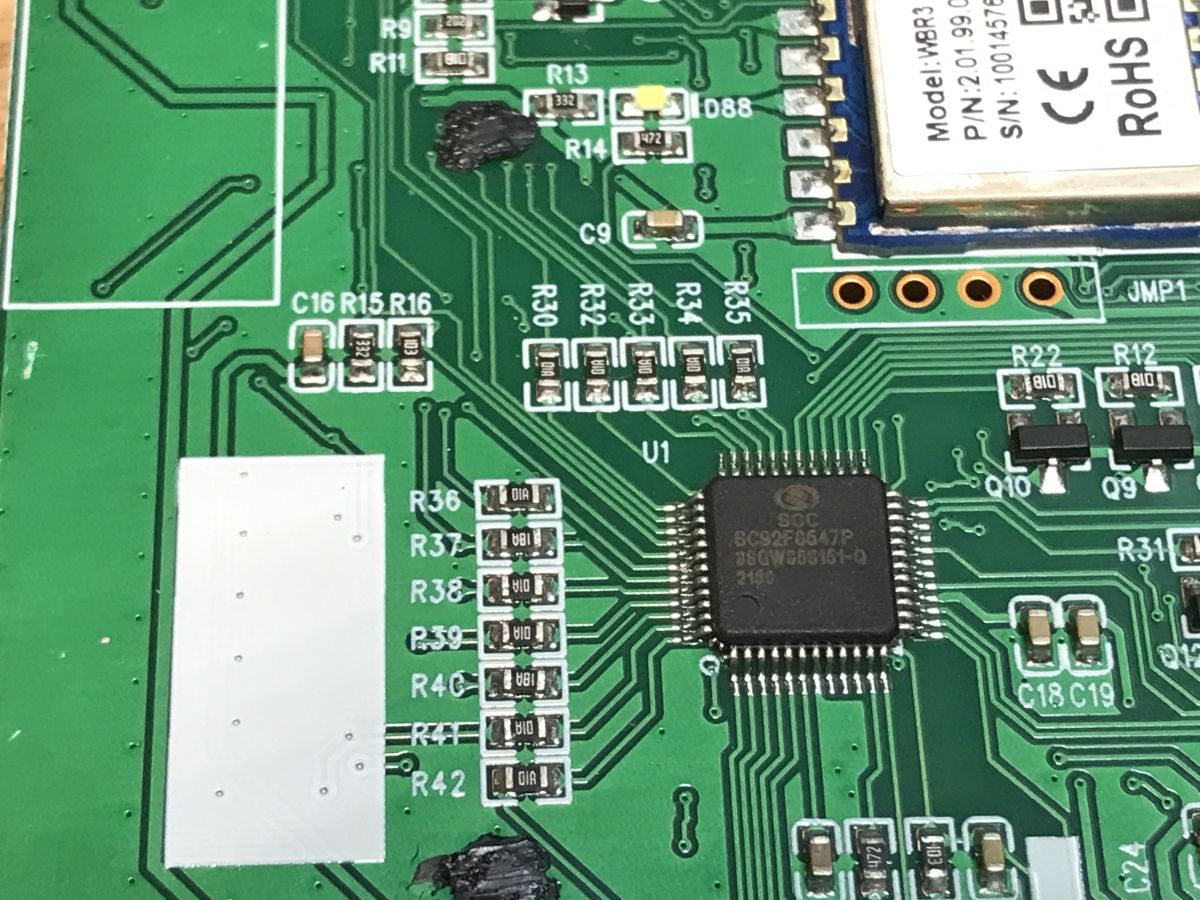

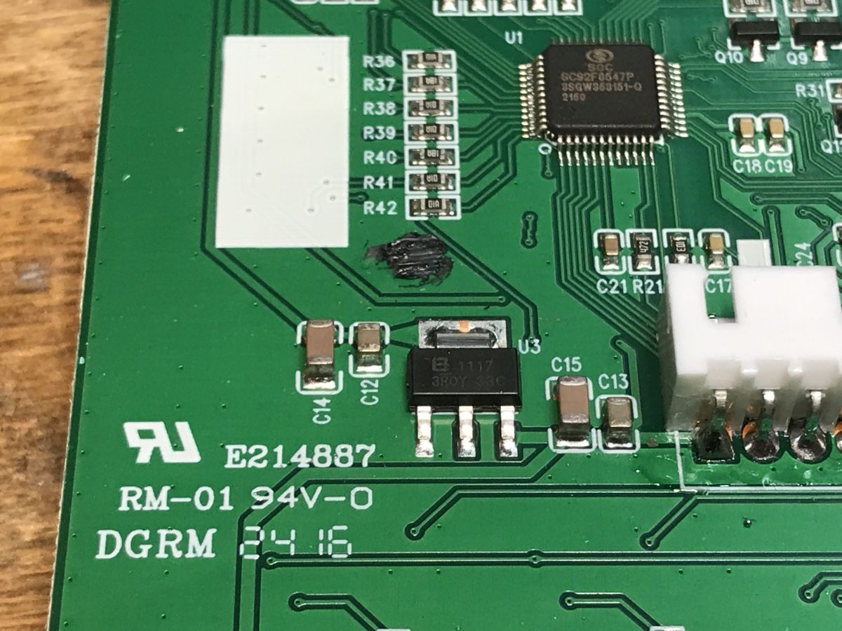

    The main PCB is marked ME82H-WIFIMBLED-V1.3 The device is based on the WiFi WBR3 module , a chip from Realtek. In addition to the WiFi module, we also have an additional microcontroller which takes care of all the logic of the device, and a timer chip real DS1302Z with a quartz clock resonator and power supply backup for times of power loss. This allows the device to resume programming even if it loses power completely and WiFi is not available to retrieve time from the Internet with the NTP service.
    WBR3 WiFi module mounted on green PCB with circuit traces and electronic components Close-up of PCB showing SC92F8547P and DS1302Z chips with connector Close-up of a PCB with SC92F8547P and AMS1117 components Close-up of a PCB with WBR3 WiFi module and SOC SC92F8547P microcontroller .
    The main MCU is the SOC SC92F8547P. It communicates with the WiFi module via the TuyaMCU protocol:
    TuyaMCU protocol - communication between microcontroller and WiFi module .
    This means that it will be useful to capture packets on the UART line right away. This will allow us to determine the dpIDs (identifiers) of the variables that determine the operation of the thermostat.

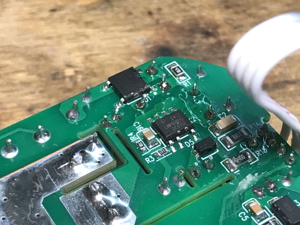

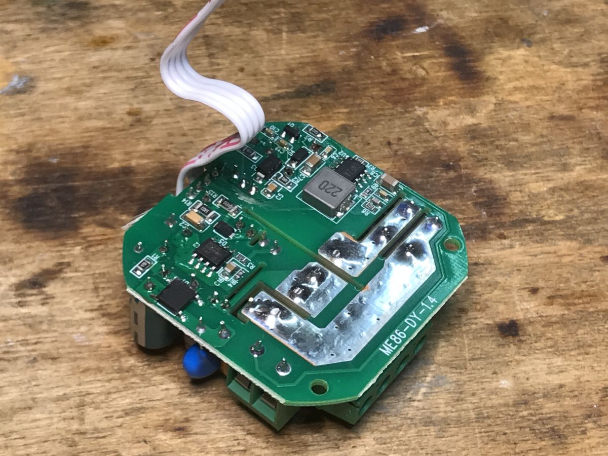

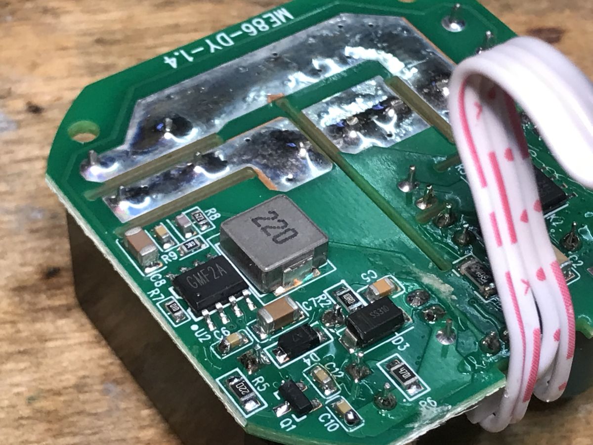

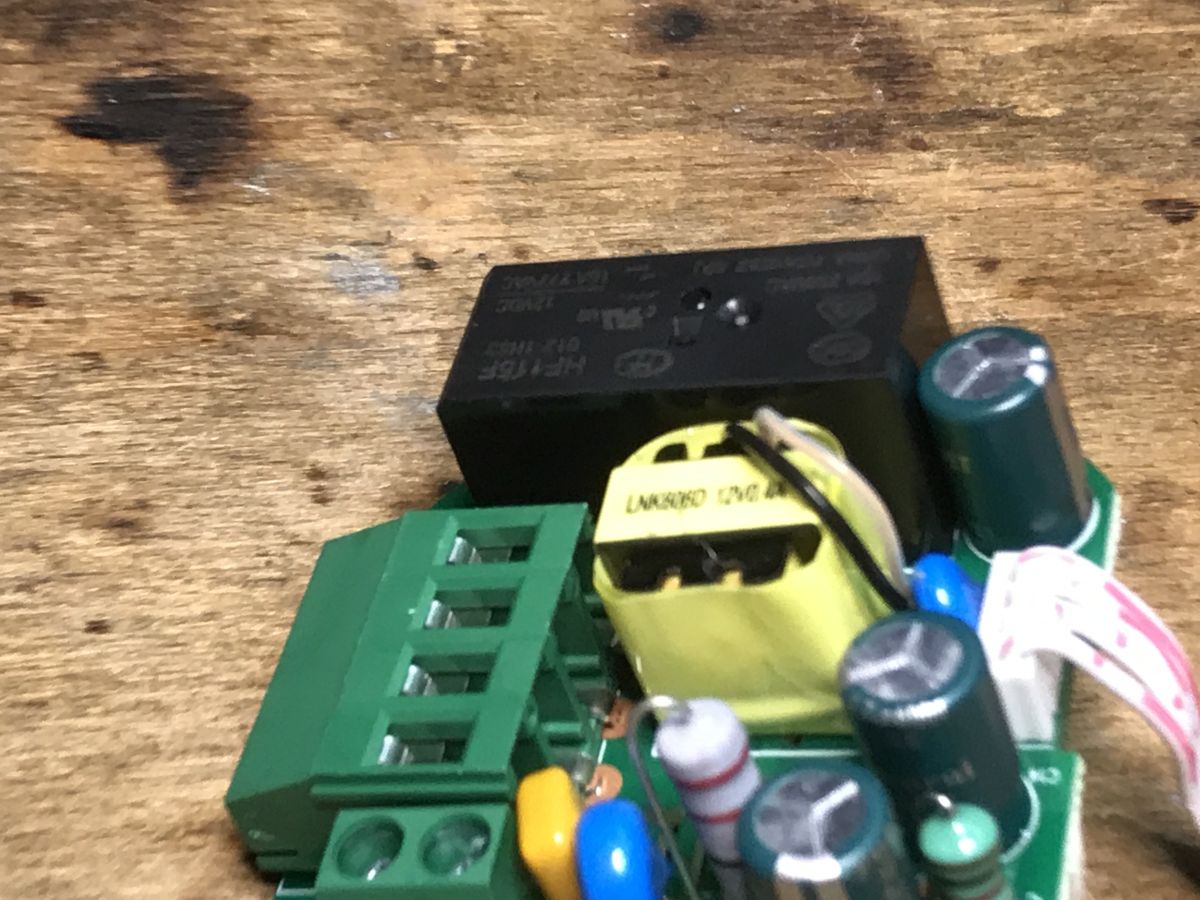

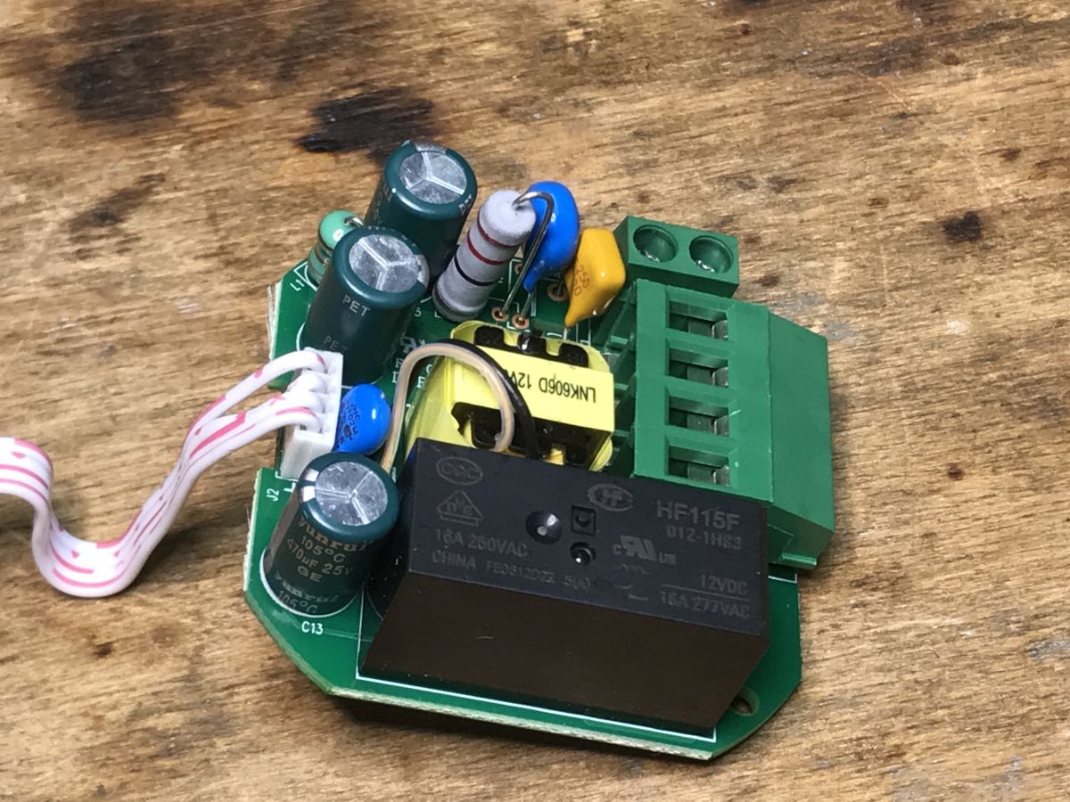

    What remains is the board with the power supply and relays - ME86-DY-1.4.
    ME86-DY-1.4 circuit board with electronic components on wooden surface Close-up of electronic components on a PCB with LNK606DG IC .

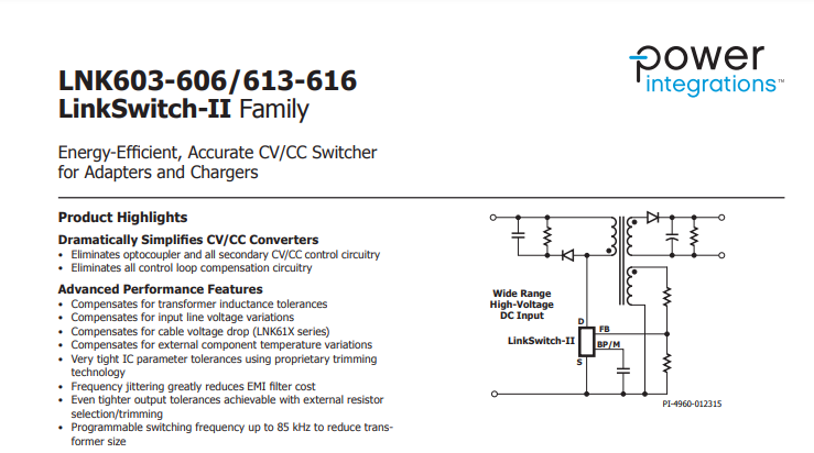

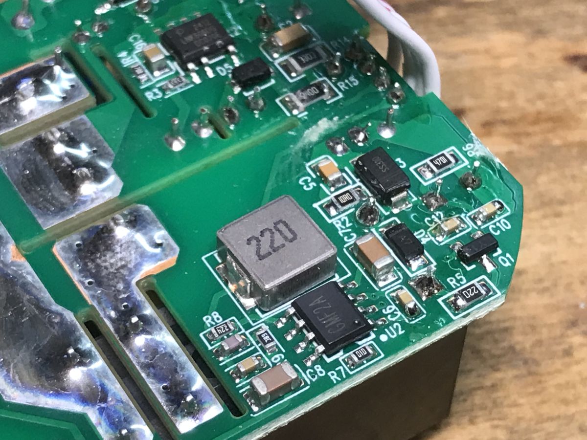

    The power supply in the device is implemented based on the LNK606DG.
    Excerpt of LNK603-616 datasheet with application schematic for power supply .
    The GMF2A is probably an inverter. Presumably the power supply gives 12V and something else has to generate 5V for the second board.
    Close-up of a PCB with a 220 inductor and GMF2A IC on a thermostat power module Close-up of the ME86-DY-1.4 PCB with GMF2A chip and 220 inductor visible .
    The presence of a large 12V relay (HF115F) confirms my suspicions. What we have here is a separate 12V power supply and separately some sort of step down converter. I don't think this 12V is going directly to the AMS1117-3.3V.
    Thermostat power board with HF115F relay and LNK606DG transformer Thermostat PCB with HF115F relay, transformer, and capacitors visible. Close-up of electronic components: capacitors, varistor, and green terminal block on PCB .

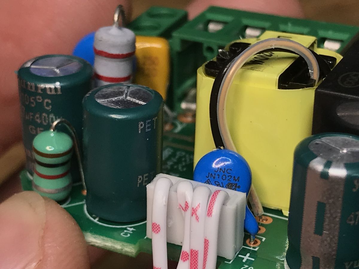

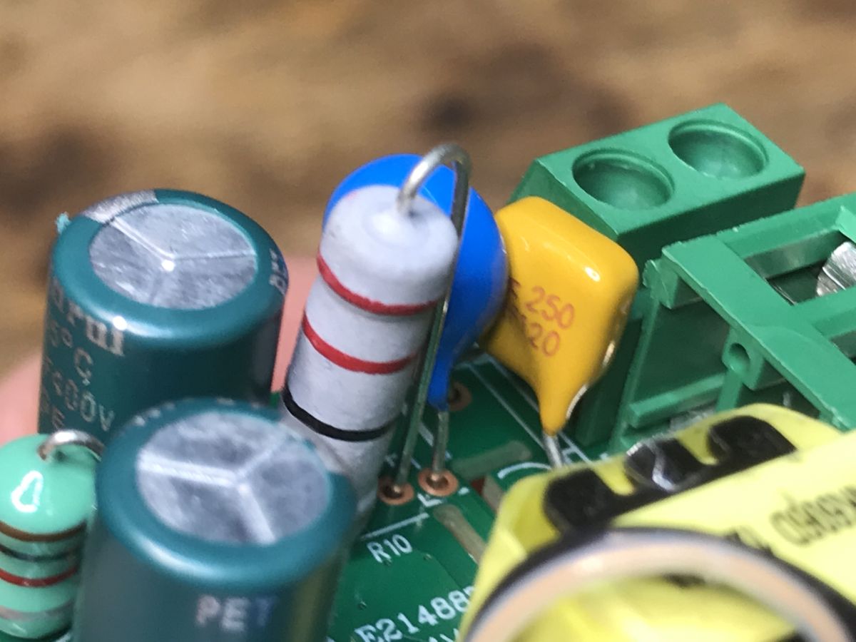

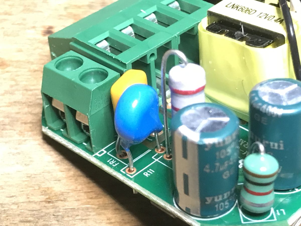

    The board is quite well built. A varistor is present at the input to protect against surges, and there is also an anti-interference capacitor.
    Close-up of varistor, capacitors, and resistors on the thermostat's PCB Close-up of electronics with capacitors, resistor, and transformer .
