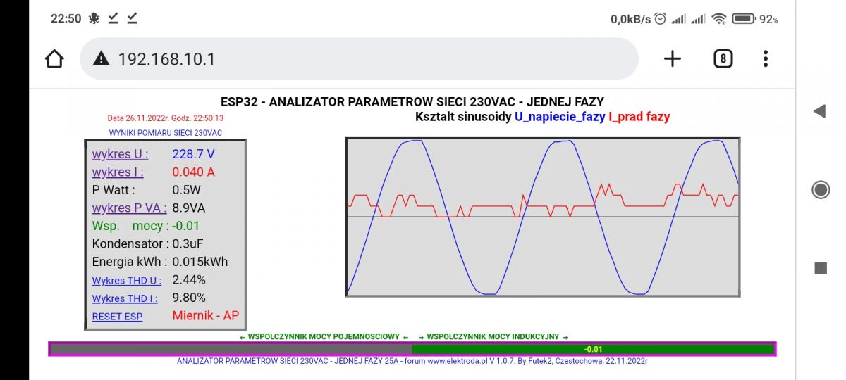

    This is what my analyzer looks like.
    Analyzer - meter of 230VAC network parameters - single phase. Analyzer - meter of 230VAC network parameters - single phase. Analyzer - meter of 230VAC network parameters - single phase.
    I noticed that every few minutes he likes to break the connection and reconnect.
    I already have a plan for the measurements but could you add a meter for the energy used?
    I want to use it in a place where there is no internet and the cell phone does not work there, so sending data to the server will fail.

    #68 20294486
    futek2
    Level 19  
    Posts: 524
    Rate: 230
    My first question, did you have problems calibrating the voltage and current range?
    And as for the energy, it is counted from the beginning of switching on, it is in the window on the left, the second position from the bottom.
    As for the loss of connection, maybe the signal from the router is weak.
    I think that there was no problem with the configuration either the first time you started it as an AP.
    Congratulations that you got everything assembled and started without any problems. It came out very nicely put together.
    Regards and enjoy using the meter

    There was no problem with the calibration.
    The results are slightly floating in relation to the meter and I do not know what is the reason for this, but it worked.
    I am not connecting through the router. Direct connection computer --> ESP.
    So this kWh indicator resets at the start and counts ascending?
  • ESP reset via web page resets kWh counter
    #70 20294657
    futek2
    Level 19  
    Posts: 524
    Rate: 230
    The kWh energy is accrued incrementally and starts after each ESP reset.
    ESP can be reset via the website
    /esp
    And I did it so that you can reset when the meter is in a hard-to-reach place but within WIFI range.
    This slight float may be due to the smoothing of the readings to get rid of the noise.
    But I chose the averaging by many tests
    trials.
    I think you already have the first conclusions after the measurements of your network and sinusoid distortions and harmonic content.

    #85 20304231
    Natanoj
    Posts: 12
    futek2 wrote:
    I am replying to the last 3 posts in turn.
    As for the sensors for measuring the current, they are available at a price of about PLN 27, they have become a bit more expensive. Because I checked and there is a lot in a different measurement range on a well-known auction site.
    Thank you. However, I meant the red and black gripper. Test probes that are attached to a circuit to measure voltage.
    Probably the most popular term used by sellers is the term measuring clip.
    I managed to buy a set of two UNI-T UT-C07 probes for just over PLN 50. This is a promotional price obtained through the use of coupons. I am satisfied with the quality, but if the analyzer performs well and I want to make more copies, a cheaper alternative would be welcome. So far, it was the most expensive element of the analyzer for me ;) . So please provide proven models of other companies.

    #87 20305111
    jarekgol
    Level 40  
    Posts: 5199
    Help: 646
    Rate: 1152
    I launched
    Analyzer - meter of 230VAC network parameters - single phase. Analyzer - meter of 230VAC network parameters - single phase. Analyzer - meter of 230VAC network parameters - single phase. Analyzer - meter of 230VAC network parameters - single phase. Analyzer - meter of 230VAC network parameters - single phase. Analyzer - meter of 230VAC network parameters - single phase. Analyzer - meter of 230VAC network parameters - single phase.
    @futek2 Nice thing, I calibrated with a fan heater, it took some 8.4A according to the Soviet lean meter. Graphs received by phone in ESP mode as AP. I still need to build it, which will probably take me a long time. When the input of the current transformer is shorted, you can see garbage on the current diagram, is it normal or is there some disturbed environment in my place? I tried to put a steel sheet (from Inpost's recommended ones) between the power supply and the processor, but it doesn't change anything. It seems to me that giving the current to 3 decimal places does not make sense. Personally, I'd be happy with one, but that's not important. When I build it, I will take it to the field, I have a plant where "capacitive power is given back" after hours, probably by computers and maybe overcompensated fluorescent lamps, I've always wanted to test it, but so far there was only a reactive power regulator with current measurement on one phase. Probably then he will be interested in collecting data for some server.
    Did you choose the 1000uF and 470uF capacitors specifically?
    However, I have a software order to put a link to the home page on each screen, because it seems to be possible to get anywhere from there and it's good to be able to go back.
    By the way, I connected a voltage transformer to 12VAC and an oscilloscope and I don't really understand why my phase is reversed. Apparently, according to the documentation, the dots are in a line and so I have a common ground, and the phase is vice versa. How is it with this? The resistor in the power supply is 10k at the 470? output. From cursory calculations, it was over 1.2mA at the power supply and below 1.2mA at the output, but the difference is close to hundreds. And my oscilloscope is not a very accurate measuring device.
    If anyone wants such a power supply, it is at the Baker, number 39550 for PLN 10 net. It looks decent, has a fuse resistor, choke on the input and output. Stabilization without an optocoupler, but loaded with a small car bulb gives advice. And there is still a 2-core microusb cable after it.
    • TV16-2mA-2mA.pdf (3.76 MB) You must be logged in to download this attachment.
  • Small capacitors and larger capacitance recommended
    #88 20305427
    futek2
    Level 19  
    Posts: 524
    Rate: 230
    Congratulations col jarekgol that everything is ok. !!!
    Another example that the meter is ok for such a small amount of money,
    This garbage is from ESP32 I struggled with it a bit but I gave it a rest as we are interested in larger currents when measuring network parameters, especially the power factor, which can be seen very nicely on the shift of sinusoids.
    As for the capacitors, I took as small a size as possible and a large capacitance.
    because they must win the voltage well so that they do not impose on the shape of the sinusoid of current and voltage.
    From what I see that you have a loosely assembled system for now, you can try to add 1000uF to it one more and be proud of the result, but I don't think it will change much.
    In the coming days, there will be another version of the software with corrections that colleagues have reported.
    I will also make a small correction with sending the results to the server, it is also a catchable error by my colleagues.
    And how did you upload the software to ESP32 using one of the programs I described recently?
    But overall the project works, and quite correctly.
    Once again col. jarekgol my words of appreciation that you built it and there was no problem with starting.
    Regards
    Futek2

    #89 20305646
    jarekgol
    Level 40  
    Posts: 5199
    Help: 646
    Rate: 1152
    I wonder if you would have a lot of work with making a typed configuration for different transformers (e.g. 5/25/100). I've seen these transformers in the 5A/1V version and they would be nice for viewing home appliances, and they sell this with a jack plug so they are easily interchangeable. I have planned a socket.
    If you want to fight, you can make a workaround that below some threshold of the measured current, it does not display the graph and does not take measurements ;) the threshold could also be in the config as a numerical field / tick.
    I really like the solution with measuring artificial mass :) Thanks to this, it does not have to be so stable.
    I uploaded as described, first blink with Aurduino via Platformio, then your binary to the address 0x10000 with the command I use Linux on a daily basis and avoid Windows if I don't have to ;)
