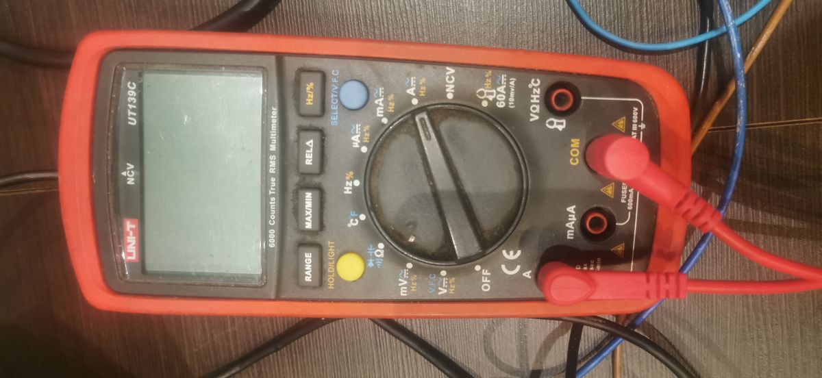

    I built it too.
    I spent a week collecting the necessary parts. I had a current transformer from another unfinished project, but it was 100A 50mA, without a built-in resistor, you had to add a 20 ohm resistor in parallel to make it work.
    The voltage transformer is tv16E, supposedly more accurate, there was no delivery of the blue one in a reasonable time on the Polish auction site. :)
    5V 2A power supply pulled from some plug-in power supply.
    housing will be.
    The ESP32 board is the same as recommended by the author. I uploaded the batch with the ESP-Flasher-x86.exe program, which weighs 12M. It worked right away, I mean ESP without measuring.
    After soldering on the universal plate (I will not boast about its bottom part :) ), the measurement was strange, the sine wave of the voltage was only in the negative part, and there was no current measurement at all. MY MISTAKE was not connecting the ESP ground leg with the rest of the system. After connecting and calibrating everything started.
    I made the calibration on the dryer and the boiler, using the meter from the photo. :(
    I also managed to connect to my home router, not right away, I didn't read that you have to enter the server address to send these three characters, then it saves.
    You have to hurry a bit when logging in admin admin, because the page reloads.
    The last photo shows the work of the laptop with the game AOE4 in the background. There are plans to connect the whole apartment (1 phase, pre-meter B40, accumulation stoves, boiler, induction hob).

    #110 20318340
    futek2
    Level 19  
    Posts: 524
    Rate: 230
    Col jarekgol
    Are you sure you connected the meters correctly? Because according to the diagram you showed, it is wrong because the current and voltage sensors are always to be on the power side before the load.
    Maybe change the direction of the current sensor fastening because it may also overlap.
    I think you have a manual for the meter, this is a connection diagram and I suggest you check it because the differences are very large. I did the trials and the differences are almost none.
    Regards
    Futek2

    #111 20318885
    jarekgol
    Level 40  
    Posts: 5199
    Help: 646
    Rate: 1152
    If I change the direction of your transformer, it shows that it does not like the direction of energy flow, and in socomec, if it is the other way around, the power of the bulbs shows negative. That's not it either.
    I've looked through the thread now and there are actually no screenshots of measuring simple elements anywhere. As someone has already thrown something, these are elements with complex consumption (the engine always takes a little bit of this, a little bit of that) so it's hard to say how good the measurement is and whether the error does not grow close to zero.
    @futek you wrote that you made 45uF, connect such a capacitor to your meter and post it here when it comes out, and I did the 5A version. For light bulbs, it shows reasonably, so there should be no hidden or undercalibrated shifts.

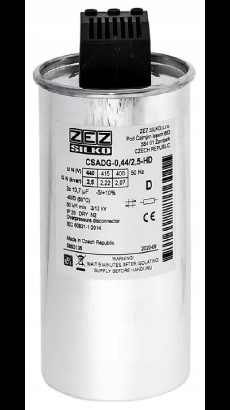

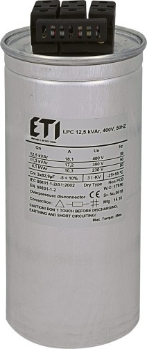

    #116 20878394
    futek2
    Level 19  
    Posts: 524
    Rate: 230
    Hello those interested in the topic.
    After many received proposals for changes and my own thoughts on improvements, I post the latest version of the soft to the analyzer - meter parameters of 230VAC network - one phase.
    Changes and improvements are:
    1 - calculation of power and capacitance of the condenser to compensate for reactive inductive power.
    2 - graph and flicker light factor for the last 15 minutes
    3 - graph of COS fi changes for the last 15 minutes .
    4 - other minor changes .
    Updates can be made via the Web page of the meter as previously described then retains the configuration or by uploading directly via USB to the ESP32 module using one of the programs in this post.
    https://www.elektroda.pl/rtvforum/topic3929533-90.html#20435759
    With regard to the fact that this is a BETA version, please ask for any comments.
    Attached is the latest software as a BIN file - meter on the range of 25A
    All other functions remain unchanged.
    We wish you satisfaction and use the meter with the new software.
    Added after 2 hours:
    Thanks for the first information about the error already made a fix and the soft posted the current corrected
    It is also corrected conversion of capacitor capacitance to power in kVar for the current measured network voltage by the anilizer.
    This is a remark that you should not be guided mainly by the capacitor capacitance from the label because it is different for different values of voltage and manufacturers give this value usually for 400VAC and capacitance multiplied times 3 if it is a three-phase capacitor and power in kVar as a calculation of the sum of three capacitances of a capacitor for a given voltage at which it should work.
    The meter calculates on the fly during the measurement.
    Example capacitor label attached.
    Greetings
    Futek2.
