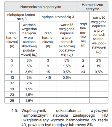

    Hi,
    I have a question regarding the Analyser,
    is this device suitable for checking whether the household meets the conditions included in the agreement with TAURON?
    (here is a fragment of it - tariff G11)
    Table with harmonic values in tariff G11 for odd and even power currents.
