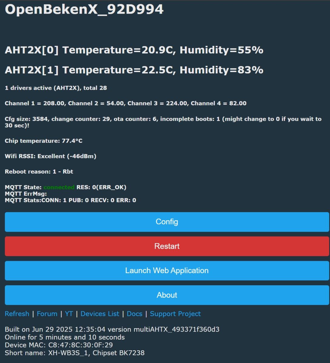

    Is it possible to have two AHT2x compatible sensors on one XH-WB3S, Chipset BK7238 ?
    The AHT30 breakout boards I am using have no obvious way to change the I2C address.
    Intended measurement before and after a cooler.
    This did not work as I hoped:
    backlog startdriver AHT2x 7 8 1 2; startdriver AHT2x 23 28 3 4;

    After fighting with my own errors, I think I finally made a working version.
    Thanks for your feedback to find them!
    Here's a version for your BK7238, will make a PR in some minutes, just need to cleanup all the debug output ...
    For your sensors on pins 7/8 and 23/28 please use:
    backlog startdriver AHT2x 7 8 1 2; AHT2X_Addsensor 23 28 3 4;
    • OpenBK7231T_App_multiAHTX_493371f360d3_OpenBK7238.zip (1.64 MB) You must be logged in to download this attachment.
  • #5 21592948
    taggbricka
    Posts: 48
    This is working correctly on my device!
    Thank you!

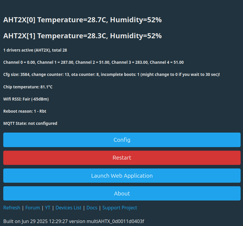

    Opened PR #1696 for this.
    I think I found a BMP280+AHT20 board and an AHT10. Let me solder them, so I can provide a screenshot...
    Usage is extended by a command
    AHT2X_Addsensor <CLK Pin> <DATA Pin> [Channel temperature] [Channel humidity]
    All other commands have been extended to add an optional <Sensor number> as last argument to address it, as shown in code.
    "Calibrate" will work on sensor 0 if only 1 or 2 arguments are given.
    In order to change a sensor != 0, you must give temp-dalta AND humidity-delta AND sensor-number
    Or has someone a better idea?
    All other commands will default to all sensors.

    Added after 58 [minutes]:
    I really had two AHTx based sensors around - sorry I didn't find them before, so @taggbricka had to do all the tests.
    So it's working for me, too:
    Connecting Two AHT2x Sensors to XH-WB3S (BK7238) with Multiple I2C Addresses
    Spoiler:
    Info:SENSOR:AHT2X_Measure: Measuring sensor clk=7 data=8) .
    Info:SENSOR:AHT2X_Measure: Sensor[0] Temperature:28.723907C Humidity:51.635075%
    Info:SENSOR:AHT2X_Measure: Measuring sensor clk=15 data=17) .
    Info:SENSOR:AHT2X_Measure: Sensor[1] Temperature:28.340149C Humidity:52.094936%
