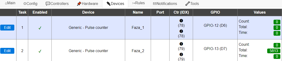

    I am doing a Virone EM-2 electricity meter reading on two phases.
    I have done the reading in 2 ways and with two circuits.
    1. connecting an OC pulse output to GPIO 1 phase D6, 2 phase D7
    a) using an external PULL-UP
    b) using an internal PULL-UP
    2 I used 2 circuits with a photoresistor together with a module that generates the signal passed to the ESPEasy.
    The signal from the LED in the counter generates a pulse at the output of the module and this, as I wrote, is passed to ESPEasy - GPIO D6 and D7.
    I modelled it on
    https://flytomcio.pl/raspberry-pi/pomiar-zuzycia-energii-elektrycznej-z-wykorzystaniem-diody-w-liczniku/
    https://forum.arturhome.pl/t/licznik-impulsow-z-licznika-energii/1730/8
    In both cases I programmed the WEMOS D1 mini and the NODEMCU with ESP_Easy_mega_20220809_normal_ESP8266_4M1M
    I also uploaded older versions.
    Problem .
    After some time, despite pulses appearing on D6 or D7, ESPEasy does not count them.
    The image below shows the reading from midnight today to now 22:30.
    You can see that phase 1 has zero pulses read and phase 2 has 5813 pulses counted and is still counting.
    If I go into the Devices->Edit setting and give Submit then the reading starts again but after a while it stops counting again.
    Previously similar situation was on D5 so I moved to D6 and still the same.
    What could be the problem as the pulses are generated.
    I have deactivated chip sleep.
