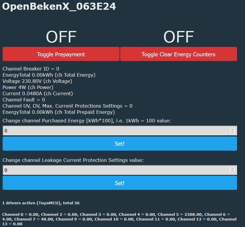

    Hi
    I´m very interested in using the Zemismart SPM01(https://www.zemismart.com/products/spm01-d2tw-zm) in the Wifi Version and therfore purchased one and found inside according webinfo a Tuya CB2S Chip.
    To get some information and closer to my personal wish of final result I also suddenly replaced the CB2S with ESP02S and analyzed the Data which are send from an Tuya MCU inside the smart meter.
    Now I`m struggeling because this data does not make really sence for me and in addition is only send by request (sendtuya0). Normally I would expect automatic provision of this data.
    At the moment I´m receiving 9 data points but only 3 contain data other than zero.
    Based on Tuya function I would expect voltage, power and current but only 1 of these three datapoints is changing. Tried to modify the load eg. 100W or 0W but also then only dpIx 6 is changing it´s value.

    My question now is, is it possible to gain additional knowledge from the desoldered CB2S with your tools? Connecting this CB2S by USB-TTL converter to read it out. Is this sth you would recommend?
    Second question in case it´s better to back one step and resolder the CB2S according your guideline https://www.elektroda.com/rtvforum/topic3970199.html it says 2 steps. First step without 5V connected without Wifi but in case of CB2S there ist no 5V only 3,3V at the Chip. So how to do these 2 seperate steps ?
    Screenshot of TuyaMCU Explorer/Analyzer showing packet data in hexadecimal format.
    Thanks?

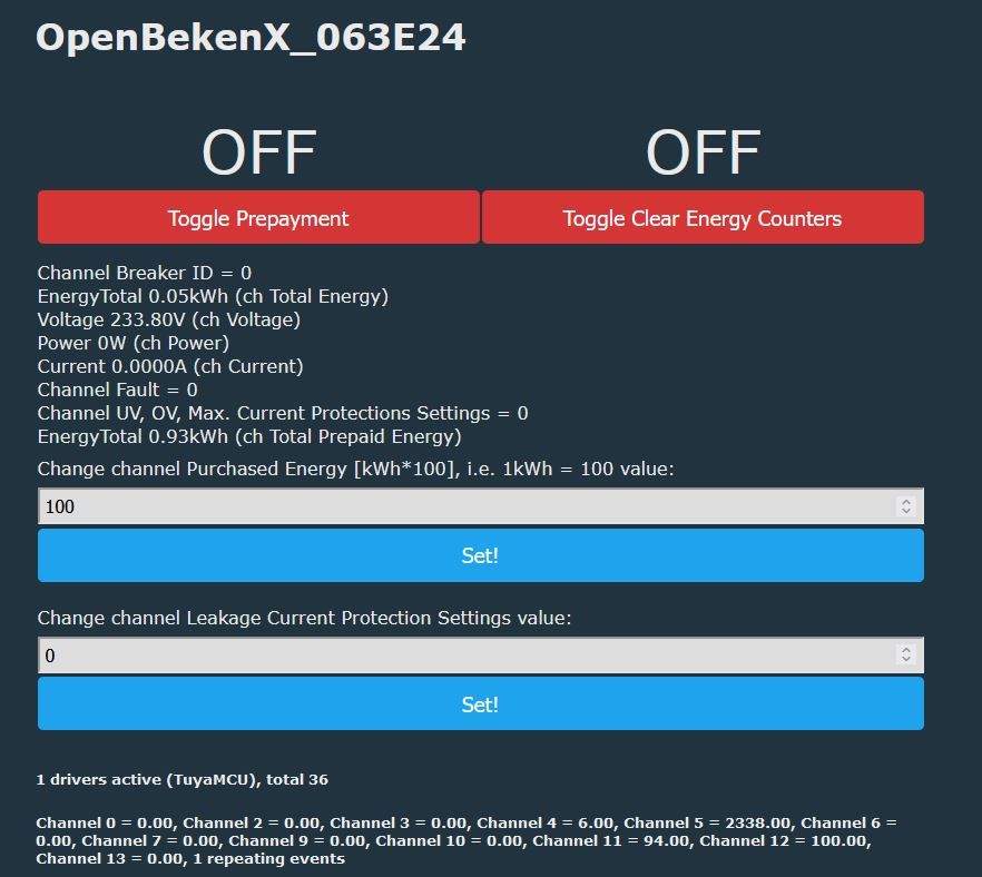

    This happens sometimes with OBK as well, it may be by TuyaMCU design. In OBK we solve it with:
    // every 10 seconds, request update from TuyaMCU
    addRepeatingEvent 10 -1 tuyaMcu_sendQueryState
    See more: https://www.elektroda.com/rtvforum/find.php?q=tuyaMcu_sendQueryState
    I don't remember Tasmota details, but for best result I recommed simulating 0x04 wifi state for the MCU. In OBK we do:
    tuyaMcu_defWiFiState 4
    Some of devices do not publish their states fully unless they think they are connected to the cloud. Some other devices even may beep or blink when not paired.

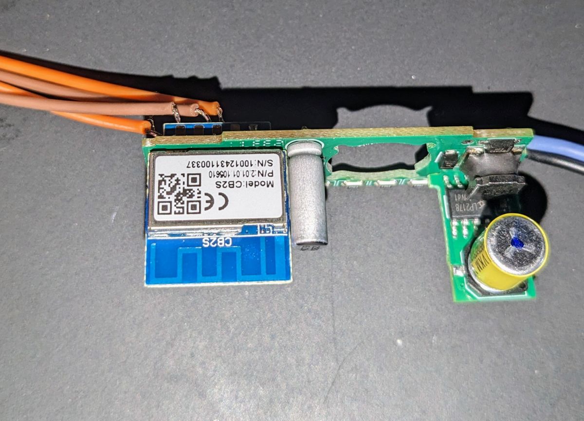

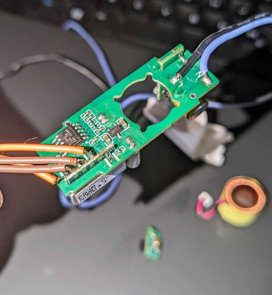

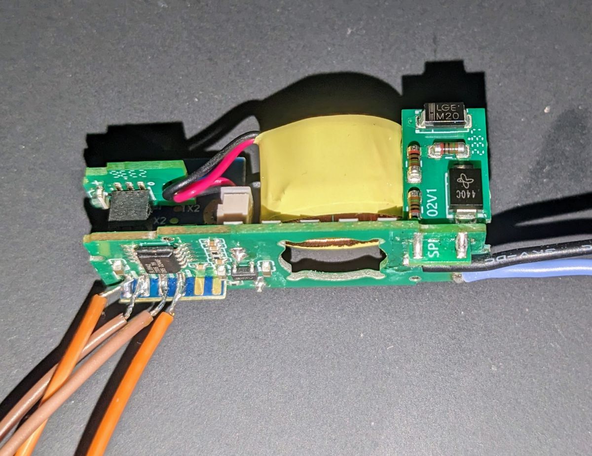

    So let's reply to a simple one and please have a look at the photos and don't be worried. I'll never connect mains while doing these kinds of stuff!
    2 photos I dismounted the coil and the board with the push button to have a better view.
    View of a disassembled circuit board with electronic components. Dismantled circuit board with electronic components and a module labeled Model: CBZS. The image shows a disassembled electronic component with a coil and button board on a gray background.

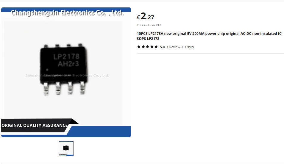

    I've looked at your photos and I can see LP2178 chip, which is most likely an non-isolated step down converter for mains voltage to 5V DC conversion:
    Image of LP2178 chip on product page.
    We still need to figure out where 5V is converted to 3.3V on your board.

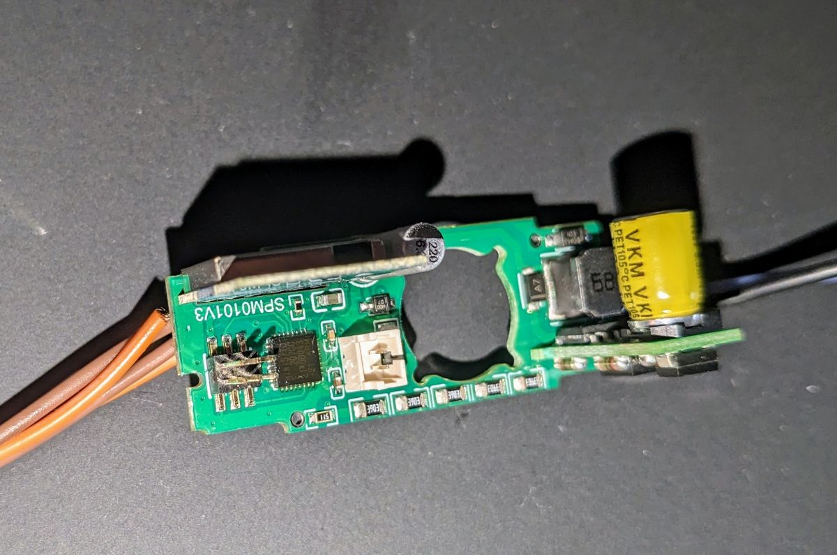

    Guess this MicrOne LDO SBWF is what we are looking for
    Printed circuit board with electronic components and soldered wires.
    In this SOT23-3 Version it should be
    Pin1: Vout = 3,3V
    Pin2: Vss = GND
    Pin3: Vin= 5V
    Pinout diagram of a SOT23-3 integrated circuit.

    Really? I would not expect that. Please at least verify with the multimether whether the pins are indeed connected to ground, 5V input and the 3.3V pad of WiFi module.
  • #7 21072614
    Pete0815
    Posts: 34
    Checked and confirmed connection to 3.3V and GND Pin of the CB2S module
    Why are you surprised? I had similar LDO at my ESP32-S2 Mini Modules from MicrOne.

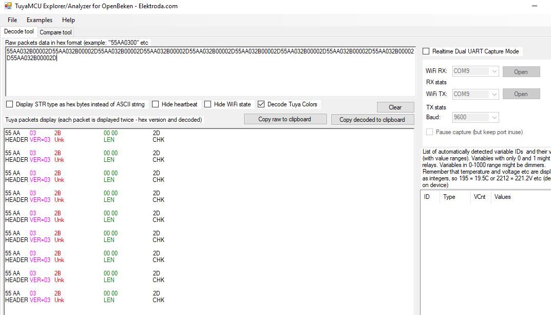

    Thx. Mmmh seems not to be at the moment. Cannot see the device in the Tuya App and also my Wifi access point does not recognize it.
    capturing while connecting 5V gives endless loop of
    55AA032B00002D
    Same as shown above.
    Maybe the USB TTL has not enough power to power the whole device.

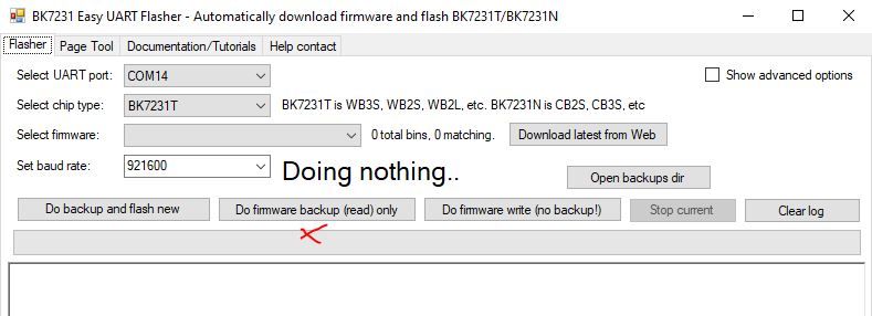

    Because at the moment I´m not getting any further and also waiting for a new USB TTL converter with AMS1117 which should have enough power.
    Can you say what sw tool to use for this 2MB backup? Is it the OpenBK flash tool? aand I can make use of this function?
    Screenshot of the BK7231 Easy UART Flasher tool

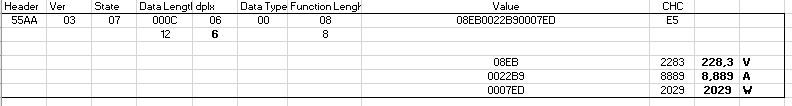

    And for the Tasmota testing and with some help via manual request command ("tuyasend0") one datapoint (dpIx 6) received in raw format could be identified:
    BIN data table with headers and values, showing details like Header, State, dpIx, and values related to voltage, current, and active power.
    so it contains voltage, current and active power

    And my OpenBeken Webpage looks like this:
    Screenshot of the OpenBekenX interface with energy management settings.
    What I´m not able to configure is because of missing examples: dpIx 2
    DP 2, VALUE(ro), cur_neutral
    dpIx 6 is working but next step I´m struggeling is the energy count (Dpid 1). Nothing seen beside 0kWh so far.
    @divadiow mentioned an app functionality for eg dpIx 1 which is this energy counter and I have configured in the autoexec.bat:
    // Total energy - Dpid 1 "total_forward_energy" -> channel 4
    linkTuyaMCUOutputToChannel 1 val 4
    setChannelType 4 EnergyTotal_kWh_div100
    setChannelLabel 4 "Total Energy"
    But no values so far:
    Info:TuyaMCU:TUYAMCU received: 55 AA 03 07 00 08 01 02 00 04 00 00 00 00 18
    Info:TuyaMCU:TuyaMCU_ProcessIncoming[ver=3]: processing command 7 (State) with 15 bytes
    Info:TuyaMCU:TuyaMCU_ParseStateMessage: processing dpId 1, dataType 2-DP_TYPE_VALUE and 4 data bytes
    Info:TuyaMCU:TuyaMCU_ParseStateMessage: raw data 4 int: 0
    Kindly ask for your experienced hints what is missing/to do to activate?
    Thanks!

    dpIx 6 working but nothing more and couldn't find any hint how other dpIx has to be activated or used.
    OpenBeken Webpage looks nice but no functionality beside dpIx 6.

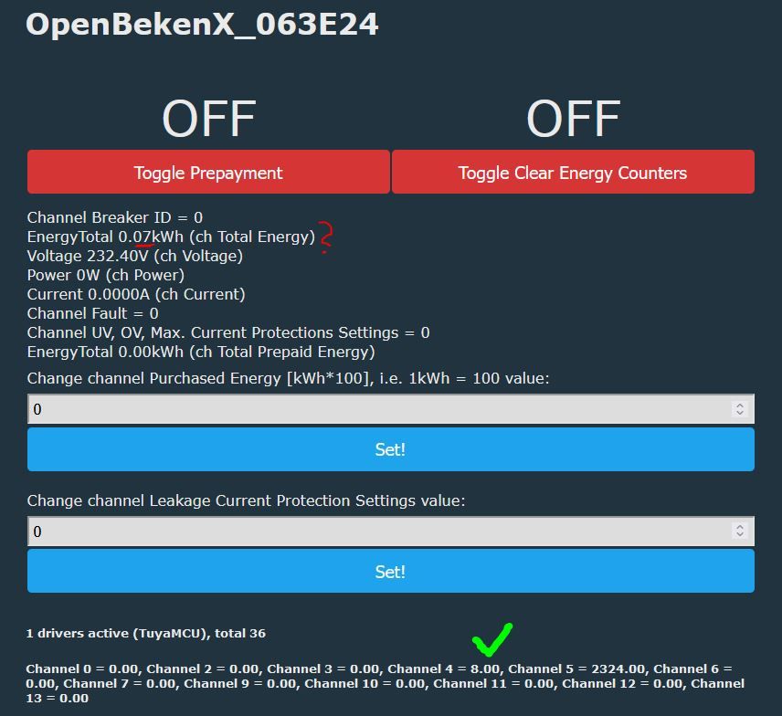

  • Channel 4 updates correctly but webview kWh is wrong
    #25 21098960
    Pete0815
    Posts: 34
    Are you forcing WiFi state 0x04?
    Not until now because of
    waitFor MQTTState 1
    Now I changed to test but seems to be same.
    Good news: The dpId 1 has changed now.
    I tested with 800W load for 1.5 minutes which are 0.02kWh
    Channel 4 changed from 6 to 8 which is great but within the Webview the counter says 0.07kWh ????
    Screenshot of OpenBekenX_063E24 control panel with energy settings.
    Nevertheless the situation is improving. Big Thanks!

  • Energy counter mismatch between raw value and kWh display
    #27 21099398
    Pete0815
    Posts: 34
    Thanks and tried by manual command and now activated the repeating command (every 5 sec) in the autoexec.bat but so far without identifiable change in result.
    My impression is that dpIx 1 is reported after first command execution but I was wondering about the difference in value presentation.
    As you can see by the log the integer value was 8 and channel 4 is also reported with value 8 but the presentation in the overview says 0,07kWh . This I´m struggling to understand because there seems to be not smaller number to have e.g a rounding error/problem.
    This morning i booted the device to test the manual & repeating query but now it gets even more strange because of different/lower values than yesterday evening.
    Today dpIx 1 value is 5 (channel 4 also) and the webview says again 0,04kWh.
    So why this reduction overnight without having powered up the device? And again this mismatch between log/channel value and the Energy counter presentation at the web page? Should I just ignore this? Because just checked the published Mqtt value and this is 5.

    User interface of the OpenBekenX application showing switches and energy values.
    After some testing I can report some more functions that are working.
    The Toggle Switch (channel 3) resets all energy counters Total Energy (channel 4) & "Total Prepaid Energy" (channel 11)
    The value for Prepaid energy "Total Prepaid Energy" (channel 11) can be set and is always reduced by the consumption
    The toggle switch "switch_prepayment" enables/disables the prepaid energy consideration for the calculation of channel 4
    Still there are minimal differences between the channel values and the values shown in the overview but this seems to be constant +-1
    Will now test the UV & OV & Current Protection if the fault switch is triggered by it.
    For the leakage setting I´m not sure if this makes sense for this device.
