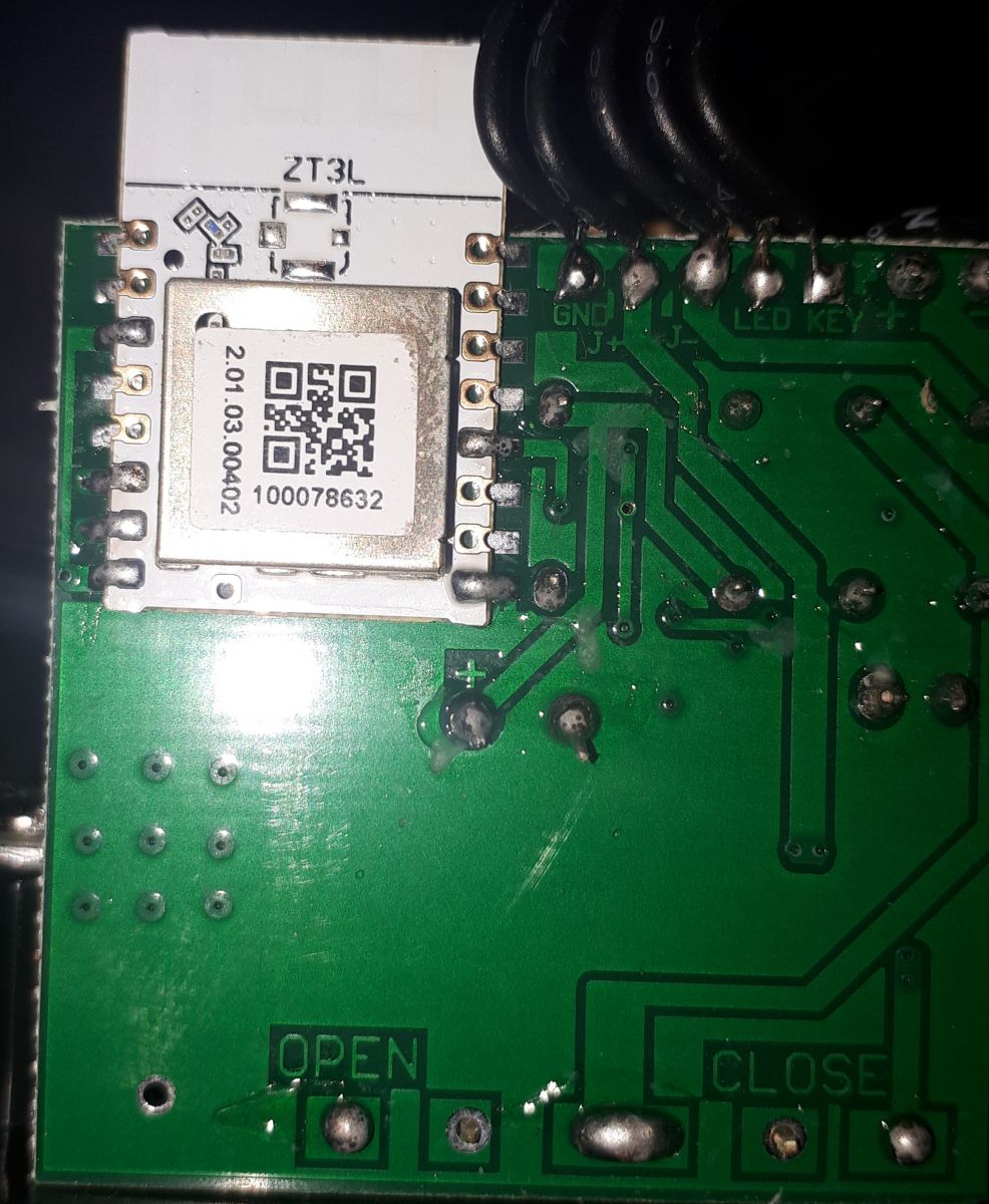

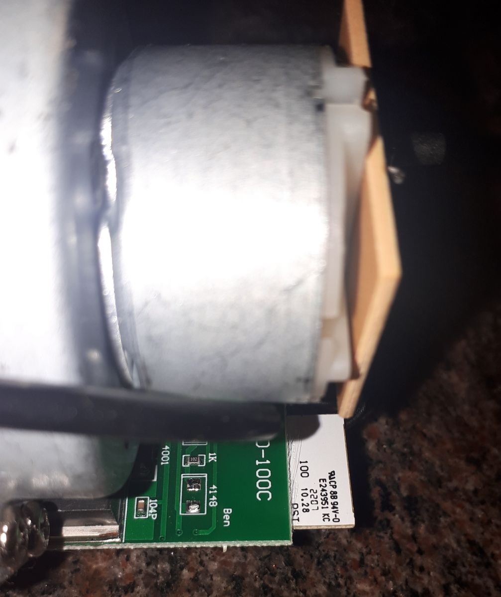

    Hi. Surprising situation.I mounted a device on a pipe at the DHW valve,just below the CH boiler. ( a company of many pipes to and from the boiler).Boiler enclosed with plasterboard.Zigbee gateway at a distance of 4m, another router 3m. They have one brick wall on the way.When I open the inspection hatch (35x25cm) to the boiler, the range is immediately there.The hatch is a plasterboard in a frame of Al.Plugging a signal amplifier-extender into a socket 2m away without a wall on the way or a metre away,but with a wall does nothing.Even a repeater inside the enclosure does not help. I have made some kind of Faraday cage of plaster and non-ferrous metals there? Or these devices have less range than claimed.Here is the inside of the controller:
    Improving Tuya Zigbee Valve Signal Range in Enclosed Boiler Setup .
    Antenna:
    How to solve this? Cut up the antenna and add your own and put it outside?

    In those two vertical leads in the photo on the left?
  • #4 20284723
    sosarek
    Posts: 83875
    Help: 9320
    Rate: 15532
    The antenna is on a PCB flooded with white lacquer, with ZT3L printed underneath.

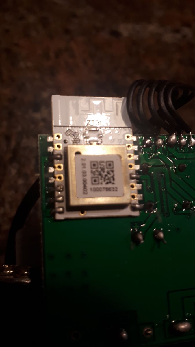

    palmus
    Posts: 3976
    Help: 233
    Rate: 752
    Yes yes, I meant precisely these points:
    That's where I solder in, cutting off the antenna on the board at the same time?

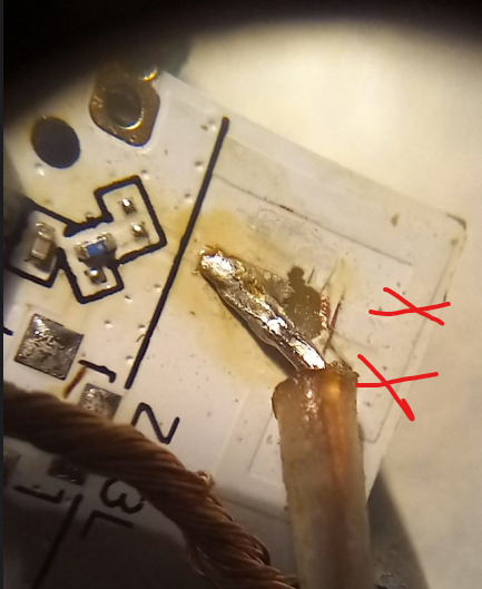

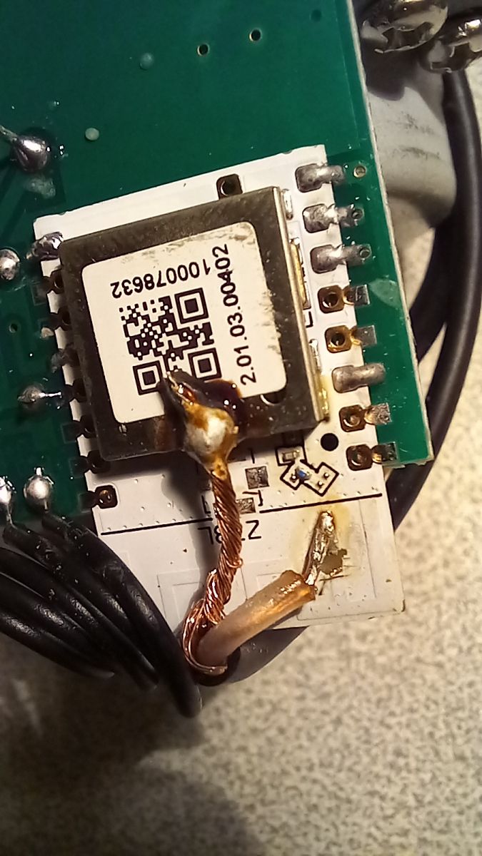

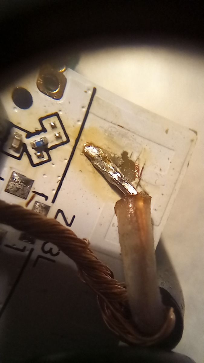

    I have performed an action of yes:
    Unfortunately, it's worse.The device is not detectable, i.e. the connectivity has died.I checked if something is shorted, but it's unlikely to be:
    A cable of about 1m, terminated with an SMA socket, an 18dB or other weaker antenna and unfortunately nothing.
    Where is the error? What else is there to check?

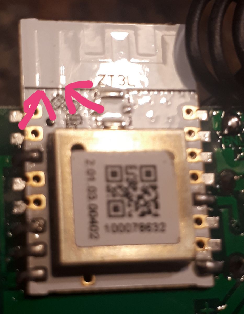

  • #7 21588480
    skowerr
    Posts: 65
    >>20341619
    imho You should cut these taces marked on picture
