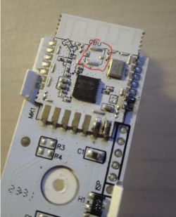

    Interesting. A CBU module is installed in my door sensor, for example. The pads for the IPEX connector are easily accessible and it would be possible to solder a coax cable for an aerial directly to them. The only question is what needs to be changed in the signal path (the antenna is on pin 2 of the IC) so that the external and not the PCB antenna is used.

    With the CBU board, I am almost certain that you can choose between PCB and external antenna by re-soldering this component. At least that's what it looks like in the picture and my continuity measurements suggest so. Look at this datasheet

    However, I am not sure if an external antenna can be connected correctly to CBU without additional circuitry.
    I found the wiring of the antenna here: https://developer.tuya.com/en/docs/iot/bk7231t-cob-hardware-design-guideline?id=Ka97u6dz0h8b8#title-2-Minimal%20system%20diagram. It will probably be similar for the BK7231N.
