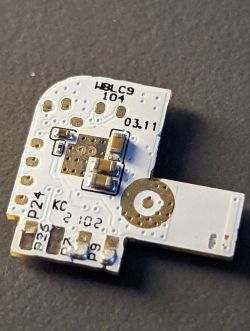

    I have 6 LVWIT 5W 350Lm RGB Bulbs in my bathroom and before I swap out for Zigbee I thought I would have a play with getting OpenBeken installed on them.
    WBLC9 module (BK7231T) and the SM2135Eh constant current LED controller.

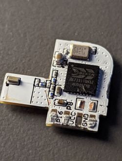

    Using Tuya Cloud Cutter on an old Beelink GT1 Ultimate TV box running Armbian I was able to successfully flash OpenBK7231T_UG_1.15.125.bin on one of my bulbs.

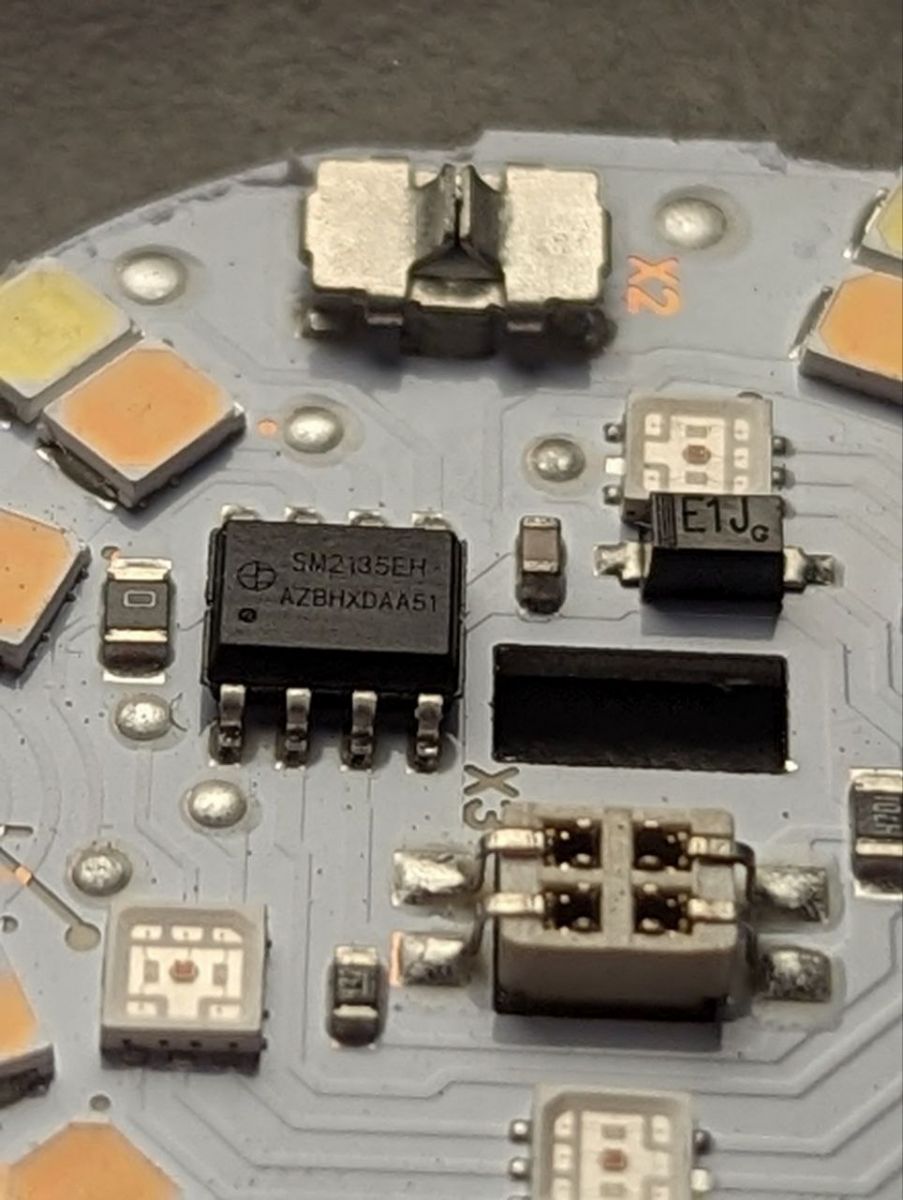

    I initially looked at the blakadder template for these bulbs which showed driver as MY92x1 which prompted me to open a spare and check - confirmed as SM2135.
    Now to my issue... I am totally new to this so might be an easy fix but I set the PIN configuration the same as the tear down for WOJ14415:
    P24: SM2135 DAT
    P26: SM2135 CLK
    The chip has labels for P9 P7 P26 P24 P16 and P8 (see image)
    So far all tests unsuccessful - light is default off and trying all toggles (on/off) brightness, temperature, colour results in no changes.
    Is there a testing method to try and find the magic P numbers?

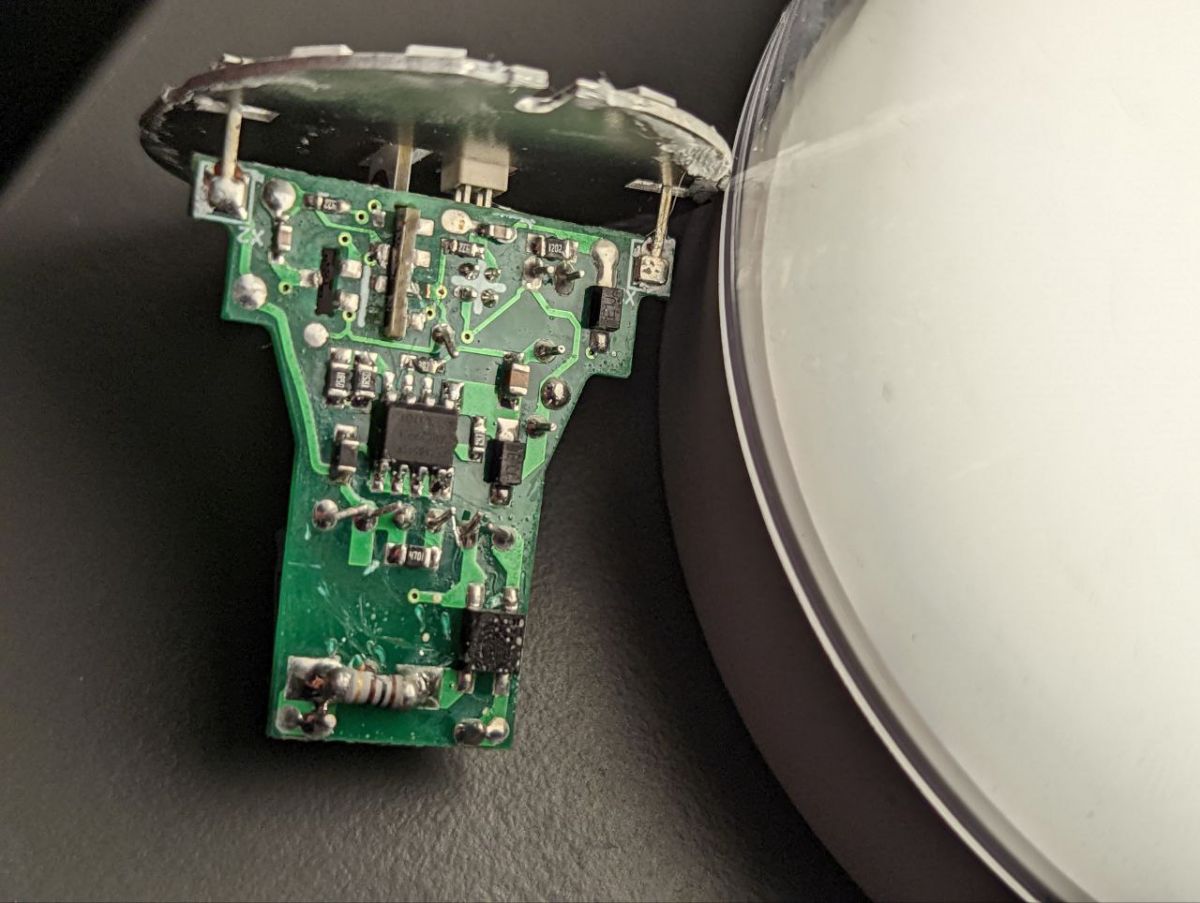

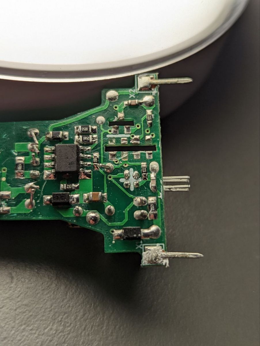

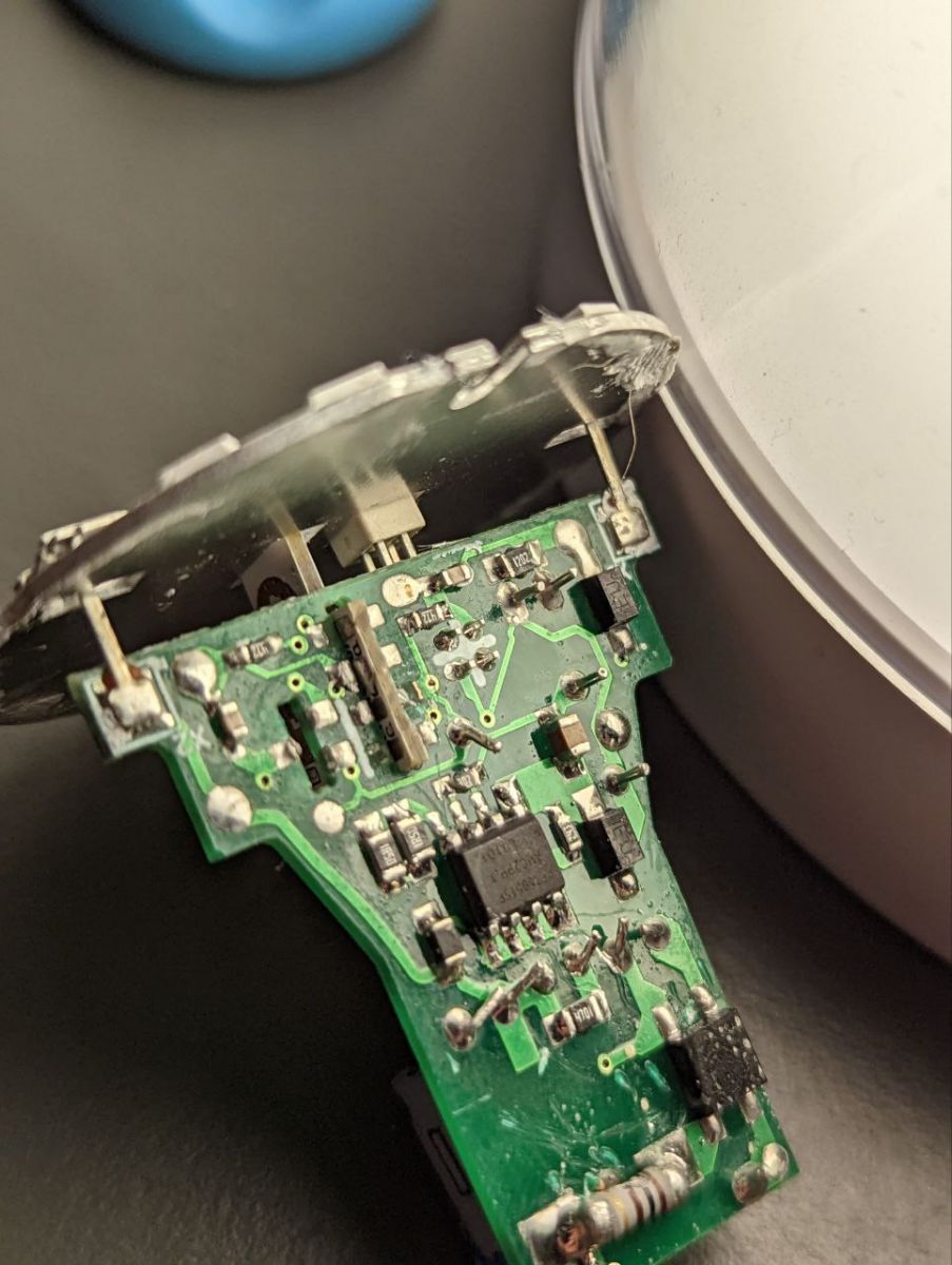

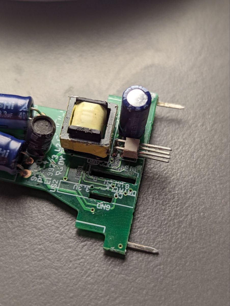

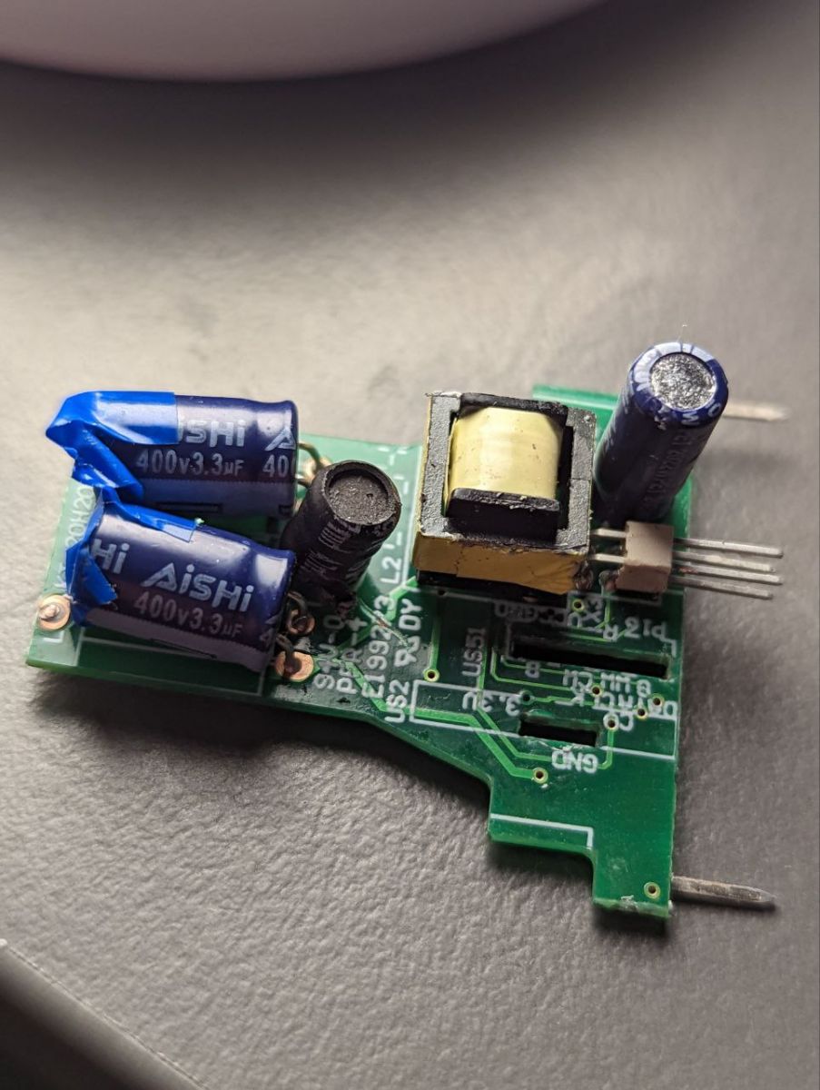

    Managed to get the power board out and some photos of it:

    Hello @s1dave , have you checked if the P26 and P24 connects to SM2135 with a multimeter?
    EDIT: do you know that you should restart device after changing pins of SM2135 to apply the change?
  • #3 20315879
    s1dave
    Success with multimeter (thank you)
    P7 - SM2135CLK
    P9 - SM2135DAT
    Now to use cloud cutter on my remaining 5 bulbs!
    Thank you p.kaczmarek2 and OpenBeken team.
