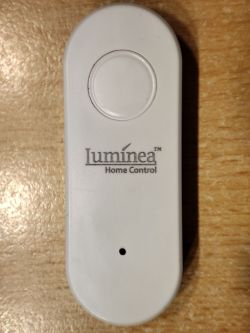

    Hi,
    i have flashed the Luminea ZX-5140-675 LED Controller with OpenBK successfully.
    The small Controller is based on BK7231N
    Here is how:
    1. Open the small case from the back
    2. Push out the PCB
    3. Solder wires to VCC, GND, TX1, RX1
    4. Connect FTDI or simmilar to the corresponding wires you just soldered
    5. VCC is 3.3V !
    6. Use this BK7231 Flash Tool (description on the page itself): Link
    7. After flashing and connecting the device to your WiFi Network go to "Launch Web Application"
    8. Click the Tab "Import" and paste the following data under "Enter template here"

    12. Go to "Config" -> "Configure Module"
    13. Choose under P7 (PWM1) "PWM" and you are finally done.
    Now its possible to Switch the module on/off and change the brightness.
    Not working:
    Built in Microphone
    Switch Button in the Case
    I was not able to figure out how the button can be addressed.
    Pictures of the device can be found here: Link
    Pictures backup:
    White Luminea LED controller with logo on a wooden surface. Label of LED Luminea ZX-5140-675 with technical information. Close-up of the LED controller Luminea ZX-5140-675 circuit board with a microphone and port markings. Close-up of the LED controller Luminea ZX-5140-675 PCB with visible electronic components. Circuit board with a microphone and AMS1117 component. Close-up of the Luminea ZX-5140-675 LED controller PCB with visible traces, solder points, and a microphone.
  • Button likely on P20, mic on P23

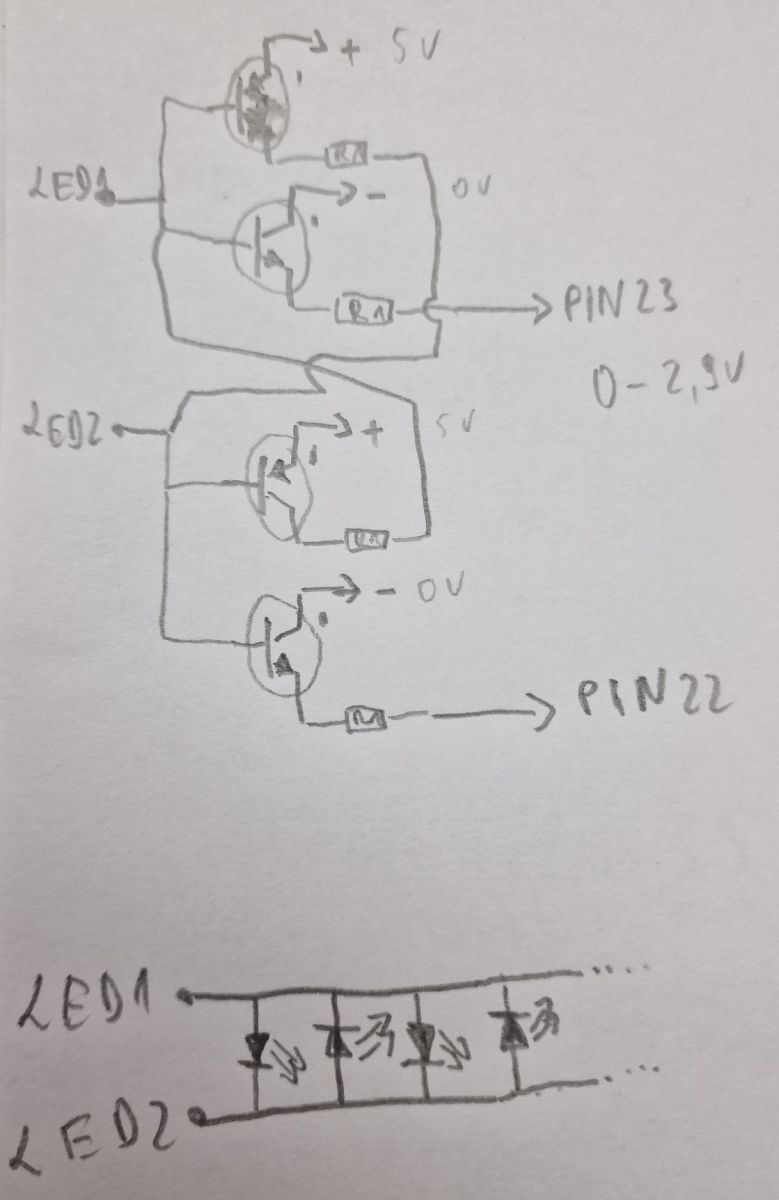

    Rate: 12953
    Would you be able to sketch a schematic how are those LEDs connected? Are those transistors pairs really connected to P6 and P7?

    niclauser
    Level 4  
    Hello everyone, I would like to take up the topic again because I have been thinking about implementing this anti-parallel two-wire LED light chain with an ESP8266 and Tasmota for some time, but I can't do it. Now I specifically got the light chain from Iluminea because it already contains what I want to recreate, just with a BL7231. And with OpenBK I can also understand the software, analogous to Tasmota.
    The LED light chain is a two-wire LED chain in which the LEDs are alternately soldered in reverse. According to my knowledge, the control takes place via an H-bridge with 2x Y1, 2x Y2 transistors and 4x 1KOhm resistors. (see drawing) The H-bridge is controlled directly by BL7231 via its PIN 22 and 23. The control takes place via a quick switch between PIN22 and PIN23 (PIN22 - on > PIN23 - off, PIN22 - on > PIN23 - off). This creates the visual impression that the chain is flashing or the light is running. At the same time, the level of the voltage supplied by PIN22 and 23 is "changed" using PWM, which makes the LEDs appear brighter or darker. Using the button that switches PIN20 of the BL7231 directly to GND, a predefined scenario on the software side is switched to switching frequency between PIN22 and 23 and PWM brightness control (8 scenes, always in the order 1-9, 9=off).
    I leave out the control via music because it doesn't interest me.
    From my point of view, the problem is the permanent reciprocal control of the H-bridge from OpenBK (or from Tasmota, as I tried before). Basically I don't want running lights at all. Only the PWM PIN 22 and 23 must be activated at the same time and like a sine wave. How can I implement this?
    Best regards
    Close-up of two views of circuit boards with various electronic components. H-bridge circuit diagram for controlling an LED chain.
  • Using PWM group mode for complementary outputs
    #6 20840461
    Posts: 14796
    Rate: 12953
    Hello, so you want one PWM to be high when other is low? With a dead time?
    Hm, it seems that you need to use a PWM group. It's should be supported in our SDK, but it's not exposed on our GUI, as I haven't tested it yet. You are the first one to ask for that. Is this really a stock Tuya device? Still, I can try to write an OBK driver for that feature, if that's needed.

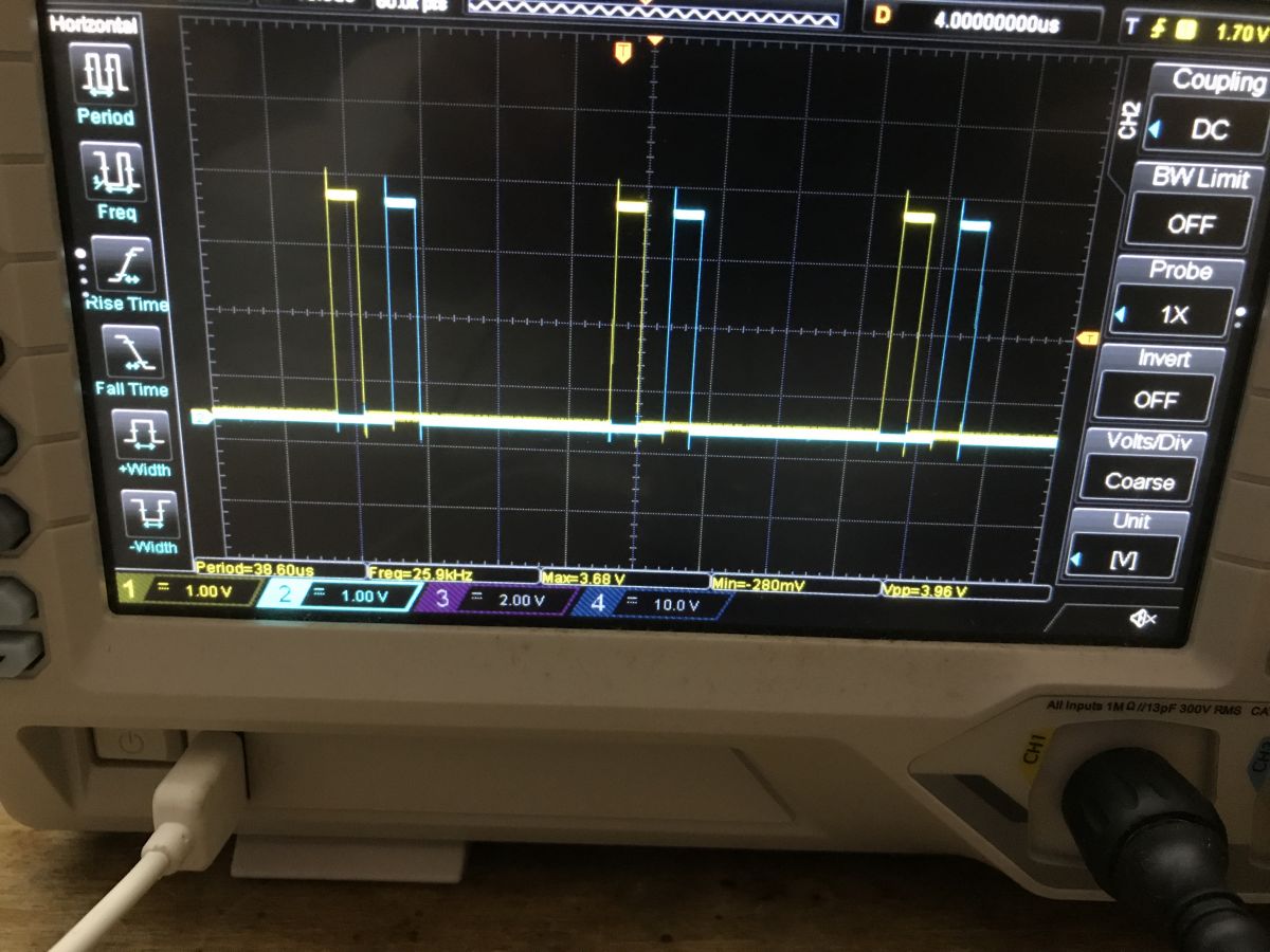

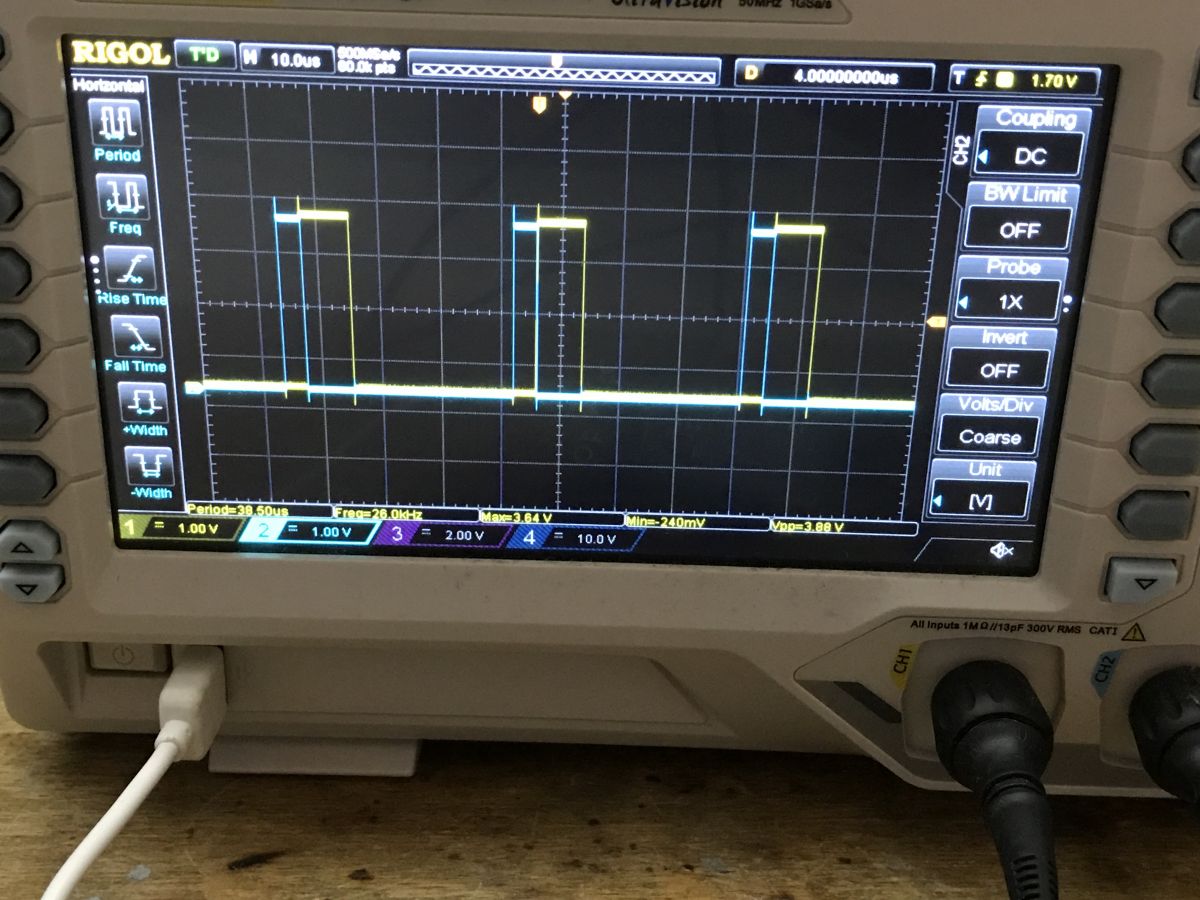

    #9 20886980
    Posts: 14796
    Rate: 12953
    Testing with scope.
    backlog startDriver PWMG; PWMG_Test
    Code: C / C++
    Oscilloscope screen displaying waveform signal.
    Same settings, but:
    Code: C / C++
    View of an oscilloscope screen displaying PWM signal waveforms.
    But I see a problem... it seems that duty2 argument is not even used in SDK:

    Added after 1 [hours] 31 [minutes]:
    I am testing to see how it works....
    Following code:
    Code: C / C++
    gives me:
    Oscilloscope displaying PWM signal waveforms.
    Added after 6 [minutes]:
    Following code:
    Code: C / C++
    results:
    Oscilloscope screen displaying two synchronized PWM signals with dead time.
    Added after 8 [minutes]:
    Following code:
    Code: C / C++
    Result:
    View of Rigol oscilloscope screen with PWM signals
    Code:
    Code: C / C++
    Result:
    Oscilloscope display showing PWM waveforms on a RIGOL screen.

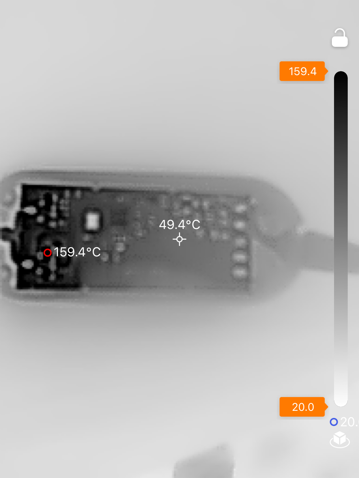

  • Overheating component reaches 150 °C at full brightness
    #11 21334798
    2ya2
    Posts: 6
    Sorry for reviving an old thread but I think my observations may be relevant. I am happy to have found this thread. I successfully flashed my Luminea ZX-5140-675 LED Controller. What worries me, though, is that under full brightness a component on the PCB gets extremely hot. I measure up to 150 degrees Centigrade at full brightness and that's with just a 1 A USB power supply.
    I never noticed this before (also never measured). Is this still normal?
    Thermal image of a circuit board with a temperature of 159.4°C.
  • #12 21334802
    Posts: 14796
    Rate: 12953
    What's getting hot - MOSFETs, BK7231 or something else?
    BK7231 can use power save to reduce heating (PowerSave 1 in startup command or autoexec.bat).
  • #13 21336018
    2ya2
    Posts: 6
    It is near the components at the "LED 2" label (if you compare my heat image and the fourth image in the top post). So it is not the BK7231. I lowered the brightness to 60 and then it is ok (around 50 or 60 °C).
  • #14 21336921
    Posts: 14796
    Rate: 12953
    Y2 transistor? It might mean that you have too long LED strip. Current consumption is too high.
    Did you get the controller in a set with a LED strip, or did you buy LED strip separately?
  • #15 21337062
    2ya2
    Posts: 6
    >>21336921 Thanks for the remark. It is an original strip, no modifications. Perhaps the original Tuya firmware did some limiting. Currently, I am figuring out which MQTT topics work and will make sure to keep the brightness low.
    Does "PowerSave 1" in startup only work for the chip, is there another limiter I could set?
