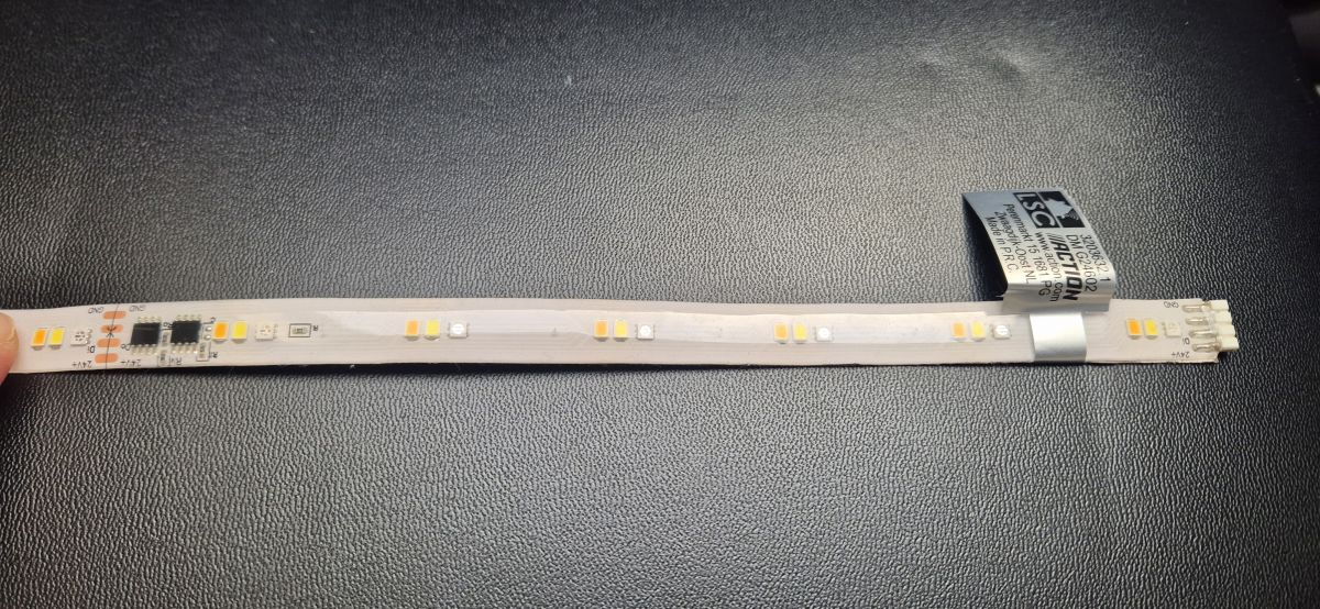

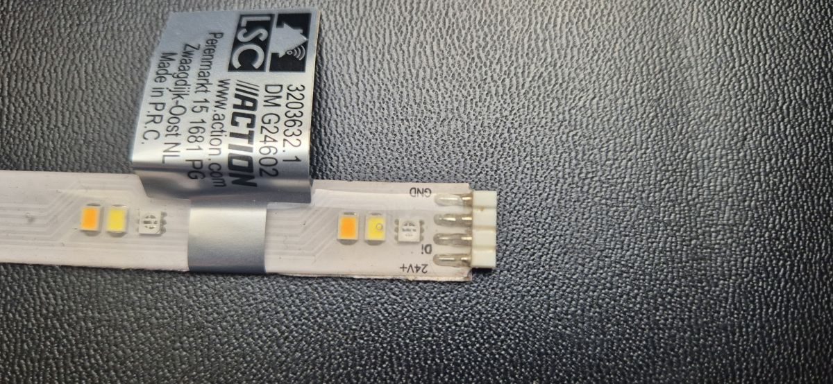

    There are 25 parts like this one to achieve the 5M strip :
    Smart LSC 3203632 LED strip on a black background.

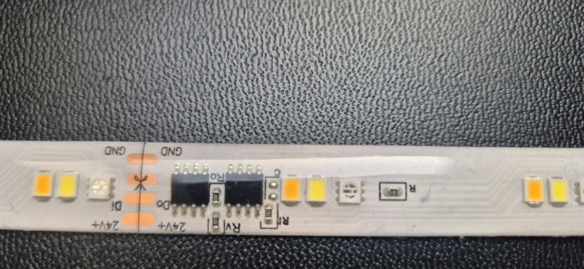

    Section of LSC LED strip with code 3203632.1.Section of LED strip with visible diodes and components.
    The 2 CI's on strip are totally black, no writing, no refs.

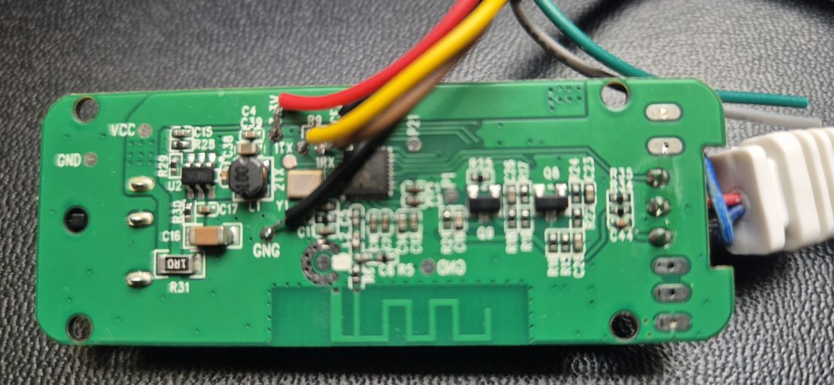

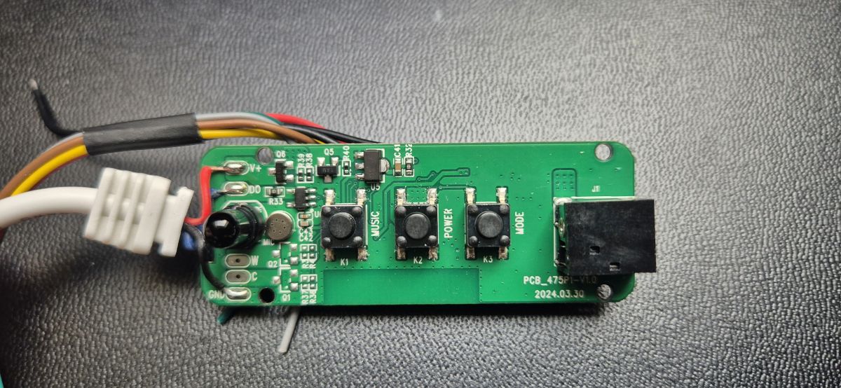

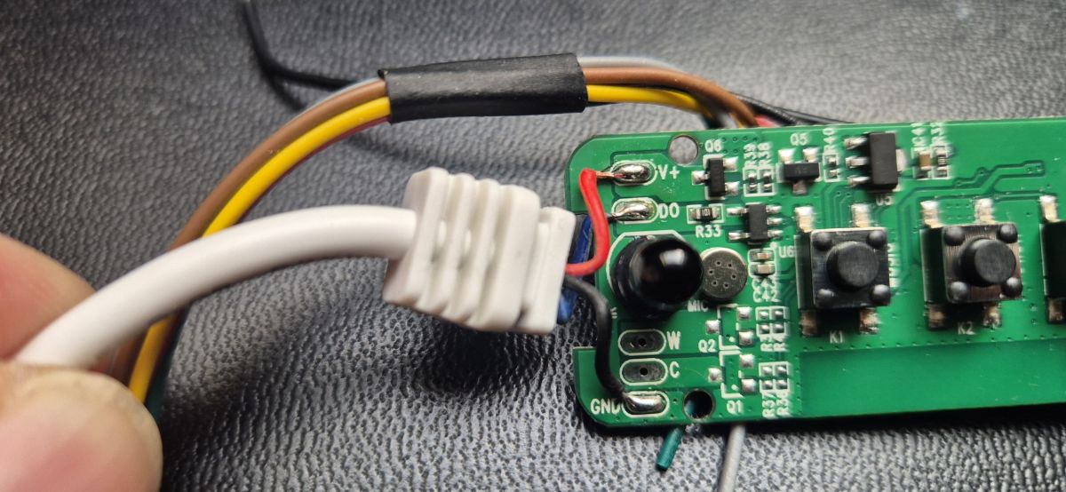

    And finally the board itself : 3 buttons, IR receiver, 24V power
    Circuit board with wires and electronic components. Close-up of an electronic board with three buttons and an IR receiver, along with connected wires. Circuit board with three buttons and colored wires.
    As we can see, everything is driver by Do output. Cold/warm channels are not used .
    The backup from original BK7231N fw is ok but no way to retrieve the conf : "Failed to extract keys" with BK7231Flasher

    after investigations, here are my results :
    PWM on P6 to control light
    REL on P8 to ON/OFF the 24V on the strip
    Buttons on P9 / P24 / P28
    and SM16703 on P16
    Right now, i can on/off the strip , Brightness is ok , IR Receiver ok, colors are ok ( BRG order )
    Buttons are working but each one acts as a toggle switch for the strip in the current conf.
    I didn't find yet how to control RGB from WHITE cool/warm are there is only one channel wired to the strip.
    "pins": {
        "6": "PWM;4",
        "8": "Rel;20",
        "9": "Btn;3",
        "16": "SM16703P_DIN;0",
        "24": "Btn;4",
        "26": "IRRecv;0",
        "28": "Btn;50"
    Regards.

    Was Cool/Warm color working with Tuya app?
    So there is only VDD, GND and DATA going to strip? I see W (warm) and C (cool) pads not soldered...
  • #3 21334397
    snakesrules94
    Posts: 37
    yes, white cool/warm was ok within tuya app. You could choose either color and select, or white and select cool/warm.
    Indeed, only gnd/gnd and Do line between the controller and the strip, C/W pads on the PCB are not used.

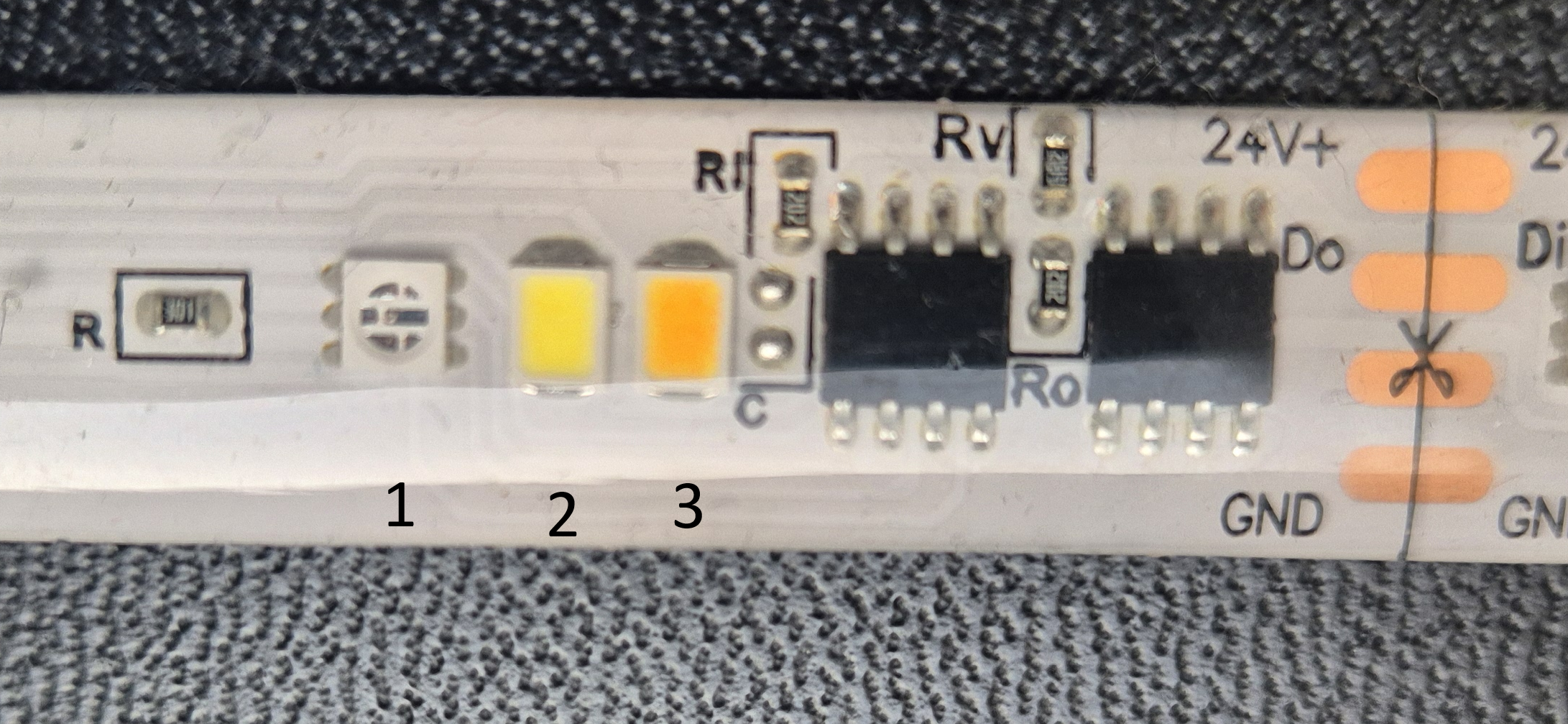

    I've reflashed original FW this morning to check :
    Close-up of an LED strip with three diodes and power markings.
    When using RGB mode, only led 1 is used
    When using cool white mode, only led 2 is used
    When using warm white mode, only led 3 is used
    When using other white mode, leds 1 & 2 are used
    24V is always present when using the strip.

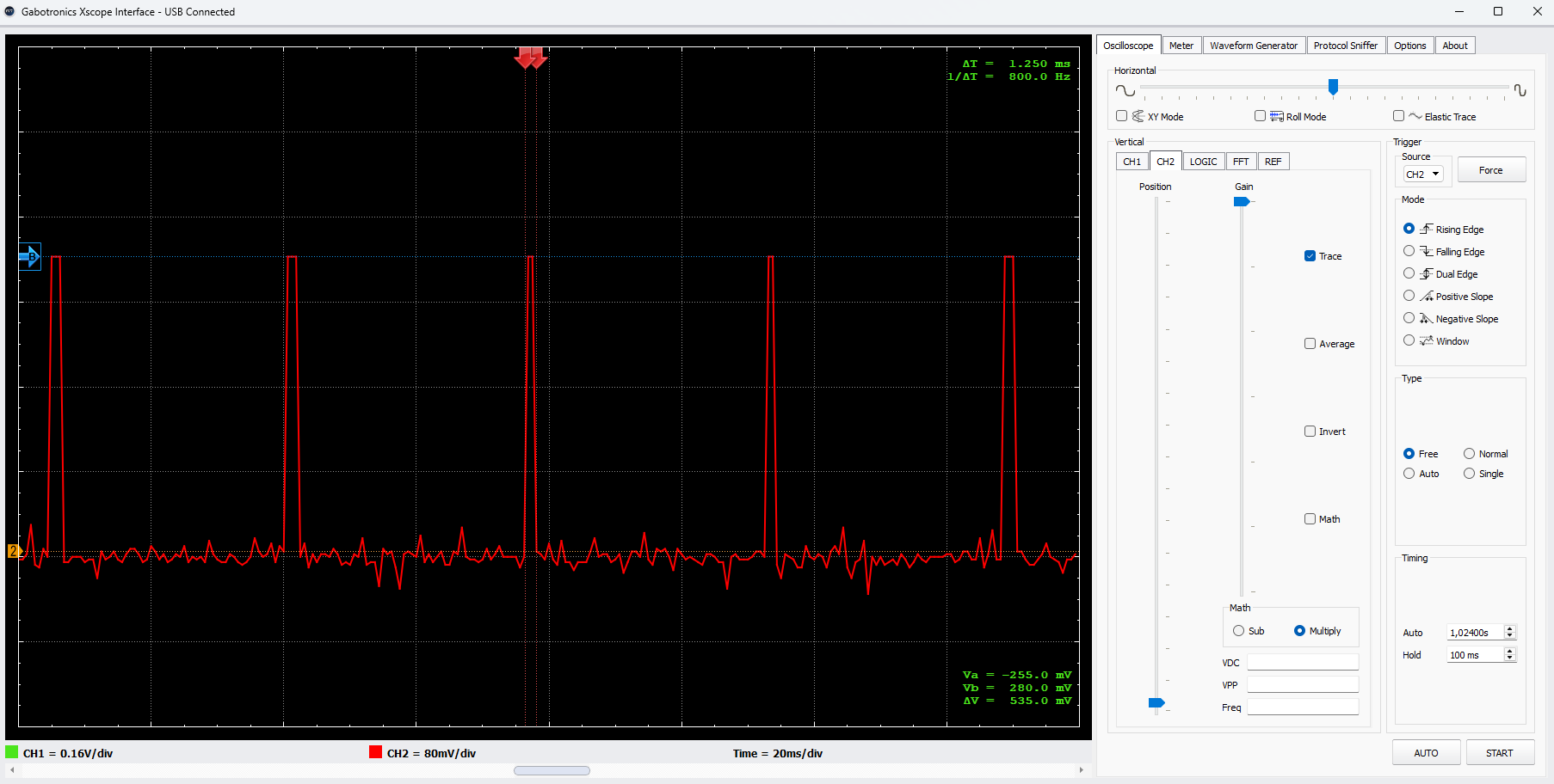

    I have a very basic Gabtronic Xscope on the computer but not sure what to check as there is only one output on the PCB and every action on the remote seems the same on the scope screen .
    Screenshot of the Gabotronics Xscope interface showing a signal graph.

    I'm not a signal analysis expert, but could it be possible that the frequency change to drive RGB or white part on the same pin? It could make sense with the 2 IC on the strip, one for each "color"?
    From what I can monitor, I sometimes see some frequencies at 400Hz, sometimes 533Hz and sometimes 800Hz, but as told before, I only have basic equipment and not sure at all about the readings.

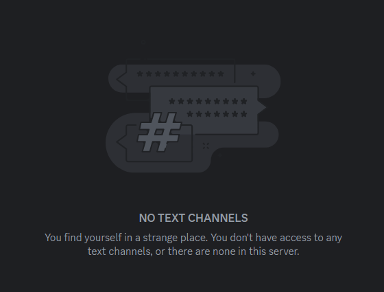

    snakesrules94
    Posts: 37
    I have this message with the link
    Graphic displaying the message NO TEXT CHANNELS with additional information about the lack of access to text channels on the server.

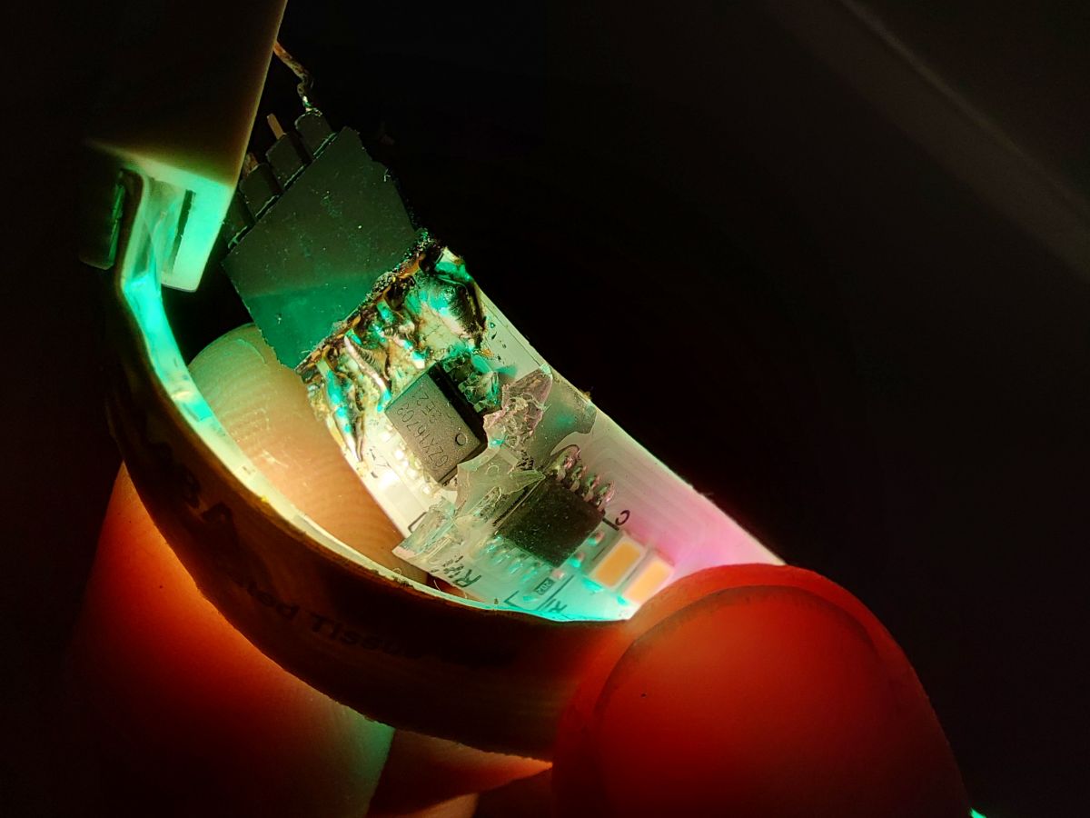

    Now I am soldering the strip in parts with some lan cables between it. I'm facing some issues with broken strip parts. Some parts are working but uncontrollable, with brightness of all LEDs 100%, others stay always on if 24v is supplied. Don't know the reason for this.
    On the chip I can see the chip number: gzx16703 Damaged LED strip with visible components and chip gzx16703.
